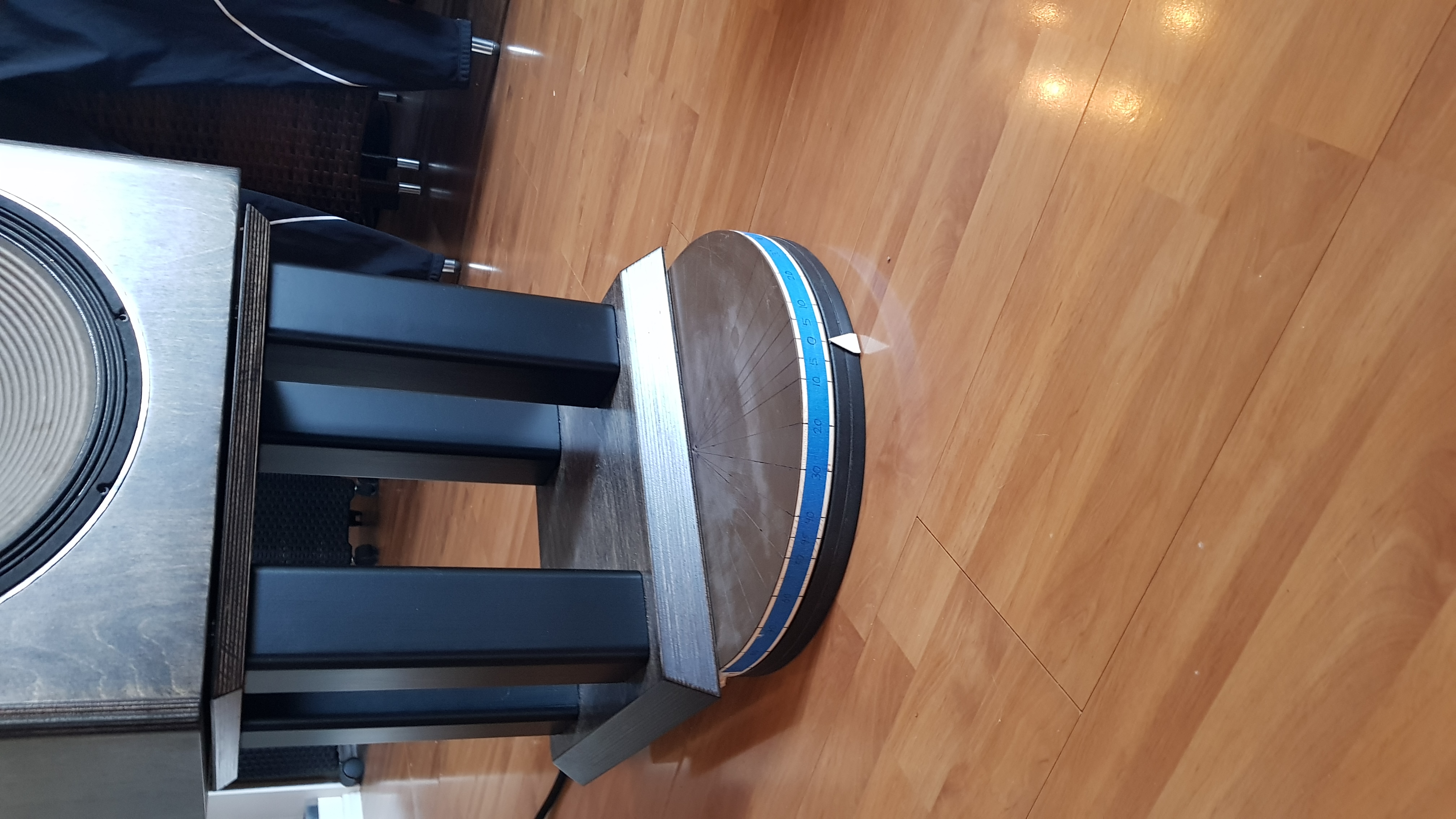

Measurements are done indoors and in the 4pi box. I am using a diy turntable for off axis measurements. Some pillows on the floor helps, but with gated measurements or with frequency dependent windowing in REW it seems quite reliable in the midrange and up. I know outdoor measurements are preferred, but a lot of hassle.

Took measurements with my turntable going from -45 to +45 degrees, and with 5ms gating to remove most reflections from midrange and up. Horizontal power response looks good to me, and I think this correlates with what one is hearing if listening at distance in a reflective room as mine. There is a problem with flutter echo in my room and I hat to pull down the area from 1,3k to 3k with eq to get it balanced to my taste. This has been the case with almost every speaker I have had in this room.
