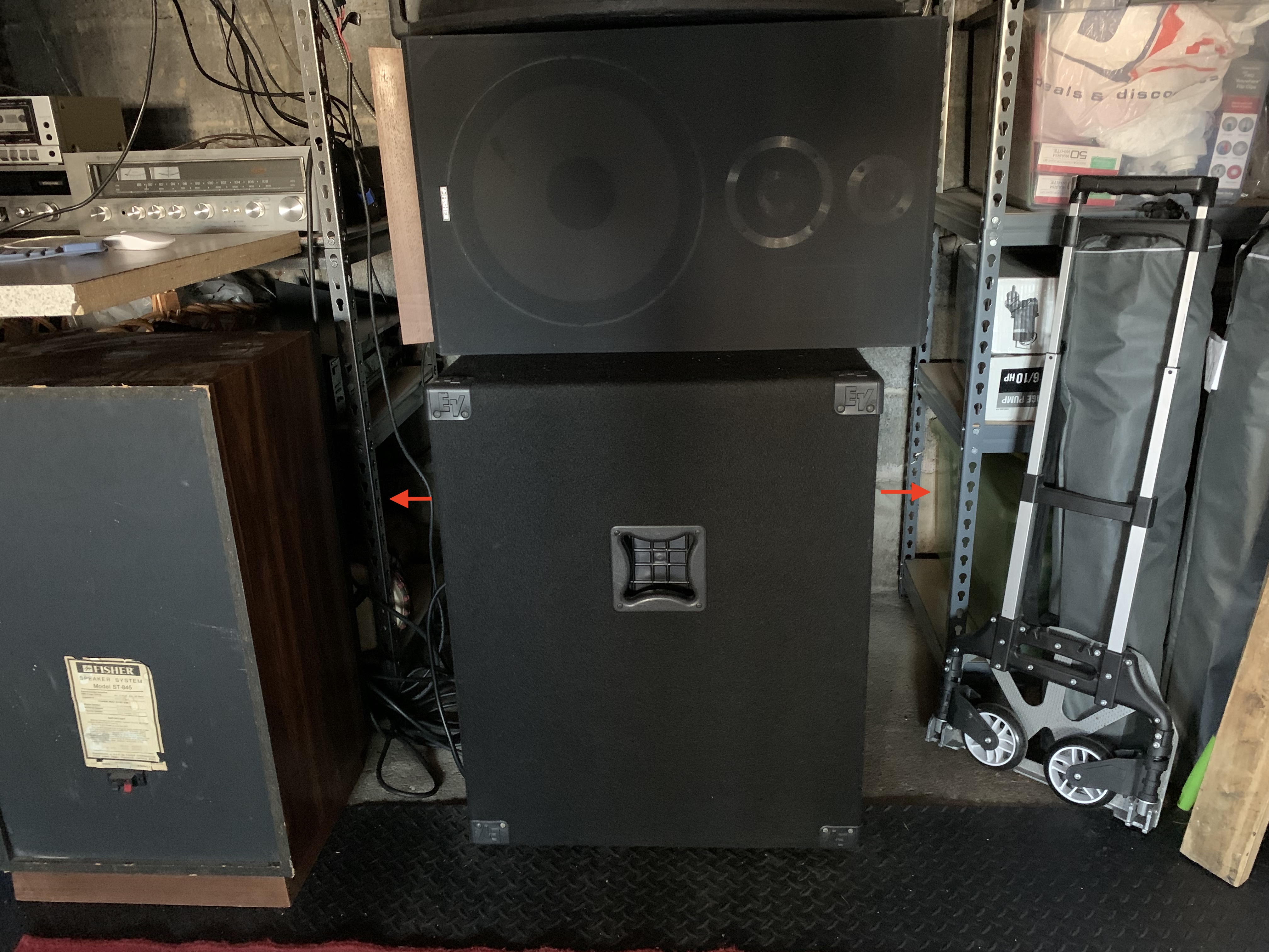

Hello all, I am new here seeking some advice/opinions for my issue please.
I have storage cabinets, shelving and whatever else placed along the back and side walls of the rectangular shaped garage which measures 10'W x 25'L and 8'H.
I have always had an issue with hearing the bass in different ways or lower tones at different spots in my Garage. I can't do anything about the room itself, it is what it is. Few days ago, I wasn't getting any sound from my EAW SB1000 Sub so I pulled it out and plugged it's cable from the Amp into my Full Range EV Eliminators to rule out any equipment issues. I then checked and it was the SB1000's speakon connection which had failed.
Thing is when I plugged the Bass Amp into the EV's, the EV's was in the middle of the room facing the side walls and I noticed that no matter where I stood in the room the bass was constant. So I decided to experiment further and placed the EV's where the EAW Sub was but placed them facing sideways towards the side walls between the 2 Shelving at the back wall and now the bass sounds equal at any spot in the Garage.
Please see attached pic of the back wall of my Garage. I am thinking of trying the EAW sb1000 sub in the same position but right now those are the EV's showing on the bottom of the pic facing sideways between the 2 storage shelves. As you can see there is some space like maybe 10″ on each side facing the shelves. Now if I were to place the EAW sub in that same way there would hardly be any free space on either side so might this be safe for the woofers please, if I should get the same results? Thanks guys.
/forum/index.php?t=getfile&id=2748&private=0
  • Attachment: IMG_2777.jpg
    (Size: 2.42MB, Downloaded 1251 times)

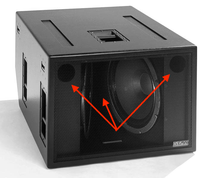

and another on Flanking subs. There some terminologies there which is confusing to me tbh but if I am understanding those 2 threads correctly it involves using more than one sub strategically placed in the room? If yes, I don't have the physical space to add more than one sub and only in the middle of the right side wall.
The EAW SB1000 is crossed at 80hz as that is the recommended setting for it and also I get the best bass tone from it.
Getting back to my original question though, I am thinking since this sub has 2 port holes and also a big opening between the 2 woofers on the front that maybe air is being pushed through these openings and if any objects should be placed in front of them then this might restrict the air flow and might cause some physical damage to the woofers so may not be a good idea. Is this accurate please or would it not matter?

If you really crank those subs up, the airflow through the ports will increase and things nearby might cause an obstruction. But if you're not really pushing them hard, airspeed won't get high enough to matter.
Put a sheet of cardboard where your nearest obstruction is. If the cardboard flutters from port airflow, then consider moving the obstruction. If it doesn't, don't worry about it.

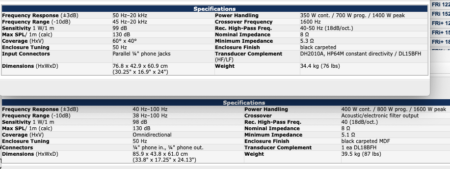

Meantime, as a potential idea. I am thinking I might try a pair of the EV subwoofer version which will give a little more power and more bass depth. These are the 2 versions of the EV's below, the 15" I have:
https://av.loyola.com/products/audio/ev-eliminator-i.html
and the Subwoofer version:
https://av.loyola.com/products/audio/ev-eliminator-i-sub.html
This is a screenshot of the specs from both of them, the 15" full range specs is on top, do you think the 18" Sub version might work better for me please?
/forum/index.php?t=getfile&id=2755&private=0
