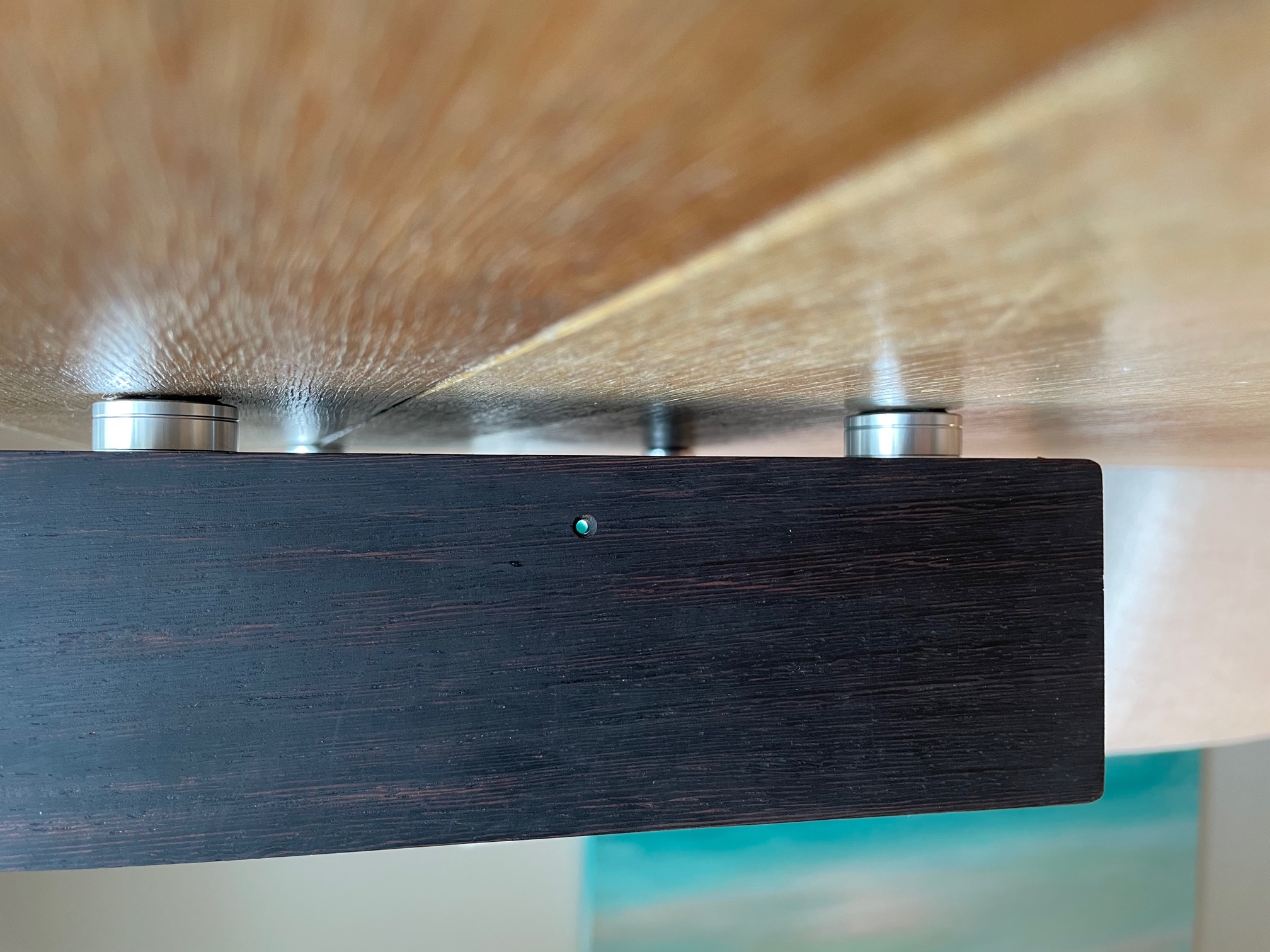

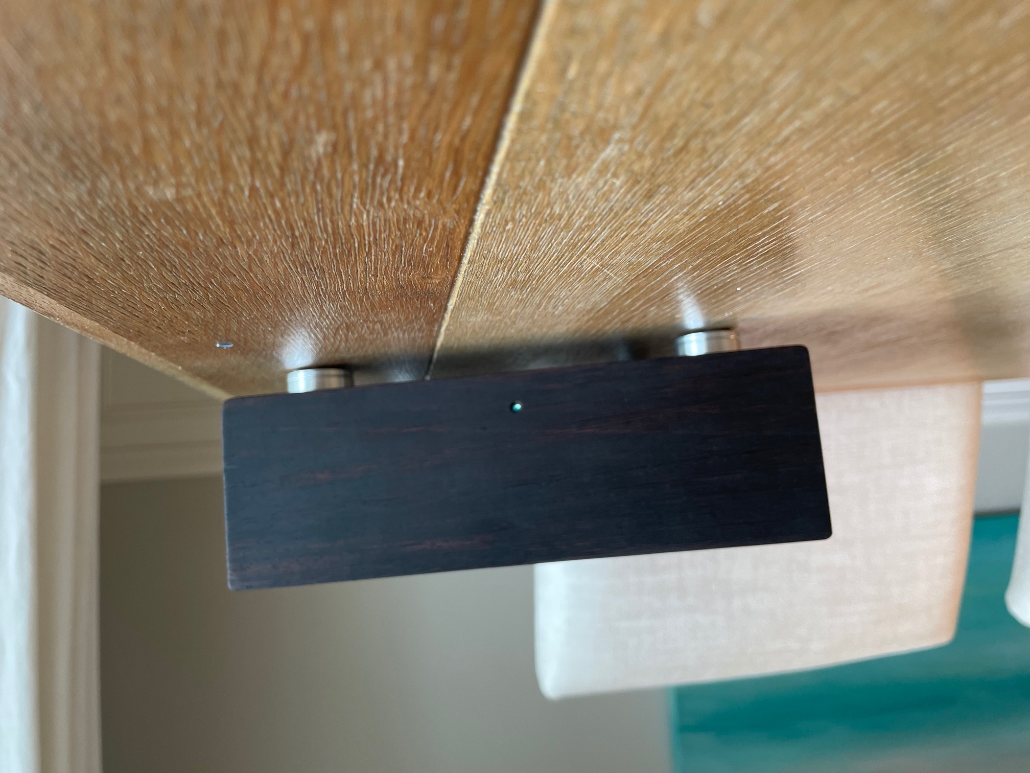

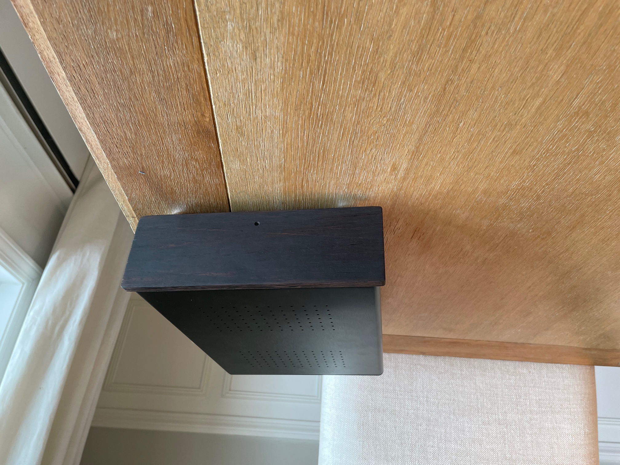

I went with a pair of Hypex NC400 "kits". The face plates weren't to my liking (especially next to my super pretty 4pis. So I worked up some replacements in Wenge. Just like w/ my 4pis, didn't know what I was doing, struggled about but survived in the end. Couldn't be happier with how they look and sound.
With a 10Tb of hi res lossless plugged into a raspberry pi, out to a Topping D50s, I feel like I have a pretty hot, low buck set up. Again, couldn't be happier.

Re: Amp Camp Amp [message #93780 is a reply to message #93779] Mon, 17 May 2021 11:32 Go to previous messageGo to next message
That really looks great! https://audioroundtable.com/images/thumbs-up.gif
Re: Amp Camp Amp [message #93781 is a reply to message #93780] Mon, 17 May 2021 12:28 Go to previous message
Messages: 1477
Very minimalist modern look. And power out the yin yang. Bet your very pleased.
