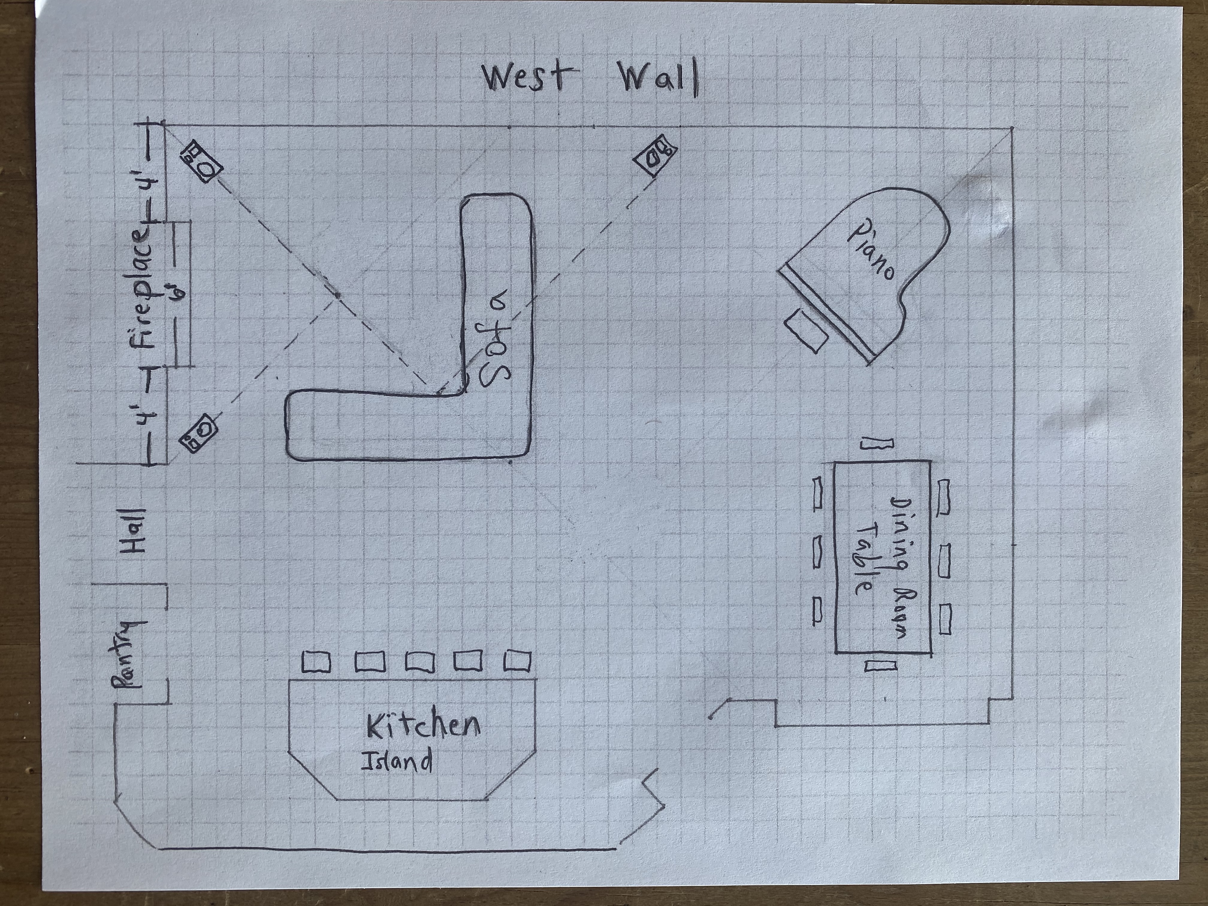

Speakers will go in the Great Room (Kitchen/Dining Room/Living Room). Due to the layout and size of this space my plan is to build 3 speakers. Speakers will be set up in an L shaped formation so that I will have 2 listening areas (See diagram below). 2 of the speakers will flank the fireplace for critical listening, home theater (tv is mounted above fireplace), or if I just want to relax on the sofa and listen. For this configuration, speakers will be set up approx 8-10' apart with flanking subs. Listening position will be 8-10 feet away. The third speaker will be used in conjunction with the speaker to the right of the fireplace. Third speaker will be positioned approx 20' from the other speaker. Together this configuration will be used for daily listening and background music while we are in the kitchen and/or sitting at the island where we spend most of our time while in this space. I will use a toggle switch to toggle back and forth between the configurations. As far as my diagram goes, I am not an artist and definitely not an engineer.
Room Diagram

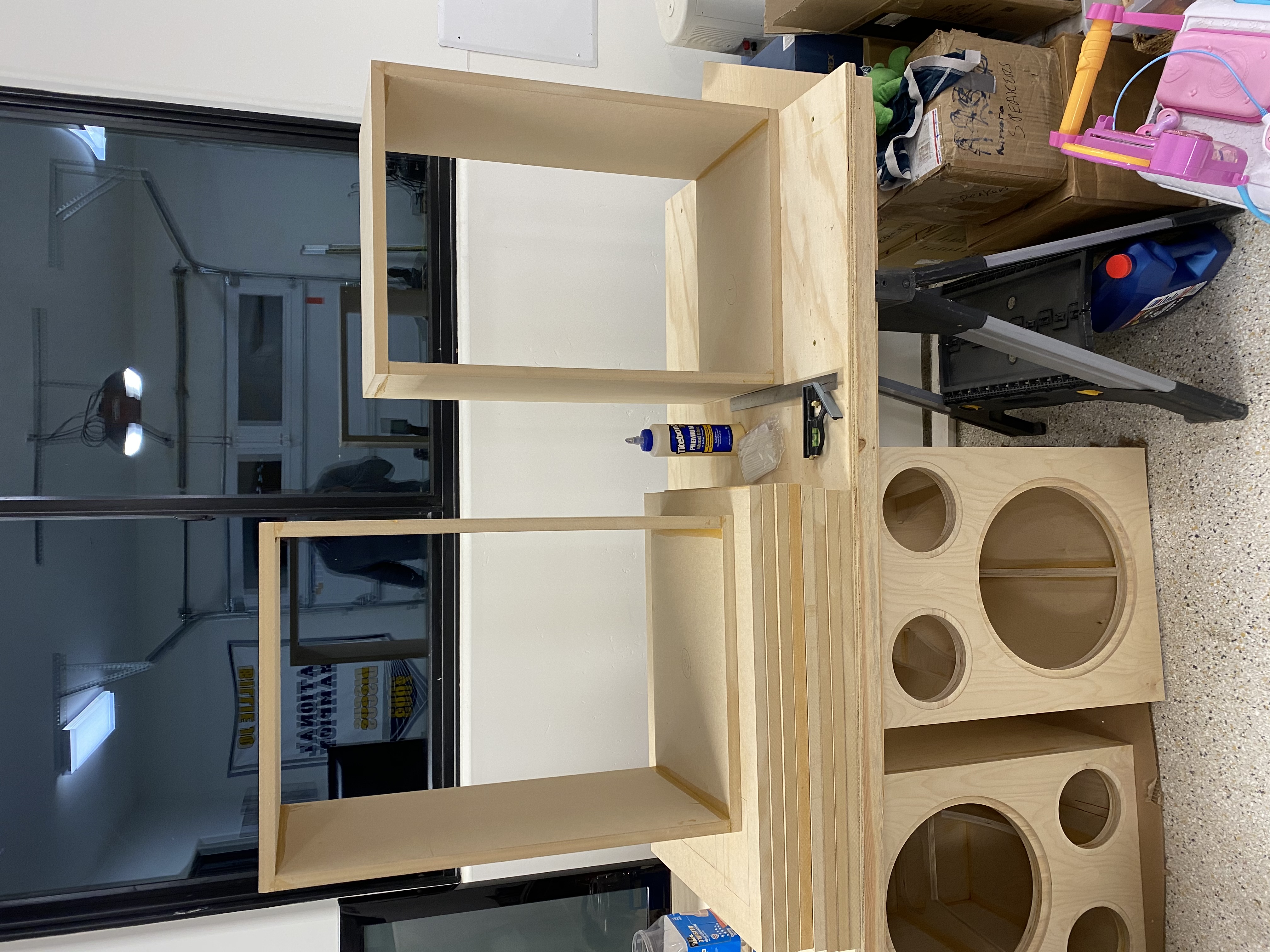

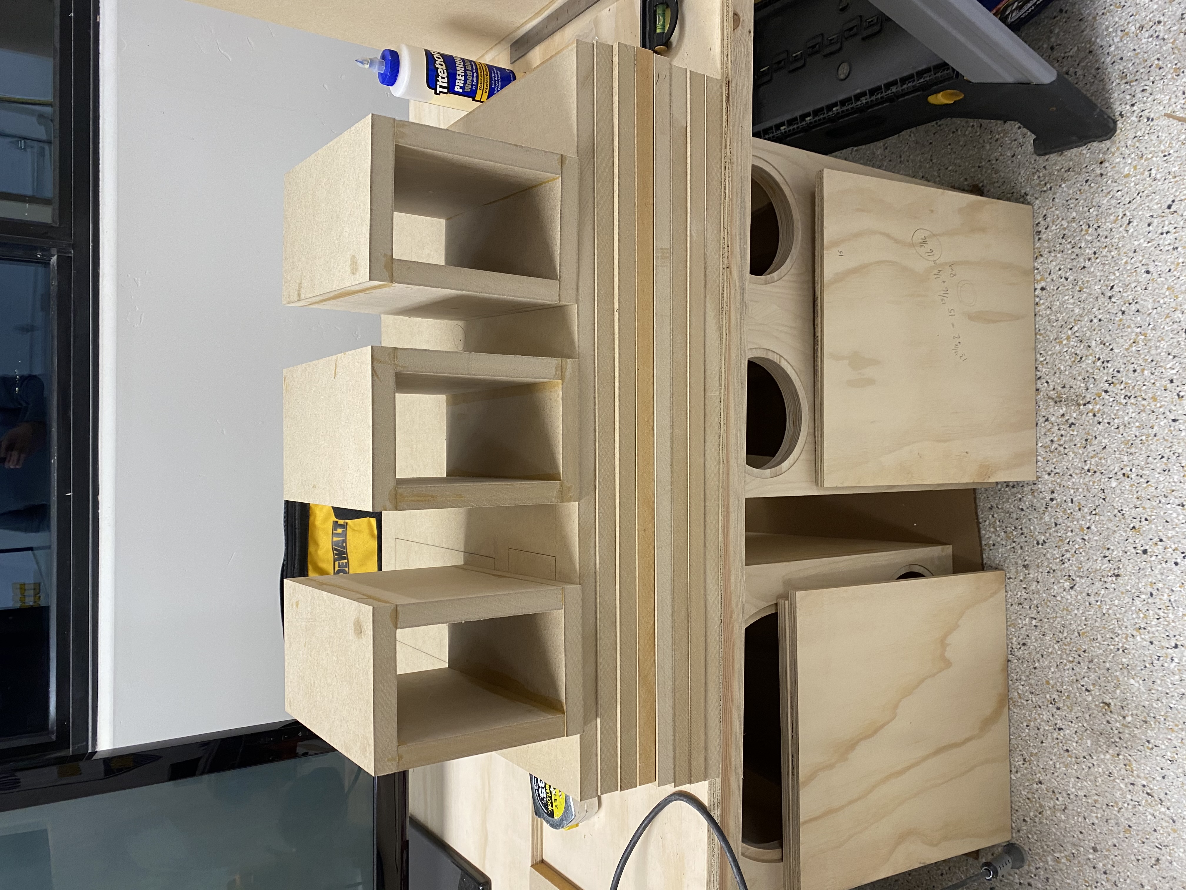

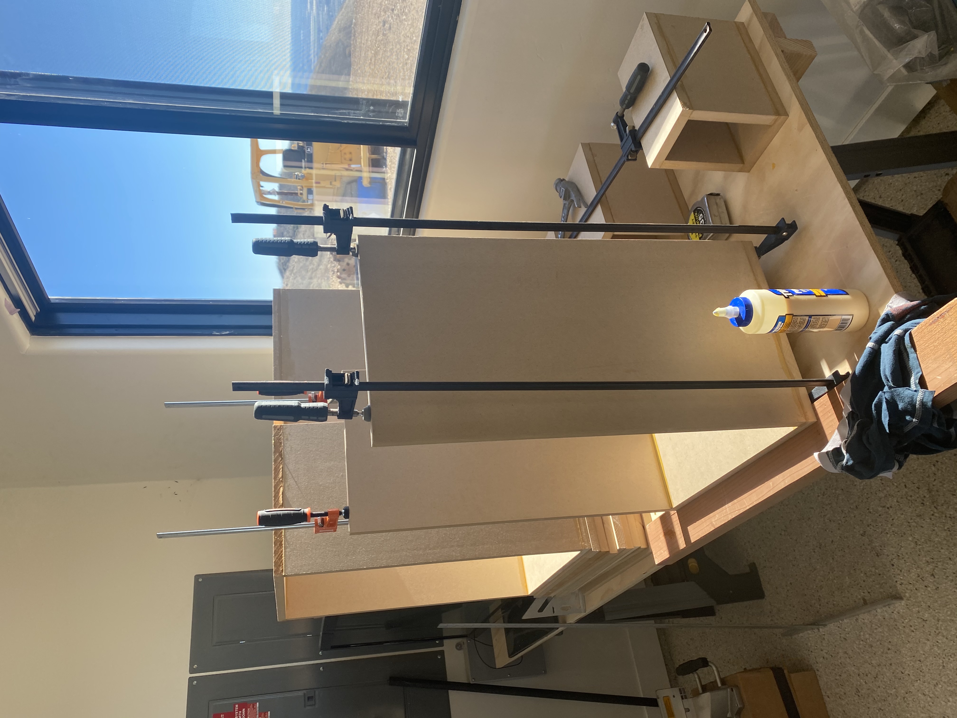

To build 3 speakers I used 2 full sheets of MDF. This gives me all of the pieces I will need with enough material left over for extra "parts," primarily the baffles. As I mentioned above, in case I mess something up I can just start over. I do own a table saw (portable, contractor grade) but in order to ensure accuracy and consistency I had the local lumber yard cut the pieces for me. I am not talking about Home Depot! The local lumber yard has been around for decades. In addition to supplying lumber and hardware, they specialize in hardwoods, trim, and molding. They have an old school professional grade table saw that is dead accurate and offer a cutting service. For $20 they made my cuts using a cut sheet that I provided. For anyone planning to go the DIY route and not use Wayne's Kit (which is a great value and would have made my life infinitely easier) I highly recommend this approach if you do not have a cabinet style table saw.
A few construction pics.

The braces can be installed with white glue only - no screws or tacking nails necessary. Make the braces a tiny bit long - like about a 32nd of an inch - so they fit snug. This preloads the panels being braced, which is what we want. Just put some white glue on each end of the braces and press 'em in.

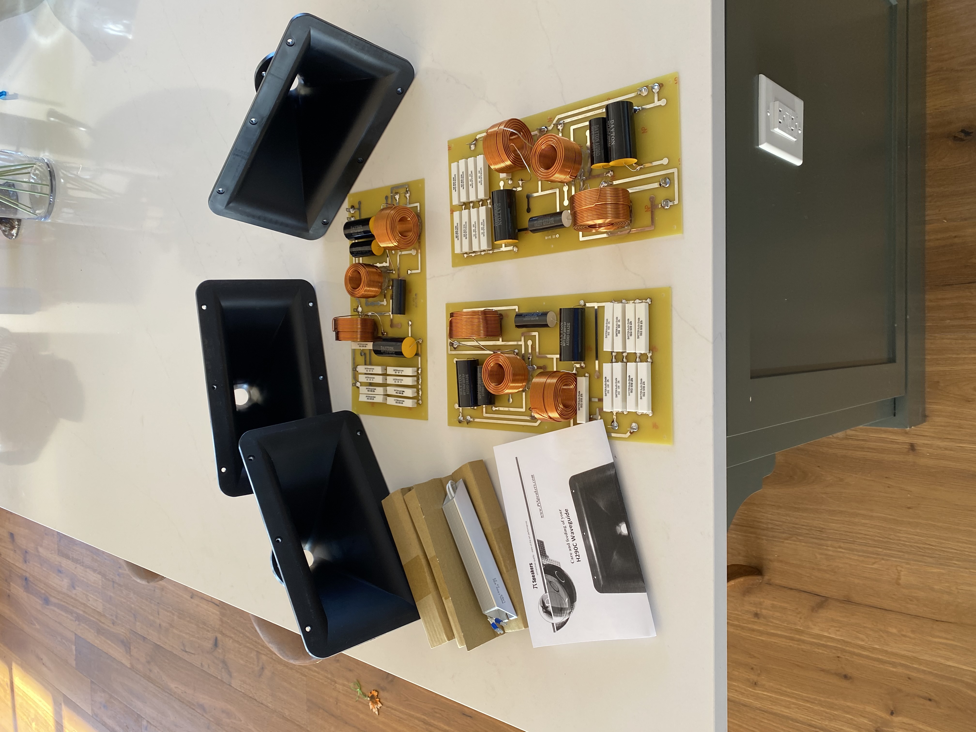

The parts arrived at the end of February. Everything was in good order and well packed. Crossovers are top notch. Good quality boards, nice lay-out, and clean solder joints. I went with standard capacitors and resistors but opted to upgrade the inductors to the 15awg version. As far as upgrades go, Wayne has an article in the FAQ section of the forum called "Upgrades." As the title suggests, it talks about the available upgrades and their benefits including which make the greatest impact. It sounds like upgrading the inductors delivers the most noticeable improvement as far as the crossovers components go. For the drivers I will be using the B&C DEC250 for the compression driver and the JBL 2226H for the woofer. Based on what I have read on the various forums, available product reviews, and on this forum, the driver upgrades are a "no brainer."

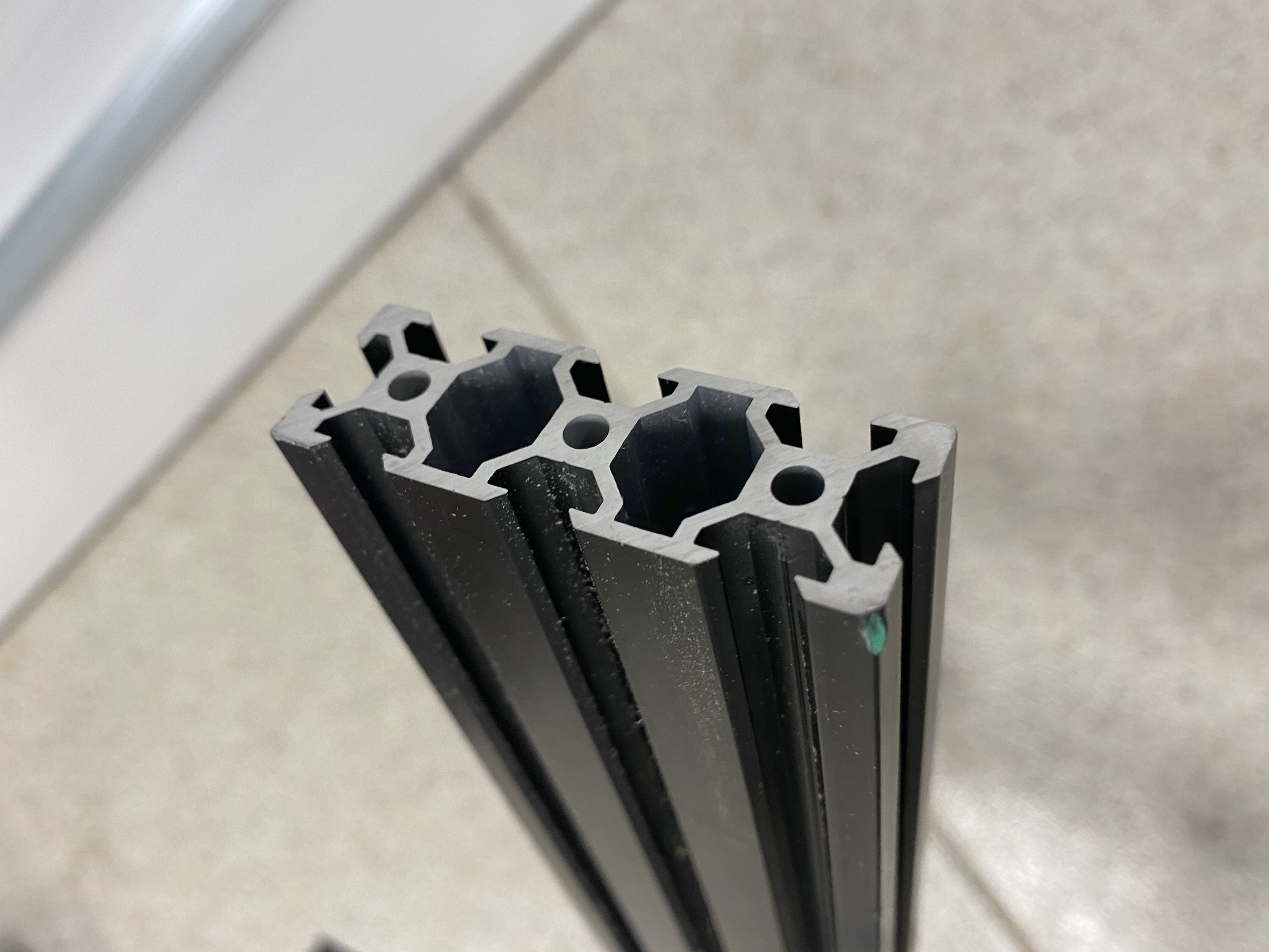

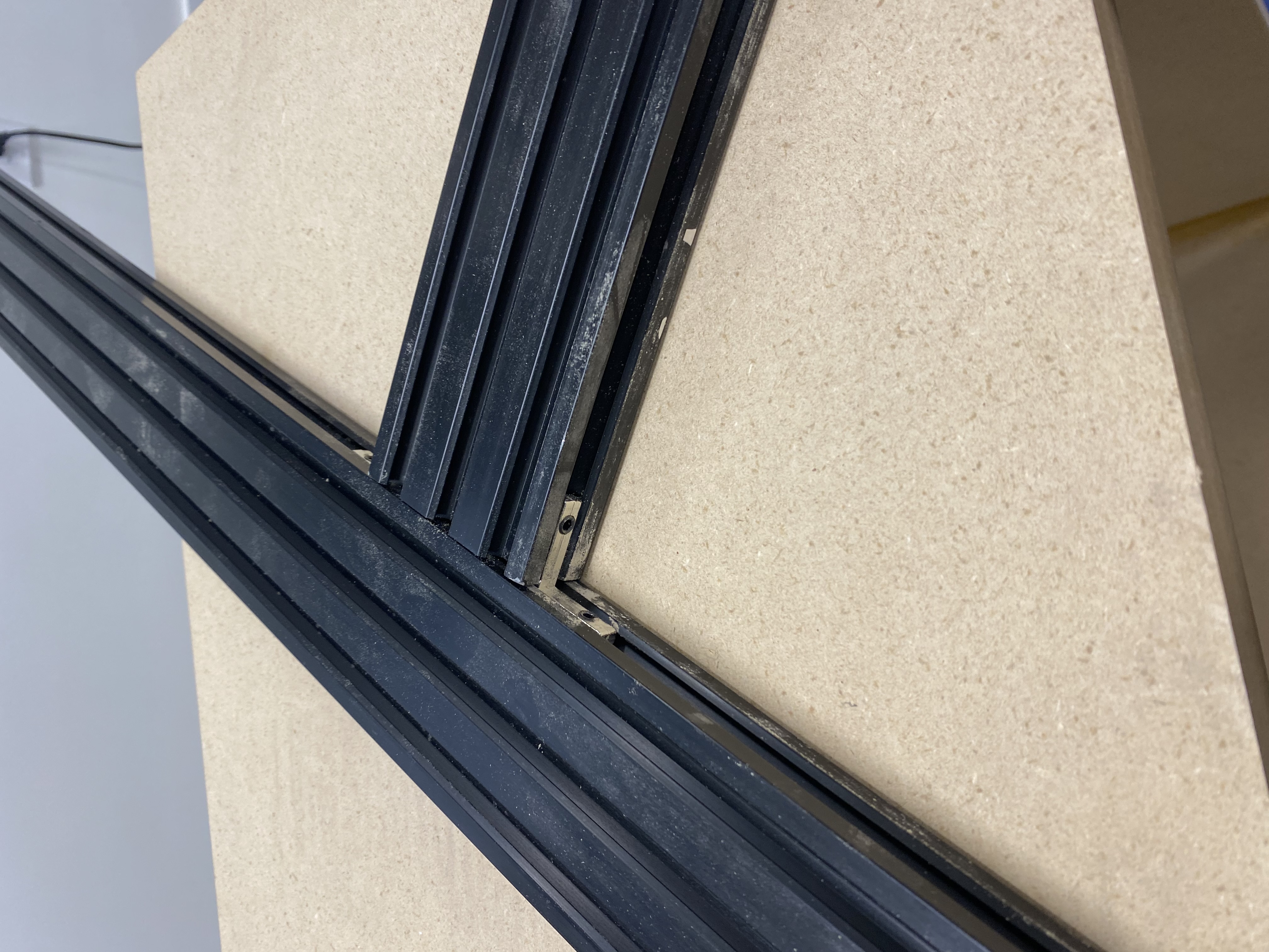

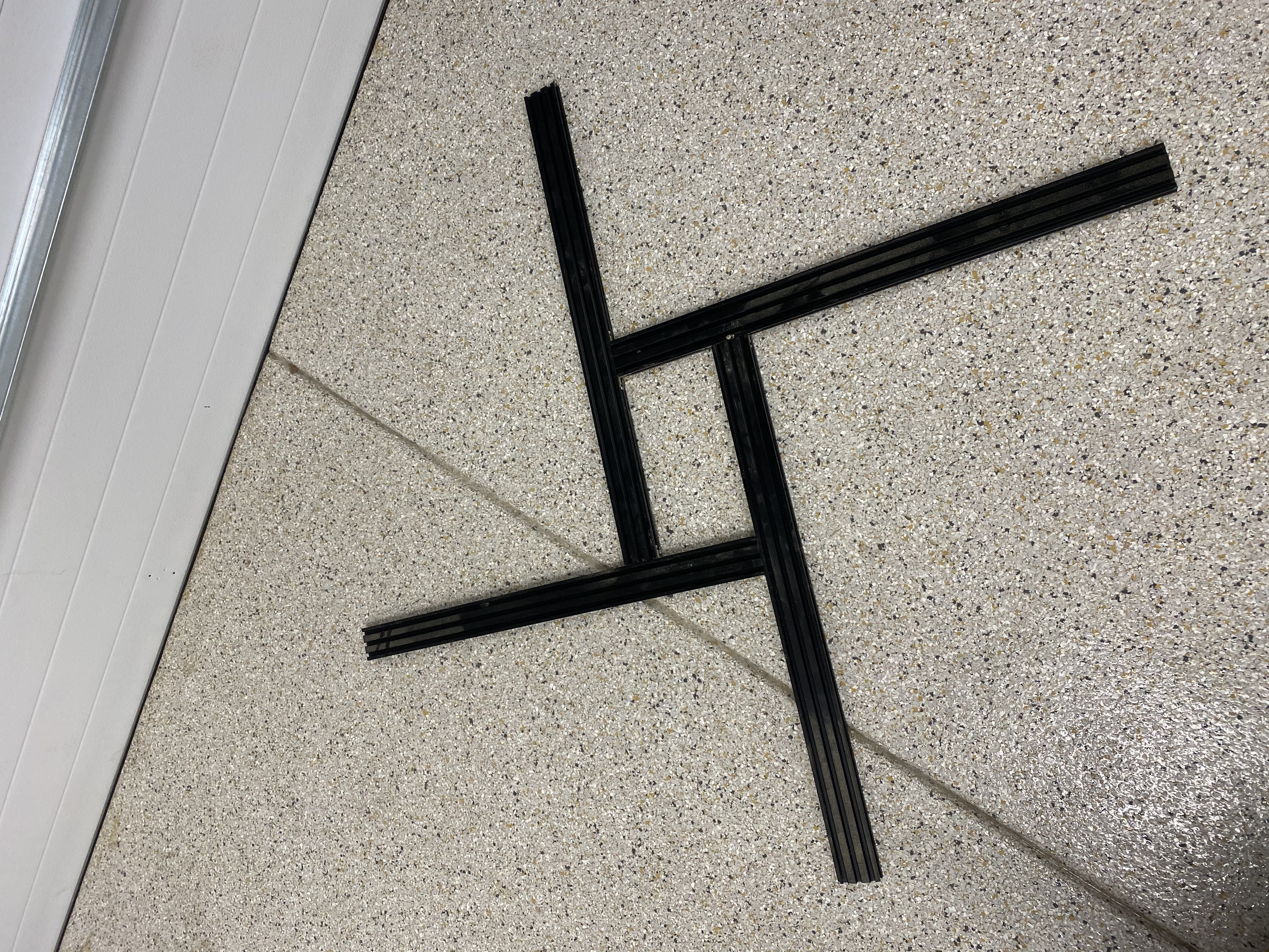

I mentioned previously that my goal is to recess the drivers and horns but that I wasn't sure how to go about handling the horns. For the JBL 2226H I will use my Jasper circle jig. For the horns, my neighbor had a really great solution for me. As it turns out, he is slightly more than obsessed with extruded aluminum framing. His entire garage, shop, and work van are filled with furniture and components made from extruded aluminum not to mention the entertainment center in his living room and the desk, printer stand, and bookshelves in his home office. He lent me a router jig that he made using the same.

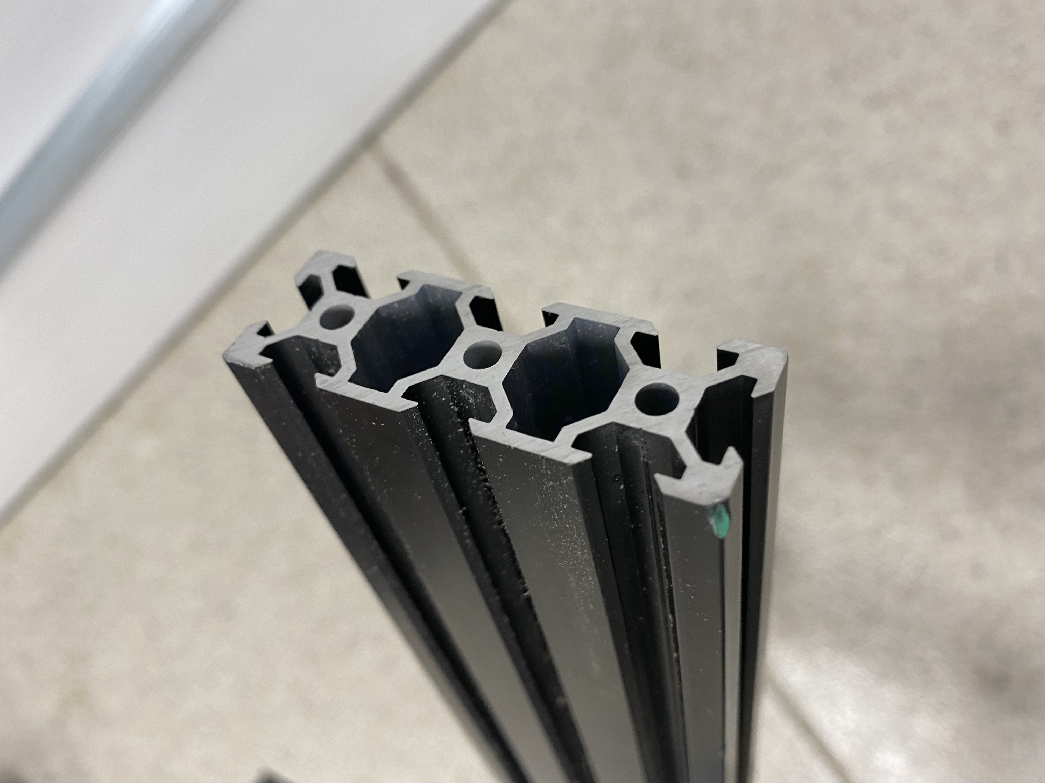

The jig is comprised of 4 lengths of 2060 extruded v-slot aluminum framing and a handful of the L-brackets that are designed to work with this material. At the end of the day you get a jig that is adjustable but sturdy.
/forum/index.php?t=getfile&id=2735&private=0
/forum/index.php?t=getfile&id=2736&private=0
/forum/index.php?t=getfile&id=2737&private=0
I made a couple of practice runs and the jig works great. I do need to figure out how to handle the corners because the finished radius that you get with this jig is slightly smaller/tighter than the radius of the corners on the horn. Unless someone has a suggestion I may just use some kind of wood filler to fill in the difference and sand it down. My plan is to use veneer so I should be able to cover it up nicely. There is a product that my cabinet guy introduced me to a few years back that is similar to Bondo. I have used it on several occasions but can't quite remember the name. It comes in a black can with bright orange writing and is available at Home Depot, Lowes, etc.... I will include the name in my next post.

1. Horn damping. It doesn't hurt, that's for sure. Some people swear by it. I personally don't find it useful because the H290C is so thick and heavy. It's well-damped, as dead as a rock. Its bell mode is over an octave below the passband, at around 420Hz. So the sound passing through it cannot energize it and the sound on the outside of the horn is damped by the insulation within the cabinet. Still, you won't hurt anything by adding rope calk or any other sort of damping goo on the outside.

re; the radius for your horn cut-outs, are you using a guide bushing on your router
or just running the base within the jig? I guess in either case, if you use a bigger
pattern bit the corners will have a bigger radius, hopefully matching the horn.
No surprise there. Nice jig, too!
Chris

I am using a Template Router Bit with a flush trim bearing. The bit is 3/4" wide x 1/4" deep. In my practice runs I was sinking the bit and running the bearing along the inside of the jig. I will look into bushing guides. Thanks for your input.
Alex

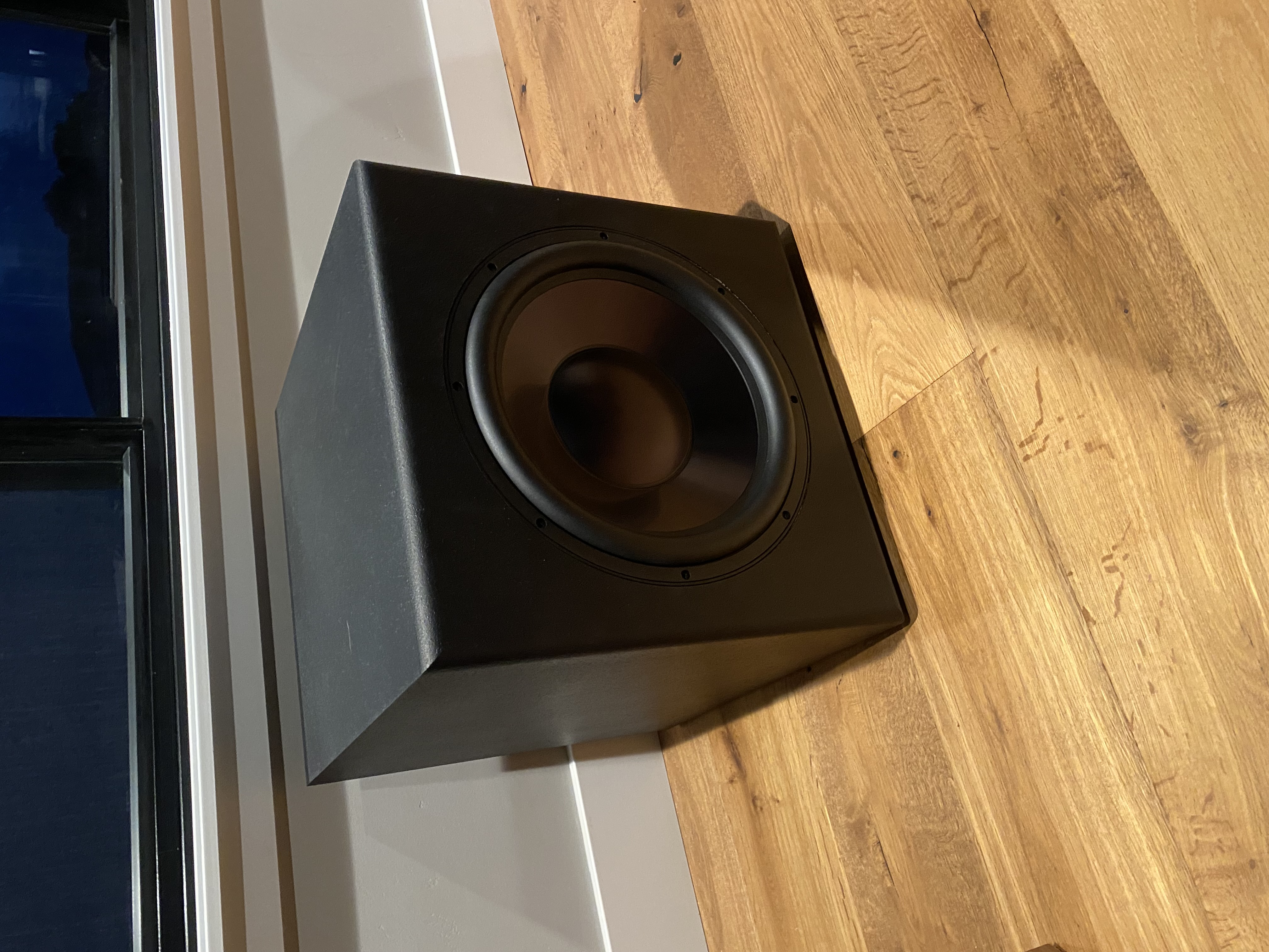

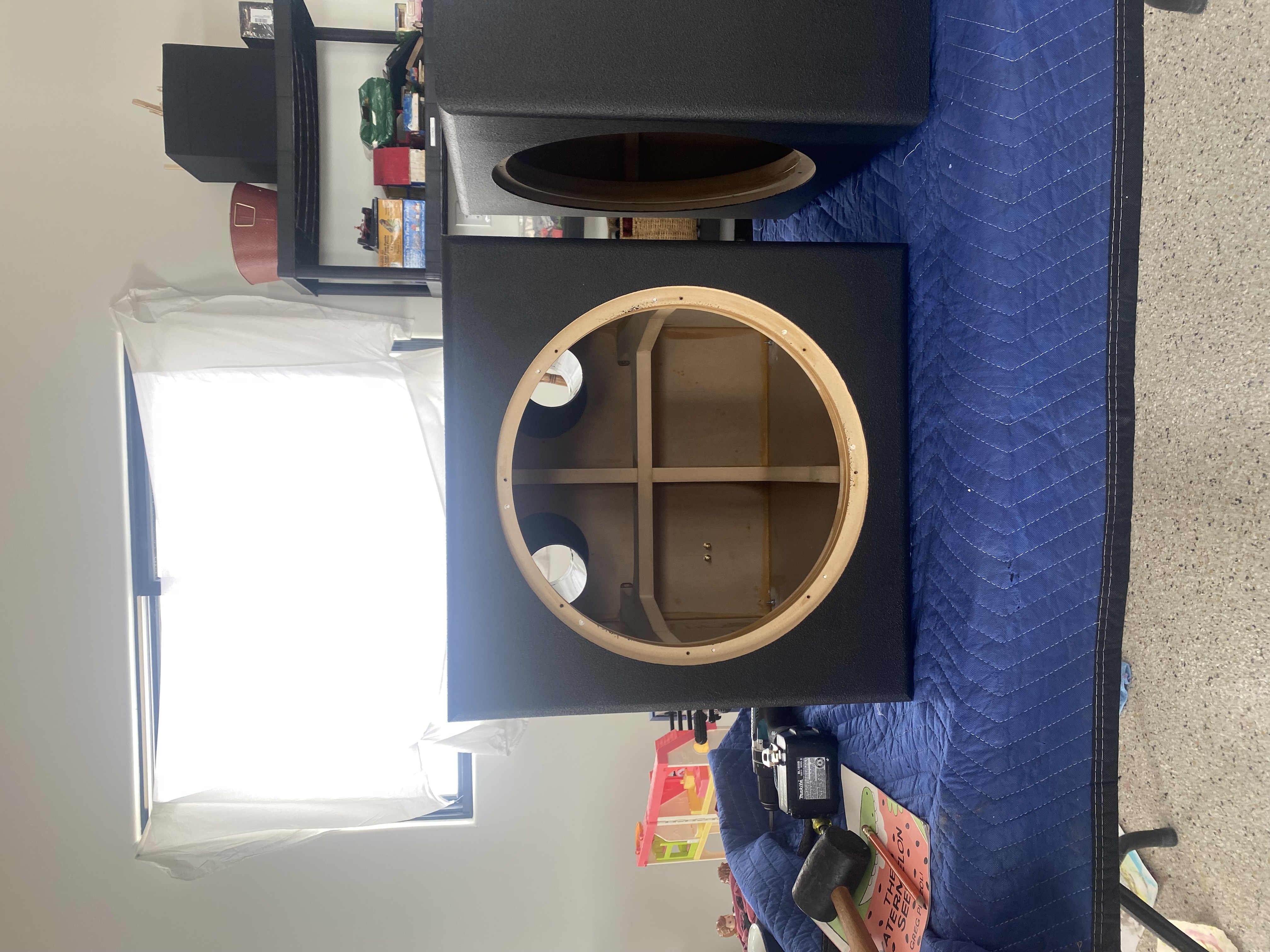

Finally, finished my flanking subs. I am using 2, 15" Drivers from Parts Express in ported enclosures.
For flanking subs, you said "just set it for low-pass 100Hz BW 12dB/Oct." For this I am going to use a miniDSP that I have from a previous project (LXmini from Siegfried Linkwitz). It will be super easy to set the recommended low pass filter in the DSP. Should I set a high pass filter as well?
