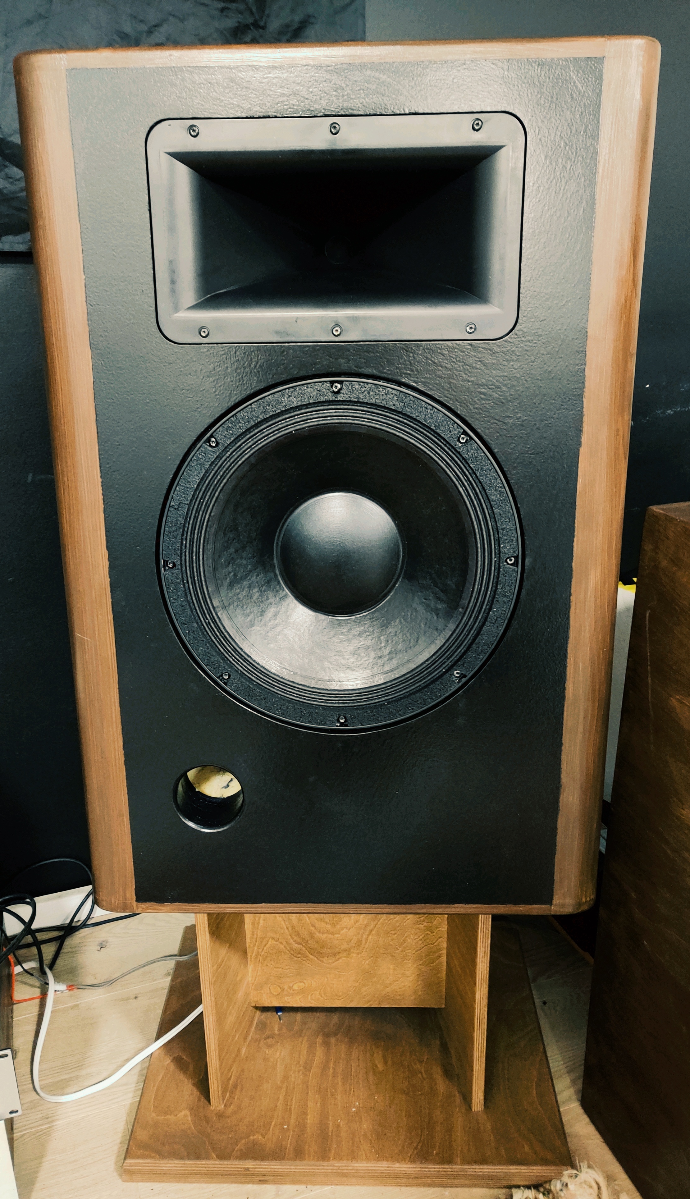

Here´s a few thoughts on my updated 3Pis.
The 12PLB100 seems to be really stiff and probably will benefit from getting some hours on them. What I feel is the biggest change is the tighter bass and control over bass especially on higher volumes.
I feel that with these it can get really loud easily without even noticing it. They just keep sounding really good and clean Smile
Next up is recycling the Delta 12.s for flanking sub duty. Eminence recommends a ported box around 100L with an F3 of 44Hz. They do however state that it´s for low power 125W. I hope they will be able too keep up and I won´t blow them. Steep highpass filter set to 35Hz will be used to protect them.
Any thoughts on this, better box suggestions are welcome.
Mathias

Re: 3pi update / 6pi build [message #93020 is a reply to message #93019] Tue, 26 January 2021 11:19 Go to previous messageGo to next message
That's an excellent idea. Highly encouraged!
I think you would probably get deeper bass from a driver like the LAB12. But flanking subs are mostly for the upper midbass anyway, for providing baffle step correction, and for mitigating SBIR and higher-frequency room modes. It's a helper woofer, sort of making the loudspeaker system into a three-way with the woofer being detached. And for this purpose, I think the Delta12LF tuned as you've described will probably work pretty well.
Your three Pi loudspeaker looks wonderful, by the way. Kudos!
Re: 3pi update / 6pi build [message #93021 is a reply to message #93020] Tue, 26 January 2021 11:43 Go to previous messageGo to next message
Mabob is currently offline  Mabob
Messages: 23
Registered: December 2017
Location: Finland
Thanks Wayne!
I will use the Deltas as I have them and enjoy my 3Pis until the 6Pis are done. For deeper bass I'll try to incorporate existing TableTuba tapped horn. We´ll see how that goes.
I did the enlargement for 12PLB with an overhand router and a homemade jig. That was not the best way to go, if I´d do it again I would instead make a template and use a router bit with bearing. End result was scratched cabinet that had to be repainted, did some bad masking and they aren´t what they used to be.
But hey! At least they sound great! 6Pis will be walnut veneered finished with danish oil.
Big thanks for making this update available to us not so pro DIY builders!
Mathias
