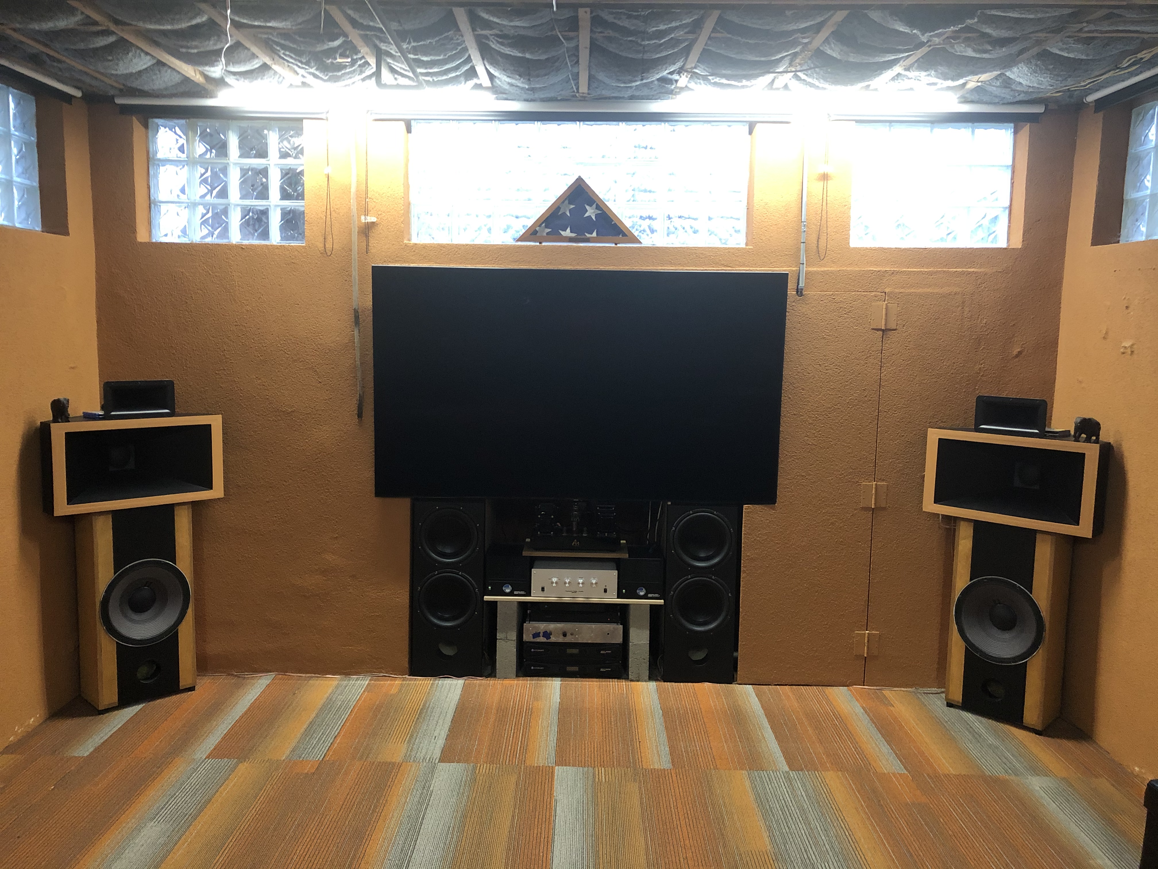

The entire ceiling is an 8" thick x 14.5' wide x 28' long bass trap. Ive had the subs distant and it makes absolutely no difference.
Walking around the room with test tones (or music), there are no discernible nulls or modes that can be heard. The room is generally flat no matter where the subs are located.
I put them front and center for practical reasons,
and for the use of low frequency extension alone. They just happen to be flanking the corner horns (towards the inside not outside) Also they are in an alcove so the front baffles are flush with the front wall.
Ill try to post a pic.
When I had the system upstairs (exact same dimensions but no bass trapping) it was a totally different story, and the distant (and flanking) subs made all the difference. Really evened out the bass response in the room.
To my ears the flanking subs still helped the most. But then the distant subs helped really even it out the rest of the way.

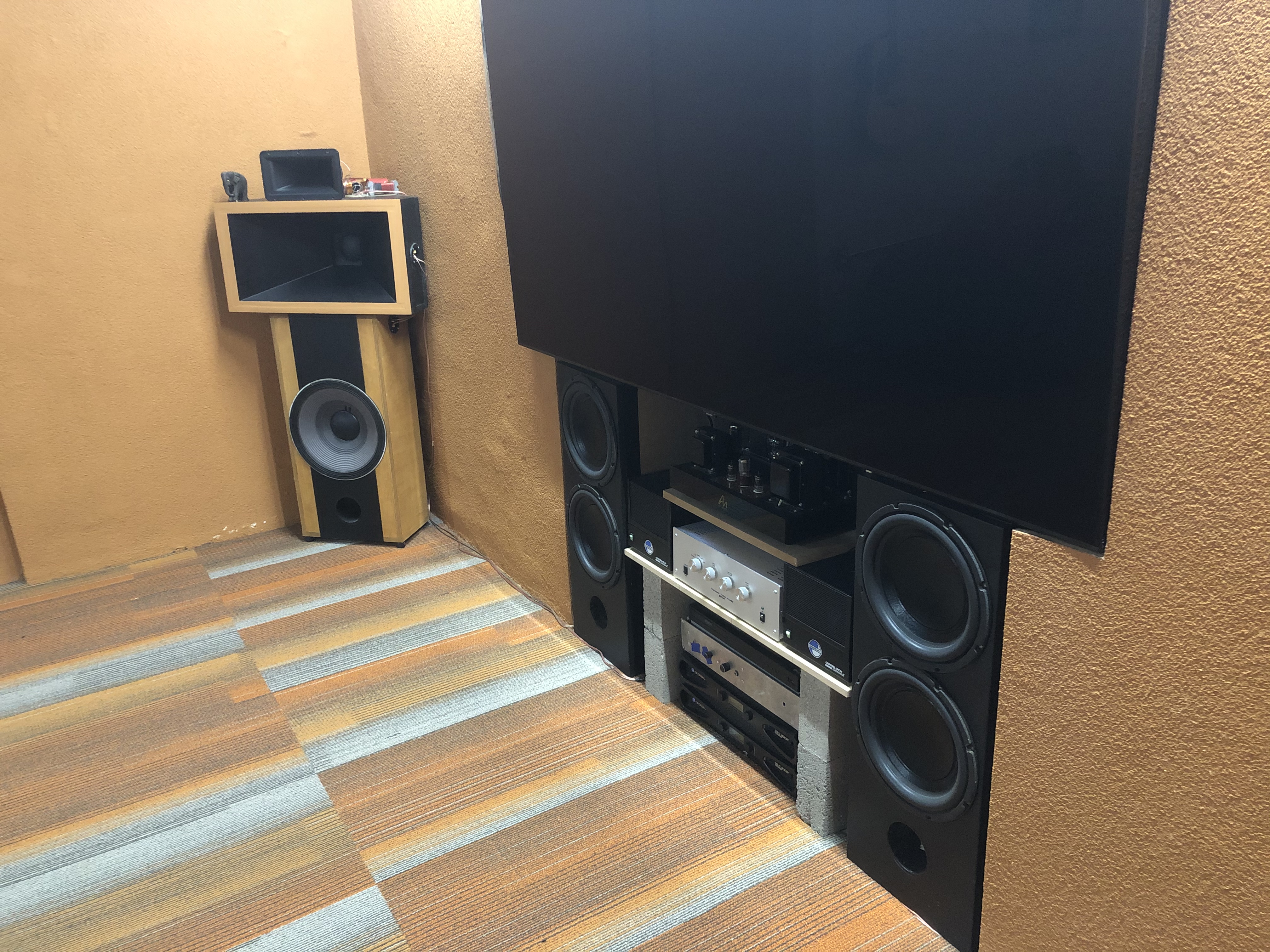

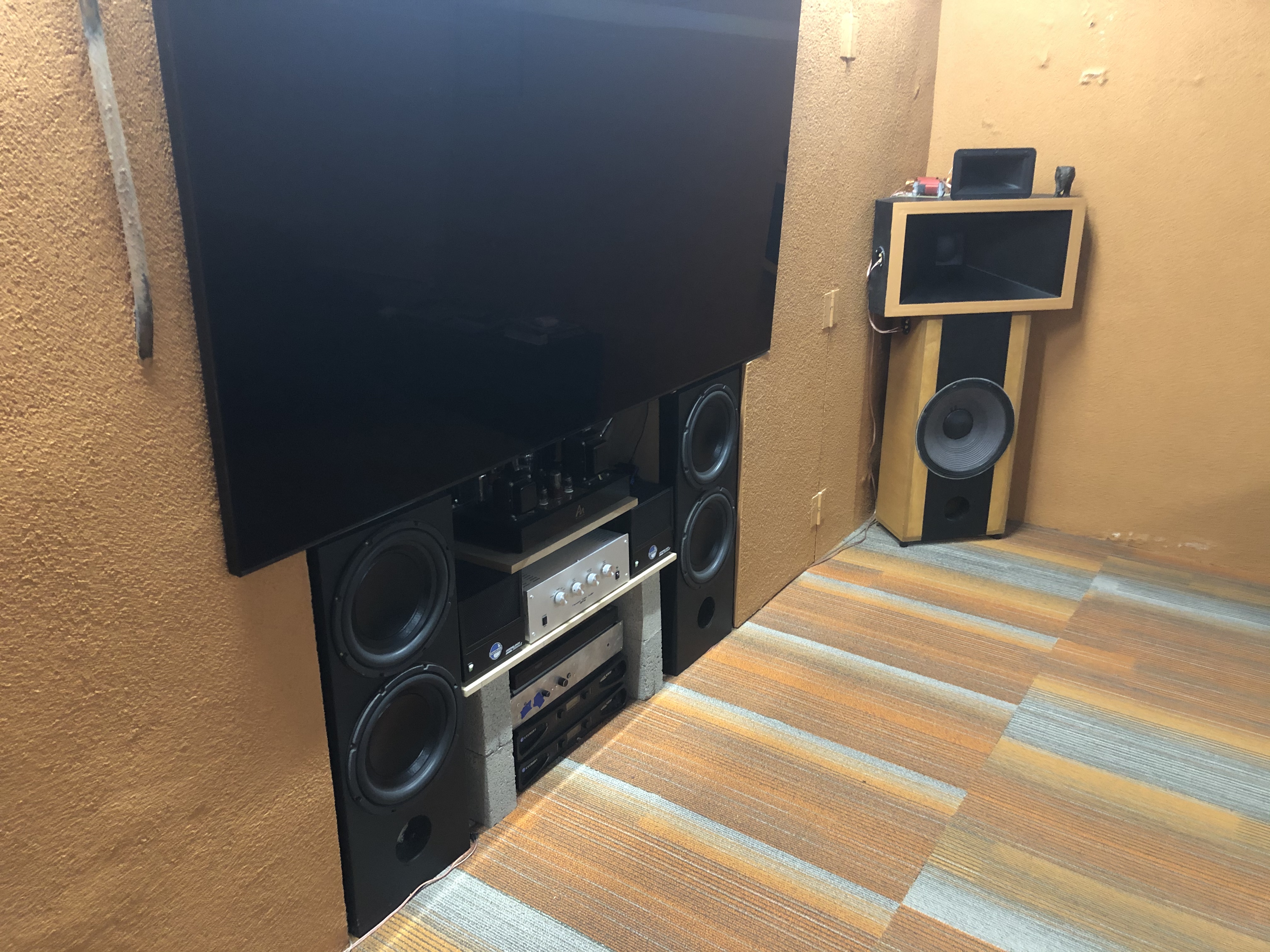

I had mentioned posting some pictures showing the subs front baffle flush with the front wall.
When my system was upstairs these four subs were spread around the room, with two of them flanking my four pi's.
The last pic show the ultra touch (cotton) insulation in the ceiling.
The dimensions of this room are14-1/2 feet wide x 28 feet long x 9 feet high.

Your room sound like it's great. In the 4 rooms (in 4 different houses) we've tried multiple/flanking subs it's improved the sound each time. I'd begun to believe it would work in every room. Obviously that's wrong.
Maybe your room is why the front firing bass bins and the 7 pi doghouses sound similar. It's my only guess, and it's only a guess.
Nice equipment rack. ANK amp on top, a couple of Oddwatt monoblocks to the side, your new VTA preamp in the middle and two crowns on the bottom. The only one that's hard to figure out is the box on top of the Crowns. And no idea what drivers are in the subs.

The silver component on top of the Crown amps is the DAC,
and the thin, low profile black box on top of that is the 4K player.
I use a cheap, little Optical Audio Cable switch box (3 source) selector,
to choose from either the TV or the 4K player......to feed the DAC.
This way I can use the sound system for any purpose- steaming, 4K Blu-ray,
or live broadcast cable, which I'm about to 86...
