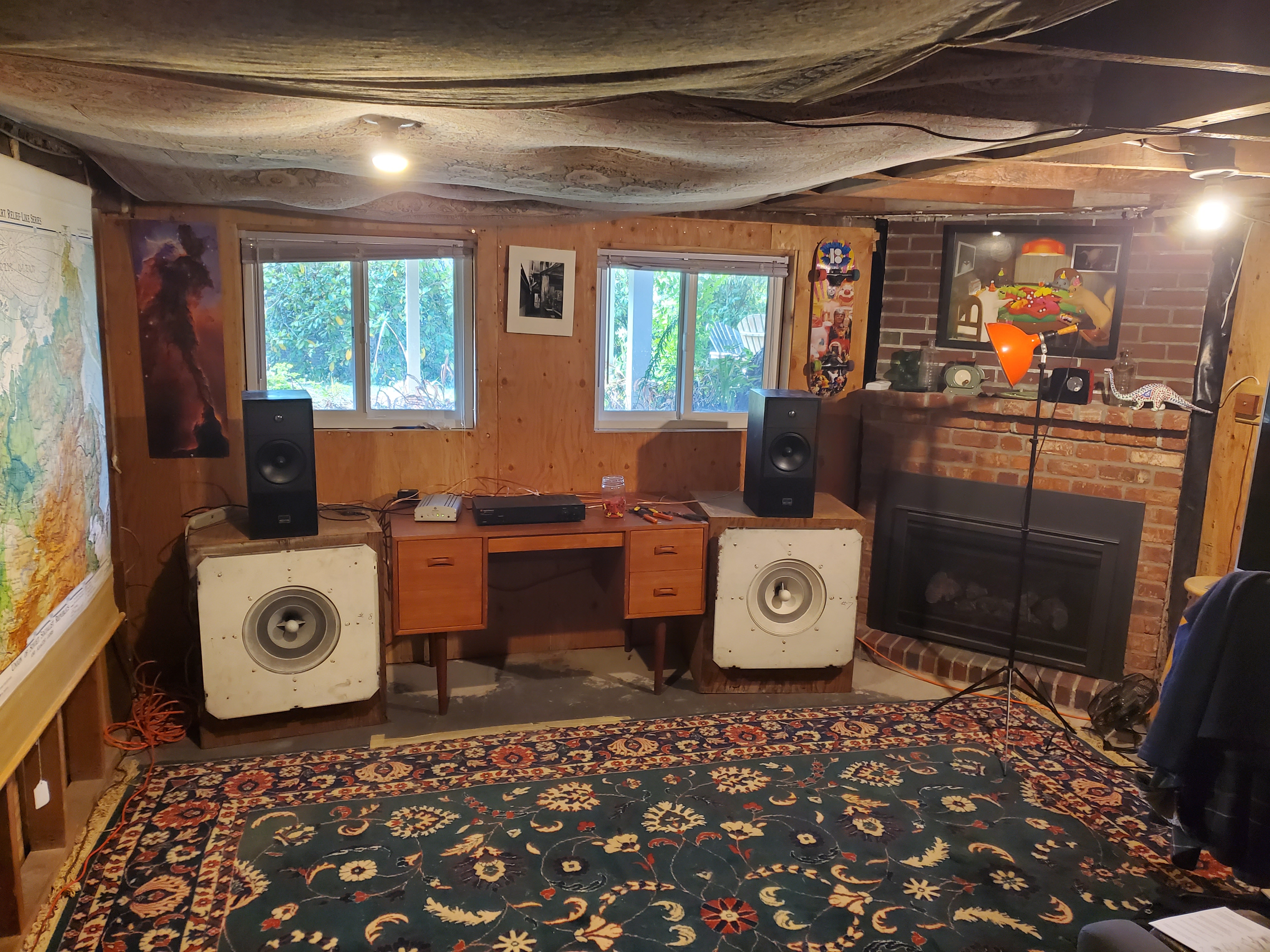

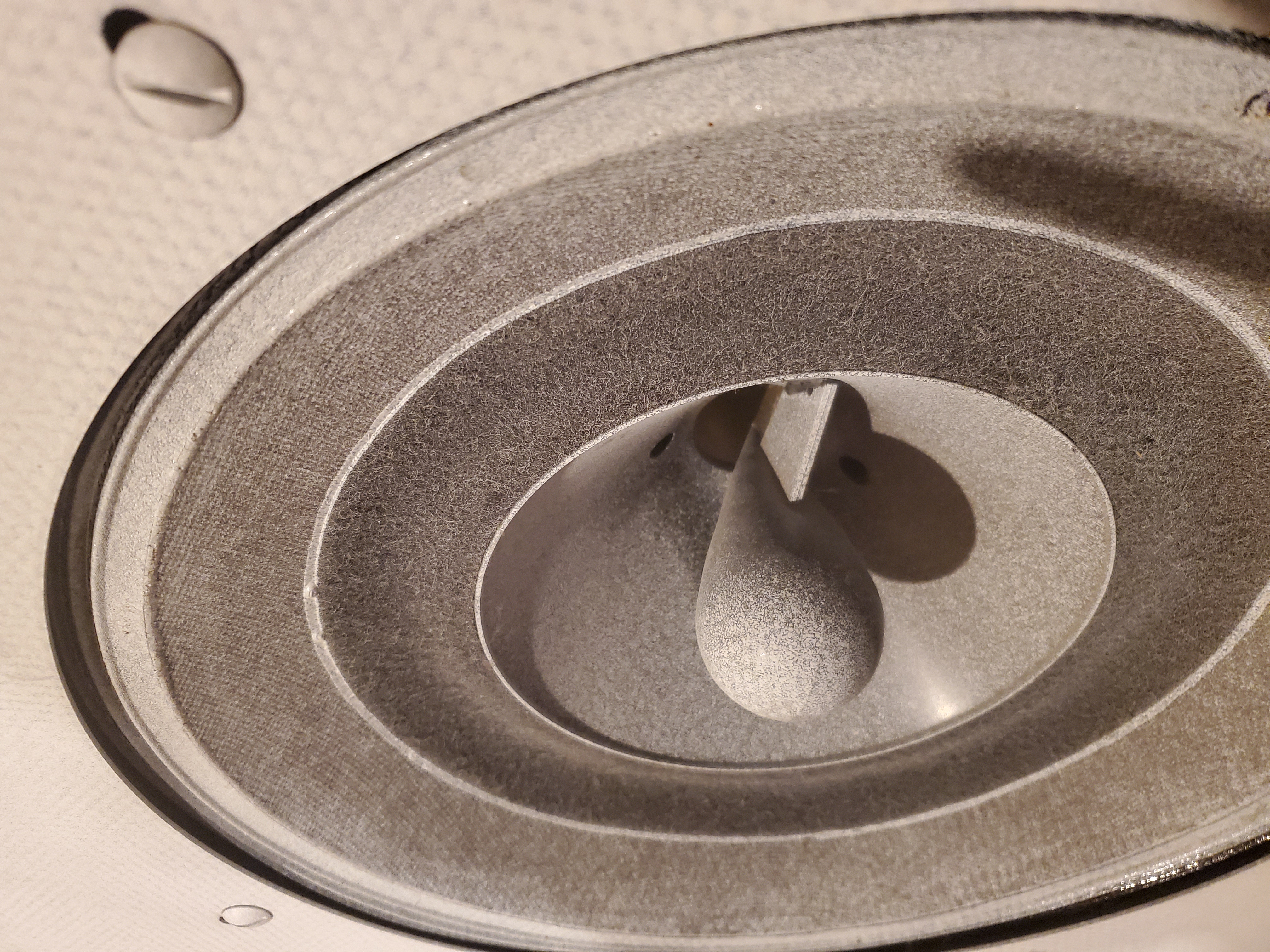

I've been playing with a pair of Altec 615 coaxial speakers I came across. These are commercial version of the much more famous 604. Their big weakness is the tweeter horn.
http://www.audioheritage.org/vbulletin/showthread.php?11304-The-Altec-615B-Duplex-Coaxial
There is a high frequency "hole" in line with the center plug. Its very HF but very noticeable with pink noise.
What if I replaced this horn with the H290C? I would need to figure out how to mount the H290C from the diaphragm side and trim off the mounting flange. Assuming I can pull off a nice solid mounting scheme, is this a bad idea for reasons I'm not thinking about?
