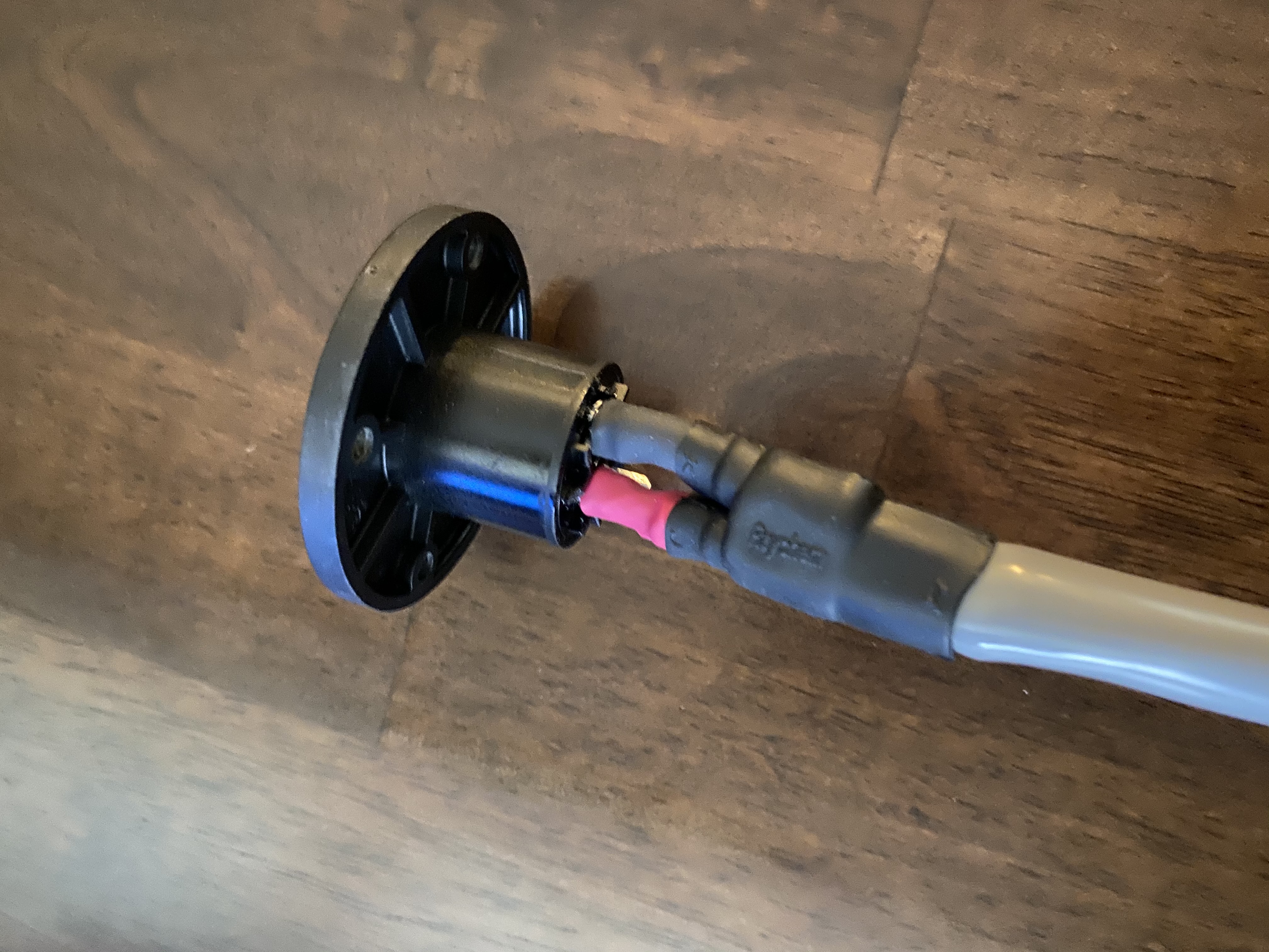

Next was to solder the Belden 1313A to the Neutrik speakON and install into the cabinet.
/forum/index.php?t=getfile&id=2628&private=0
