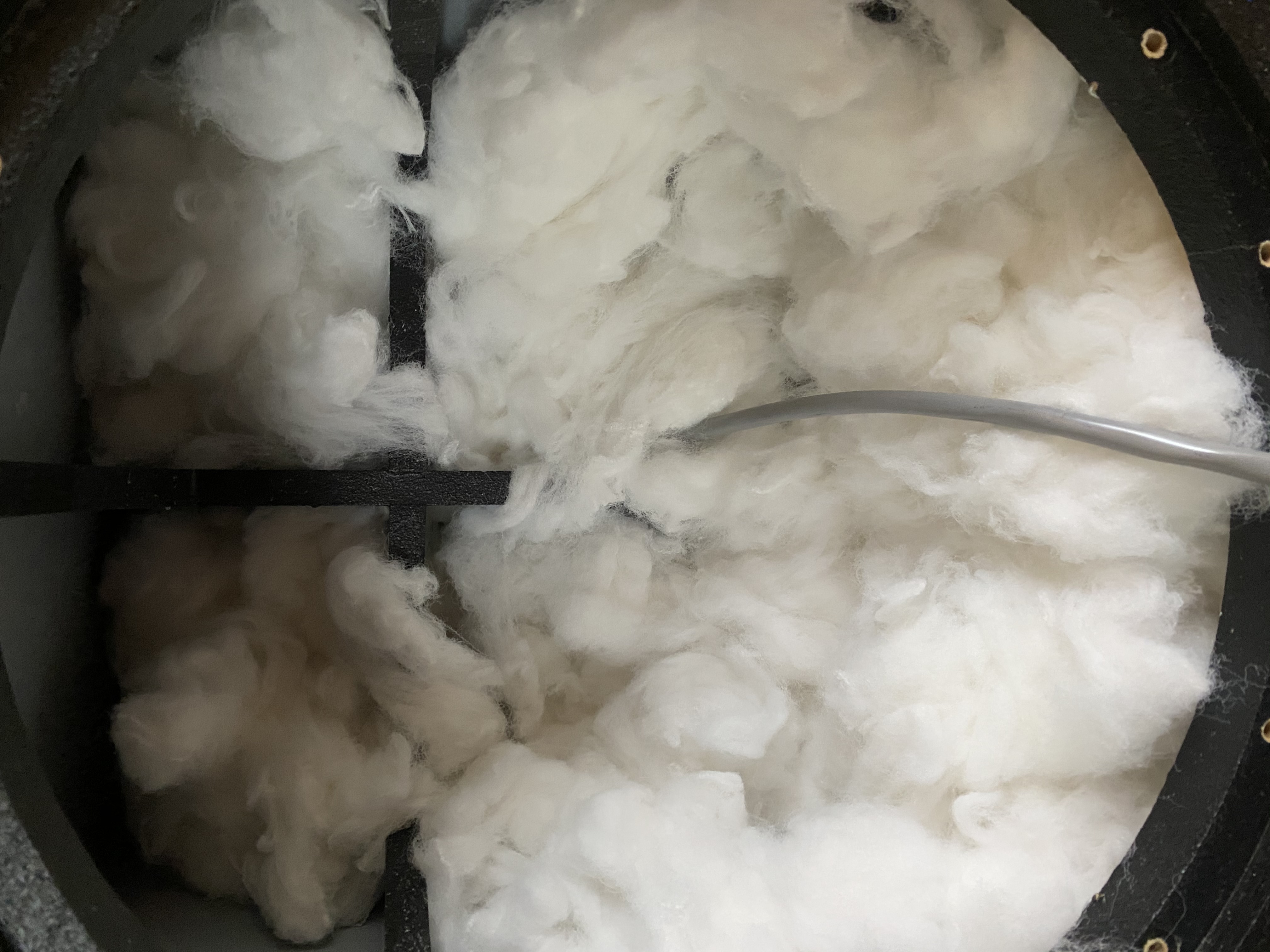

Stuff it!
/forum/index.php?t=getfile&id=2629&private=0
