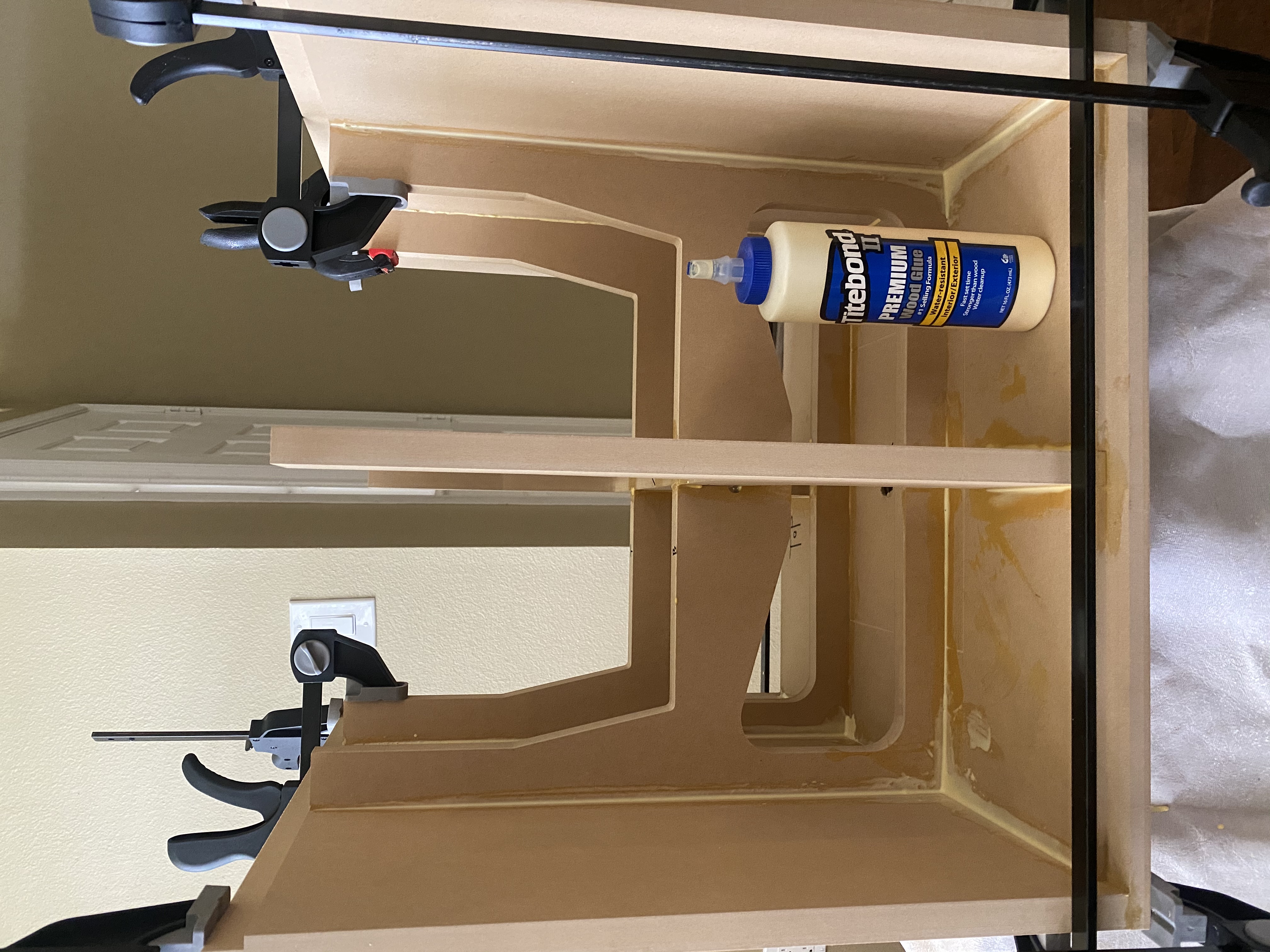

/forum/index.php?t=getfile&id=2616&private=0
Starting Assembly

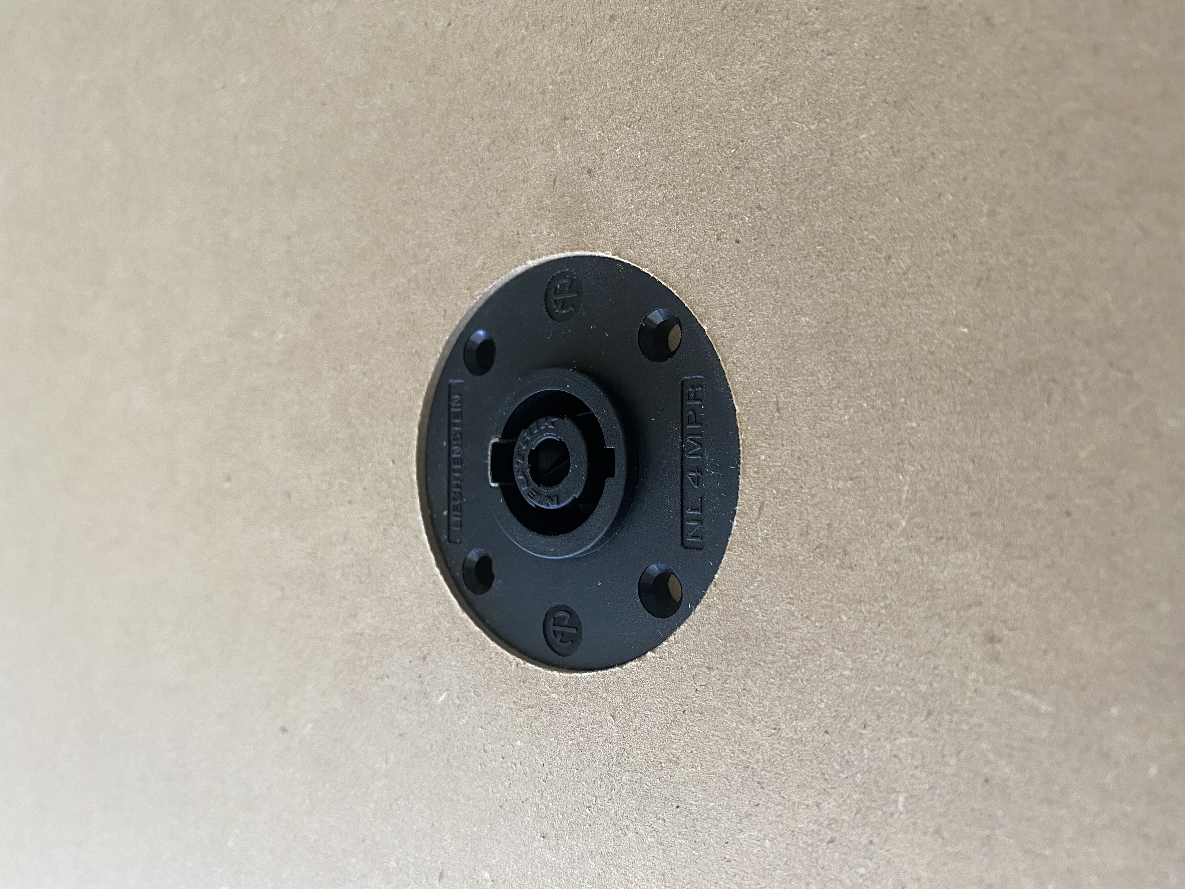

Had to install the Neutrik connector. Thanks to TomS for the suggestion of the 2" Forstner bit.
/forum/index.php?t=getfile&id=2618&private=0

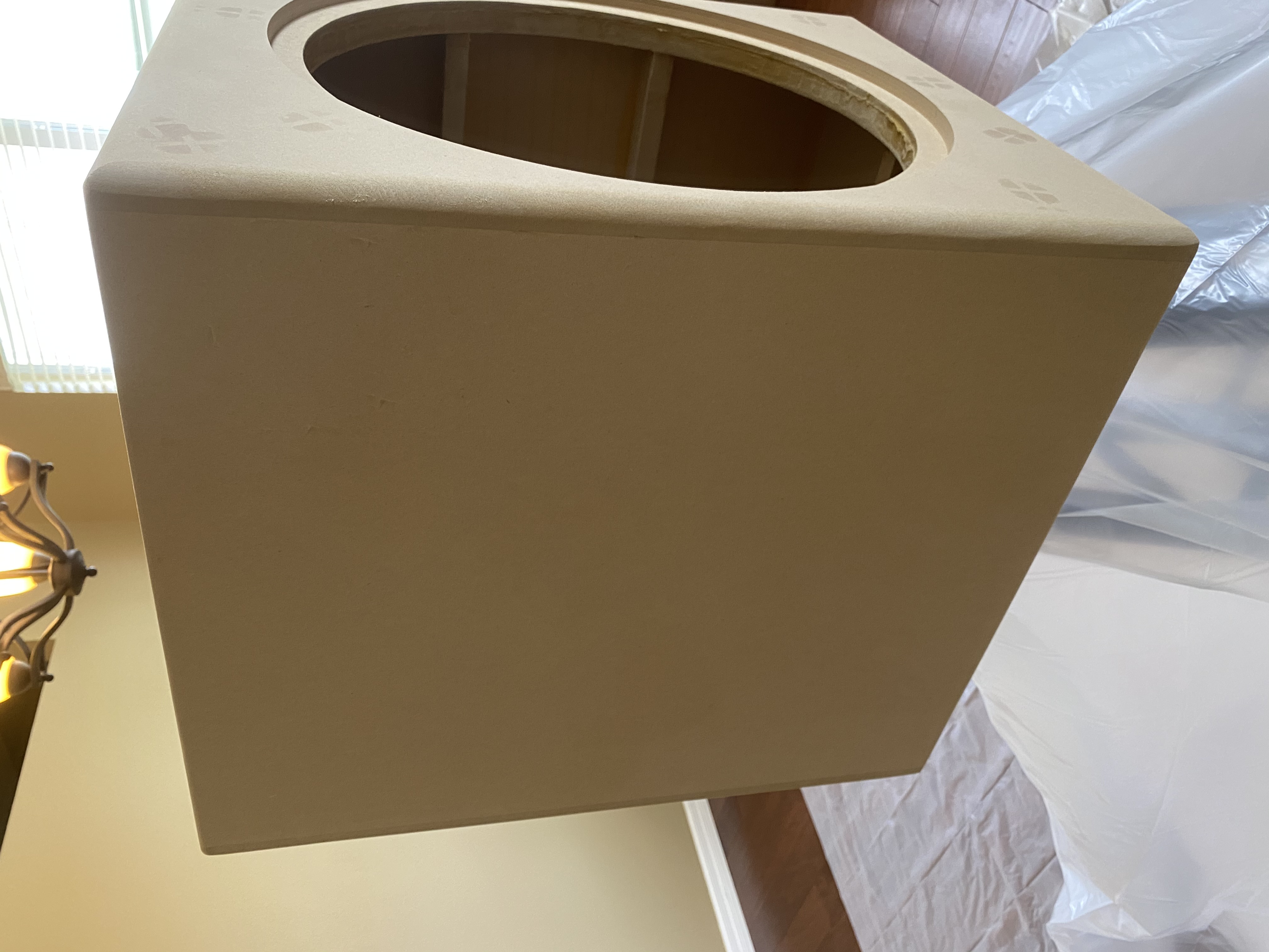

Next was some sanding. I chose to use an orbital sander with 80 grit to knock the overhang of the baffle off and really get the MDF smooth. As my previous painting training has taught me the prep work is the dirtiest and certainly the most important for the final finish. I used BIN Primer that I had tinted as a white base with black Duratex going over didn't make any sense to me. I did one coat of BIN then sanded with 120 grit and repeated.
/forum/index.php?t=getfile&id=2619&private=0

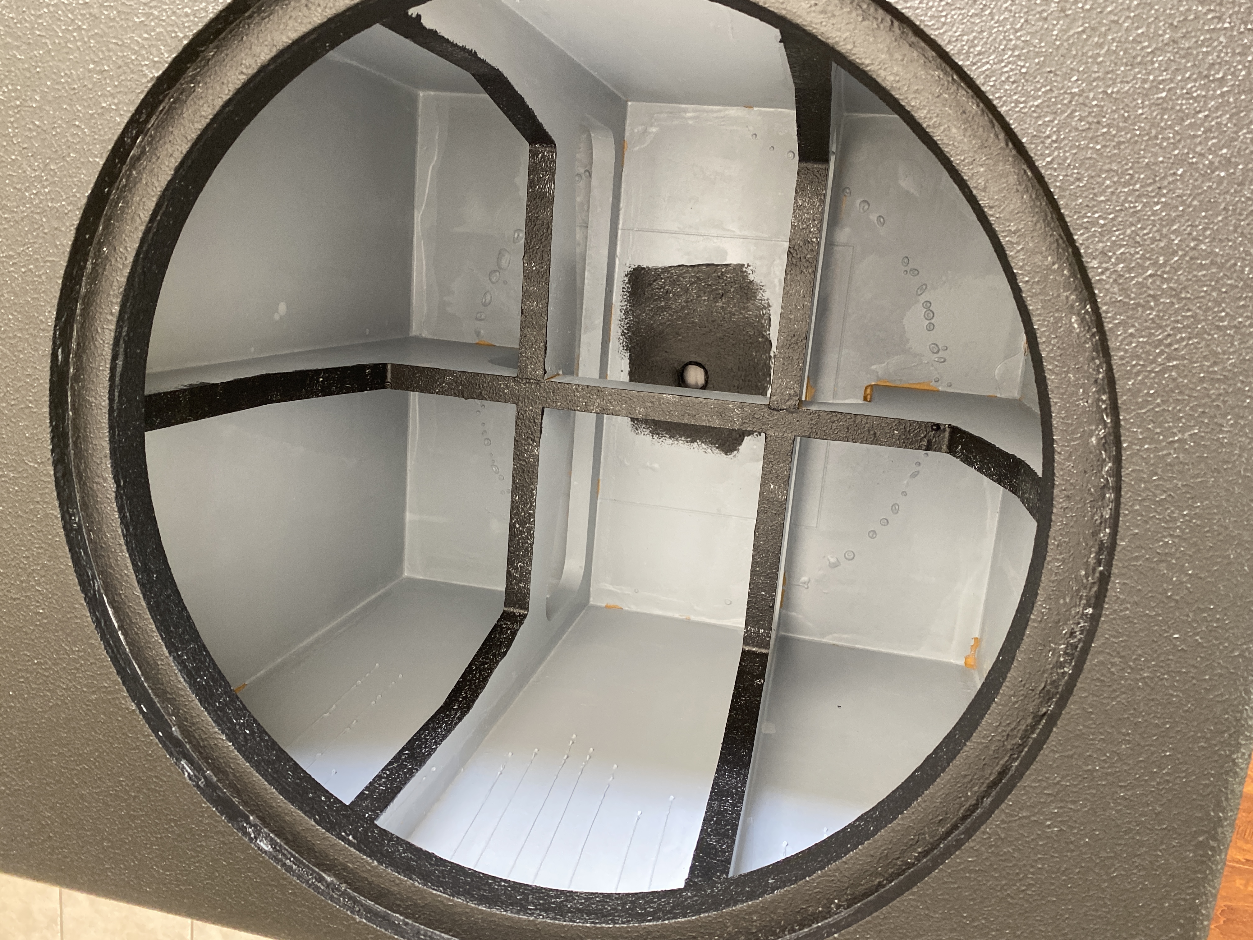

I like to finish the inside. If it was ever sold and someone opened it, I like it to look finished. Also, it really cuts down on the possible MDF dust and just makes it so much nicer to me. How crappy is it to open a speaker and see it raw and cheesy inside? Yuck. Doesn't take much more effort to make it look a bit nicer and an advantage of diy since you're not against the Excel Sheet of the bottom line.
/forum/index.php?t=getfile&id=2620&private=0

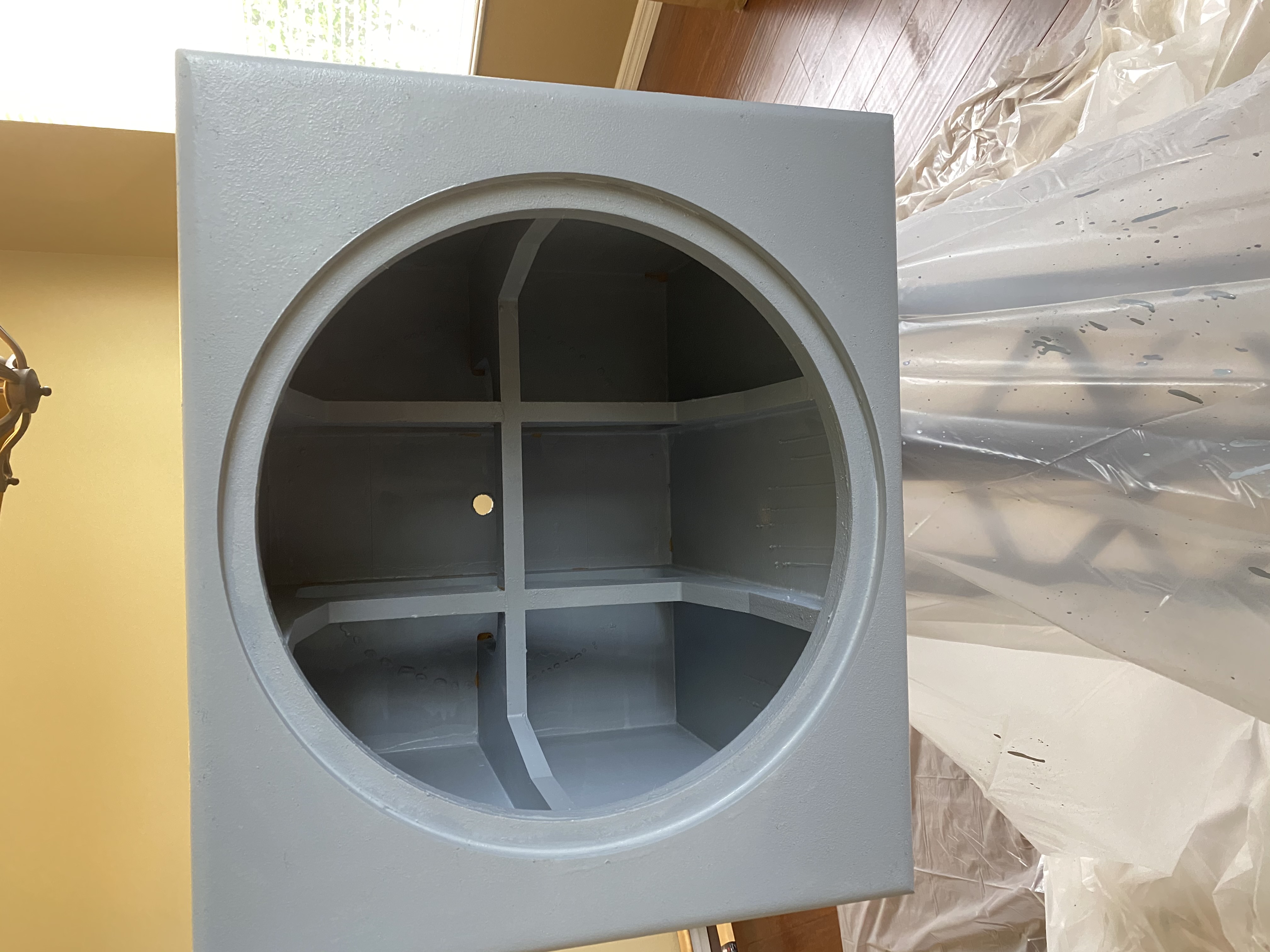

/forum/index.php?t=getfile&id=2622&private=0
/forum/index.php?t=getfile&id=2623&private=0
