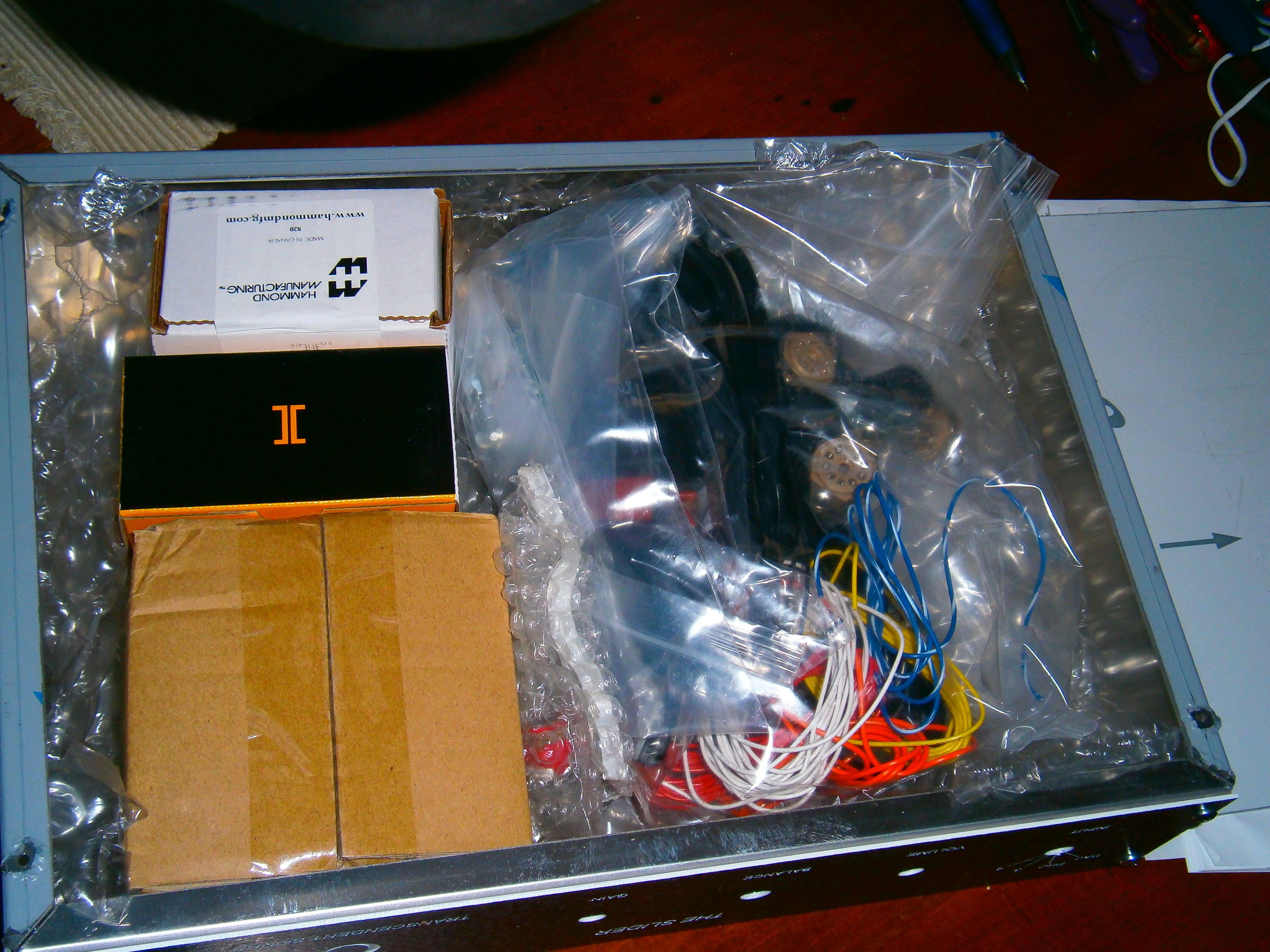

A knock on the door and a delivery personally via an electric bicycle with a newsboy basket on the front. On my front porch, a pony tailed gent that looks to take care of himself. I'm in the presence of an eccentric creative genius. I call him now, The Wizard of Waldo. Waldo is a section of the city developed in the 1940's when it was a suburb. The wizard is Bruce Rozenblit. And the box of wonder within the shipping box.

Putting in the hardware. A dainty handed lady could have done it in a half hour. But an aging wiener fingered guy like myself took hours.

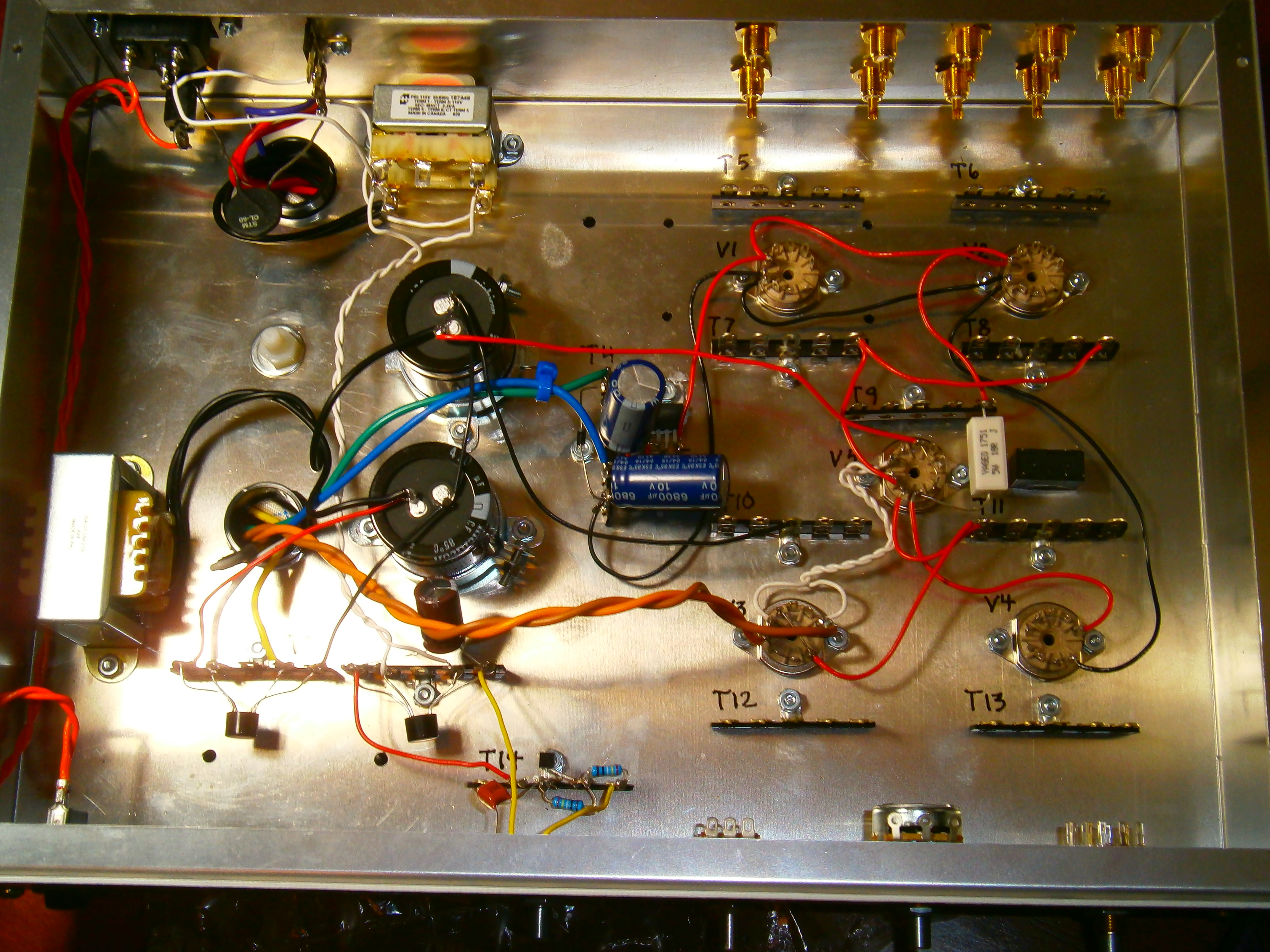

About halfway done, whew, doing point to point wiring is time consuming and sometimes exasperating getting wire crimped over the solder lugs. It's been close to 20 years since I'd done anything like this. It becomes a learning curve again with the soldering skill. And...those wiener fingers again, makes things much harder.
