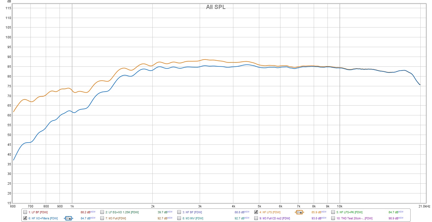

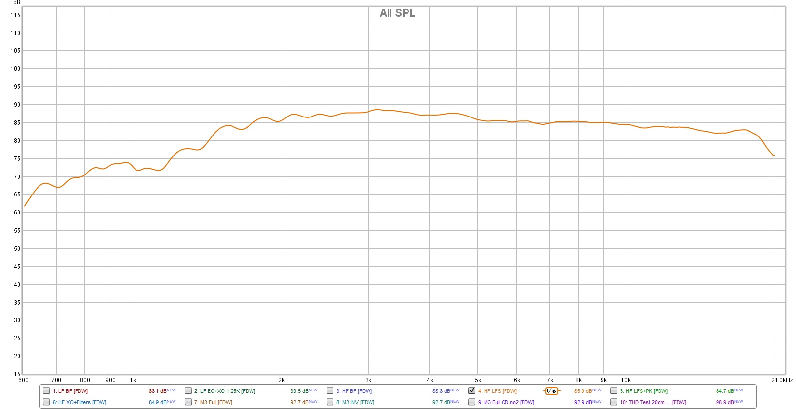

Thank you very much. I will try to update my experiment XO with Delta 12+PSD2013.
Yesterday, I tested the CDX-1747 on your waveguide. And the response is so smooth. THD is extremely low. Thank you for creating such a beast of waveguide. Your waveguide is one of the best (if not the best) 12" waveguides I have ever used and measured.
RAW Sound from CDX 1747 + H290C (@1m)
/forum/index.php?t=getfile&id=2578&private=0
RAW Sound from CDX 1747 + H290C + 2 simple bell filters + LR4 @1.25K
/forum/index.php?t=getfile&id=2577&private=0
