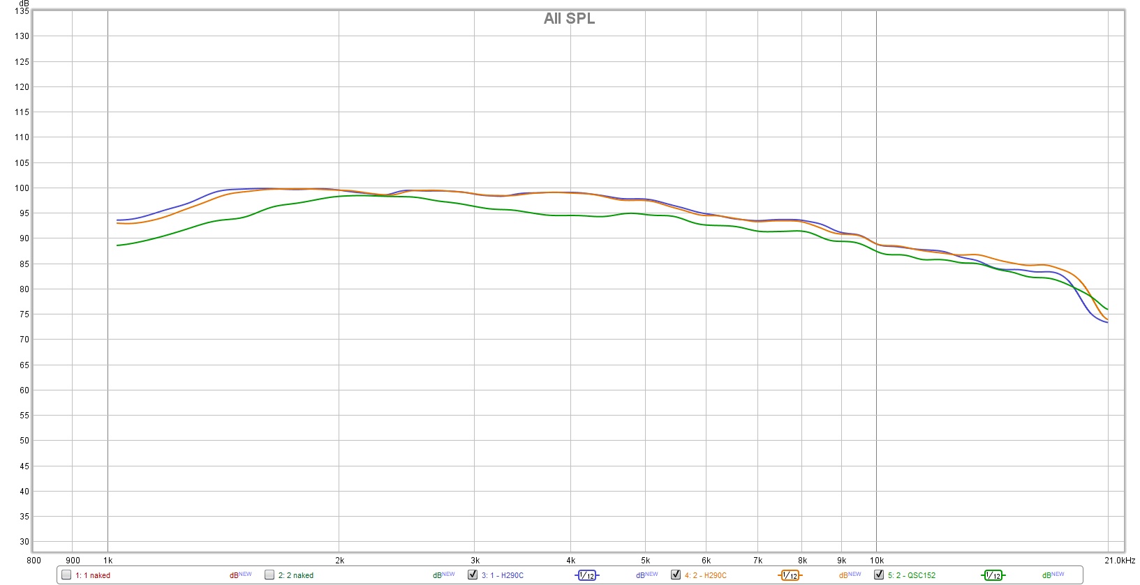

CDX 1745 + H290c/QSC152
Frequency response with H290C and QSC152, unit to unit variation
/forum/index.php?t=getfile&id=2575&private=0

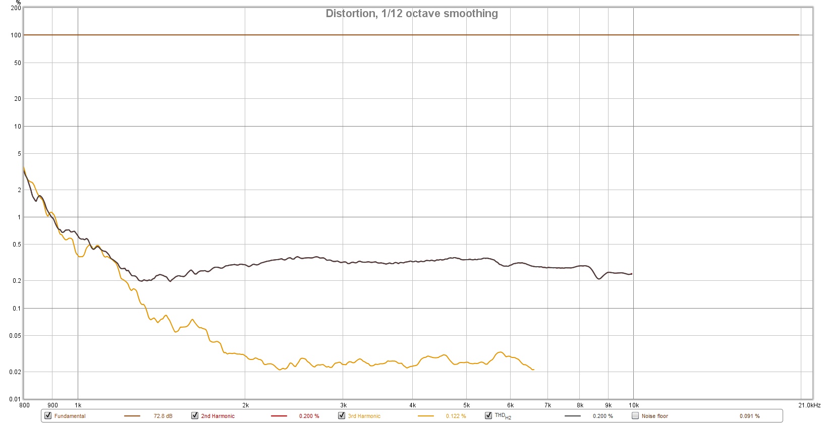

THD - I forgot that which SPL I measured in this graph, but I am sure that It is around 90-95dB / 1m.
/forum/index.php?t=getfile&id=2573&private=0

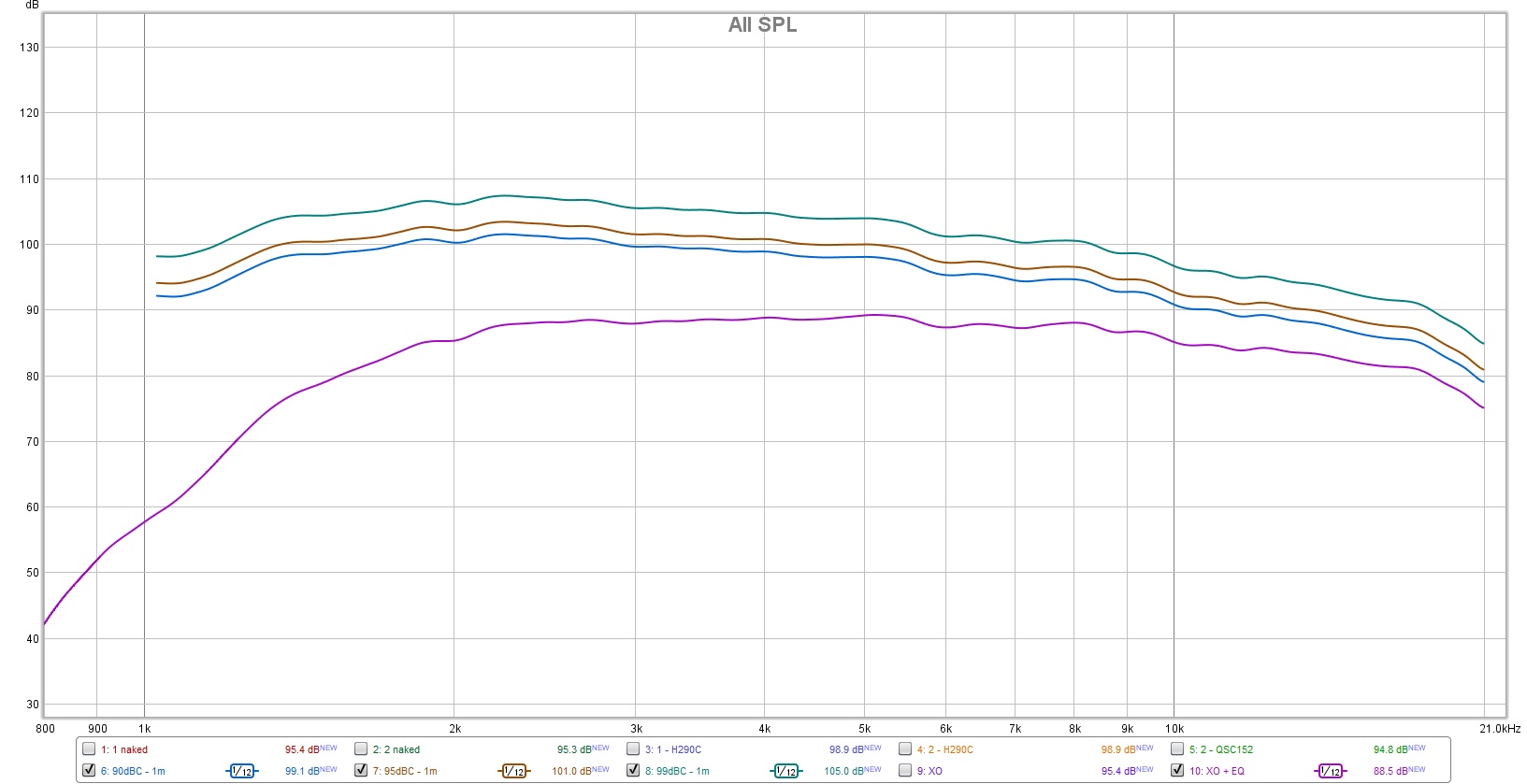

Power Compression test + Test crossover
/forum/index.php?t=getfile&id=2572&private=0

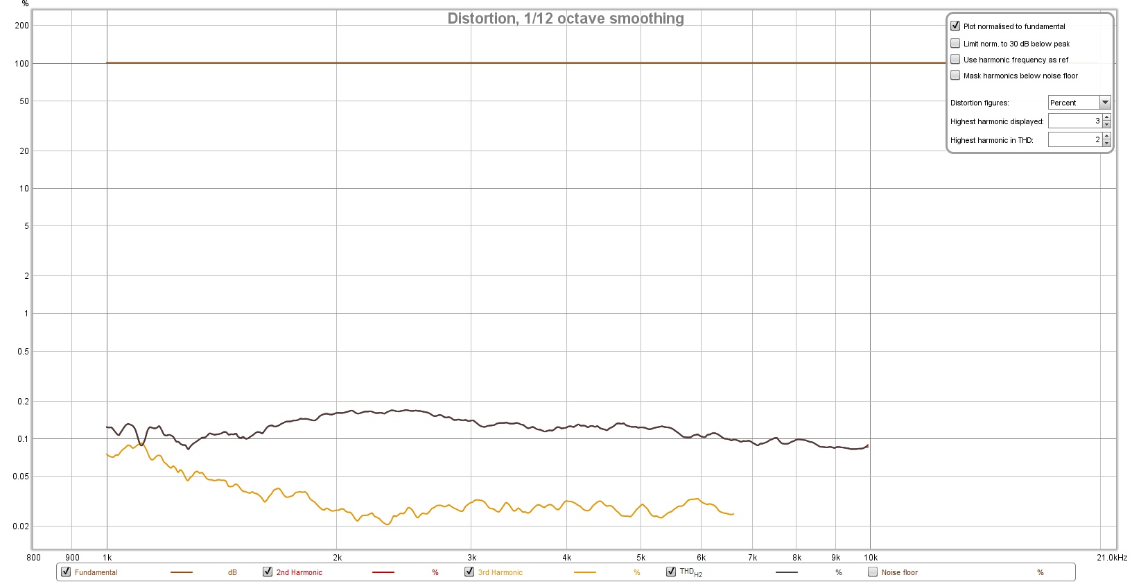

CDX 1745 THD with XO 1.2K LR4
/forum/index.php?t=getfile&id=2574&private=0
