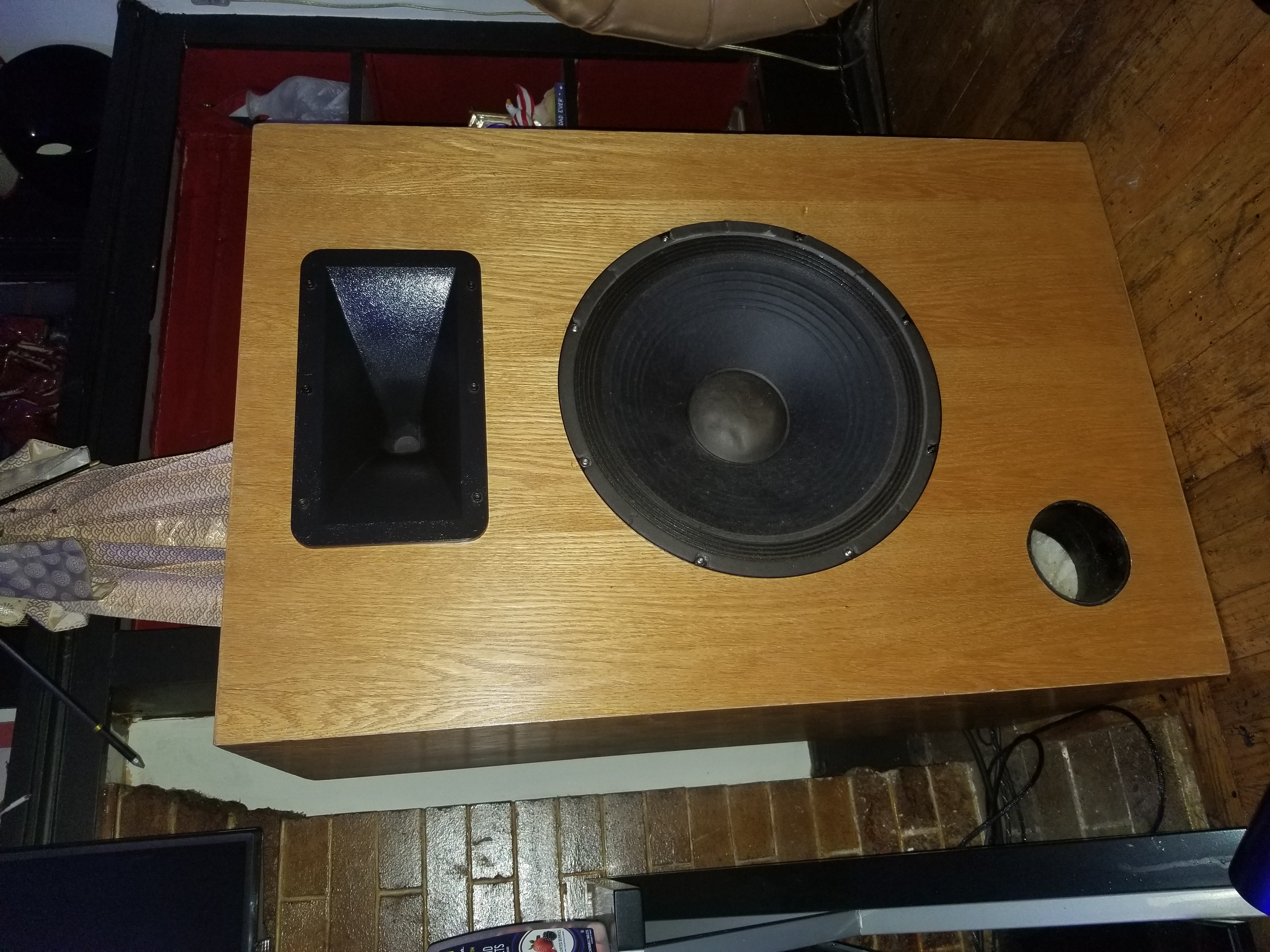

Hello my name is Angel Alameda and I live in Tulsa, Oklahoma. I bought a couple of speakers 2 nights ago which i believe are Pi Speakers. One has a 15 and a horn the other pair are towers and have a tweeter and 10 inch woofer. I hope these are Pi speakers I never had any but I remember reading about these speakers several years ago. I haven't taken these apart to check what drivers are in them. I might need to find someone who can help me make the emblems if at all possible if these are Pi Speakers. Thank you all in advance.

The top one is a two Pi tower and the bottom one is a three Pi speaker with Delta 12LF woofer and probably a PSD2002 on an old H290 radial horn. I'd update the horn to our H290C waveguide and possibly the midwoofer too. But they look to be in decent shape.
The H290C is a drop-in upgrade and costs only fifty bucks. It will require a crossover update, but that's just inserting a resistor and removing a capacitor so it's inexpensive and easy.

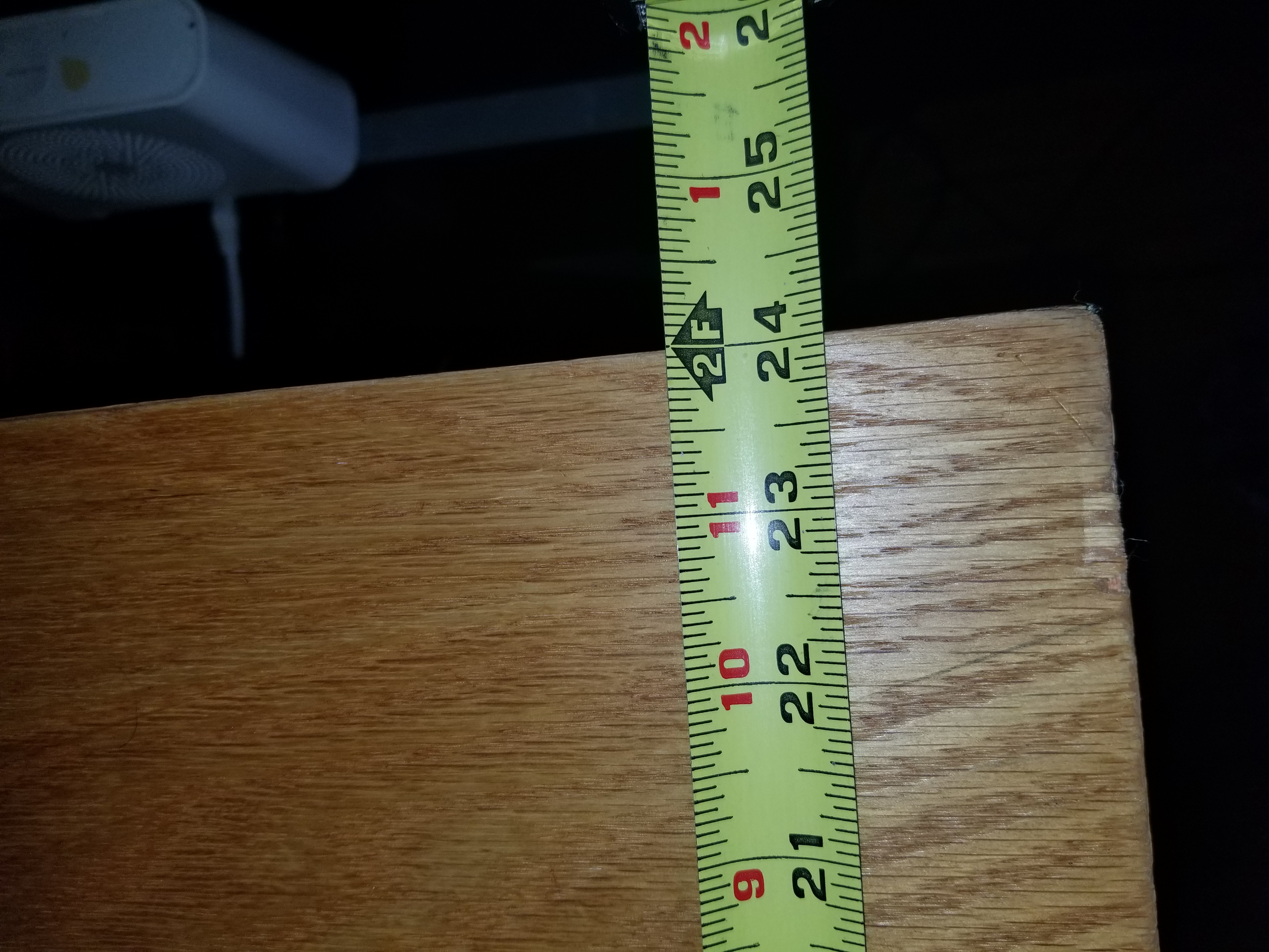

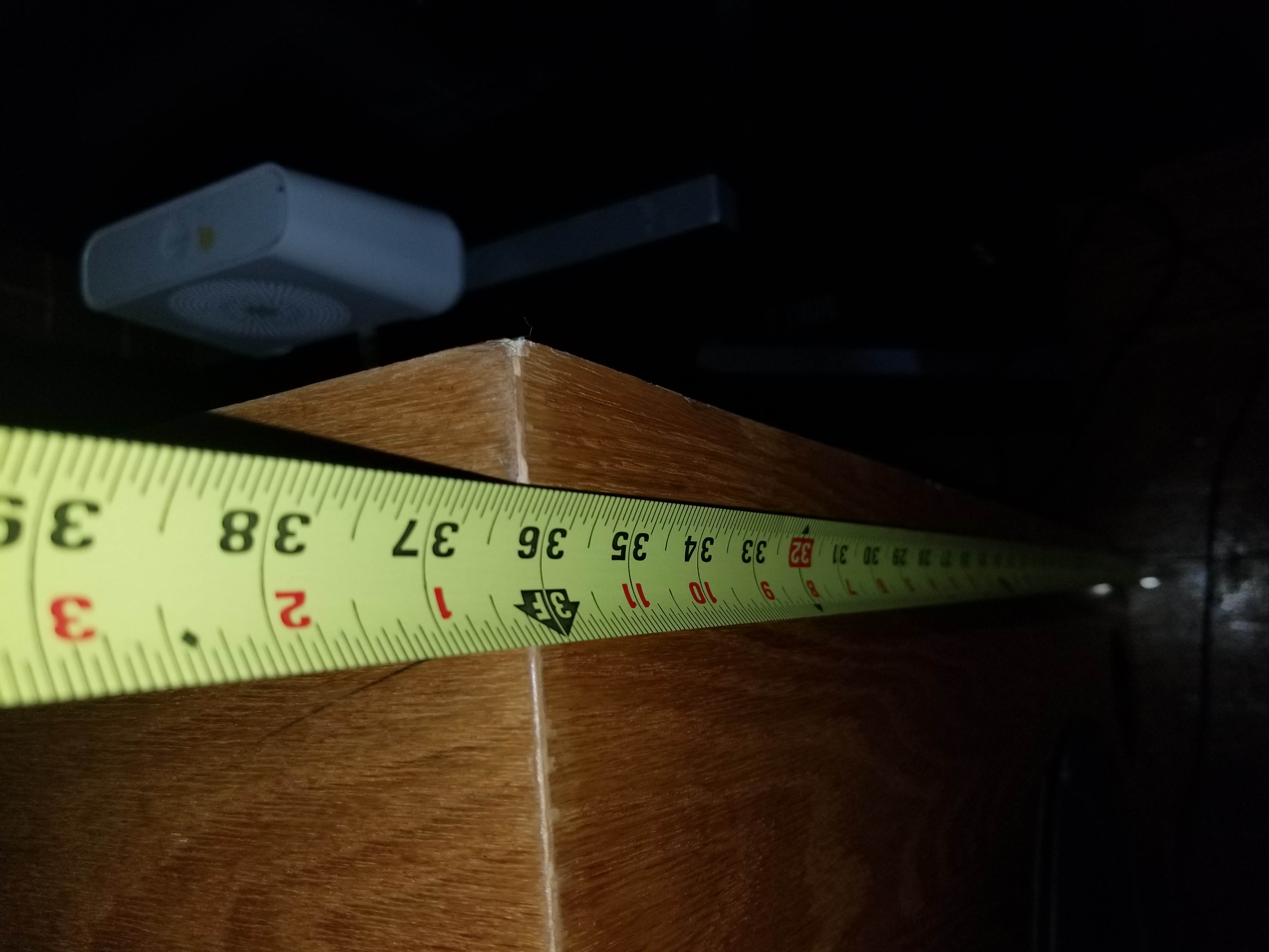

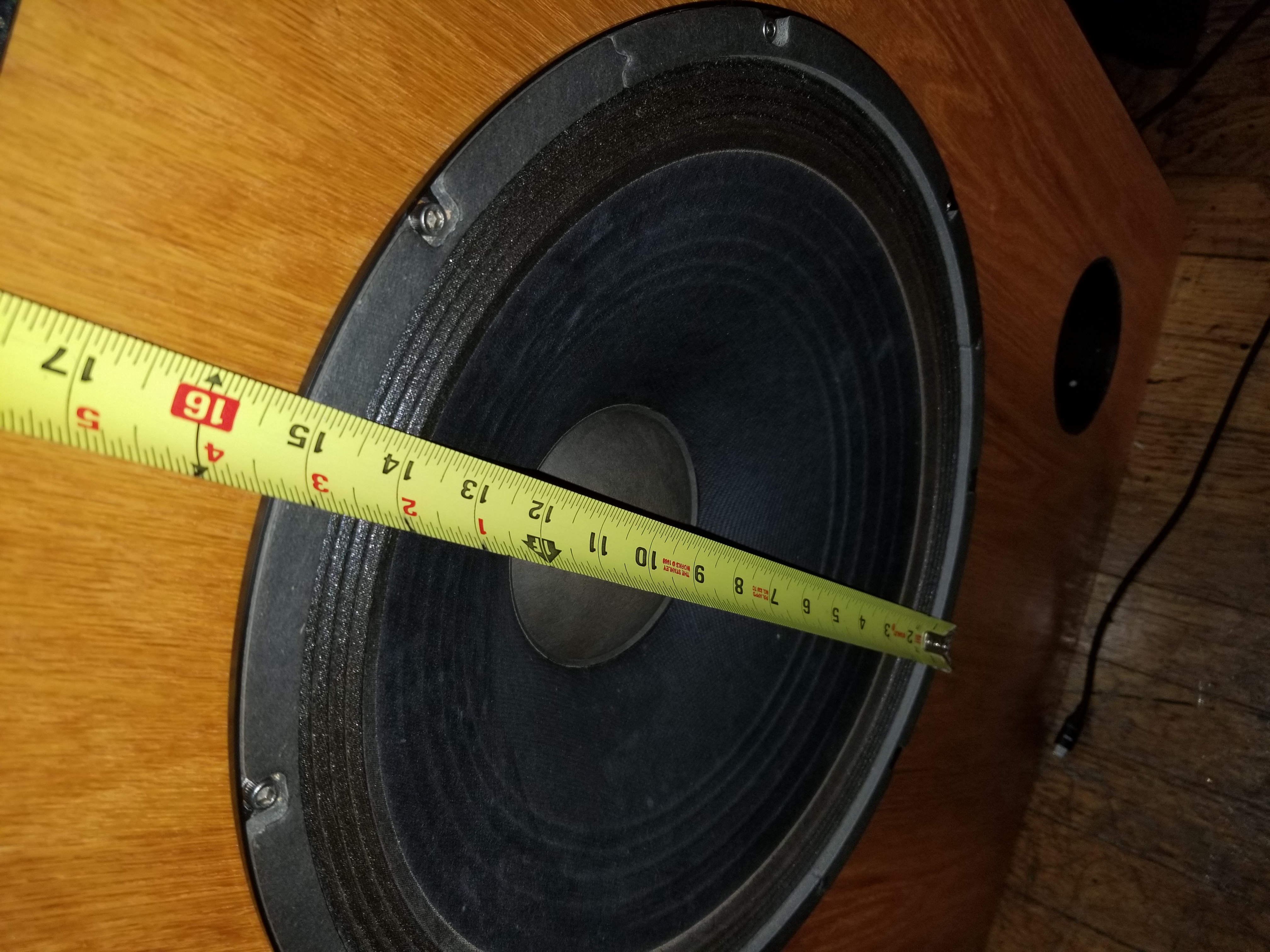

That's what I don't get Wayne - they are 15 inch drivers in there.

It might be an older model from the 1980s or 1990s. Back then, we used to make several series, like Thermionic, Theater, Stage, etc. Pull the midwoofer, read the label and report back.

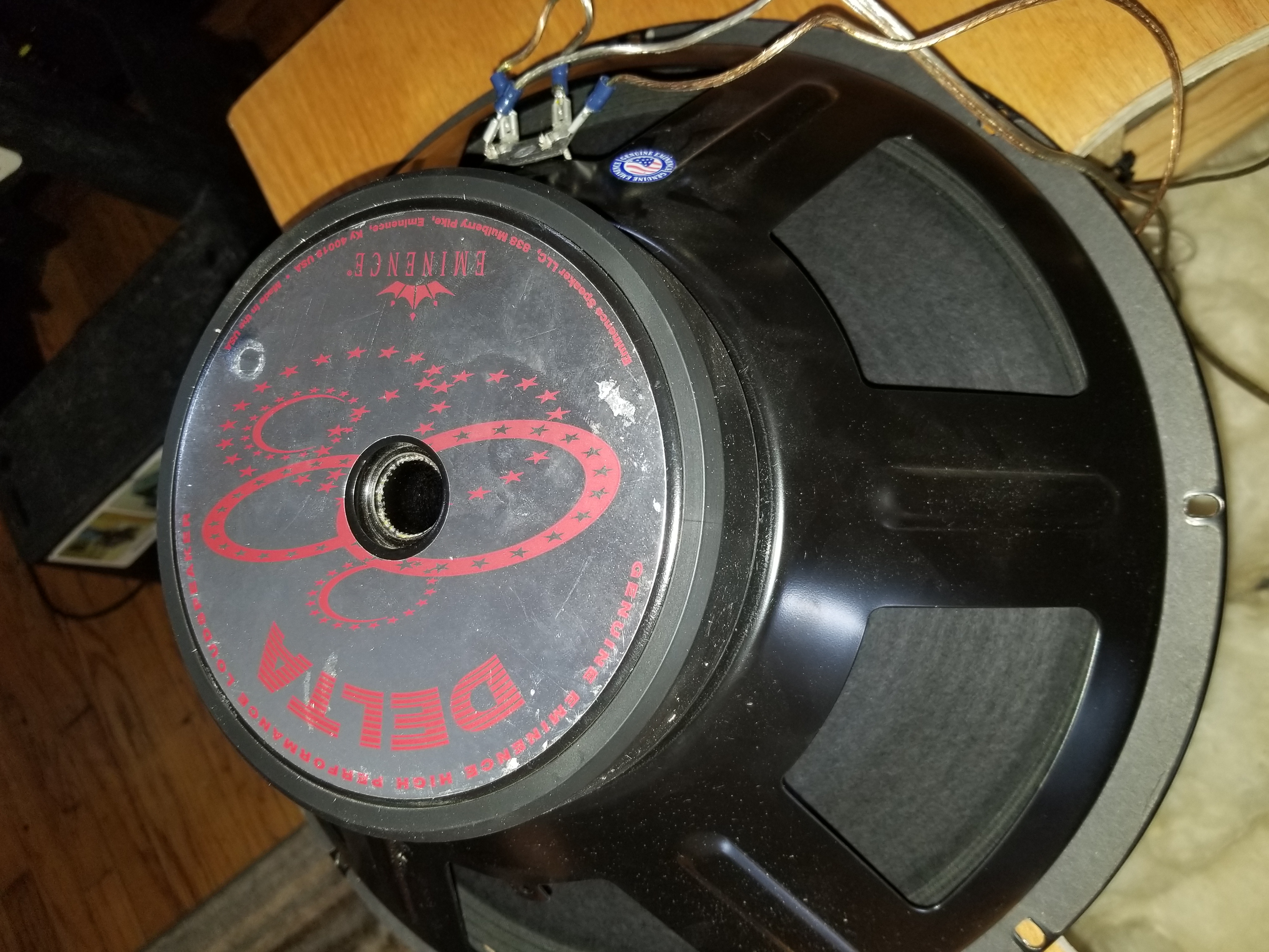

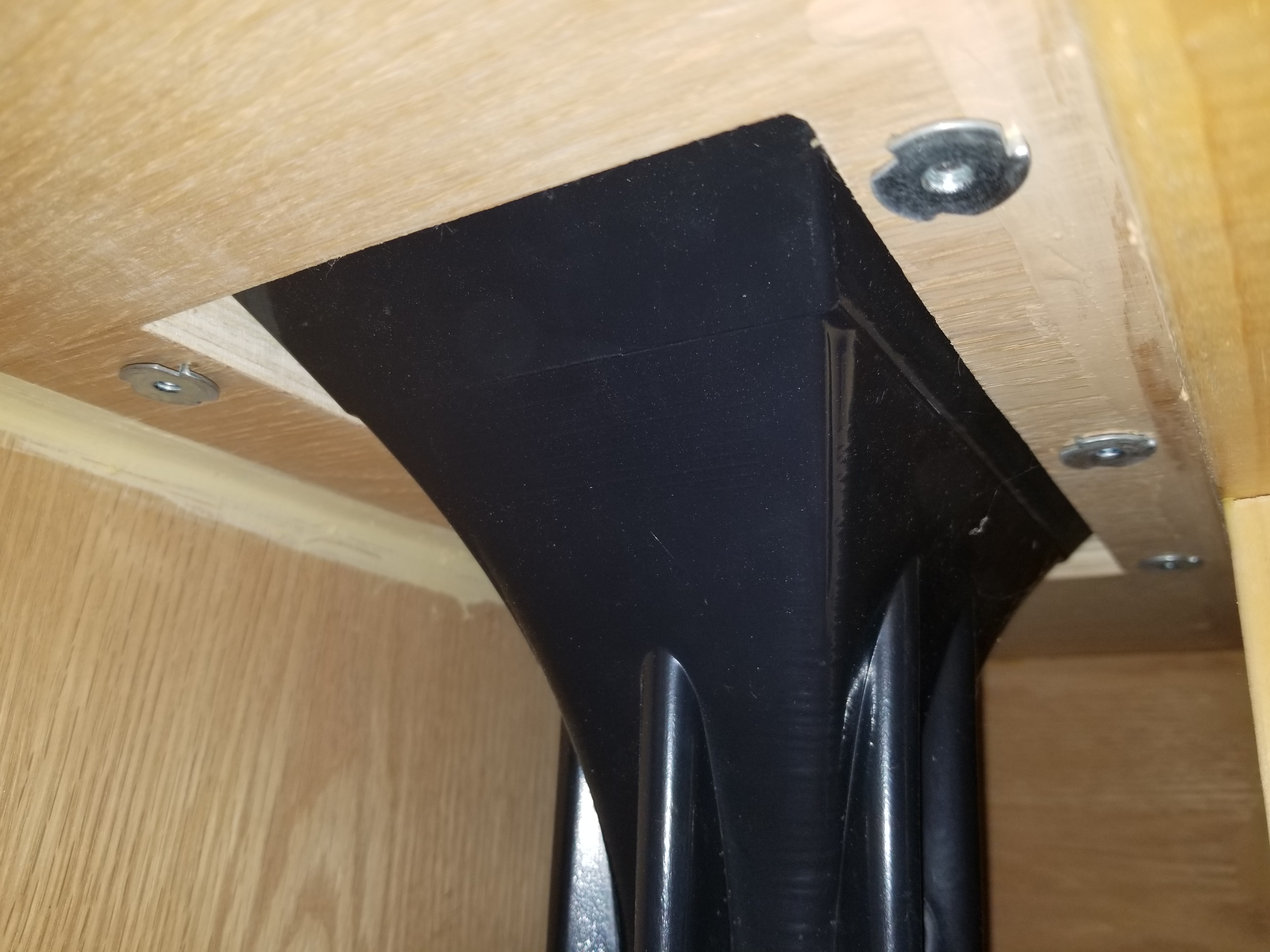

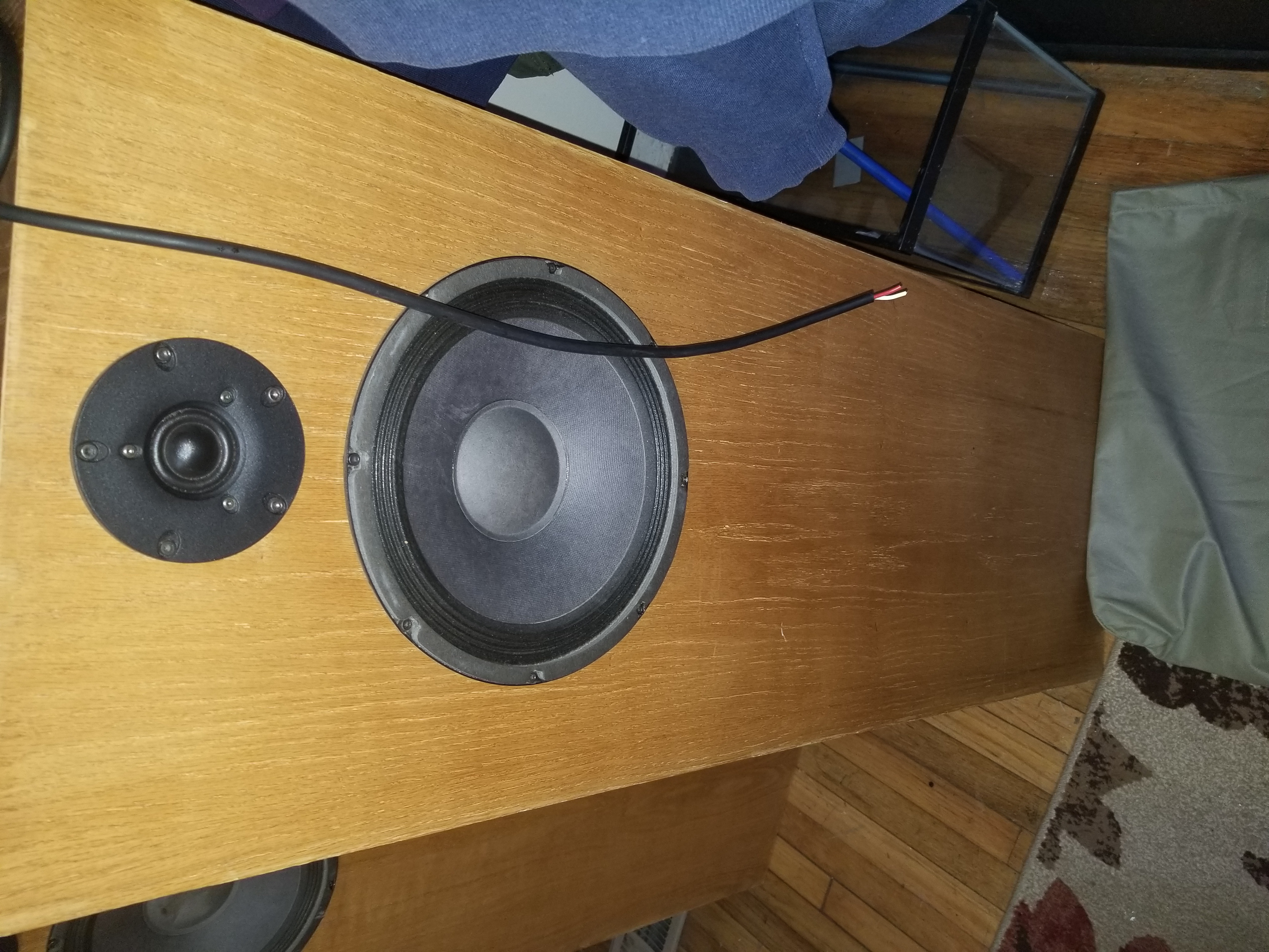

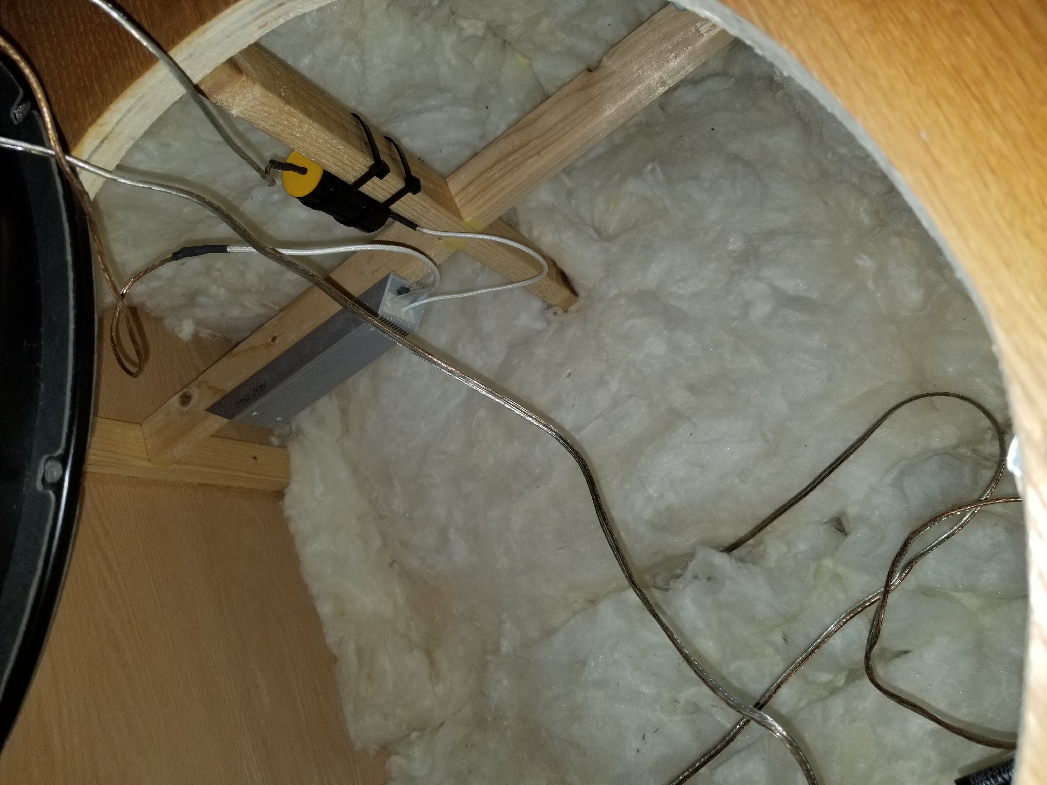

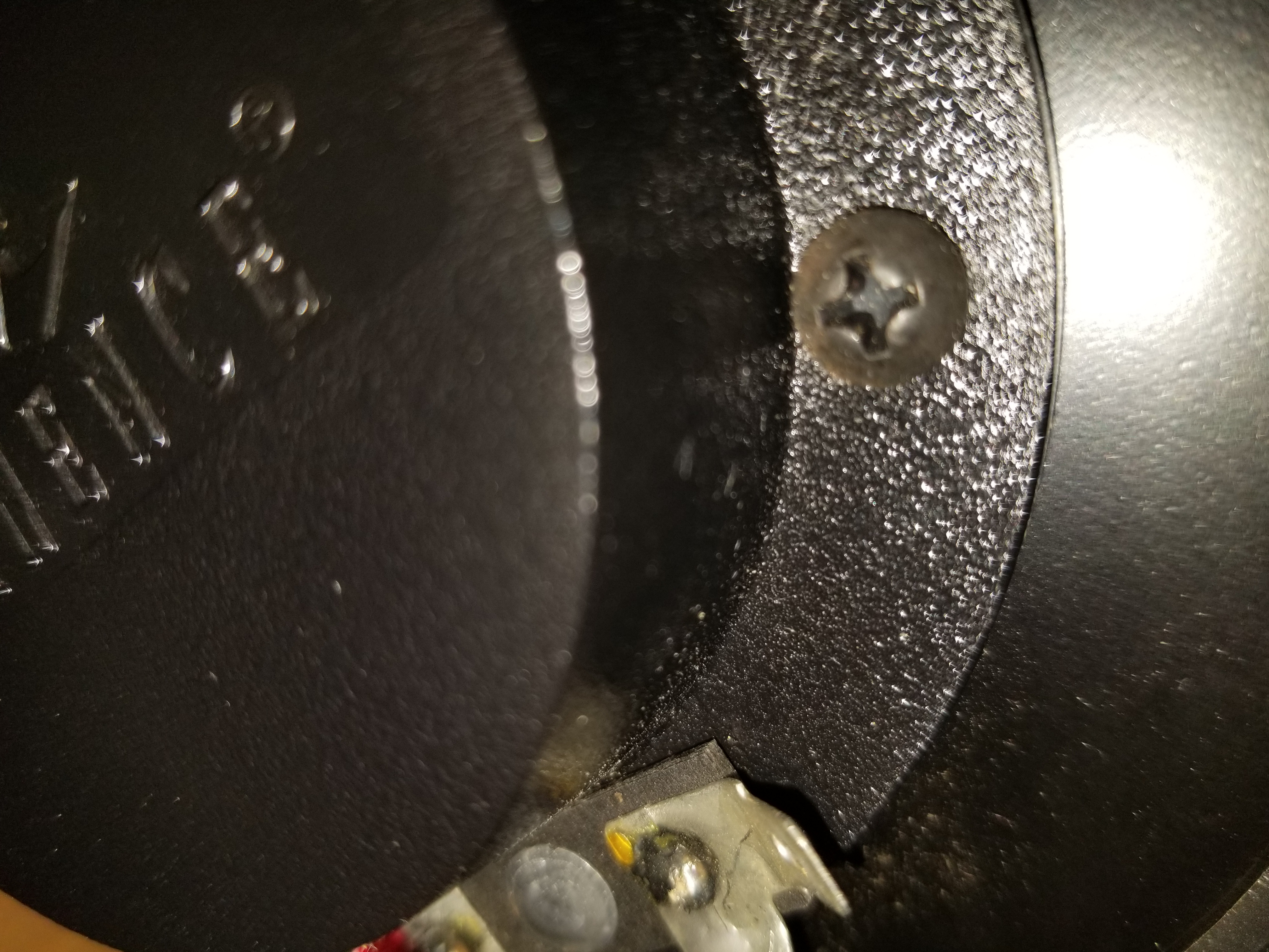

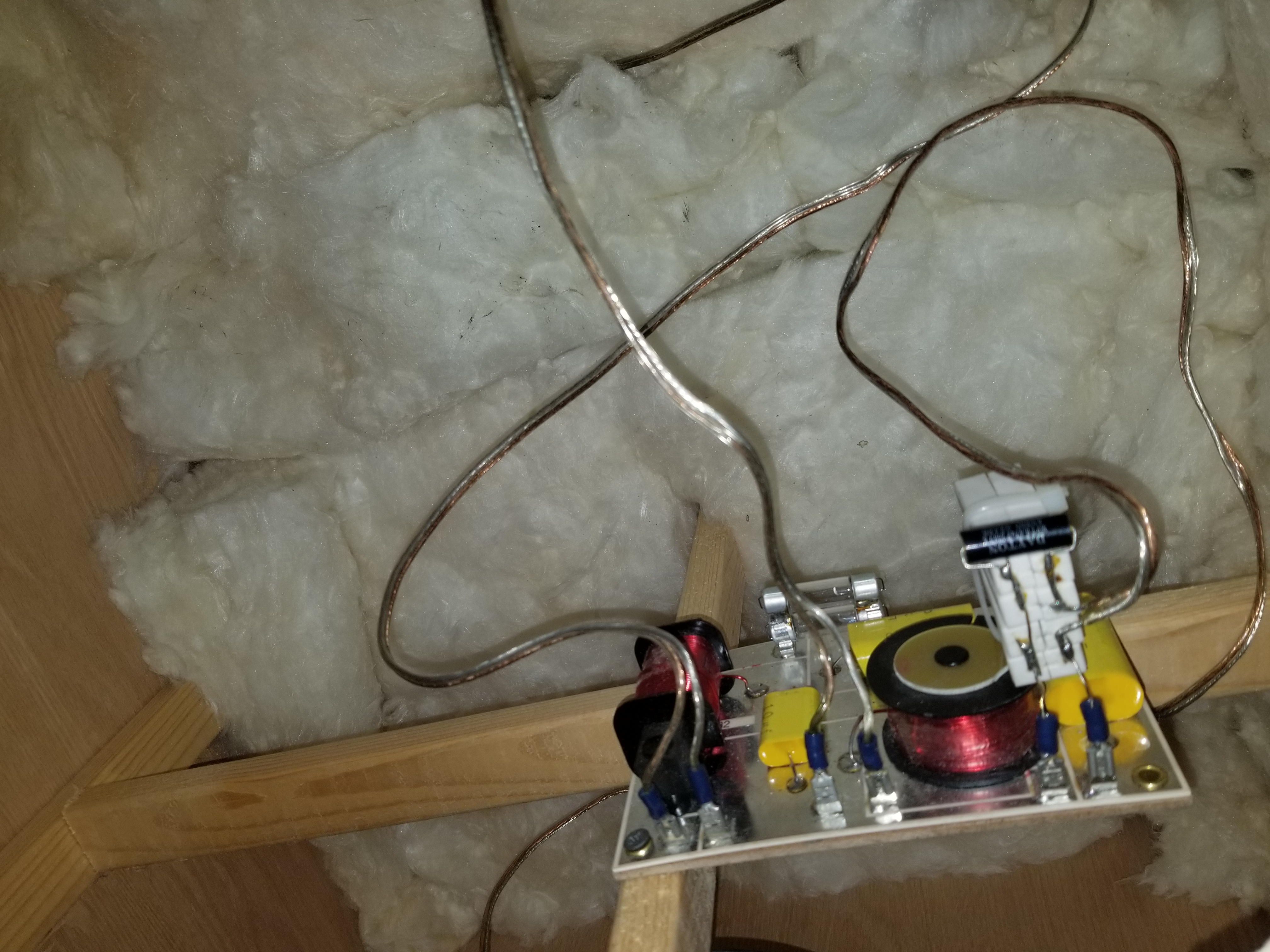

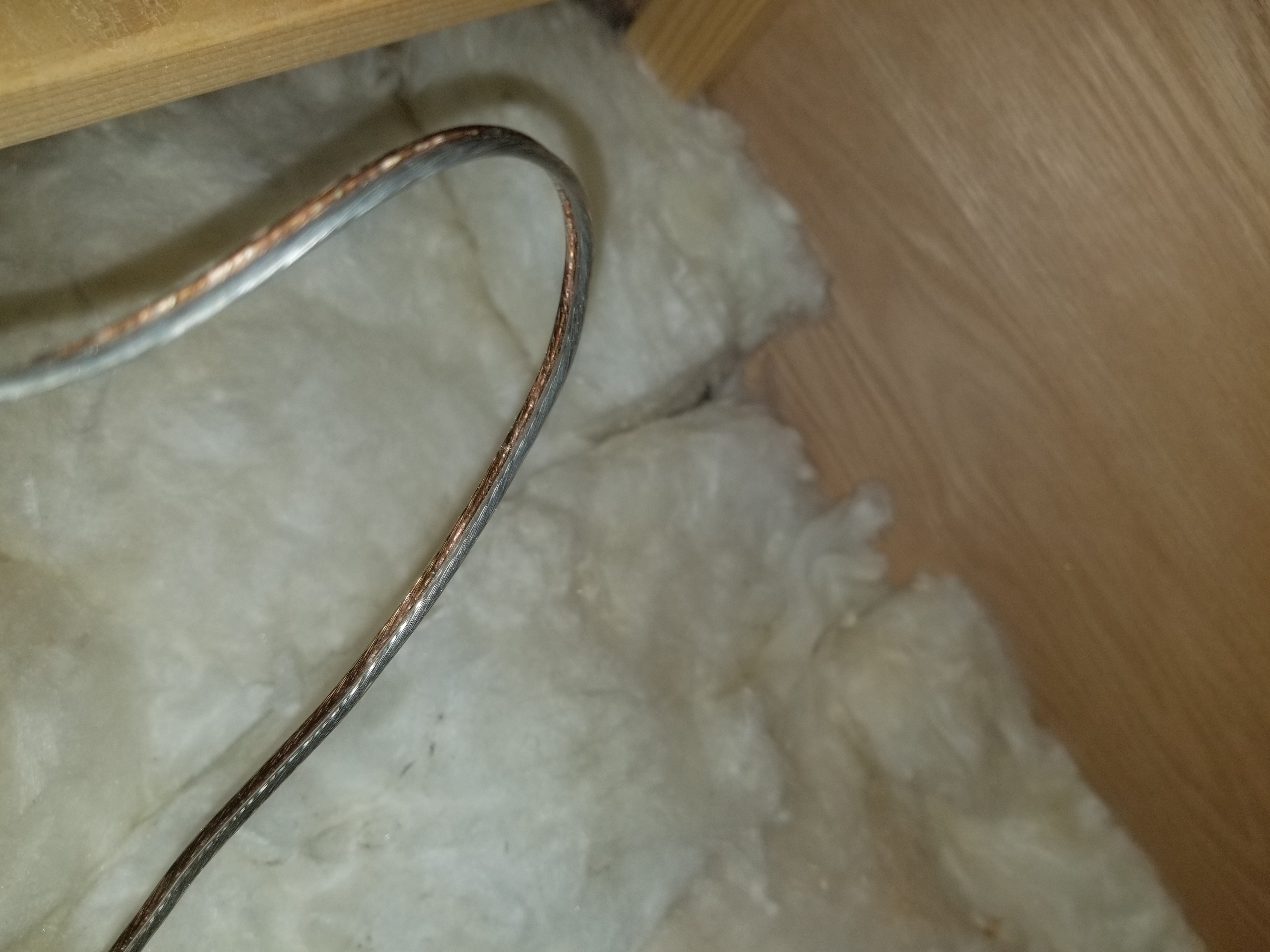

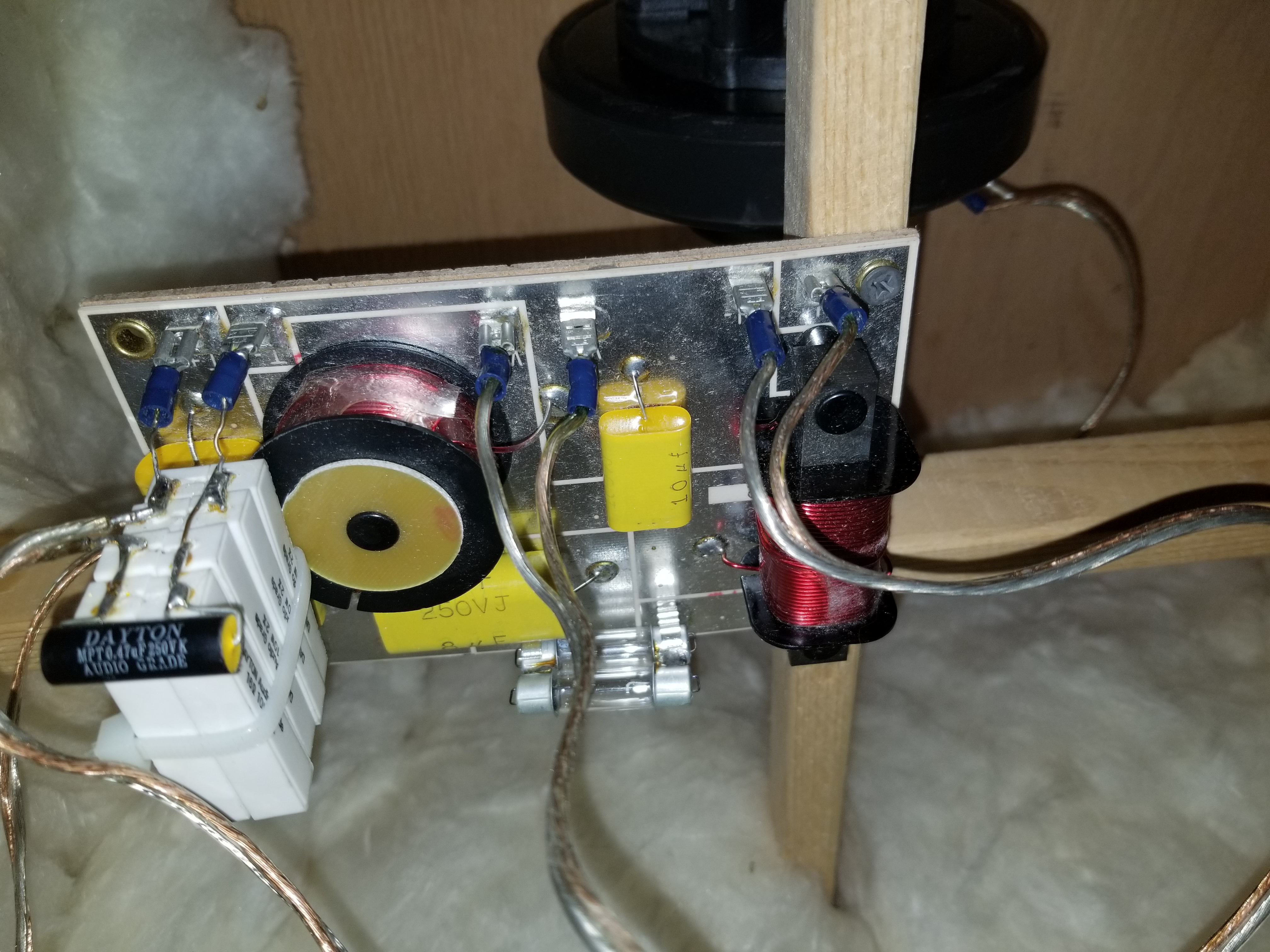

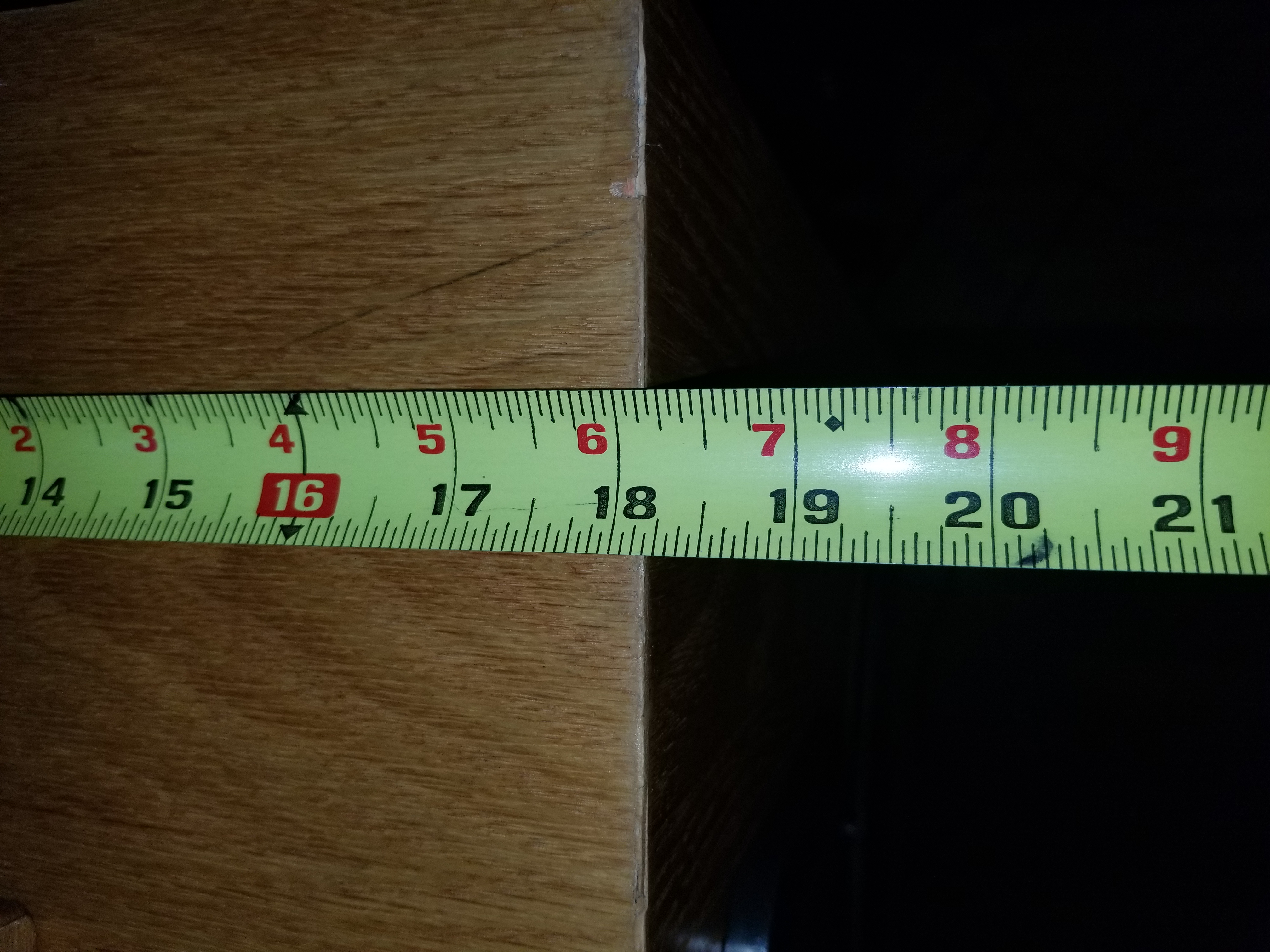

Ok I got it apart. Here you go Wayne

The plans for my first commercially available loudspeaker model were registered in the US copyright office in 1977. I did a few experimental designs before that, but my first loudspeakers were made in 1977.
The first models were just bass reflex designs, then I got interested in directivity and made the first constant directivity cornerhorns in 1979. A year or two after that, I did some DI-matched two-ways. By the early 1980s, all the models had become standardized, basically becoming the same line I have today. After that, all my efforts have been essentially incremental improvements in the same basic designs.
What you have looks like a 1990s era Theater Series four Pi loudspeaker. It was very popular back then. I no longer make that version of the four Pi, but it uses the same basic design as the models available now. The biggest change is the use of an OSEC flared waveguide, and a crossover that takes advantage of it.

We haven't really talked about the towers, so I'll address those first. They look to be the current versions, with Alpha 10 woofers and Vifa DX-25 tweeters. Those never had a different crossover, so they are the same as current models, provided the cabinets were built to spec. I can send you the plans if you want to verify that the cabinets were built as designed. But the driver compliment is same as current models, and I can only assume the crossovers are too since they haven't changed.
As for the Theater Series four Pi speakers, yes, you can order the H290C waveguides from the website. They can be installed without modifying the cabinet. And we have crossovers too, but not for that particular model. So the closest you could come would be to order the current four Pi crossovers and install them as replacements for the crossovers you now have.
But honestly, I think I'd probably leave the speakers as they are. They're really good, and were probably my most popular model in the 1990s. Seemed like everyone on this forum had Theater fours in that era.
