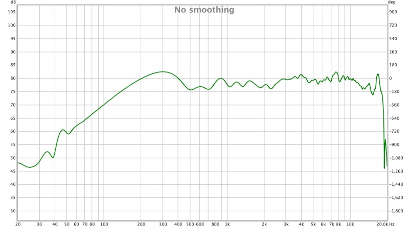

I decided to take some nearfield measurements to try to confirm what I was hearing. After reading this article on the miniDSP website on speaker measurements using my Umik1 and REW
https://www.minidsp.com/applications/acoustic-measurements/loudspeaker-measurements
I made this measurement:
/forum/index.php?t=getfile&id=2507&private=0
Per the miniDSP article, I placed the 3Pi in the corner, turned it in 45 degrees and raised it up until it was roughly centered between the floor and ceiling. I placed the mic at a 1m distance from the speaker baffle and pointed it directly between the bottom of the horn and top of the woofer. I then gated the measurement to eliminate the floor bounce.
The measurement seems to indicate that the response starts to rolloff at 10khz, and that comports with what I'm hearing. Does this still seem likely to be a malfunctioning crossover to you? I triple and quadruple checked the schematic against my wiring and verified each connection with a multimeter. Although it's not impossible, I would be really surprised if I still had a wiring error at this point.
If this response looks correct to you, could you suggest a way I might be able to raise the top octave response a bit to better suit my tastes? For example, would it help to install a cap at the C1 position?

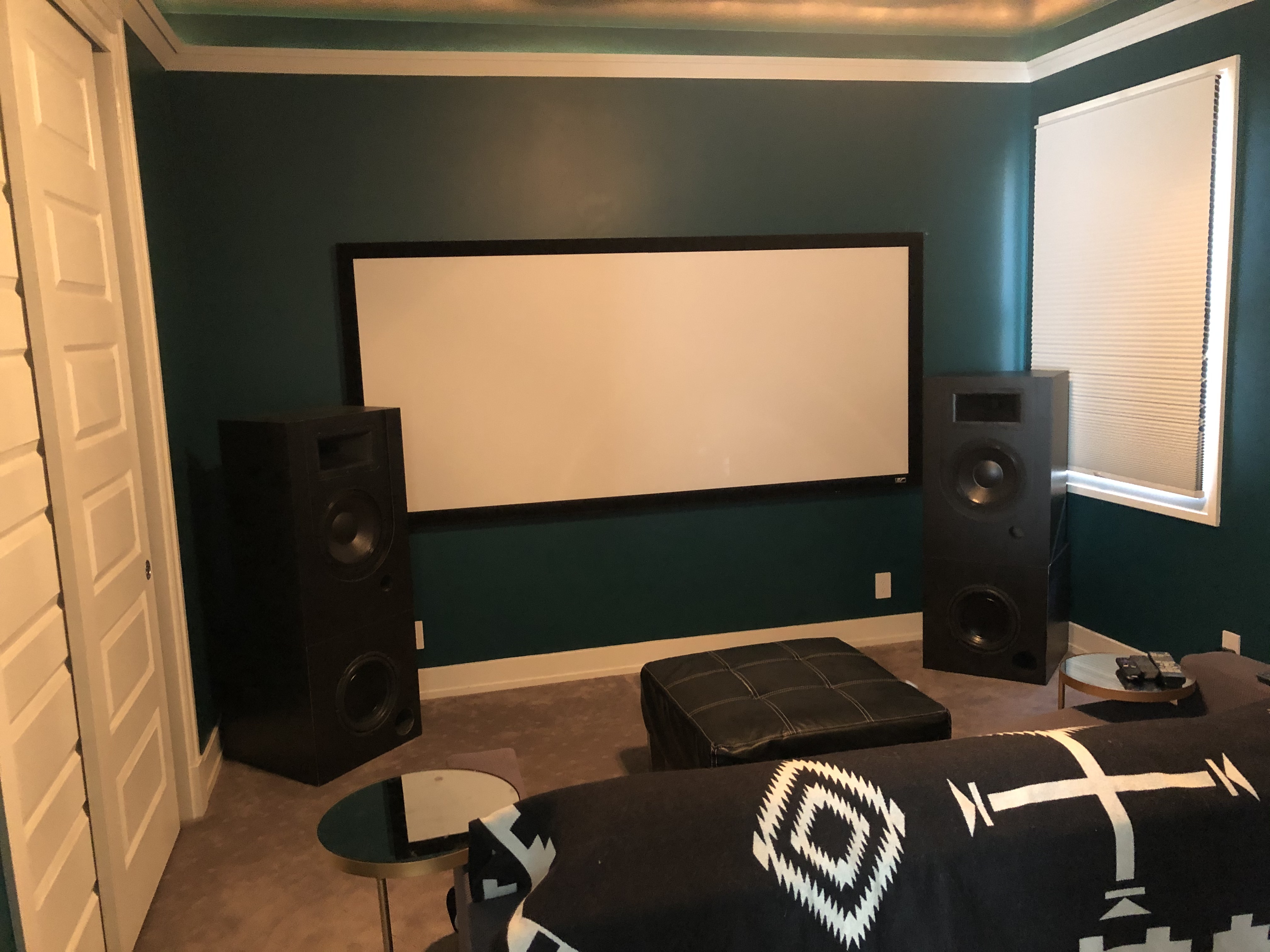

Here's a picture of my finished 3Pi mains and 3Pi subs, by the way.
/forum/index.php?t=getfile&id=2508&private=0

Your setup looks really nice! Response looks good too. There is some rolloff above 10kHz, which is to be expected from compression drivers. You can add the 0.47uF C1 capacitor if you want - which will add a little sparkle - but I removed that part about ten years ago because I thought it was too much. I'd rather have a little droop above 15kHz than a spike there.
I can see how hard it was to try and get flanking subs setup in there. Just no room. They have to be offset in all three planes to get them to do their thing. To do that in your room would have required pulling the mains out enough from the wall they probably seem to be intrusive. So I can see why you took the more traditional subwoofer approach. Looks like it worked out very well though.
