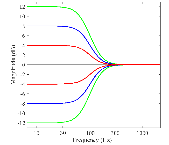

One question regarding the amp with the bass control at 100 hz. A stand alone 2nd order 100 hz low pass filter should cut output above 100 hz so that by 150 hz the output is down by 6 db and by 200 hz the output should be down 12 db. Easy. But below 100 hz it wouldn't change output. So in a perfect situation you'd see a flat line from way down low to 100 hz and at that point the output would go down as the frequency goes up.
But a 2nd order bass control on an amp would boost the frequencies at 100 hz and then fall off at 12 db in both directions. So the output would be reduced at 150 and 200 hz as it would with a stand alone crossover but wouldn't the bass control on the amp also cut the output below 100 hz on a 12 db slope, too? So at 50 hz there would be a significant reduction in bass?

A midrange tone control is a bandpass filter, but bass is low-pass and treble is high-pass. Boost is sometimes done using a bandpass filter, sort of like a parametric filter. And of course graphic equalizers use a series of bandpass filters.
But the low-pass filter in the bass tone control provides curves that look something like the chart shown below. It's not exactly right, because the slope in this chart changes with amplitude. But you get the idea.
/forum/index.php?t=getfile&id=2470&private=0
Re: Low Pass [message #91196 is a reply to message #91156] Mon, 18 November 2019 16:15 Go to previous messageGo to next message
Messages: 226
"but bass is low-pass and treble is high-pass"
OK, got it. It now makes sense.
