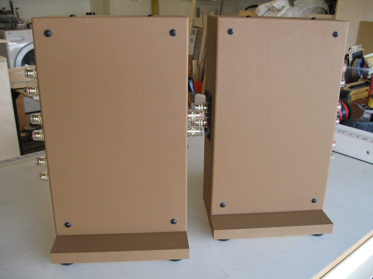

I designed my own crossover PCB just as part of the enjoyment of building my own speaker system.
/forum/index.php?t=getfile&id=2876&private=0
Also built a case for it.
/forum/index.php?t=getfile&id=2878&private=0
Here is the crossover encased
/forum/index.php?t=getfile&id=2879&private=0
/forum/index.php?t=getfile&id=2880&private=0
To fit behind the mid-horn I added a base to keep it vertical
/forum/index.php?t=getfile&id=2884&private=0
/forum/index.php?t=getfile&id=2883&private=0
/forum/index.php?t=getfile&id=2882&private=0

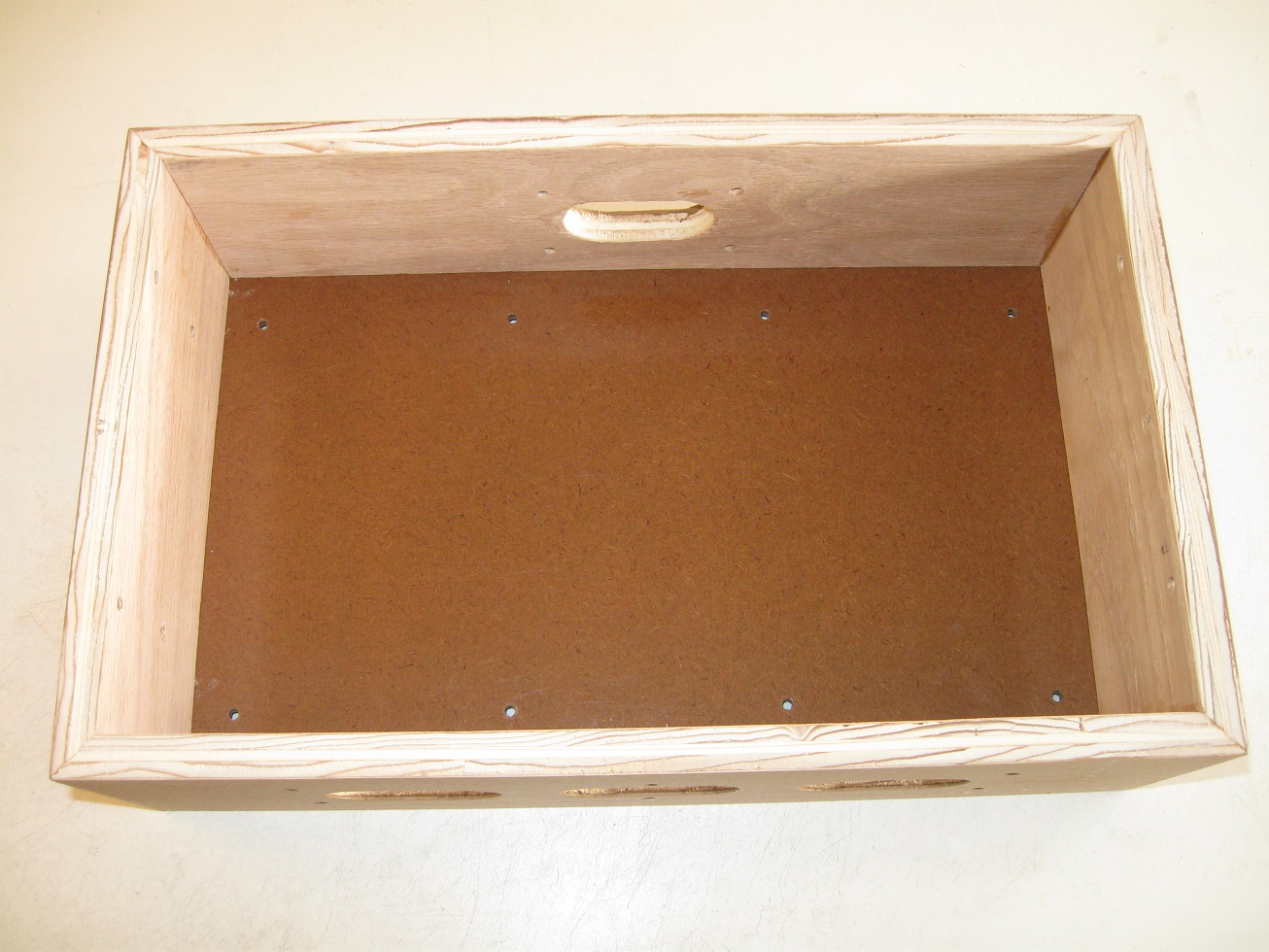

This is the bass unit during the building process.
/forum/index.php?t=getfile&id=2885&private=0
/forum/index.php?t=getfile&id=2887&private=0
/forum/index.php?t=getfile&id=2886&private=0
