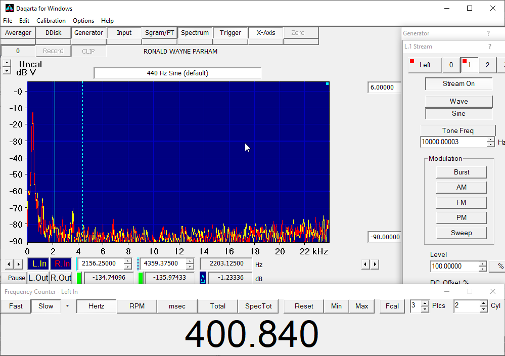

Test Tape Section 1: 400Hz, 0:09 - 2:03

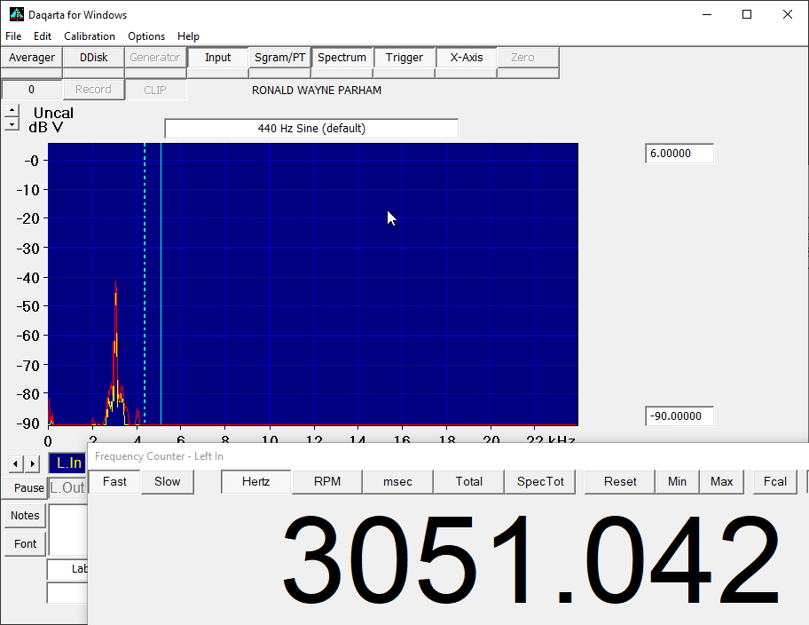

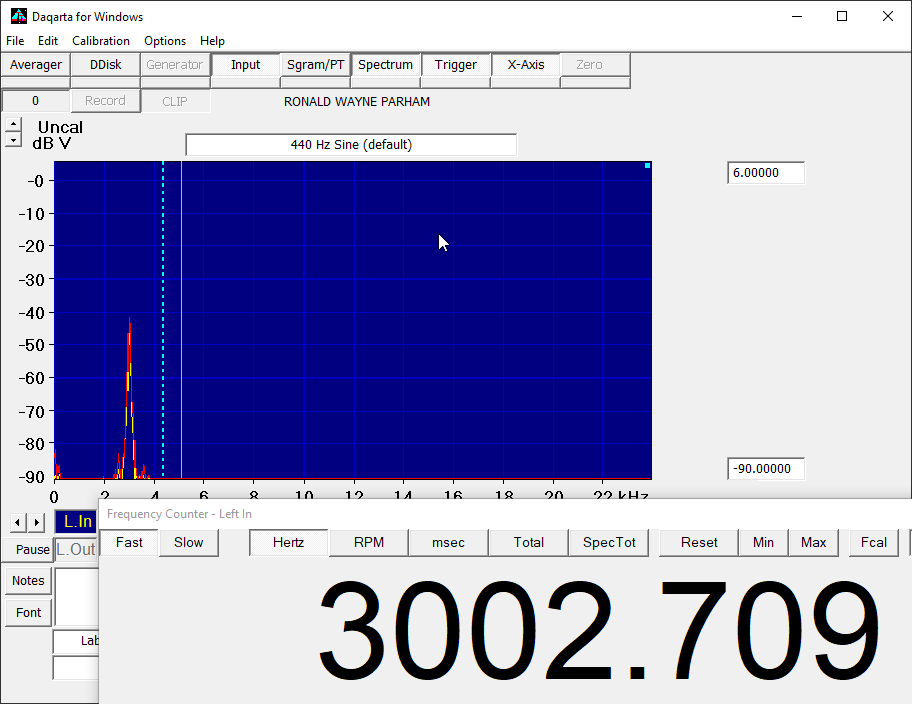

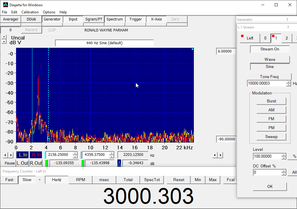

Next is a speed adjustment. Using the 3kHz signal, adjust the speed potentiometer to be exactly 3kHz.
/forum/index.php?t=getfile&id=2428&private=0
You can see mine was off a little bit. A small turn of the speed adjustment potentiometer RV71 brings it right to where it needs to be.
/forum/index.php?t=getfile&id=2429&private=0

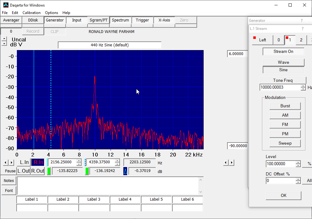

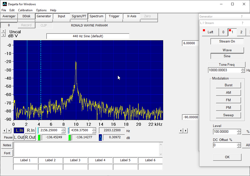

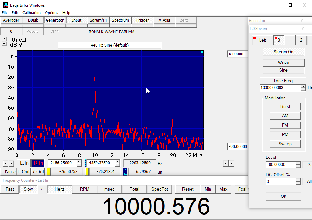

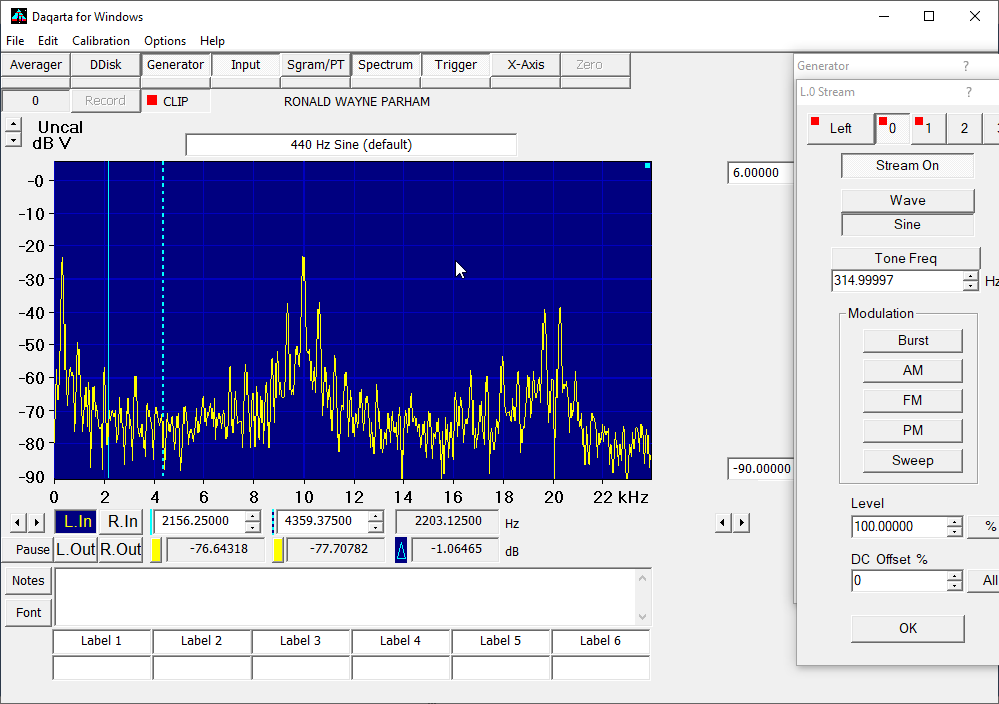

Re: Cassette Tape Alignment [message #90679 is a reply to message #90678] Fri, 12 July 2019 15:59 Go to previous messageGo to next message
I did that for a while, and then decided to create a dual-tone signal that combined the 315Hz sine with the 10kHz sine. I monitored the output with Daqarta's spectrum analyzer so I could see both the 315Hz content and the 10kHz content. That made it easier to set the levels to match. Then as a "sanity check," I used single-frequency sines of 315Hz and 10kHz to make sure the levels were matched when a pure sine wave was presented.
Pay attention to the relative amplitudes of the signals below at 315Hz and at 10kHz:
/forum/index.php?t=getfile&id=2435&private=0
Before adjusting bias: Right channel bias NOT set
/forum/index.php?t=getfile&id=2436&private=0
Right channel bias properly set
/forum/index.php?t=getfile&id=2437&private=0
Left channel bias properly set
