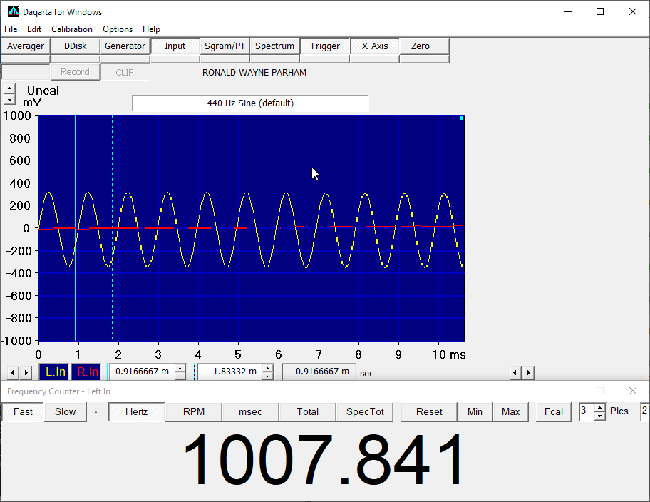

Single-frequency sine signals are useful for measuring speed accuracy and for measuring channel separation. Cartridge azimuth has an effect on channel separation: If the stylus is perfectly perpendicular to the groove, then a signal on the left channel groove will be present only on the left channel and not on the right, and vice versa.

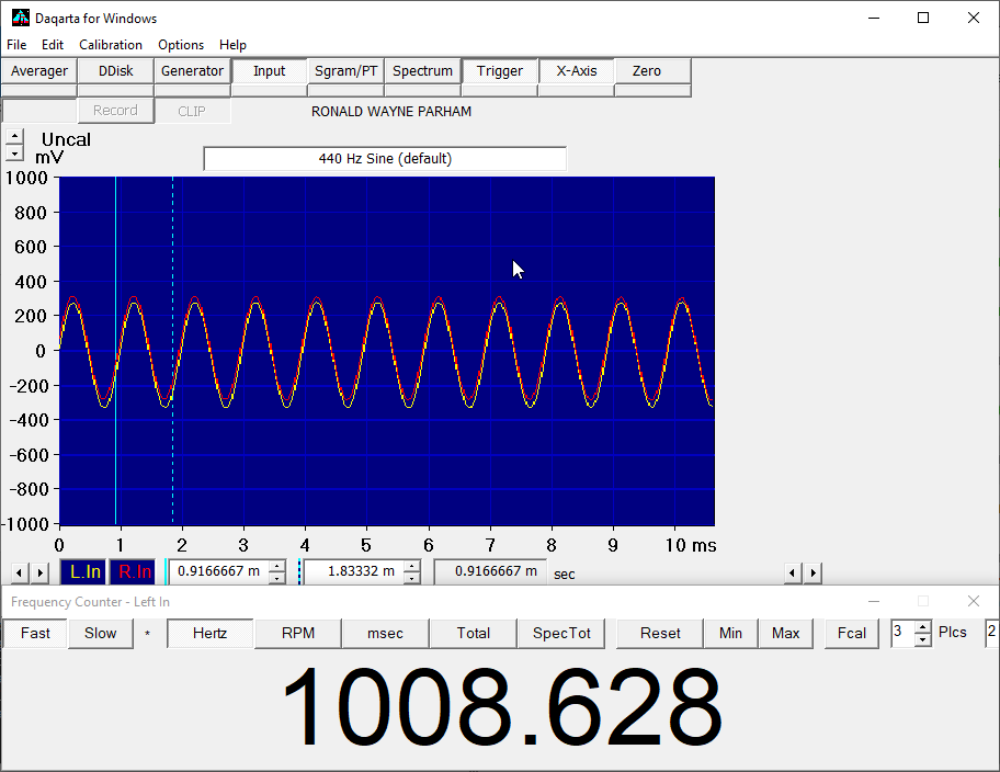

1kHz sine
Using a 1kHz sine in both channels, we can see amplitude and phase matching:
/forum/index.php?t=getfile&id=2393&private=0
1kHz on both channels
The amplitude and phase are well-matched between channels. Looks like there's a slight zero-offset difference between left and right channels.
/forum/index.php?t=getfile&id=2394&private=0
1kHz on the left channel only
/forum/index.php?t=getfile&id=2395&private=0
1kHz on the right channel only
The signal is present only on the channel intended, so azimuth is set pretty well.

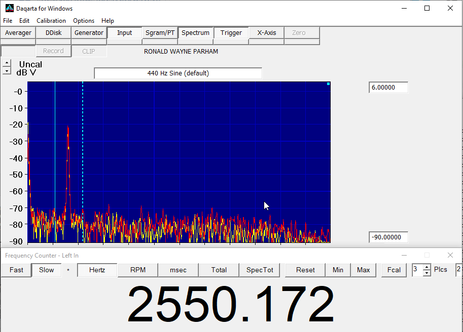

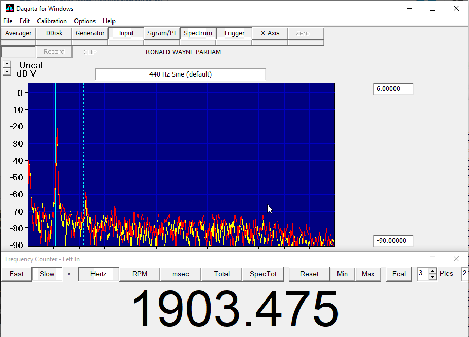

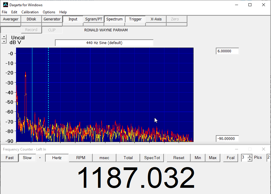

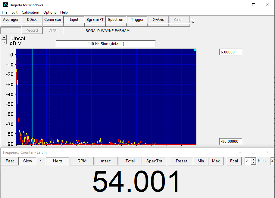

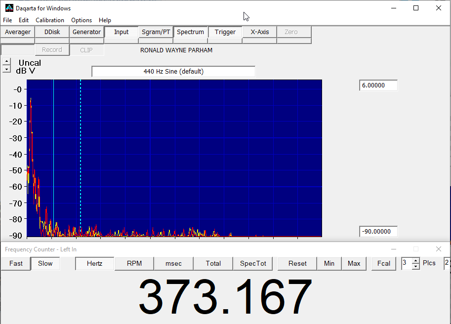

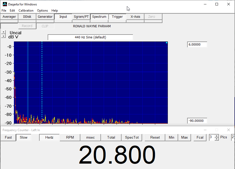

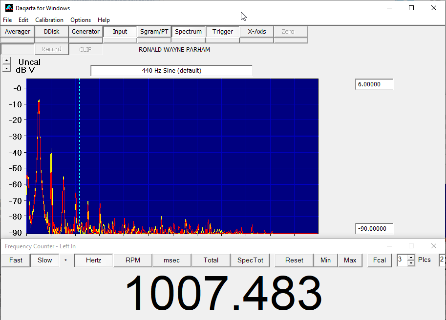

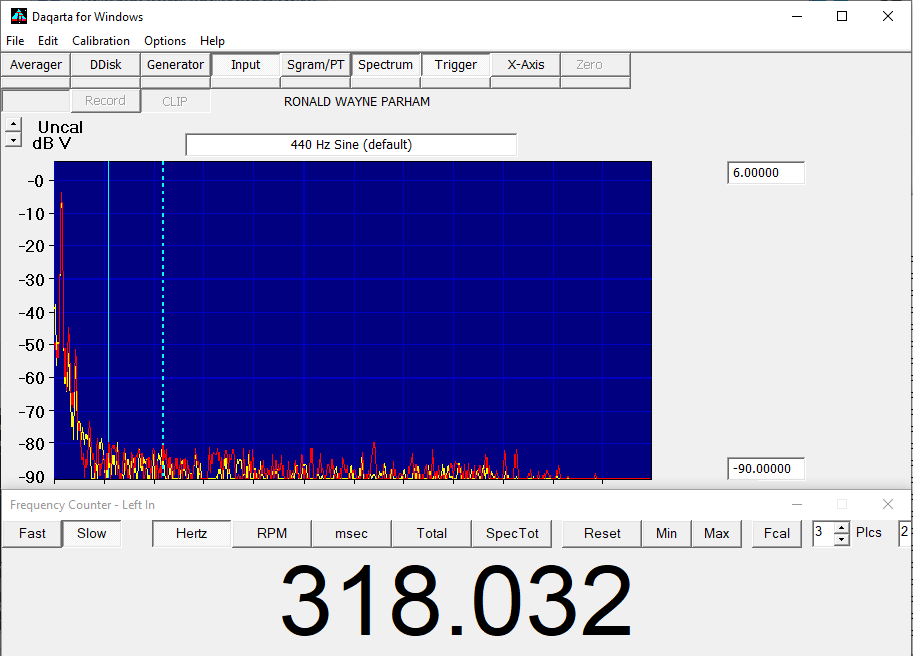

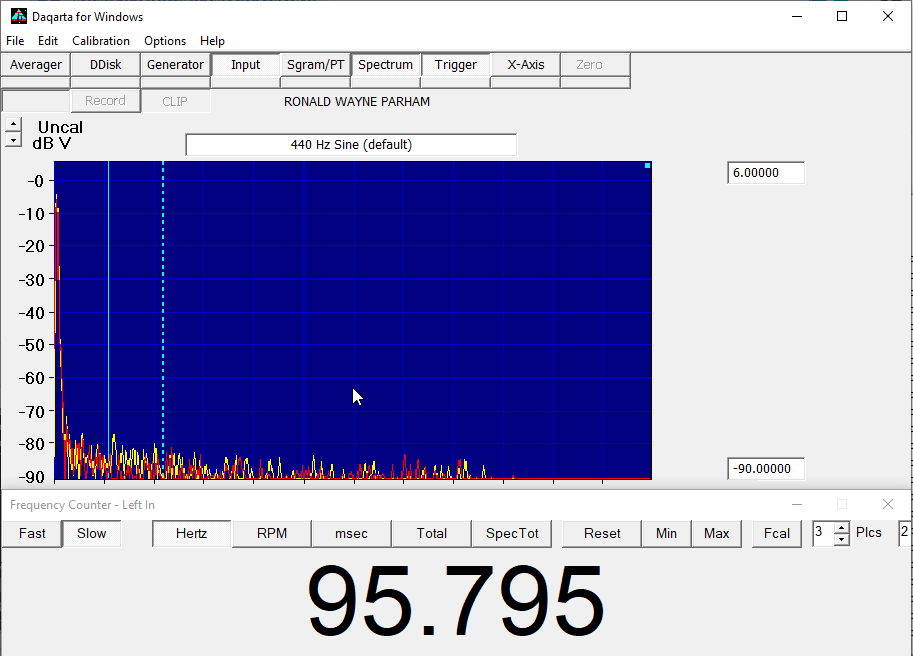

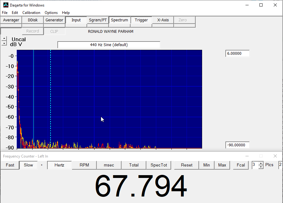

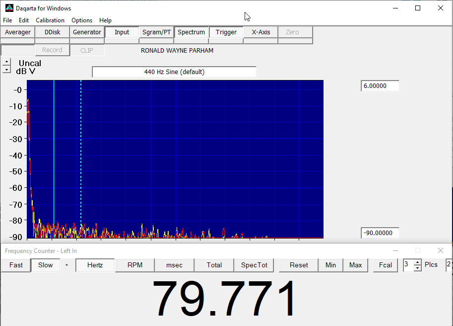

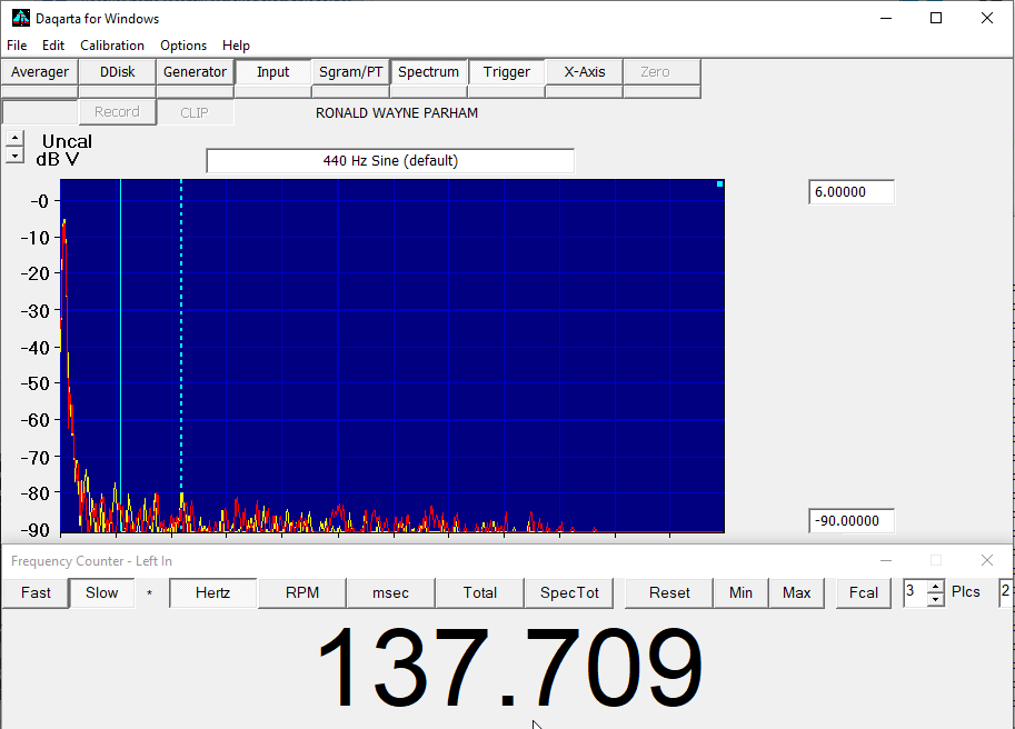

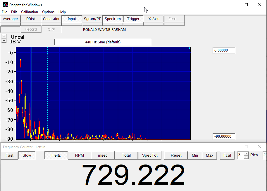

The sweeps (which are actually stepped sines) are of equal amplitude so if the reactive load on the cartridge and the RIAA equalization is accurate, then the output of at all frequencies will be equal amplitude.
I switched from oscilloscope view to spectrum view for this test. That made it easier to see the signal and its amplitude: As frequency rises, the position of the signal simply moves to the right on the graph.
There are a couple things I would have liked to have done differently. One is the horizontal (frequency) scale, which is linear and goes clear out to 24kHz. That's fine when doing high-frequency sweeps, but it would have been better for me to have switched to a view that limited the range to 1kHz, placing that at the far right of the chart for low-frequency sweeps. I'm not familiar with Daqarta yet, so I don't know how to do that or if it's even possible.
The other thing I would have liked to have done was to sample the screen captures more often, so I could capture all the signals. I had a screen capture program set to grab the Daqarta window every half-second, so it missed some of the signals. I still got a good representation of the behavior of the system though. Maybe next time I'll study the program more so I can capture all the frames, perhaps as an animated GIF.

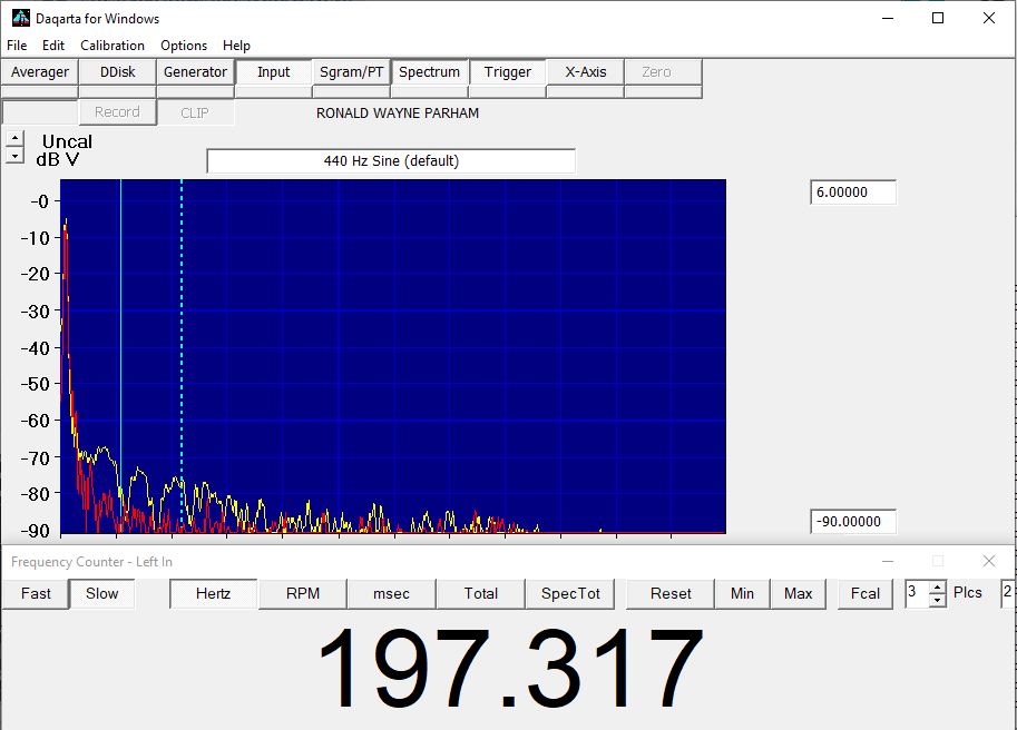

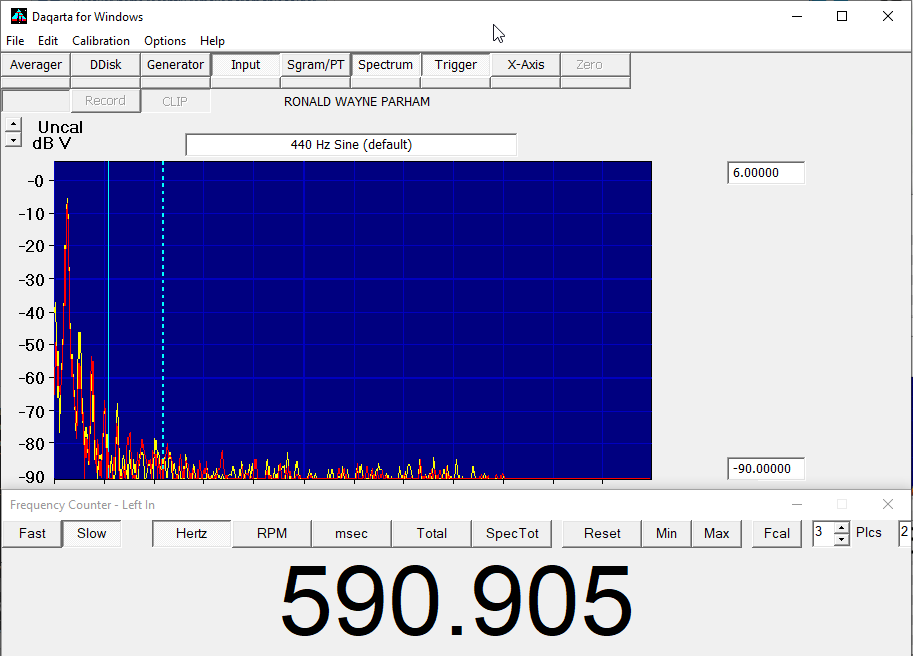

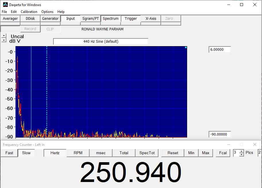

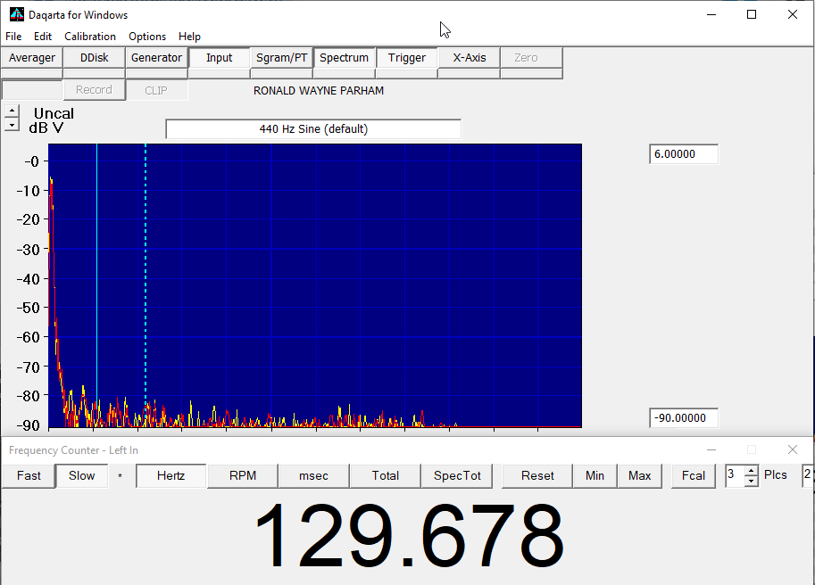

Stepped sines from 1kHz to 10Hz:
/forum/index.php?t=getfile&id=2396&private=0
/forum/index.php?t=getfile&id=2397&private=0
/forum/index.php?t=getfile&id=2398&private=0
/forum/index.php?t=getfile&id=2399&private=0
/forum/index.php?t=getfile&id=2400&private=0
/forum/index.php?t=getfile&id=2401&private=0
/forum/index.php?t=getfile&id=2402&private=0
/forum/index.php?t=getfile&id=2403&private=0
/forum/index.php?t=getfile&id=2404&private=0
/forum/index.php?t=getfile&id=2407&private=0
/forum/index.php?t=getfile&id=2408&private=0
/forum/index.php?t=getfile&id=2409&private=0
/forum/index.php?t=getfile&id=2410&private=0
/forum/index.php?t=getfile&id=2411&private=0
/forum/index.php?t=getfile&id=2412&private=0
Amplitude response looks pretty good and flat between 10Hz and 1kHz.

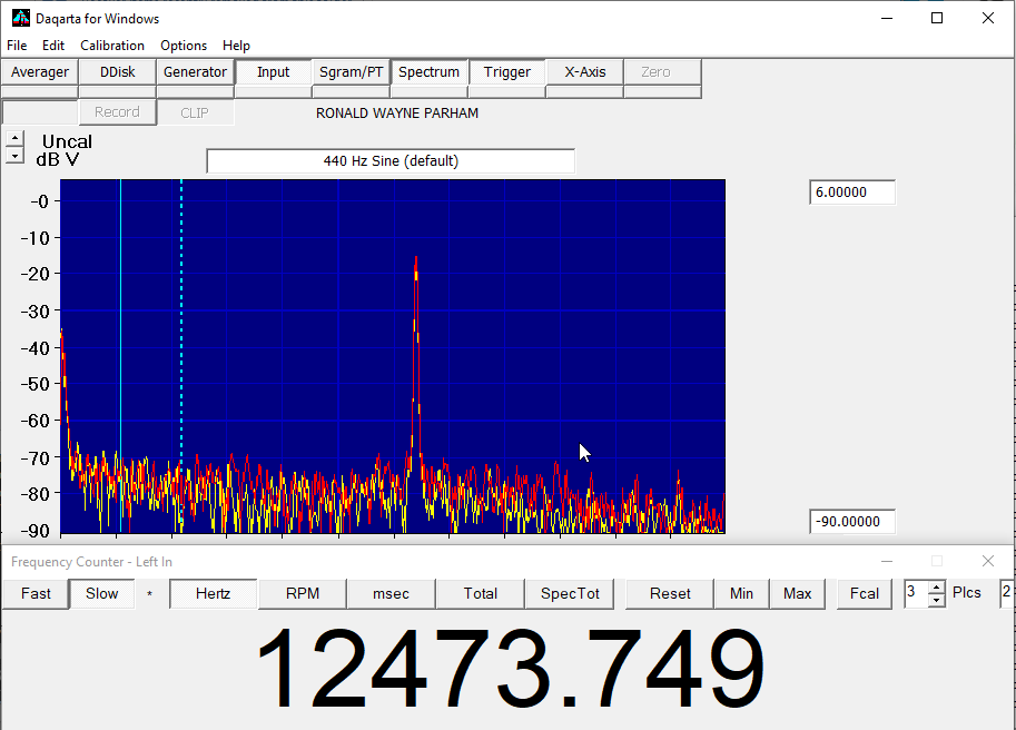

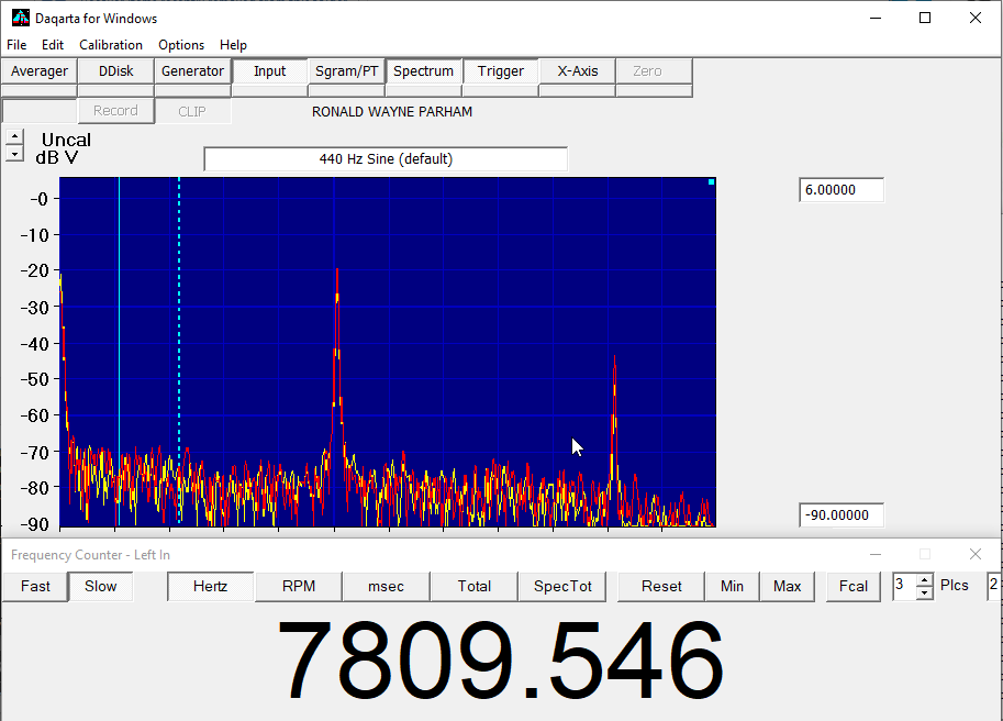

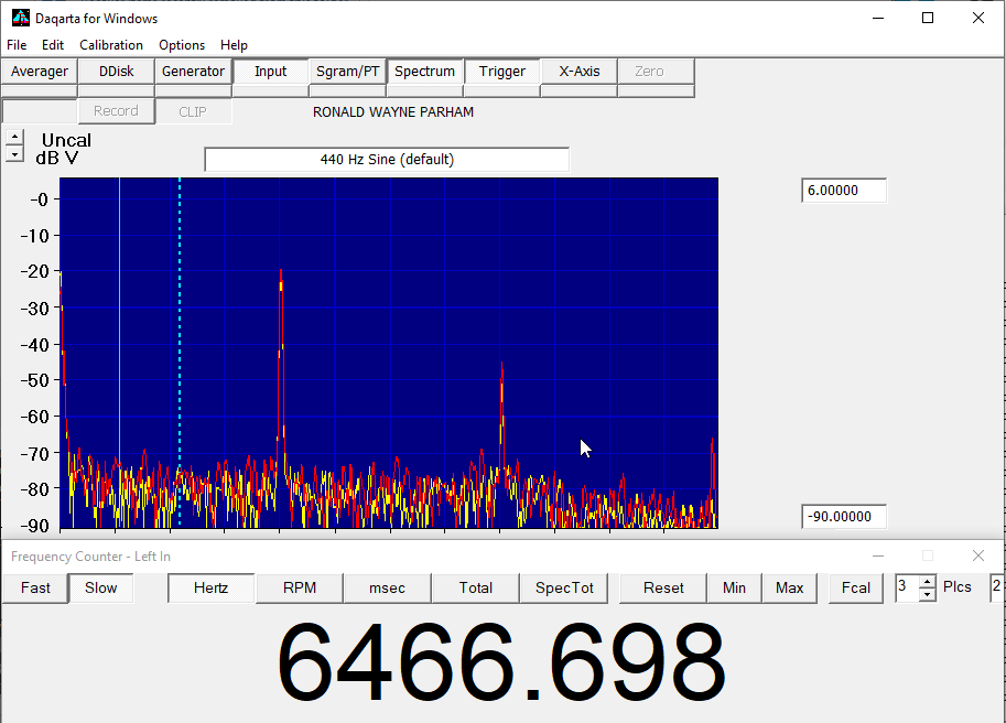

Stepped sines from 1kHz to 20kHz:
/forum/index.php?t=getfile&id=2413&private=0
/forum/index.php?t=getfile&id=2414&private=0
/forum/index.php?t=getfile&id=2415&private=0
/forum/index.php?t=getfile&id=2416&private=0
/forum/index.php?t=getfile&id=2418&private=0
/forum/index.php?t=getfile&id=2419&private=0
/forum/index.php?t=getfile&id=2420&private=0
/forum/index.php?t=getfile&id=2421&private=0
/forum/index.php?t=getfile&id=2422&private=0
Amplitude is consistent with all these samples so the frequency response of this cartridge and phono stage is nice and flat.

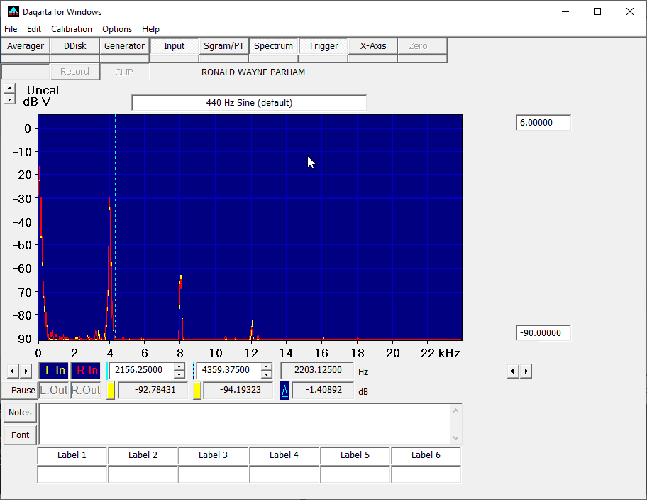

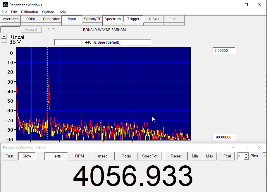

Intermodulation distortion (IMD) from 60Hz and 4kHz sines
The intermodulation test signal is a 60Hz sine and a 4kHz sine. Clipping in the phono stage (or measurement system) will increase IMD, as will the incorrect vertical tracking angle.
/forum/index.php?t=getfile&id=2423&private=0
This measurement doesn't look good but it's hard to know how much of that is the measurement system and how much is the device under test. For one thing, I need to be able to change the horizontal scale so that I can see the area around 4kHz very closely. I would expect to see 3940Hz and 4060Hz components from intemodulation, but I can't see that well because of the horizontal resolution. What I can see pretty clearly are 2nd and 3rd harmonics at 8kHz and 12kHz, which tells me something else is going on. Probably clipping in the measurement amplifier or possibly the phono stage.
Re: Turntable Cartridge Measurements [message #90658 is a reply to message #90657] Mon, 08 July 2019 21:22 Go to previous messageGo to next message
Observations:
There is evidence of harmonics in some of these measurements. I'm confident that the amplitude of the fundamental is still accurate because I initially measured in oscilloscope view and saw that the fundamental wasn't clipped. So if that information is all that is needed, then the presence of these harmonics isn't important. But sometimes - like distortion measurements - harmonics are an indication of some sort of nonlinearity, and that makes me less confident in the IMD measurements.
What I don't yet know is whether the harmonics were caused by a sampling artifact or by something like clipping in the phono stage or in the measurement amplifier. I am most suspicious of the measurement amplifier and ADC, because the phono stage was not operated beyond its limits. It was used as it normally would be. The measurement amplifier/DAC used was a Behringer UMC202HD, and it has variable gain controls. I could have simply set those too high.
The frequency counter seems off in some measurements. When Daqarta is in spectrum view mode, the horizontal scale is linear with lines every 2kHz. So it is easy to read what frequency is presented from the horizontal position. In some cases, the position indicates a frequency that is different from what the counter reads. An example is the stepped sine sweep where the frequency counter reads 14121.248. The position indicates the frequency of that measurement was closer to 18kHz.
The frequency counter errors could have been a result from the harmonics. When there is more than one sine wave present, a frequency counter cannot really know what to count. So the multiple frequencies from harmonics may throw off the counter. Or it may have been that there was too much noise, or the frequency counter may just not be all that accurate. It did seem to work well when presented with a clear single sine though.
