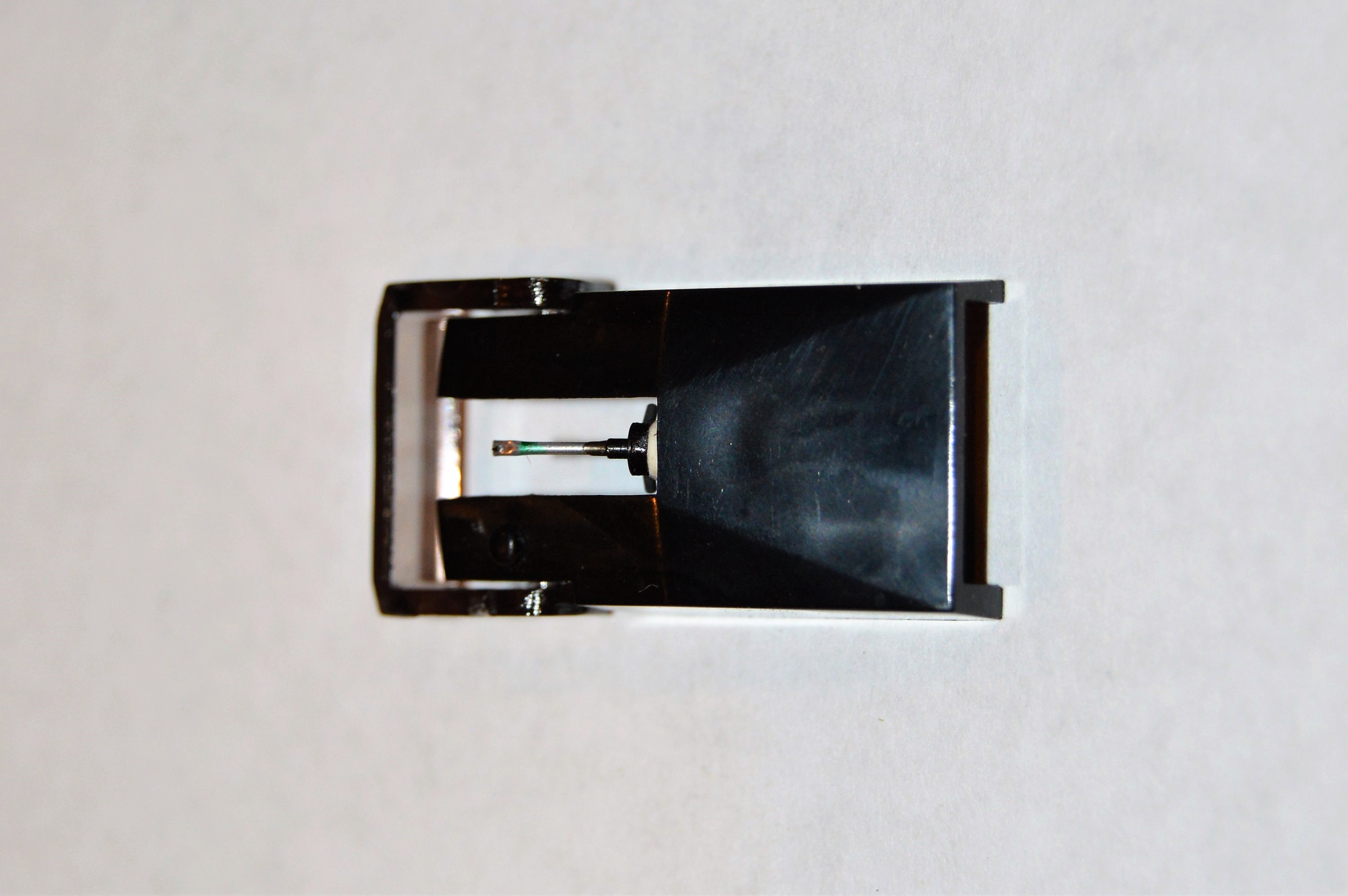

I've learned a lot, and I have a lot more to explore. So I'm here to report the things I've found.
First, TurntableNeedles.com sent a replacement for the defective Jico/Bliss stylus. They said they have never seen this kind of problem before but asked no questions and didn't hesitate to exchange it. You can see that the one they sent is well-formed:
/forum/index.php?t=getfile&id=2300&private=0
ATN20 "Bliss" (Jico) Stylus
Re: Stylus Inspection [message #89576 is a reply to message #89575] Sun, 13 January 2019 18:35 Go to previous messageGo to next message
I am comparing the ATN20 "Bliss" stylus with a genuine original Audio Technica AT20 stylus. Both have the Shibata shape.

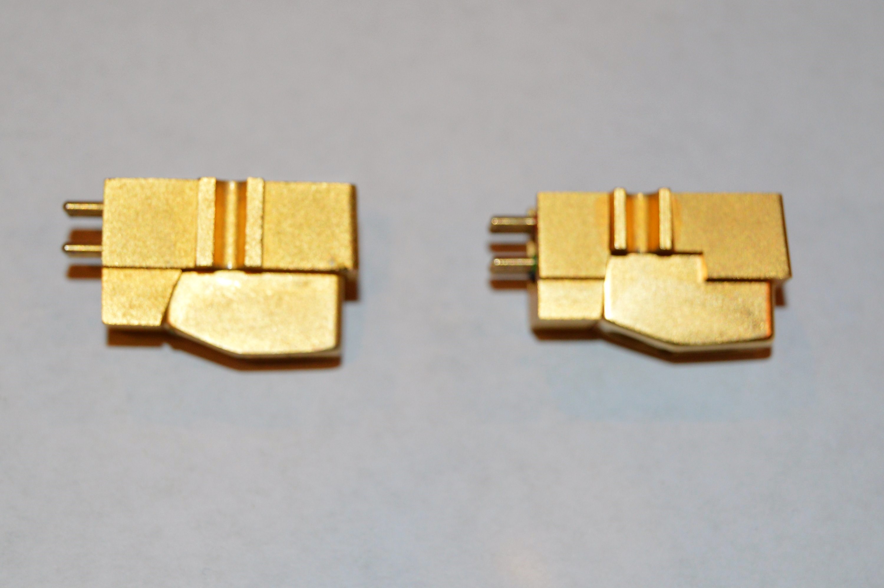

As an aside, I am also comparing the AT20SL cartridge with the AT20SLa. Upon casual inspection, you don't really notice a difference in the two. But Rusty clued me into the fact that the AT20SLa has a slightly different cantilever angle. When you hold them side-by-side, you can see this:
/forum/index.php?t=getfile&id=2302&private=0
Audio Technica AT20SL and AT20SLa, top view
/forum/index.php?t=getfile&id=2303&private=0
Audio Technica AT20SL and AT20SLa, side view
/forum/index.php?t=getfile&id=2304&private=0
Audio Technica AT20SL and AT20SLa, bottom view
The original AT20 cartridge is on the left in all three photos. The AT20SLa is the same cartridge electro-mechanically, but it is slightly shorter and the stylus mount is angled differently. As a result, the vertical angle of the AT20SL is 20° and the AT20SLa is 15°.
