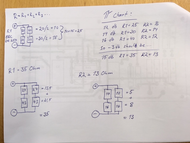

Hi Wayne,
Can you confirm my math in the compensation chart for the 4pi with -3db for the DE250 8ohm with the 2226J 16ohm midwoofer.
I understand the basics, but can you tell me a little more about the voltage sensitivity? Effects of doing this "wrong" with 16ohm woofer? Effects on the amplifier? Is there some amp better than the other in this configuration?
/forum/index.php?t=getfile&id=2257&private=0
Thank you very much.
n-a
  • Attachment: IMG_0959.JPG
    (Size: 82.77KB, Downloaded 1463 times)
Re: 4pi build and questions [message #89212 is a reply to message #89201] Wed, 14 November 2018 16:36 Go to previous messageGo to next message
There are two things to consider when substituting a driver with different impedance:
1. Voltage sensitivity
2. Reactive load
The voltage sensitivity is the easier of the two to understand. You need to match the SPL of the woofer and the tweeter at a given drive voltage. If their load impedances are different, then each will receive a different amount of power, because power is a function of the reciprocal of resistance (V2/R). So you have to match their sensitivity at a given voltage level, rather than to consider their W/M output levels. Or to make a long store short, if you substitute a 16Ω driver for a design that called for an 8Ω driver, then you must understand the 16Ω part will dissipate half the power of the 8Ω part at any given voltage level. So the 16Ω part will be 3dB lower than the 8Ω part, and you must compensate for that in the crossover. A 2226J generates about 95dB/2.83v/M whereas the 2226H generates 98dB/2.83v/M. Both parts generate 98dB/W/M, but the drive level to dissipate one watt is different.
The load presented to the reactive parts in the crossover is different, so the components must be scaled. Generally speaking, if the load impedance is doubled, then the inductance of the coils should be doubled and the capacitance should be halved. But this is not always exactly the case, so it's best to verify with testing.
Re: 4pi build and questions [message #89223 is a reply to message #89212] Thu, 15 November 2018 08:13 Go to previous messageGo to next message
n-a is currently offline  n-a
Messages: 5
Registered: November 2018
Ok, thank you so far. So to confirm this; double the coils (woofer), half the capacitors (woofer, but not C4), double the R3 to 16ohm, compensate -3db with the resistors in HF schematics. Can you confirm my math in the earlier post? Does it show?
My intention is to take measurements when the speakers are ready to confirm that is working as designed. But I understand that it should be build with the right parts. All the parts that I have are new and I thought that I have the 2226H, but what I received was 2226J. And the private seller didn't have the 2226H left anymore so I will try to make these work. Smile
I will send some pictures when the building starts.
Br,
n-a
Re: 4pi build and questions [message #89228 is a reply to message #89223] Thu, 15 November 2018 08:47 Go to previous messageGo to next message
If I were you, I would send back the 2226J drivers and get 2226H drivers instead.
Since you've just recently purchased and implied that's an option, I wouldn't think twice - I'd just do it. That way you'll know they're right.
But if you had 2226J parts and were going to try to make them work, what you've described is a good starting point. You'll still need to "dial them in" though. Measure amplitude response and polars, and slightly change the capacitor and/or coil values slightly to get the on-axis and off-axis response right. Pay most attention to the verticals, because that's where you'll see phase shifts caused by the crossover.

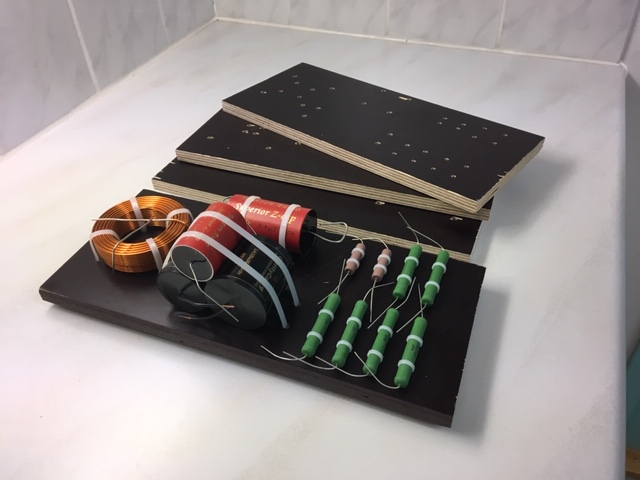

Re: 4pi build and questions [message #89302 is a reply to message #89201] Wed, 05 December 2018 08:33 Go to previous message
Messages: 5
/forum/index.php?t=getfile&id=2281&private=0
I made the crossover in two separate pieces. Taking my time, no hurry Smile
There is some cushioning under the coil and capacitors.
  • Attachment: Cr2.JPG
    (Size: 80.96KB, Downloaded 1351 times)
