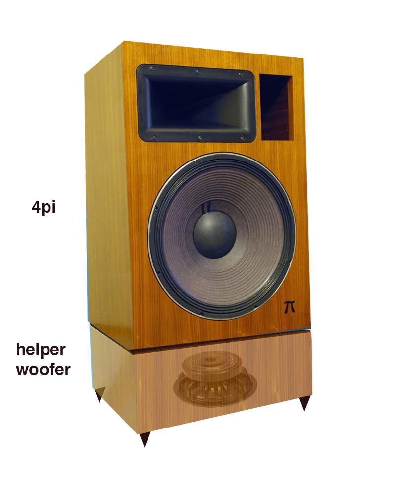

/forum/index.php?t=getfile&id=2282&private=0
So this is not a good idea, I guess (apart from the questionable photoshop skills)?
The helper woofer acts as a stand at the same time Very Happy

That won't provide all the benefits of a flanking sub, no.

My wife saw the sketch, no worries, it will not happen! Very Happy
