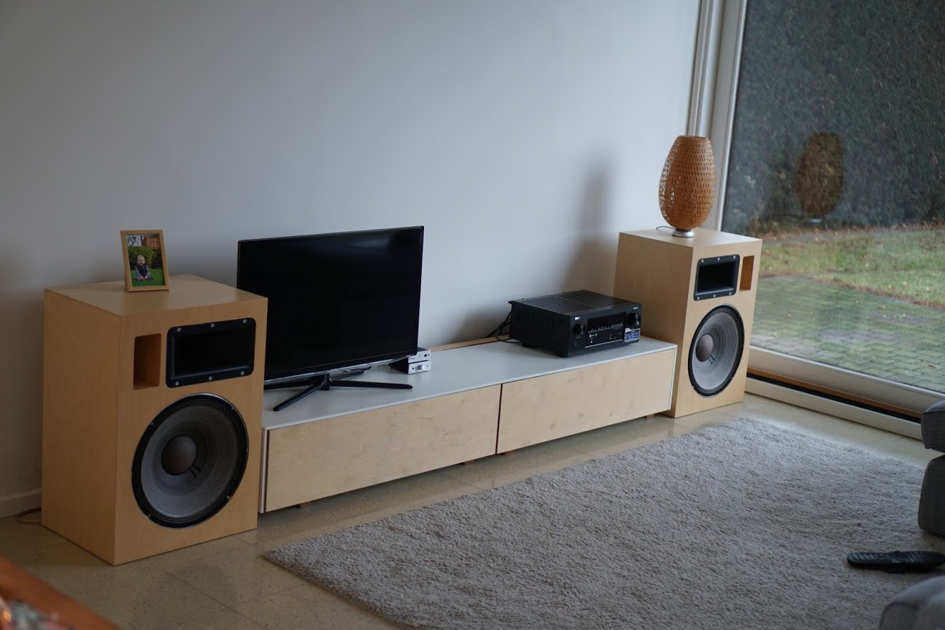

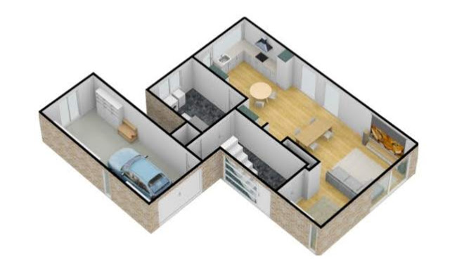

We have an L-shaped room and this is the best aesthetic speaker setup:
/forum/index.php?t=getfile&id=2265&private=0

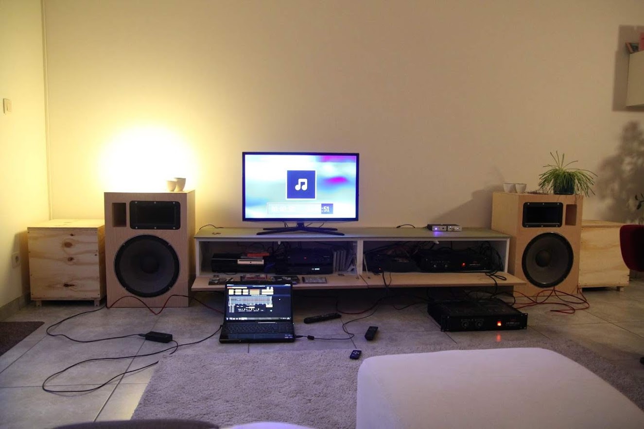

The 4pi speakers aren't toed-in, they are not on stands. Just on the floor straight forward. It's a compromise between good audio and aesthetics.
/forum/index.php?t=getfile&id=2266&private=0
There is no acoustic treatment (it's a living room). The only possible treatment are carpets, thick curtains and two book cabinets across from the speakers.

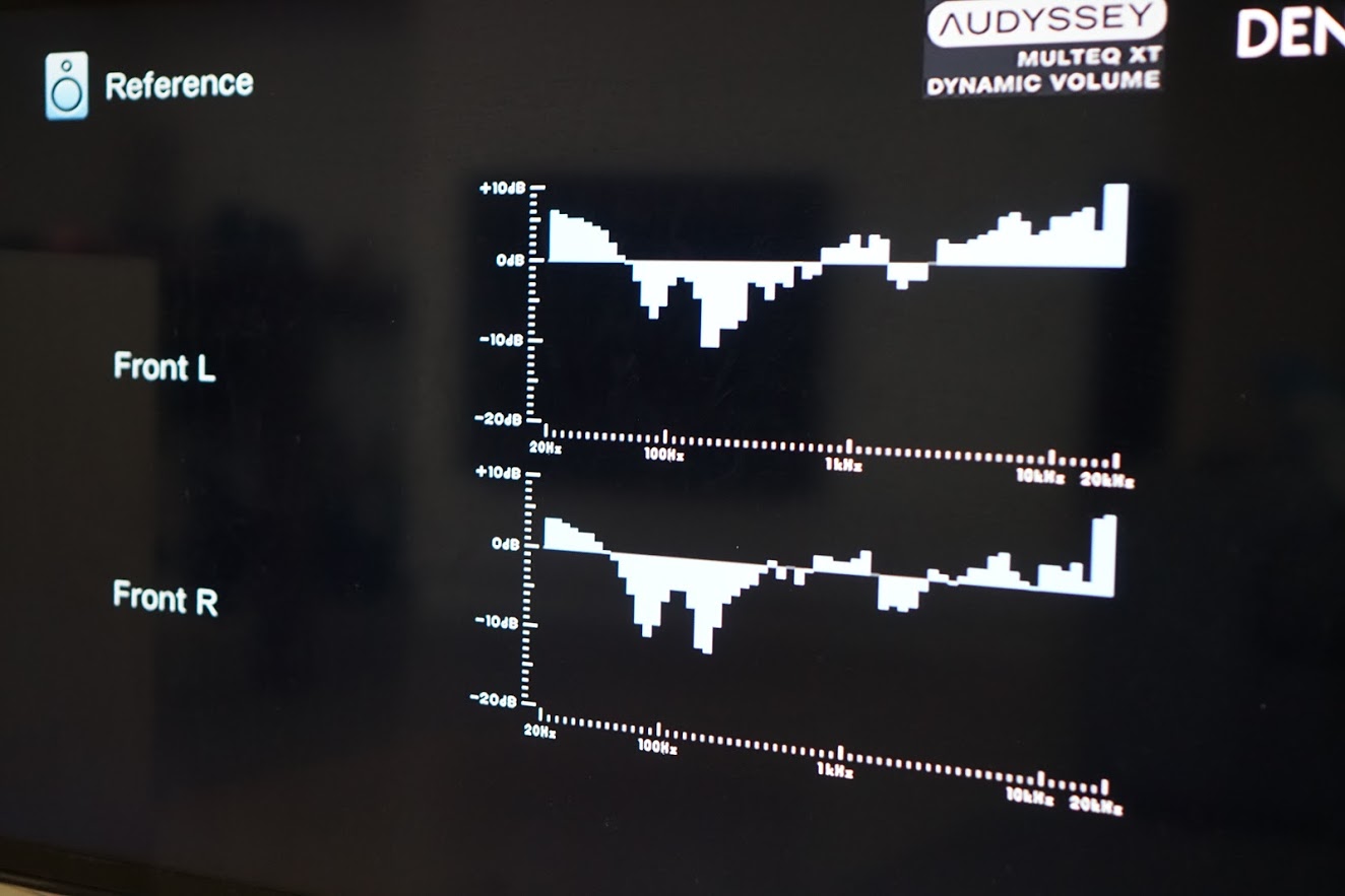

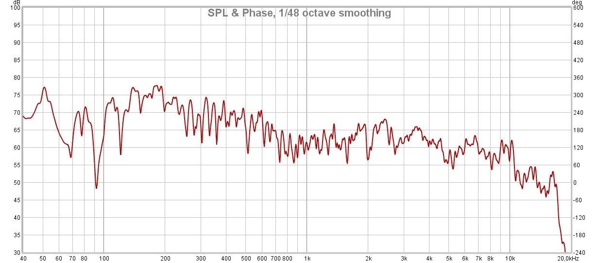

This is what audyssey EQ did to the sound:
/forum/index.php?t=getfile&id=2268&private=0

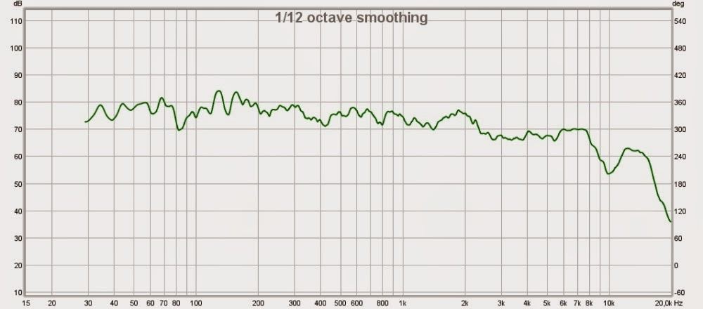

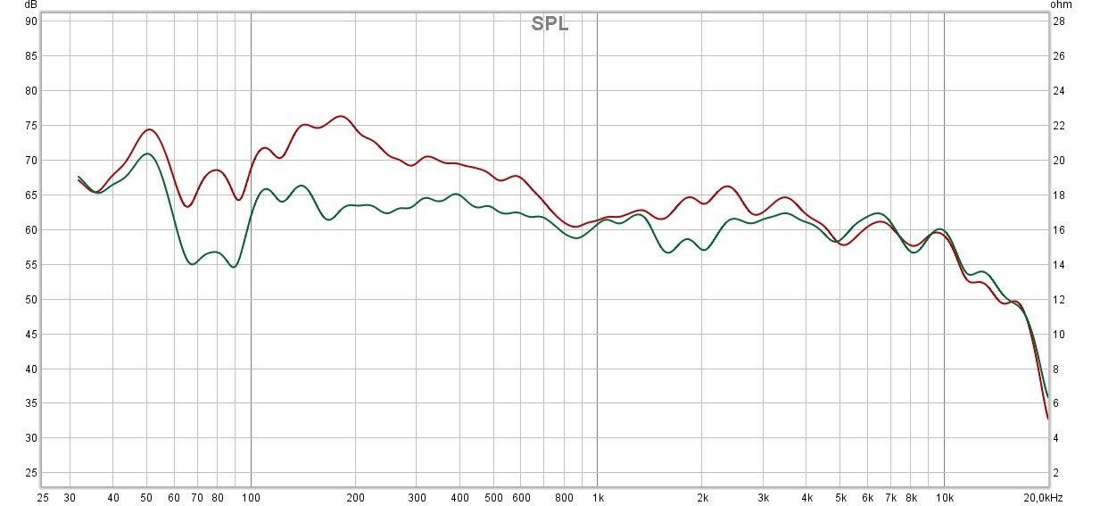

With REW software, I measured the differences (from listening position). Red is before EQ, green is after EQ:
/forum/index.php?t=getfile&id=2269&private=0

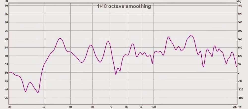

You can clearly see the differences. You can also see that some signal is lost in the 60-100hz area. I could tweak it with the audyssey app, but I didn't purchase it yet. But overall, it just sounds better.
I know the possibilities of flanking subs to deal with the modes in the LF area, and I experimented with it (2 passive 3pi subs). But somehow, it never worked quite well. Maybe because of our L-shaped room? The assymetrical placement of the speakers in our room?
So, is it possible?

It looks like you've done a very good job already, and I have no doubt you'll tweak your system further to make it even better still.
Congratulations!
You're "working with what you've got," which is what 90% of us have to do. High-quality uniform-directivity loudspeakers help a great deal here, but we're still hostage to room acoustics. That's what you're fighting, but you've done a great job.
I'm not particularly concerned with the amplifier you choose. It will serve you well provided it is a good quality unit that is used within its operating range, e.g. not overdriven and pushed into clipping. So choose your amplifier based on quality and features.
I see you're having the most trouble below 100Hz, and flanking subs aren't effective in that range. They can increase extension but cannot smooth room modes below 80Hz. The flanking sub configuration is intended to smooth the upper midbass and lower midrange, which is partly influenced by high-frequency modes but mostly affected by self-interference from the wall behind the speakers and side walls that are very near. Those boundaries cause a deep notch, usually in the 100Hz to 150Hz region, and this is too high for more distant multisubs to mitigate.
You may find that you do have a notch or two above 100Hz, and that a higher-resolution measurement would expose them. In fact, I think I see evidence of that in the dip around 120Hz. The measurement system likely smoothed a deep notch there, making it appear to be wider but less deep than it really is. Flanking subs would smooth that.
But for the region below 100Hz, distributed mutisubs are the best cure. You'll want to place subs far from the mains, and low-pass deep enough to prevent localization. Of course, the farther away they are, the more important it will be that low-pass be deep and steep. This, of course, limits their ability to smooth the higher-freqency room modes. You may have to limit the distributed subs to 60Hz to 80Hz, and that leaves the range above 80Hz unmitigated.
This is why I find a blended approach to be the best solution. Funny, I'm proposing a "blended approach to subwoofer blending." Laughing
Use flanking subs and distributed multisubs. The flanking subs can't smooth the modes below 100Hz by themselves, but when combined with a couple distributed subs placed some distance away, smoothing is very effective. Distributed subs are limited by localization problems, and so must be low-passed too low to smooth modes above 80Hz or so. Flanking subs are limited by close proximity to the mains, and so cannot achieve effective smoothing below 80Hz or so. But together, they can smooth the whole modal region.

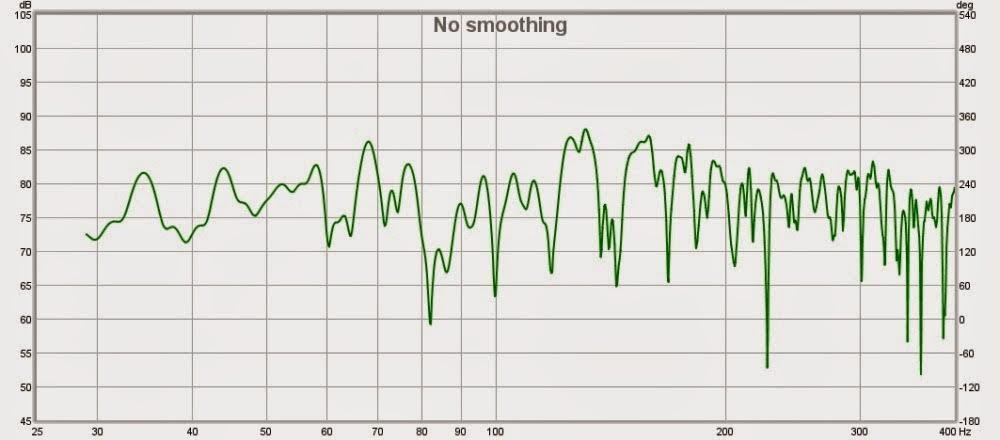

You're right about the notch at 120hz. I always like to smooth the measurements a bit because it gives a good feeling. Embarassed Very Happy

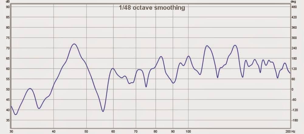

A less smoothed image of the measurement from listening position without EQ shows clearly what you predicted:
/forum/index.php?t=getfile&id=2272&private=0
So, generally this notches would disappear with flanking subs for the upper midbass and lower midrange whereas more distant multisubs can smooth out below 100hz?
So... Adding 4 subs. Rolling Eyes Very Happy
Do these subs have to be big and is the position of the distant subs crucial?
The Audyssey EQ flattens/lowers the frequencies from 100hz to 300hz (which caused somewhat a muddy bass IMHO). This lowered frequencies already made a much better image in de midrange bass.
Can flanking subs/distant subs solve this acoustic problem around 200hz too or is EQ here the only cure?

In my experience, 200Hz is about the limit of the flanking sub (helper woofer) approach. But I've blended the woofer with the mid(woofer) to ~250Hz in some loudspeakers and it has worked well.
Some specialized cases, like the constant directivity cornerhorns, allow for a wide overlap band. Many 2.5-ways are designed this way too. The midwoofer and helper-woofer are in fairly close proximity, so they can overlap to fairly high frequency.
But when I've run subwoofers as "helper woofers" - in the configuration I call "flanking subs" - I generally don't run them that high. They are localizable if the rolloff if made too high. I generally use low-pass between 90-120Hz second-order, which provides quite a bit of output in the 100Hz to 200Hz region because rolloff is so gradual.
You could try 150Hz second-order, which would definitely provide output up to 200Hz and beyond. But it might start to sound unnatural when run that high.
As for the modal smoothing below 100Hz, please do a search here for multisub setups. There are a few approaches, but most agree that if you have four subs (or more) it almost doesn't matter where you put them. Just don't cluster them together - Place them around the room.

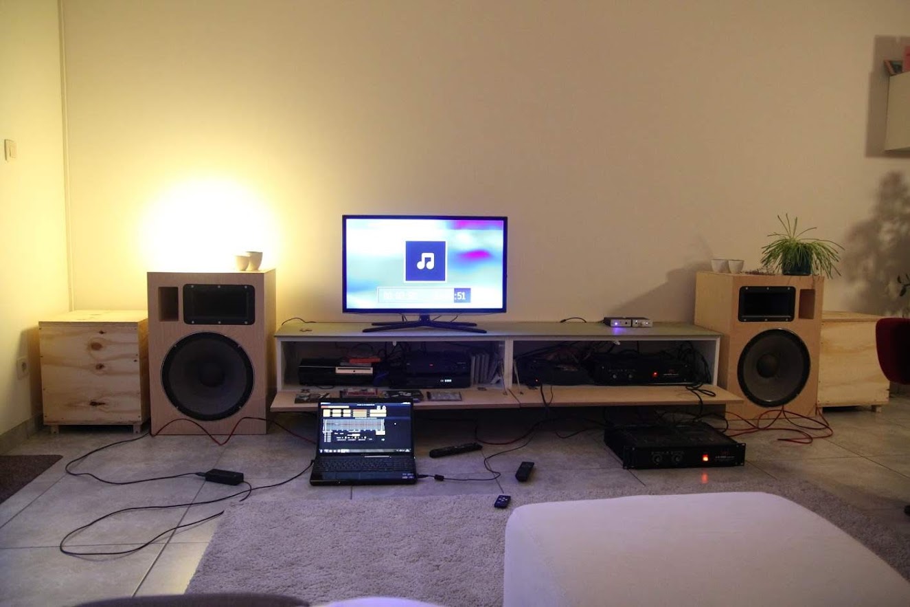

This was my setup with (temporary) flanking subs:
/forum/index.php?t=getfile&id=2273&private=0
