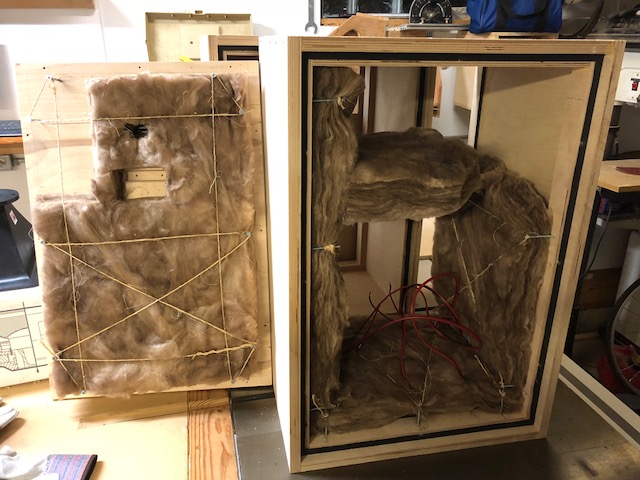

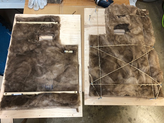

Working on insulation. Decided to put 2" wood screws around the perimeter of where any insulation is being installed to tether it in place. These will be moved around from time to time to various functions, so I wanted to make sure insulation is held in place well.
index.php?t=getfile&id=2165&private=0

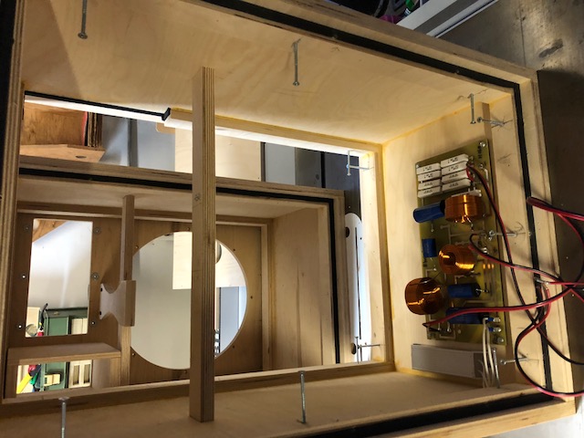

Cut separate pieces for each side and cut openings for wiring and braces. Tried to leave enough area around port so air would not be restricted.
index.php?t=getfile&id=2164&private=0
index.php?t=getfile&id=2163&private=0

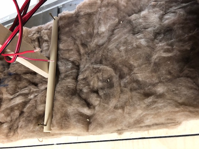

Also used another method to install insulation. Got some 5/8 dowels and put a screw in each side to hold insulation. I think it looks and works much better than old way.
index.php?t=getfile&id=2171&private=0
index.php?t=getfile&id=2170&private=0

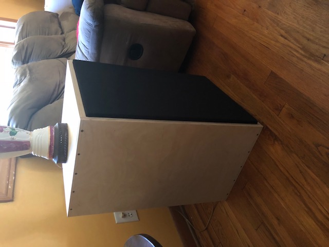

That got me to thinking about grill treatment. My original idea was to wrap speaker on 3 sides with cloth and make solid wood top. After positioning them, they are a bit tall for end tables and think in our room they will need to be raised a bit get sound at better level. Also, they are heavy. Need my son to help carry them. I am going to be transporting these to different functions and could see the grill cloth on the sided getting tore up when moving them. Sooo

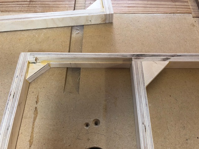

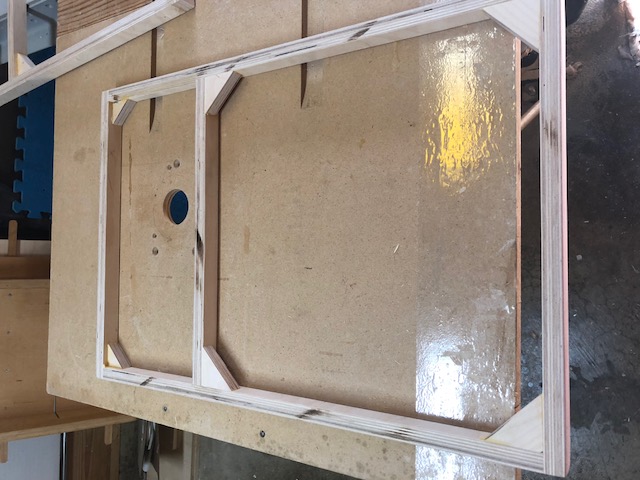

Decided to try an inset grill instead. Ripped 3/4" baltic birch scraps of cabinet to 1" depth. Have question though. Will this depth interfere with baffle diffraction? The frame is still outside of the 45 and 90 degree pattern of the wave guide. One thought is to cut off the top of frame to just cover the midbass driver if it does make a difference and work on a thinner or no grill for top. Can't go any less in depth as I don't want speaker hitting grill when playing normally. I have rounded the corners on frame, and for now will lightly tack up one grill to see how it goes and sounds.
index.php?t=getfile&id=2169&private=0
Had to rabbet out edge of frame to accommodate edge of wave guide
index.php?t=getfile&id=2168&private=0
Final position of grill on speaker
index.php?t=getfile&id=2167&private=0

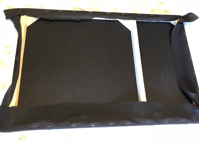

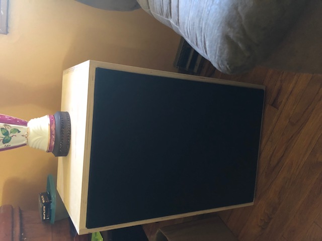

Stapling up cloth over frames. Wasted an hour scrounging around looking for my manual staple gun to fasten grill cover on frame. Just about resolved to go get another one, and wife says why don't you try our paper stapler. Worth a shot. Well it turned out to be perfect. Almost all the staple drove cleanly and they ended up below the level of the cloth so overall depth would not be increased.
index.php?t=getfile&id=2176&private=0
Sanded all the sides of the frame smooth so it wouldn't catch cloth. Set the four corner blocks around midbass to use as attachment point if needed. I sized the frames to fit snuggly inside the recess of the front cabinet so hopefully could just tap them in without any anchor. So far so good.
index.php?t=getfile&id=2175&private=0
Had to sand a bit extra on a few edges to get the fit right. Outside of speaker still in rough state. Pencil marks, not sanded only minimal screw in to get them playing.
index.php?t=getfile&id=2173&private=0
index.php?t=getfile&id=2174&private=0
index.php?t=getfile&id=2172&private=0
