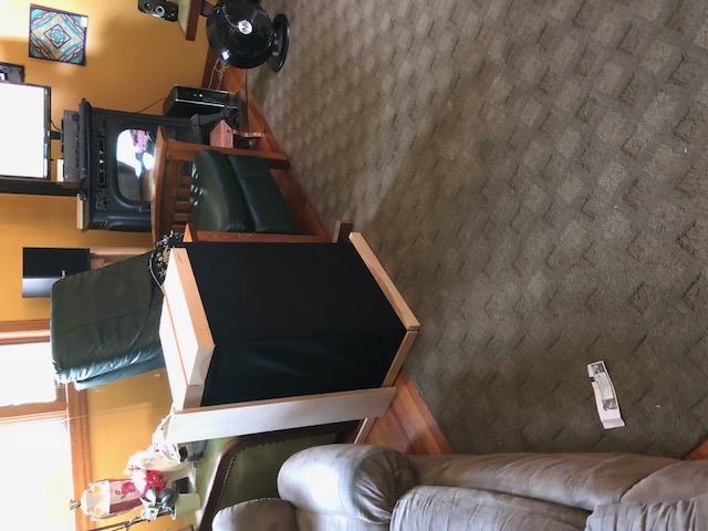

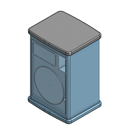

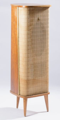

Working out a design to fit in living room. Hoping to be able to disguise them as end tables/plant stand for (WAF). 3 Sides will be wrapped with vintage grill cloth. Top and bottom capped with solid maple or walnut. May add some small trim pieces to finish out. All dimensions will be exact to Wayne's plans.
Below is first concept and old vintage Grundig unit I am borrowing design idea from.

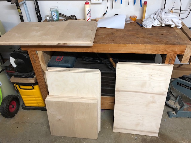

Bought a couple 3/4" birch plywood sheets and had them ripped in half at store to get them home.
Broke out my tools to break panels down to size. Laughing
index.php?t=getfile&id=2126&private=0
After a few minute hacking away, I had the panels sized.
index.php?t=getfile&id=2127&private=0

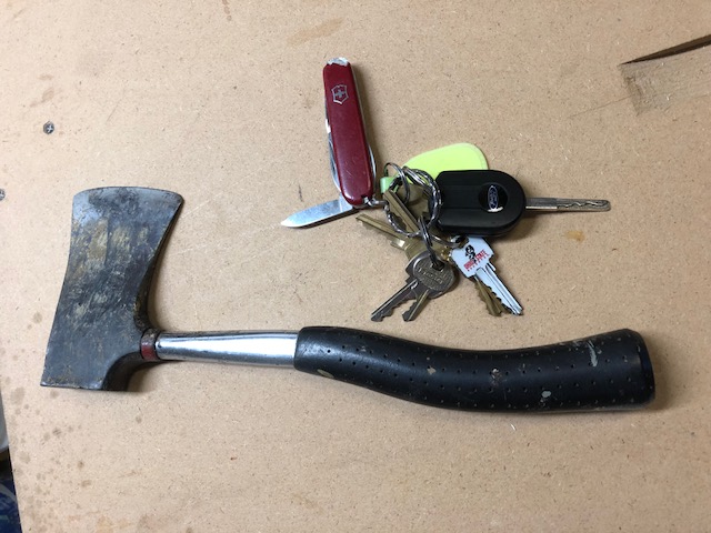

Best hatchet work I've seen in years Smile

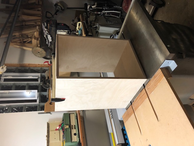

Decided to cut the depth down to designed depth of 14.5" They look much better.

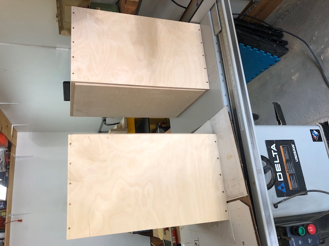

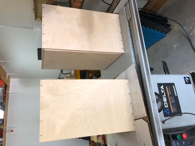

I glued and screwed the sides. They will be covered by something so not worried about looks. Trying for the most strength as I envision them being moved a lot. Back is loosely placed in to keep them square while glue dries.
index.php?t=getfile&id=2131&private=0
Got the cleats in and screws for back set.
index.php?t=getfile&id=2132&private=0

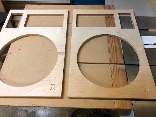

Baffles and pi logo cut.
index.php?t=getfile&id=2135&private=0

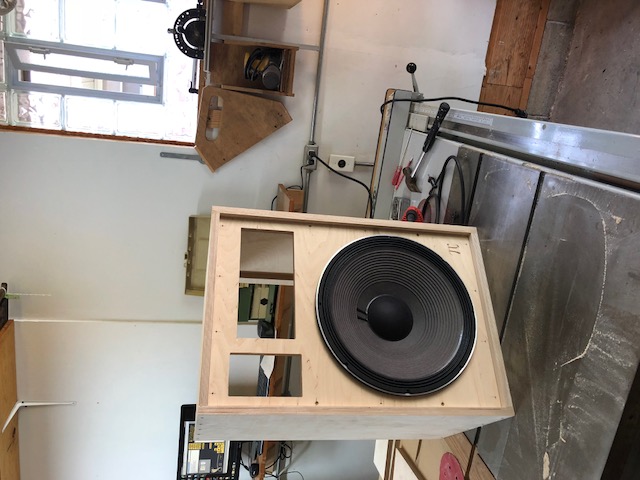

Starting to look like a speaker now.
index.php?t=getfile&id=2137&private=0

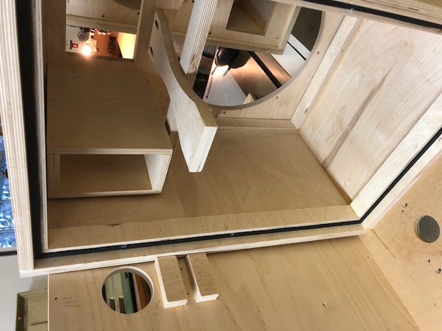

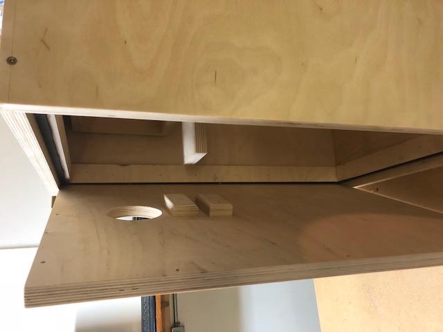

Had to remove some of inside trim as it was interfering with the port tube.
index.php?t=getfile&id=2138&private=0

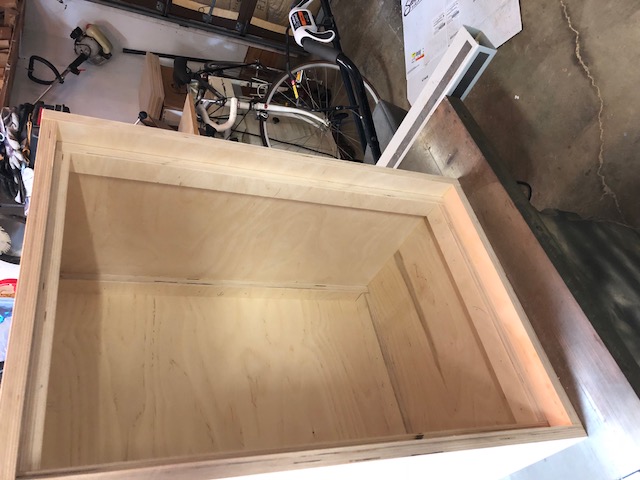

Finished inside of box
index.php?t=getfile&id=2139&private=0
Got to finally listen to just the woofer a bit. Hooked it up as right channel and kept existing small bookshelf speaker as left. Didn't have all ports on cabinet sealed and no insulation or bracing. Sounding much more like a speaker. Was amazed by how much the box was resonating at only 5 watts. The back panel was just tapped in place without any screws, and it felt like rubber. I've only had small bookshelf speakers prior to this and didn't realize how powerful this speaker will be. Definitely going to brace as recommended, and then some.

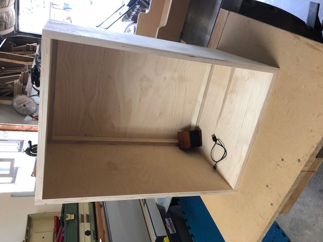

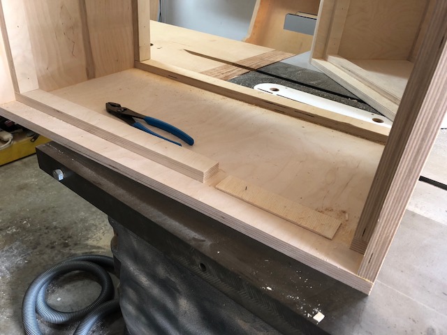

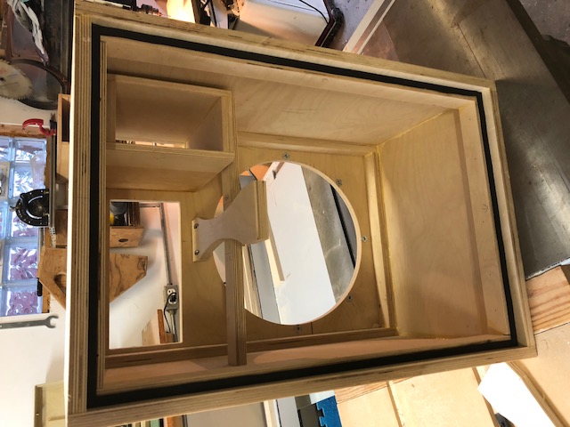

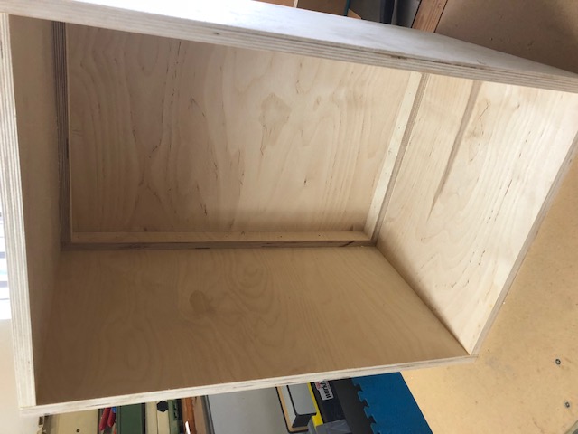

Installed cleats on back board of cabinet to guide brace going from front to back. Slightly tapered the front edge so it will funnel the brace into position. Will put two screws through back and into brace for extra support. On the front side of the brace I used some Kreg pocket screws.
Brace going from side to side is also held in place by pocket screws. Each brace is just a hair longer than needed to give a compression fit.
Port sides are 1/2 baltic birch I had lying around. Glued up port box separately on it's end and stapled with finish nails. After it dried I glued and screwed it to the front face, then added some 2 inch screws.
I'm on the fence with the black foam tape I used for sealing the speaker back. I screwed the back in while I was fitting the braces, and when I took the back off, the foam stayed about completely compressed. I guess I was expecting it to bounce back a little bit.
index.php?t=getfile&id=2155&private=0
index.php?t=getfile&id=2156&private=0
I have some black speaker grill from parts express and wanted to mock up what the final speaker would look like. Plan on wrapping 3 sides with the cloth. Tried some walnut and it was ok. Liked the maple pictured here a lot better. As of now, my plan is to build a solid 2" thick slab that overlaps a bit on all sides. I will recess the center around 3/4" so it stays in place and covers the top edges. Will oversize a bit to allow for seasonal wood movement. I may also run a maple board about 5" to 6" down the back of each side as pictured. It breaks up the blockiness of the mass. (Hat tip to Josh).
index.php?t=getfile&id=2157&private=0

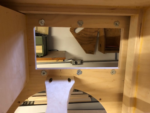

The goodies from Wayne came in. I purchased the x-overs and wave guides. I only have one set of drivers (JBL 2226 Midbase and B&C 250 cd) at this point, so time to get one up and going.
Placed the waveguide in cutout to mark for mounting holes. Drilled and inserted t-nuts. Somehow I got one of the holes a hair off so will have to pull t-nut, ream hole and reinstall. But that can wait.
index.php?t=getfile&id=2159&private=0

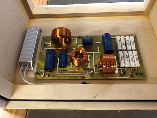

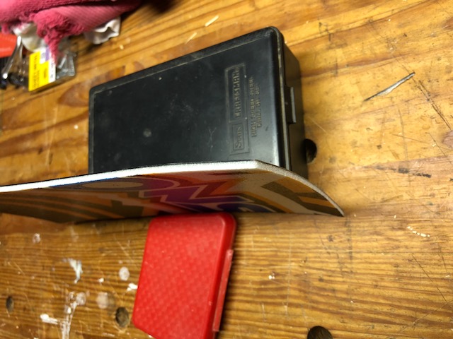

Wayne suggests putting something under x-over to keep it from vibrating. Took a tour of our basement and found and old snow sled that would work great. It is just a thin piece of plastic laminated to 1/8 foam.
index.php?t=getfile&id=2160&private=0
Measured and cut with utility knife and it worked great. Had to enlarge x-over holes just a bit to allow screws through. Mounted it and resistor to bottom of cabinet.
index.php?t=getfile&id=2161&private=0

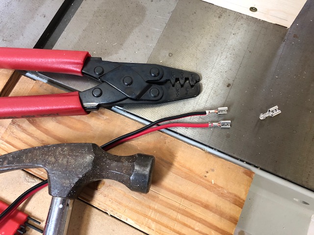

Have been doing a little more electrical work than normal lately. Finally got some crimpers to make electrical connections and wishing I had bought them years ago. They make really strong professional looking connections. I crimped all the wires for one speaker. I would think spade lugs would give a better connection, but both drivers had only spring loaded connections, so I used those.
index.php?t=getfile&id=2162&private=0
