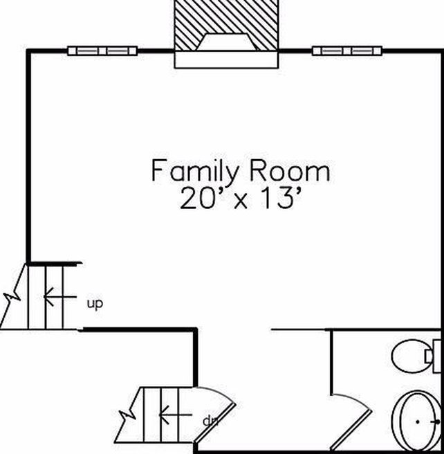

im looking for a nice set of speakers for my home audio. i do not know what im getting myself into when it comes to speakers, i plan on doing a whole system eventually. i have a current system that works (mostly free hand me downs) but sound quality is not all that great. (compared to my father in-laws diy speaker build)
im looking at one of the diy speaker kits because i do enjoy wood working on the side and would want to add my own personal touch to them. currently my entertainment system is my everything. i game (pc and xbox) watch movies and play music loud enough to hear while im on the back deck or doing the honey do list.
i only have a receiver and two floor standing speakers which im looking to replace at the moment. i have a room about 20x13 with 10 ft ceilings where the speakers will be placed.

index.php?t=getfile&id=2085&private=0
  • Attachment: 1.jpg
    (Size: 35.93KB, Downloaded 914 times)

Since you mentioned the six π loudspeaker, I'll respond to those specific questions. As for your general questions, I'll leave those to others to respond. If you want more detailed information about π Speakers, I suggest posting on our support forum:That said, I'll answer your questions briefly here.
In your room - the room layout you showed above - I would absolutely recommend constant-directivity cornerhorns, like the six π or seven π cornerhorns. They will make the best use of the room's layout. To understand why, see "Speaker placement and wavefront launch" from the π Speakers FAQ. You can also learn about options and upgrades in this FAQ. Look in the "Models, Upgrades and Driver Characteristics" section. The link called "Upgrades" tells you what benefits you can expect from each option.
If you are a competent woodworker, the constant directivity cornerhorn isn't a very difficult build. It isn't as easy as a typical "box" speaker, but it doesn't have an internal labyrinth with a lot of pieces like folded horns, so it isn't nearly as hard to build.
