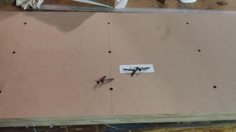

Can you provide me with the infos for flush mounting the drivers on the 2Pi towers?
Specifically, the outside diameter of the frame, the thickness of the frame, the bolt hole circle diameter, and the number of bolts for both drivers.
The part numbers are fine provided I can get manufacturers info online.
A nice bonus would also be the hook up plate dimensions.
teaser pic.
You know this would look much better with driver cutouts...
index.php?t=getfile&id=2076&private=0
