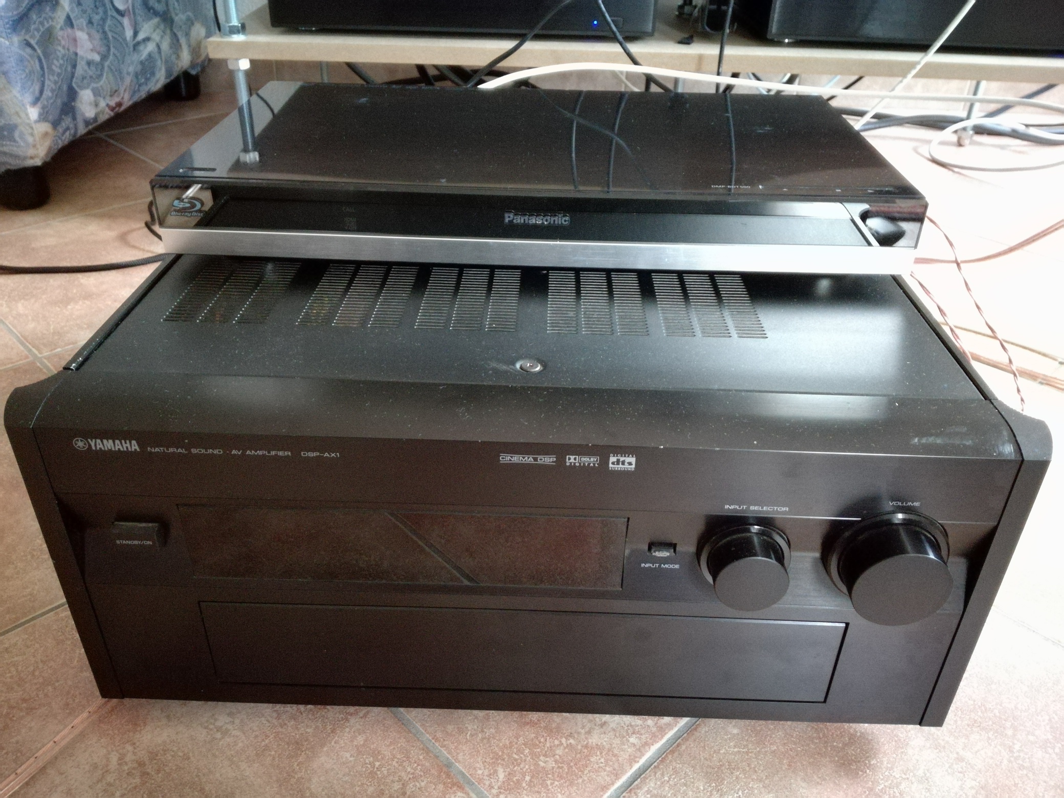

index.php?t=getfile&id=2036&private=0
I bought an old Yamaha DSP-AX1 multichannel amplifier and a Panasonic DMP BDT-500 blu-ray player with all the current hd audio encoding. It also has analog audio outputs up to 7.1 channels, so I can skip the obsolete digital section of the Yamaha.
