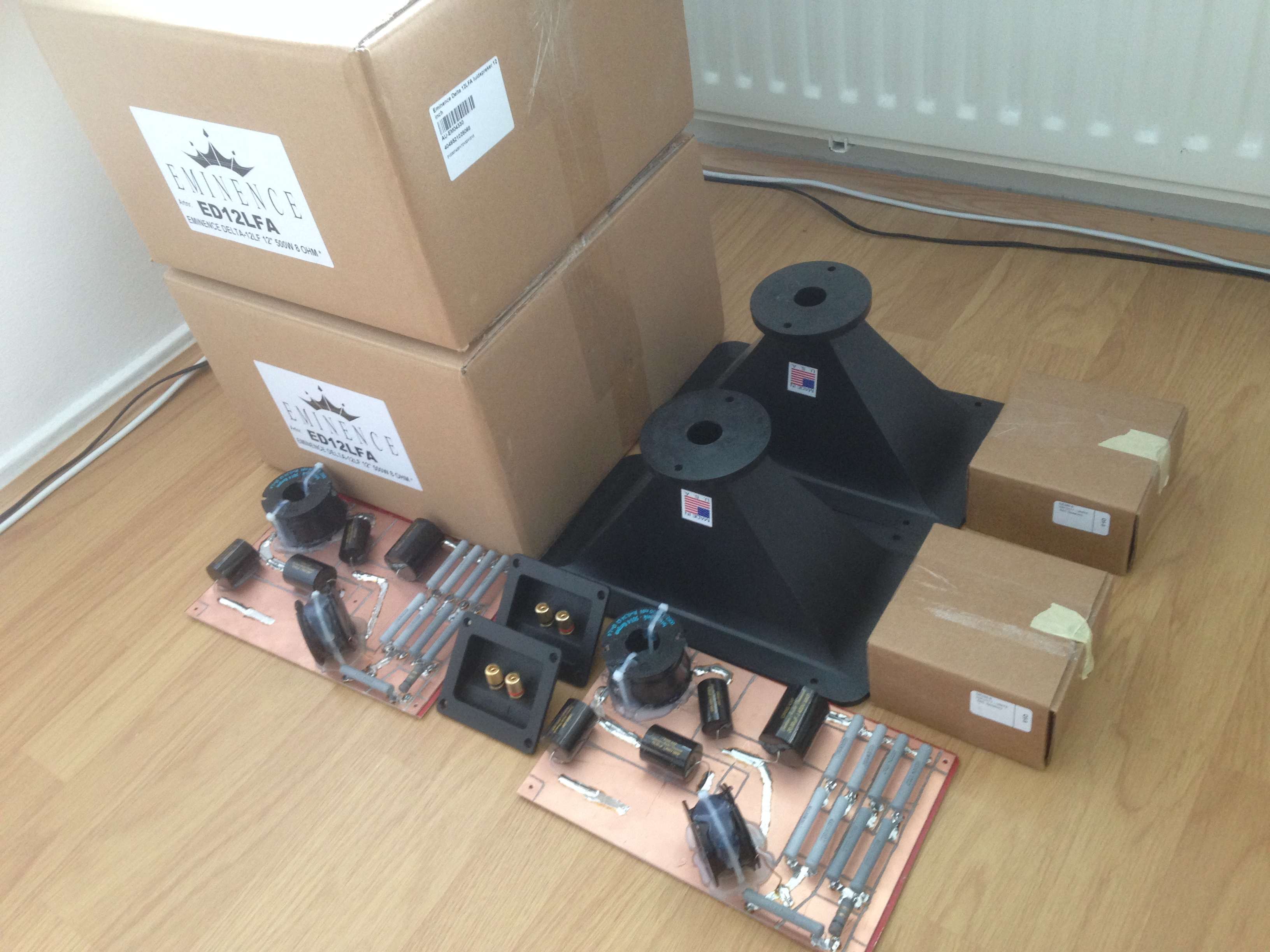

So I finally got some time and spare money to start collecting parts for 3Pi speakers... crossover is made with left-over PCB's I had with good/standard/whatever quality parts I could find for reasonable price: Jantzen Cross-Cap's and Bigger gauge coil for the woofer (1,4mm wire) and Metal-film non-inductive 10Watt resistors. I'm still waiting on delivery for 100Watt 8 Ohm dummy load resistors to be mounted off-board as per drawing.
index.php?t=getfile&id=2003&private=0
For the speaker components I wanted to start with all-standard Eminence - but I got lucky and found a good deal on summer fire-sale and got myself B&C DE250 for just 25.- Euro more than PSD2002 per piece.
For the woofer I wanted to jump right on the upgraded part but it's price in Europe is just silly high (300,- Euro per piece) so I settle down for stock part Delta 12LFA.
Now that the funds are exhausted, I have to wait till next month to start working on the box itself, I will surely post many pictures of the build...

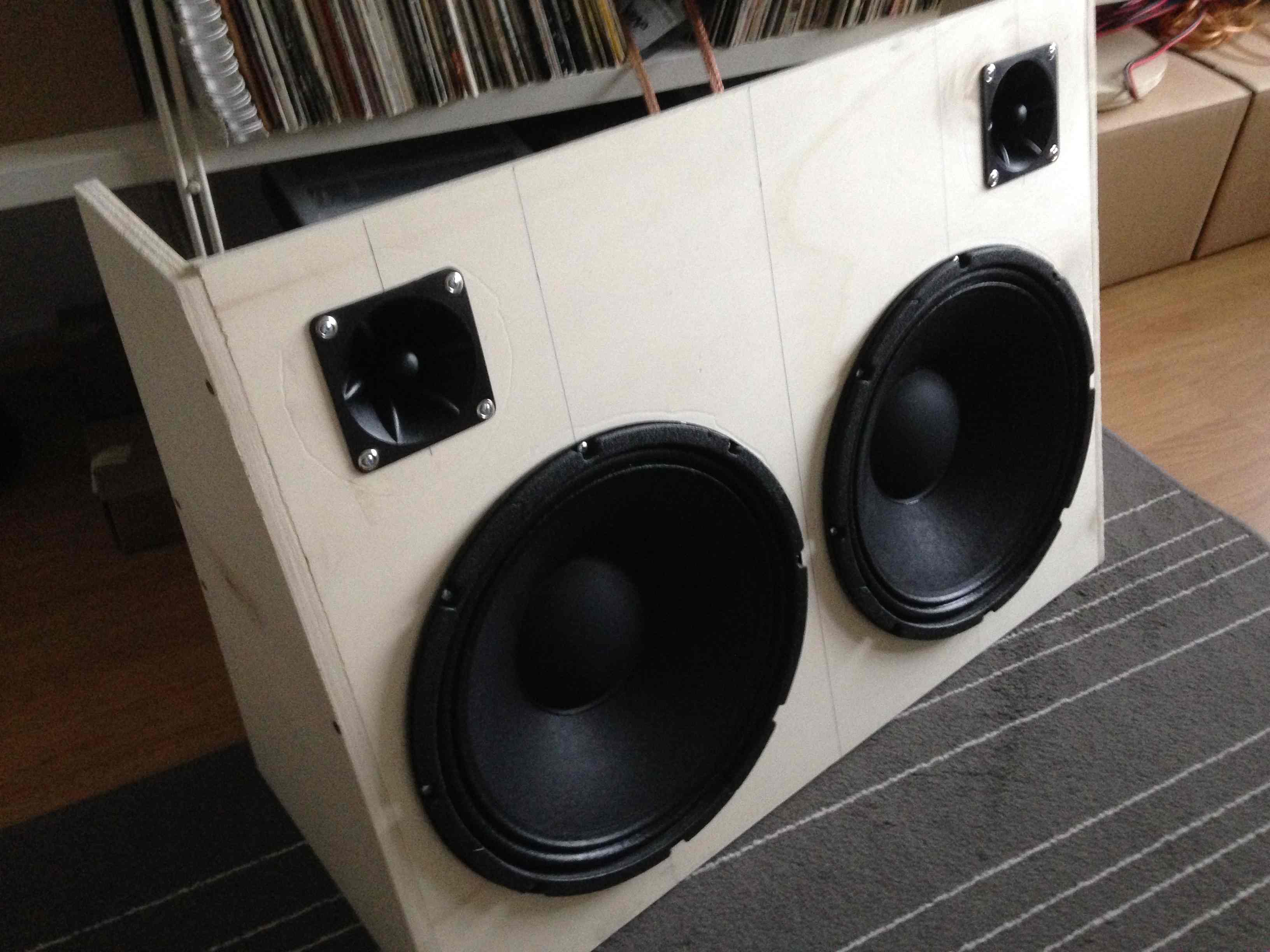

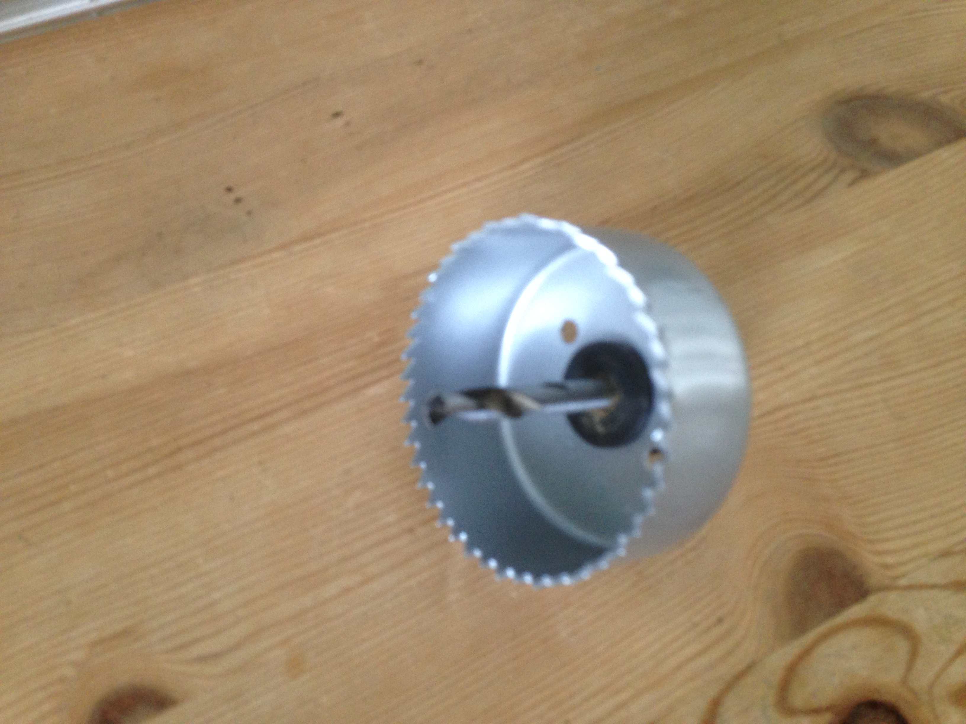

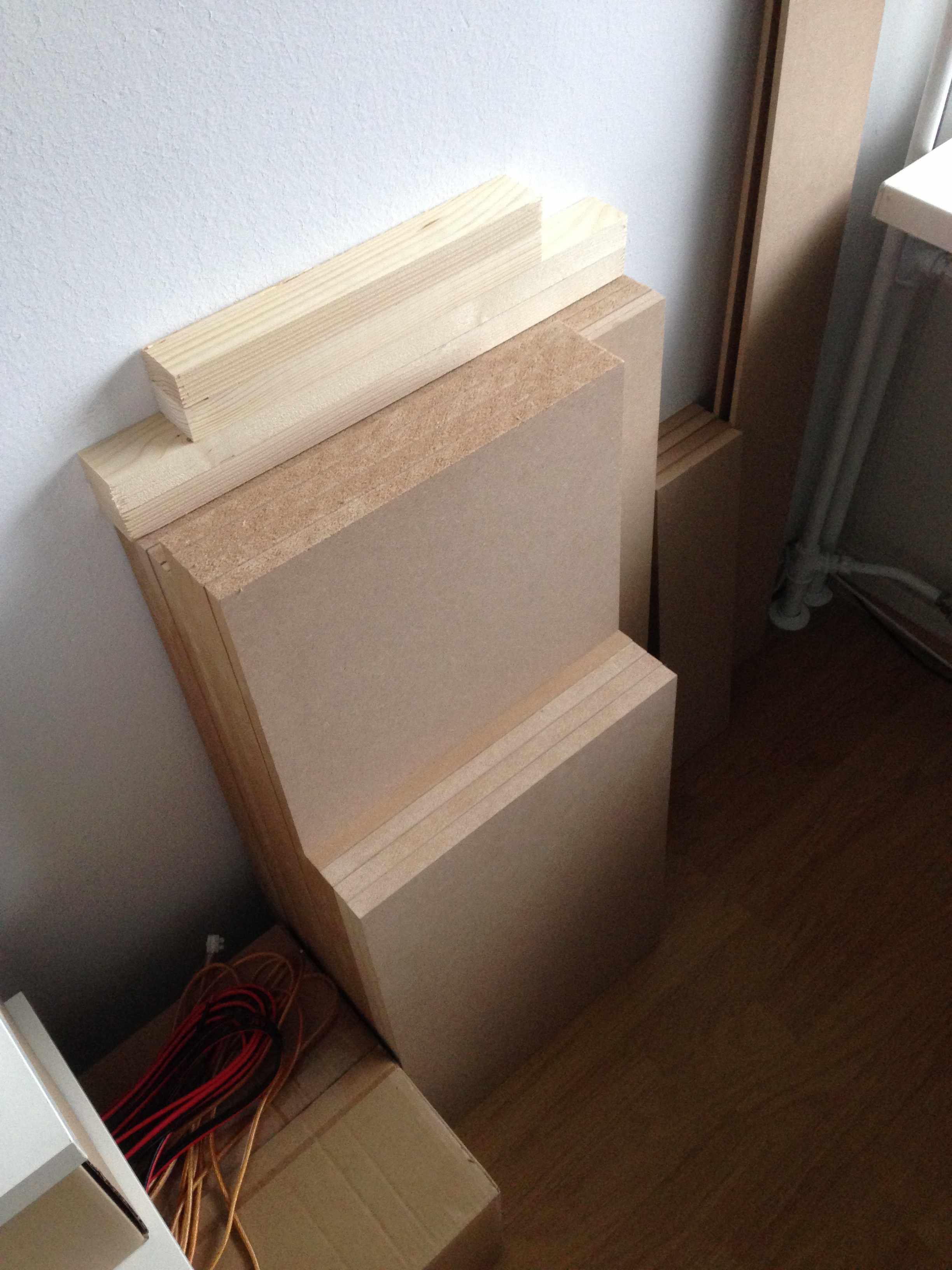

Well, I finally started with cutting some wood, also sourced 2,5 inch drill for bass port ( was not easy find in europe ) and my 100WATT 8 Ohm dummy load I ordered 2 months ago never came so I had to order this time from USA and wait again some 2-3 weeks... we will see, I hope soon to start assembly...
In the mean time I was breaking-in those Eminence 12LFA's in a guitar box - open back and they sounded ok, but need a tweeter to sound best... in short 12LFA's are not great guitar speakers, for BASS guitar they are awesome but need proper enclosure with the port...

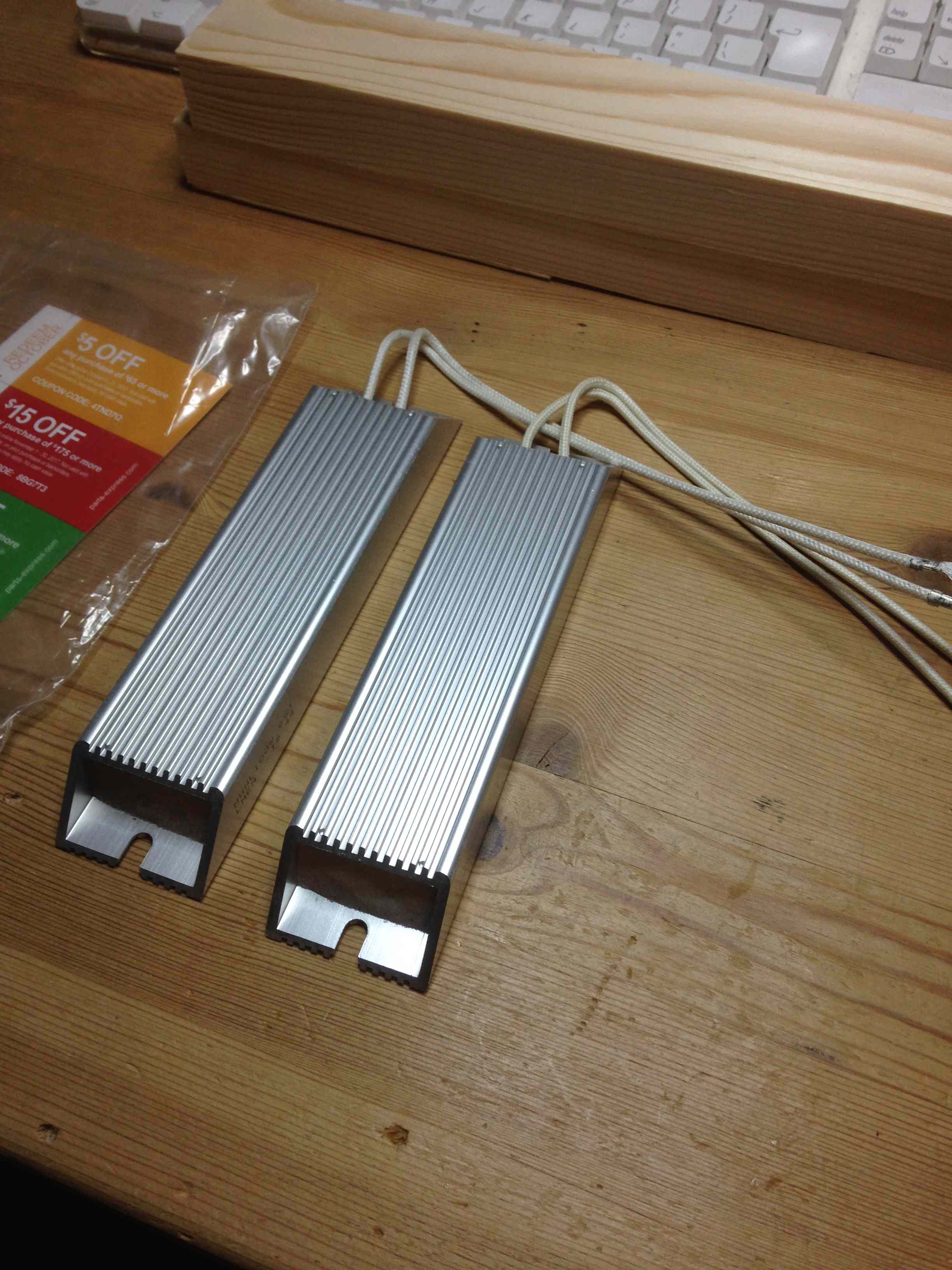

You mentioned the 100 watt resistor. I know it is used in the 4pi, but not sure it is used in the 3pi? Wayne, does he need the big resistor with the woofer he is using?
Re: New 3Pi build [message #86456 is a reply to message #86448] Wed, 01 November 2017 12:23 Go to previous messageGo to next message
Yes, the 100 watt Zobel resistor is used in the three π loudspeaker just like it is on the four π model.

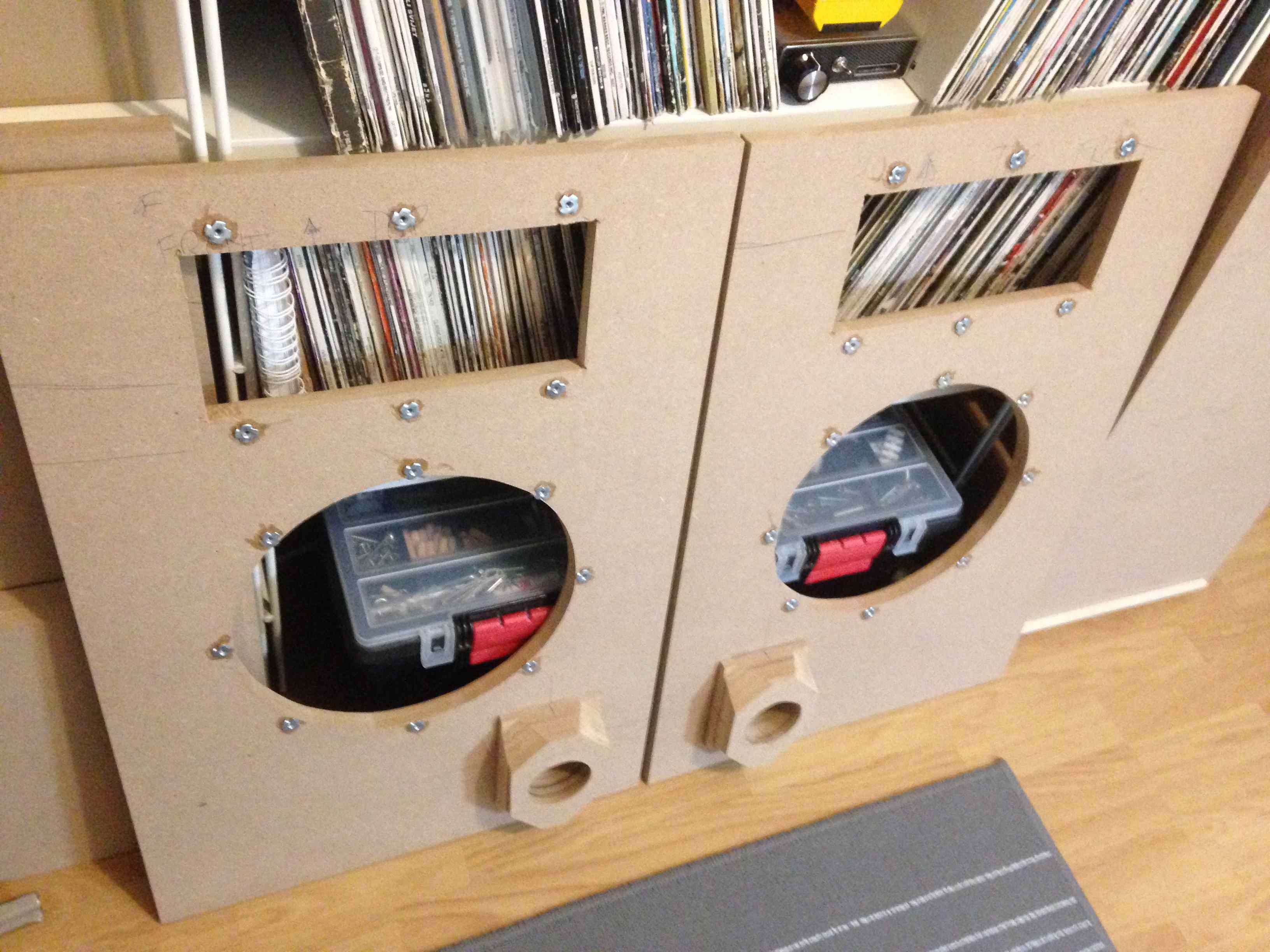

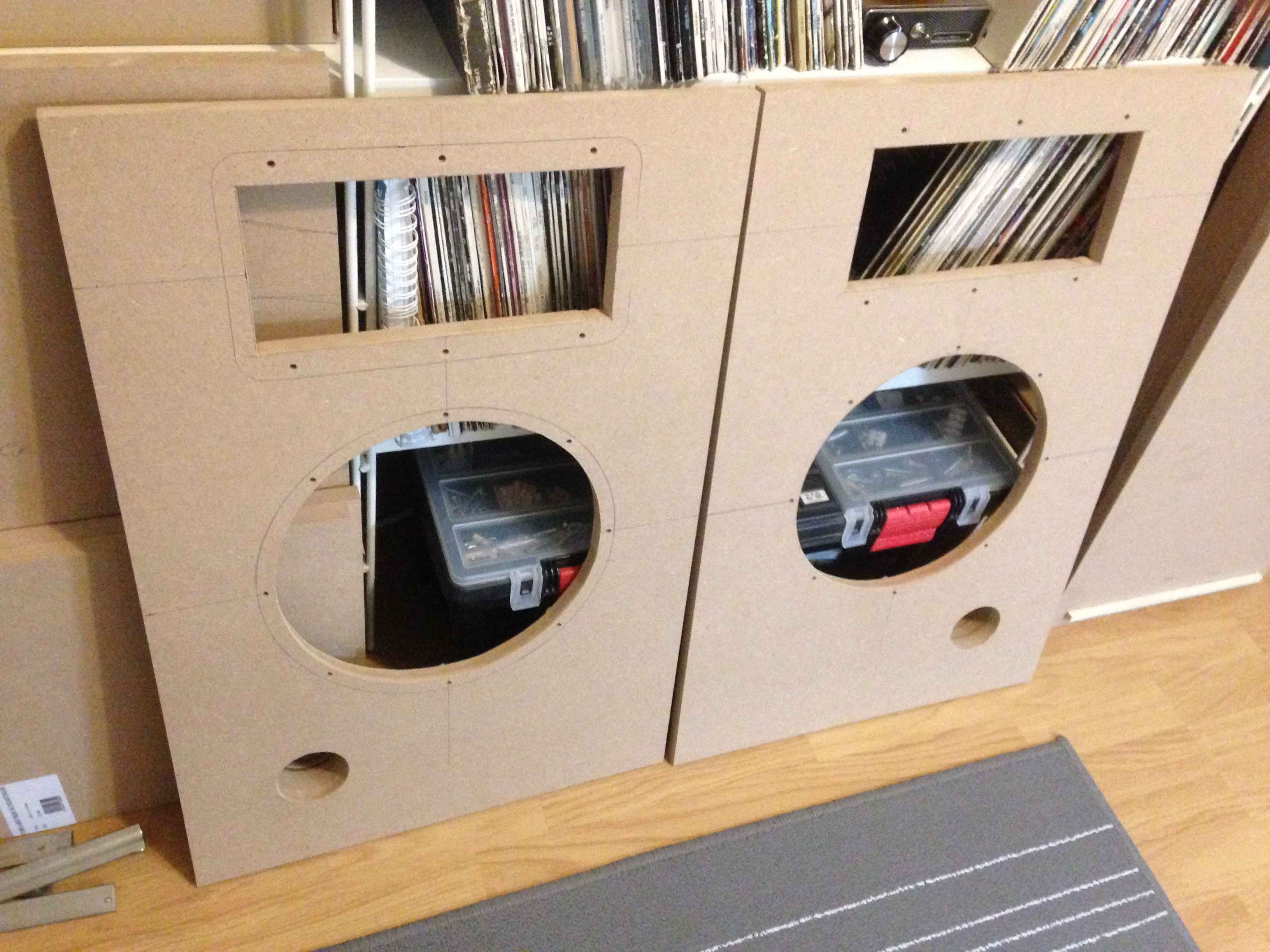

OK, so here I'm again with some progress... trimmed all the panels to exact same size, succeeded to cut openings for woofer & horn along with T-nuts, it took me forever just to drill those bass ports, probably most difficult job I ever done with MDF ( I wish Wayne had some alternative design with standard plastic port size... ).
Now I can finally move to glueing everything together, then sanding, painting, sanding again, placing isolation, wiring... Shocked it could be ready in two weeks if all goes according to plan and yes I received Dummy load 100WATT 8 Ohm resistors from Parts-express so now is crossover complete as well...
btw, 100WATT resistor is actually not needed for 3 Pi if you using AE 12TDS if I'm not wrong?

Re: New 3Pi build [message #86516 is a reply to message #86515] Fri, 10 November 2017 16:39 Go to previous messageGo to previous message
Looking great!
You could have used a plastic or cardboard port tube if you wanted. Many of our speaker models use a cardboard duct. For those models, we use tubes that are made for storing or mailing large blueprints. They have really thick sidewalls - so thick they're tough as baseball bats. Cut their length to size with a table saw and they work great for speaker ports. But the port on this model is pretty short so we glue small wood blocks on the baffle and drill through them, same as you've done.
About the Zobel resistor, you're right that the AE woofer doesn't need it. Eminence and JBL woofers do.
