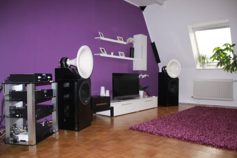

I'm going to build a couple of 4Pi, so please Wayne, I appreciate the plans so much Wink
I will use Eminence Omega pro 15A and B&C DE250.
I have a question: I would bring some modifications on the original shape of the 4Pi, because of some ... home design needs.
I was thinking about the Eminence in a 4-5 cubic feet separate enclosure, and the B&C mounted on a Jabo KH-30 horn, something like these:
index.php?t=getfile&id=1973&private=0
Do you think is it possible? What about crossover variations?
Thank you so much guys!
Re: 4Pi Speaker variation [message #84982 is a reply to message #84973] Tue, 11 April 2017 12:25 Go to previous message
That's very attractive!
But it's a whole different beast. Without our waveguide, the design is different. It will have a different radiation pattern, different response and will need a different crossover.
