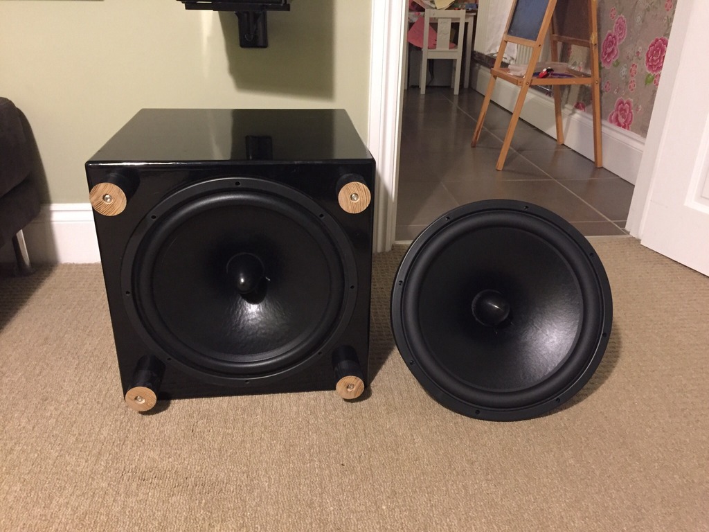

Re: Mono "flanking sub" [message #83753 is a reply to message #81624] Fri, 21 October 2016 12:52 Go to previous message
jonone is currently offline  jonone
Messages: 67
Registered: October 2015
My new woofer has arrived, so I can use them as flanking subs, I've also had some new cabs made so they will be forward firing this time.
The Amps ordered and the cabs are being sprayed, so I'm pretty much ready to rock.
index.php?t=getfile&id=1952&private=0
