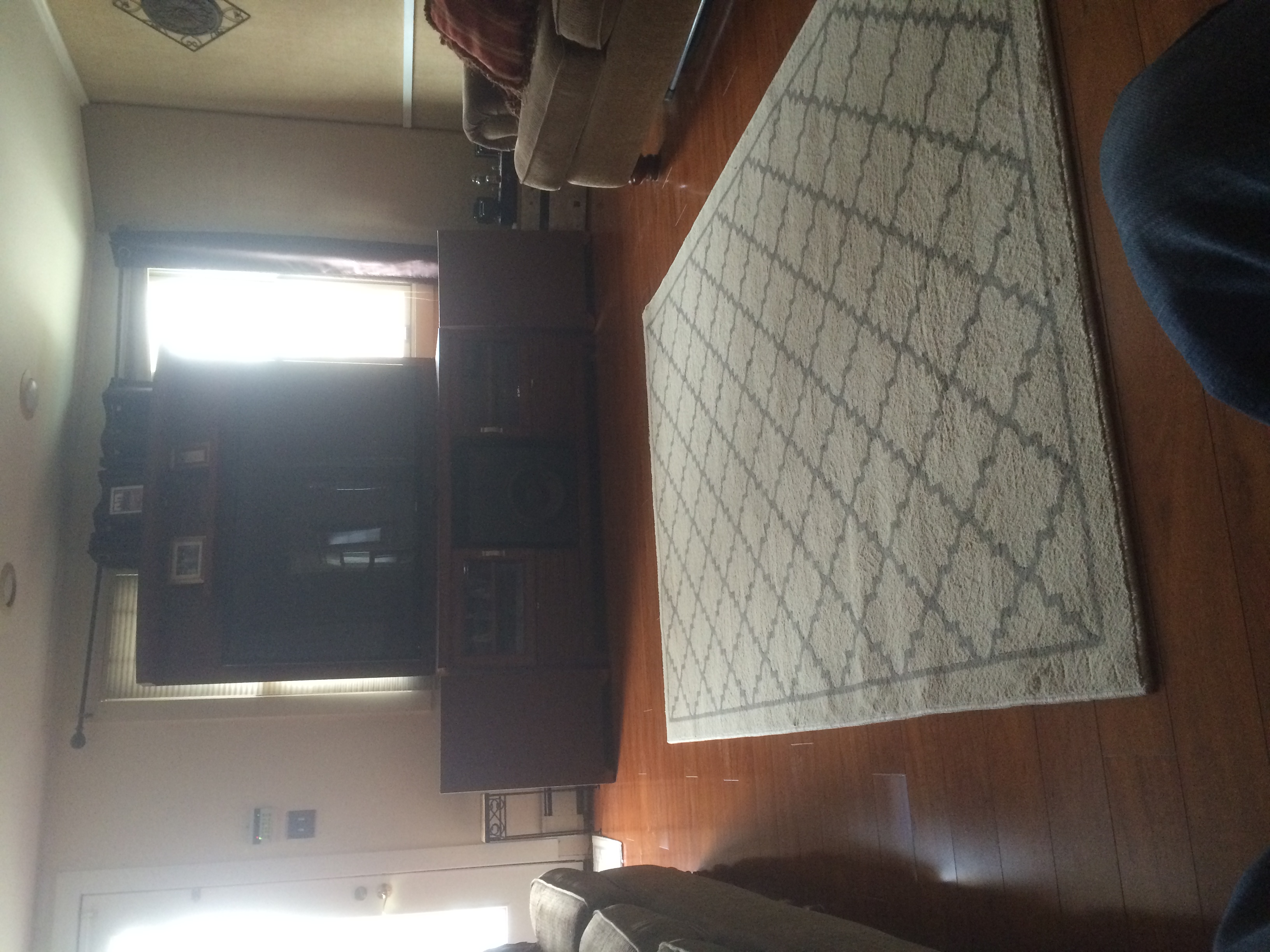

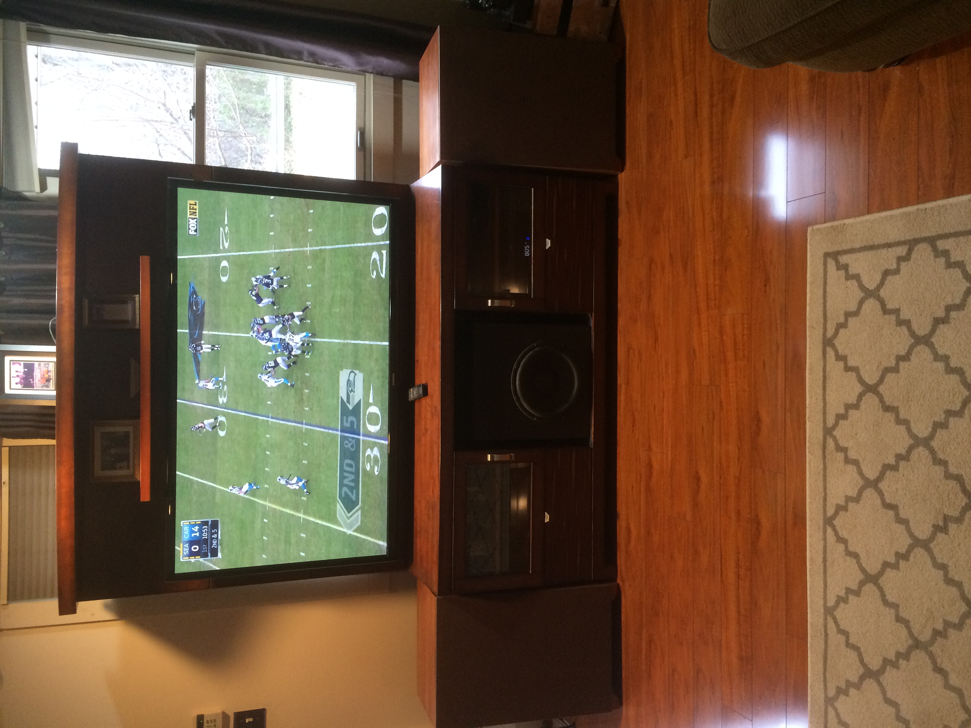

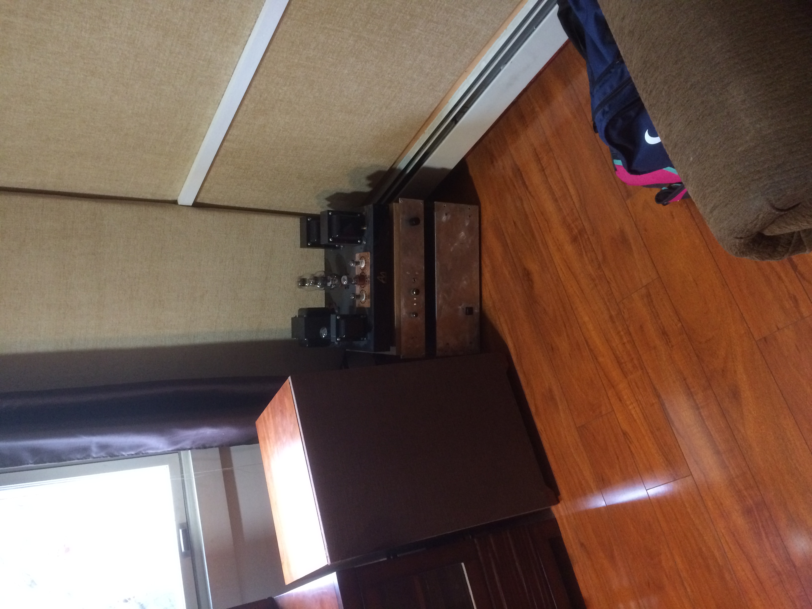

Here is my current set up.
It sits along the front/narrow wall (15.5').
Front door is on the left.
When I incorporate the flanking subs, I will have to re-locate the
speakers and tv along one of the long/side walls (27').
I will also be able to angle (toe in) the mains for better stereo image for all in the room.
I know firing the speakers from the longer wall is not best, but it's the only way I can utilize the flanking subs until I move everything downstairs.
