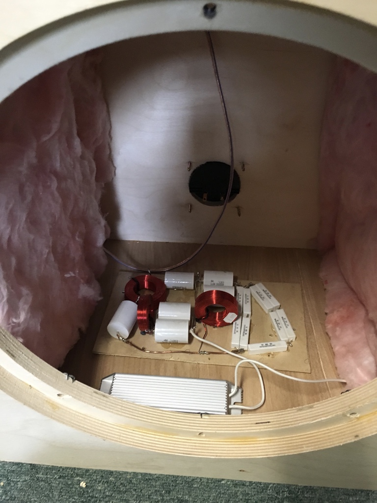

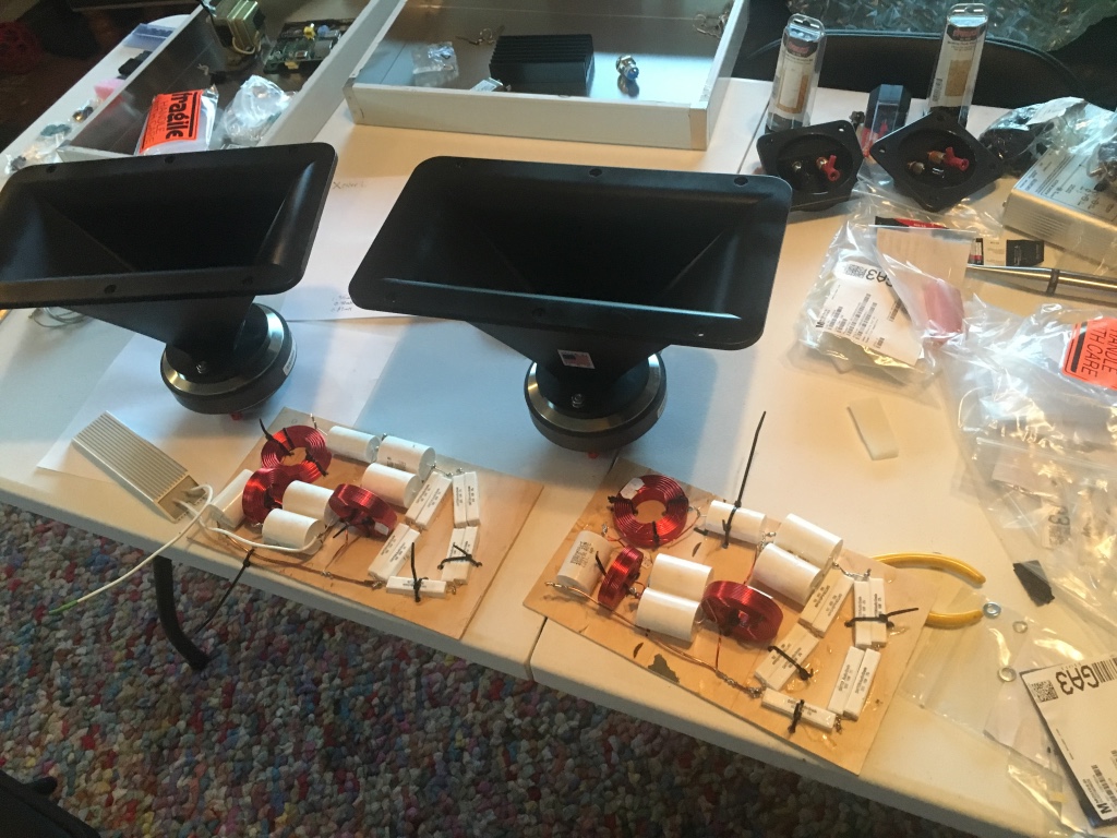

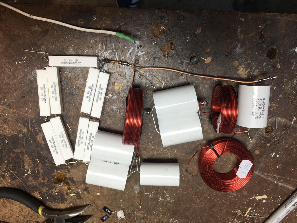

Next I worked on the crossovers. I bought all the parts on Mouser. I got two 10uF capacitors cheaper than one 20uF capacitor so I wired them in parallel.

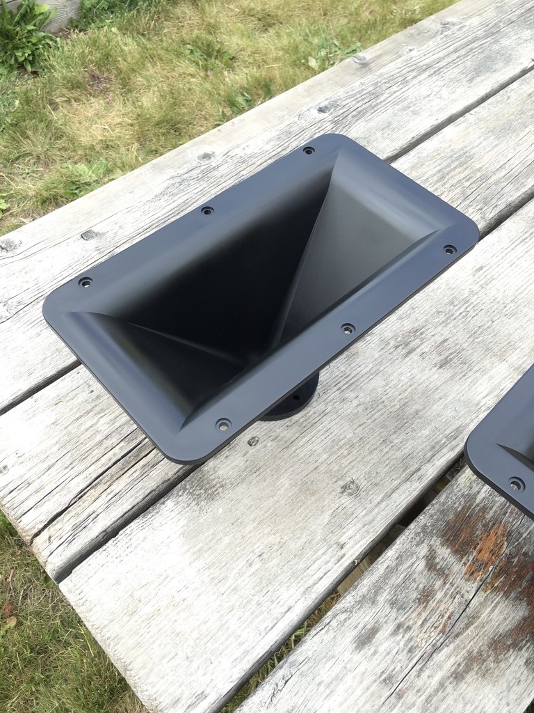

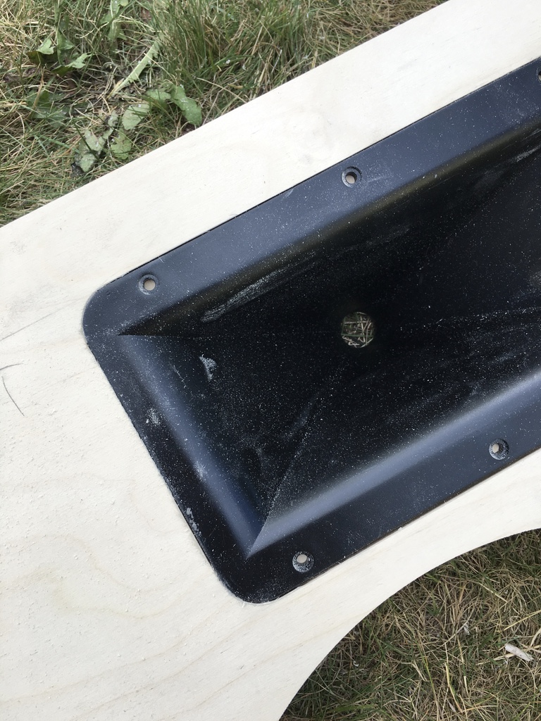

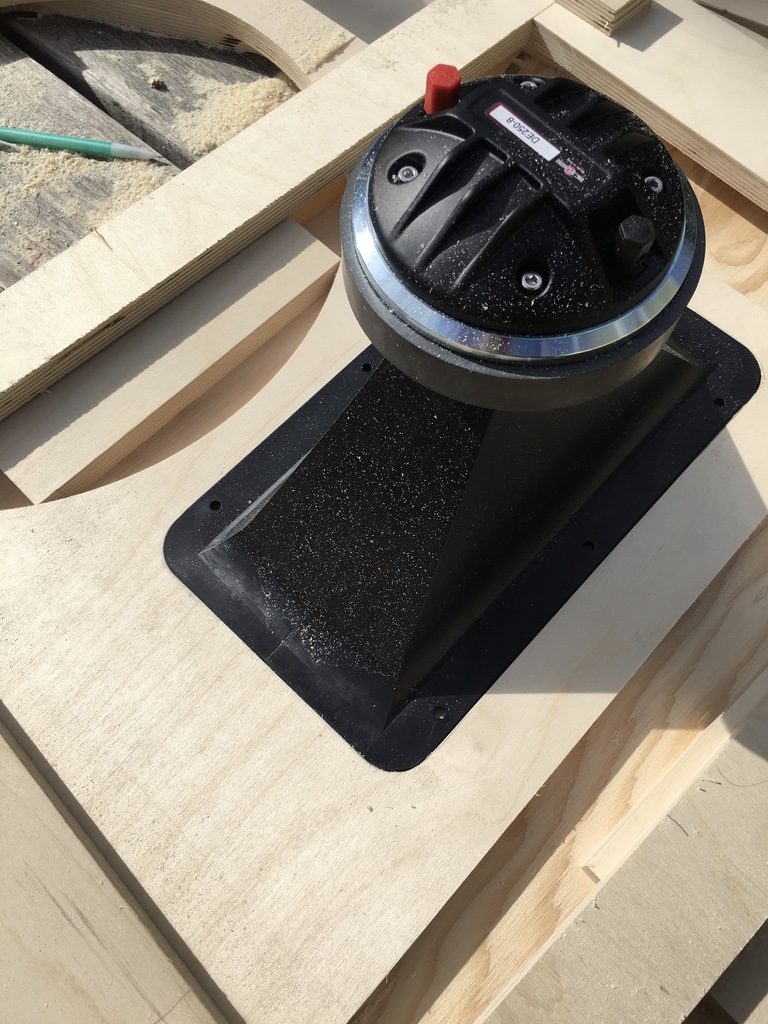

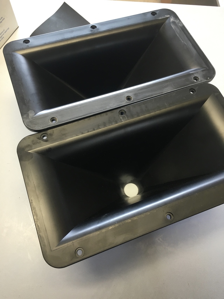

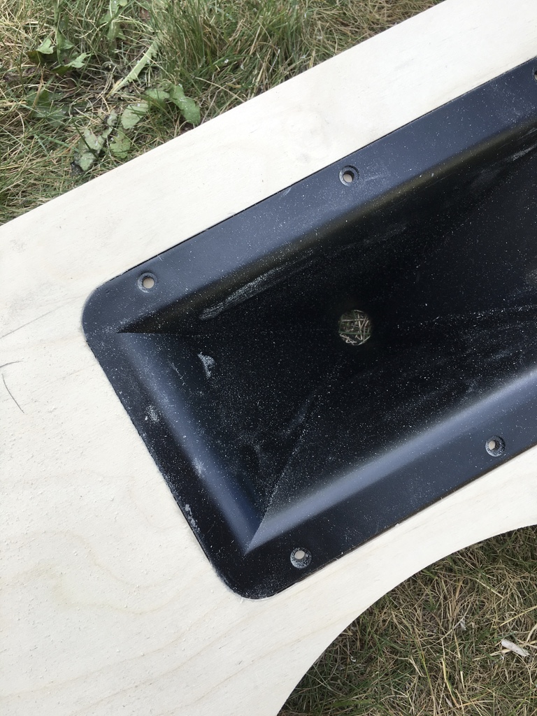

I bought the H290C horns from Wayne. The build quality is nice and I was pleased with the construction. They definitely need to be sanded to remove the parting lines from the mold. I sanded them with 800 grit sandpaper and painted them with semi-gloss black. Unfortunately, the paint got very scratched during the build as I was test-fitting the horns, so I will need to re-sand and paint.
index.php?t=getfile&id=1928&private=0
index.php?t=getfile&id=1929&private=0
index.php?t=getfile&id=1930&private=0

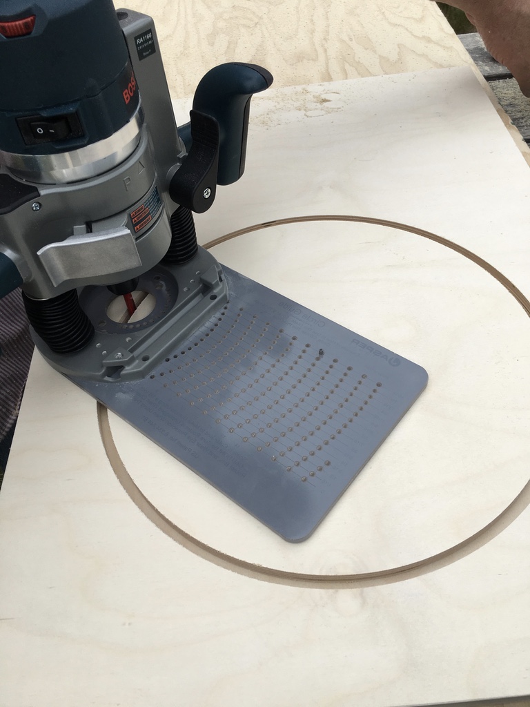

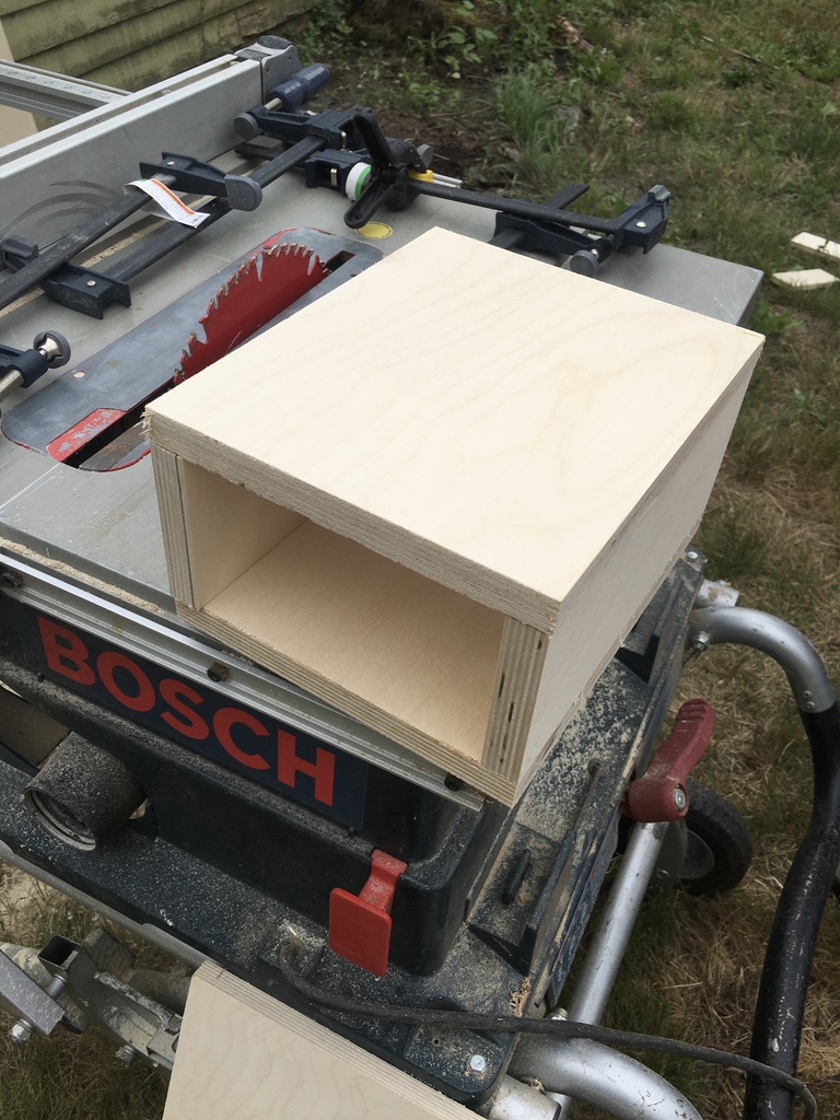

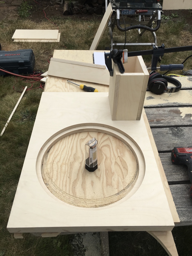

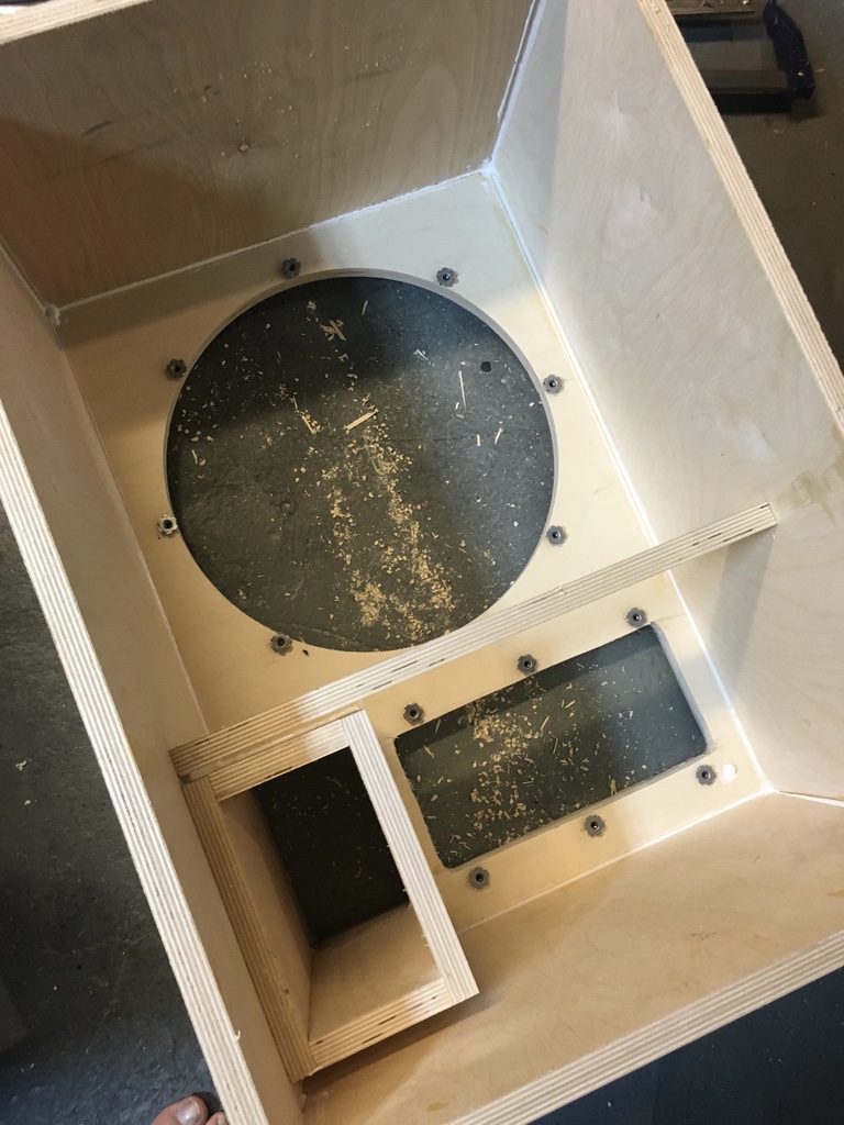

I cut the holes for the speakers with a router and a jasper circle cutting jig. Super easy and highly recommended.
index.php?t=getfile&id=1931&private=0
index.php?t=getfile&id=1932&private=0

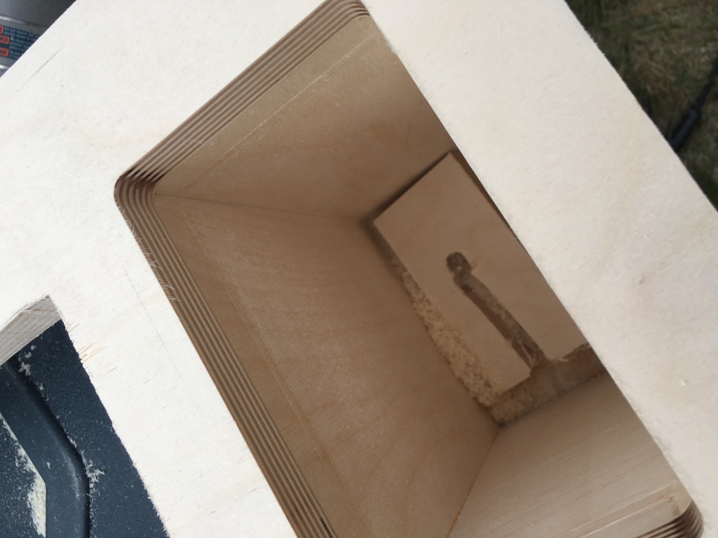

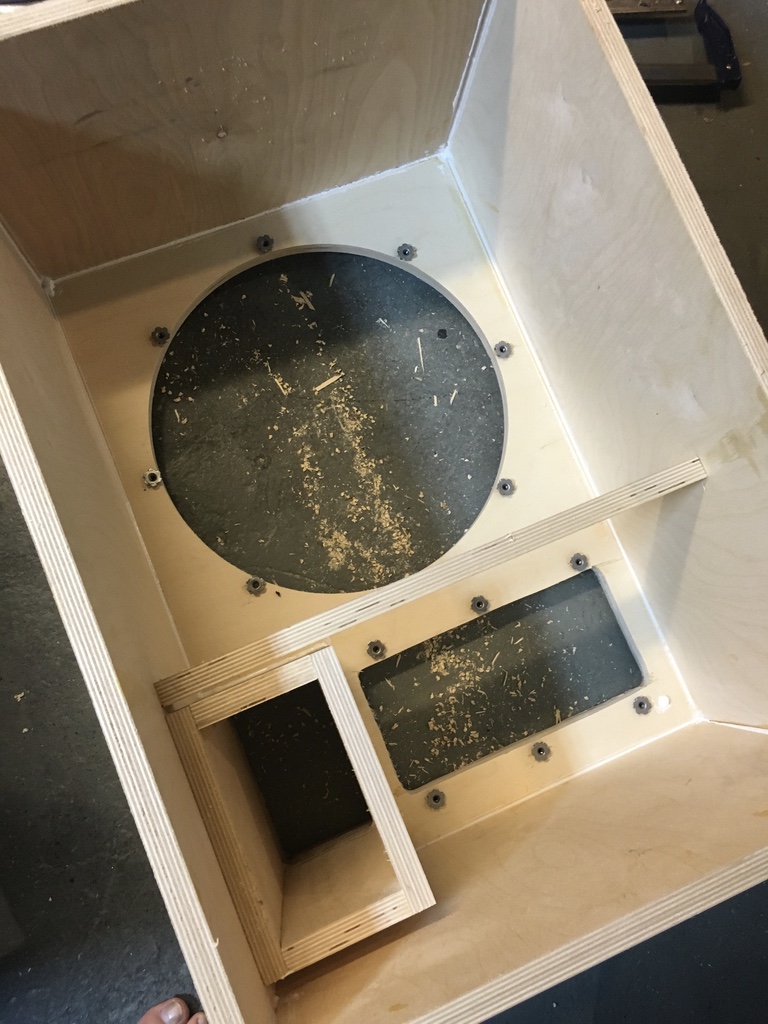

Unfortunately I don't have great pictures of it, but I made a jig to create the cutout for the horns. You can see it a little in the second picture. It was basically a big rectangle that I could run the router across. The hardest part was getting the jig centered. I routed the corners by hand, using a larger bit (3/4") helped a lot.
index.php?t=getfile&id=1933&private=0
The port holes were the easiest part. I glued the port to the back of the front baffle and used a flush cutting bit on the router to cut out the front panel. I got the idea from someone else who did the same thing. I really like how they turned out.

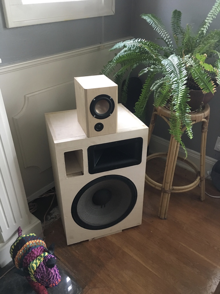

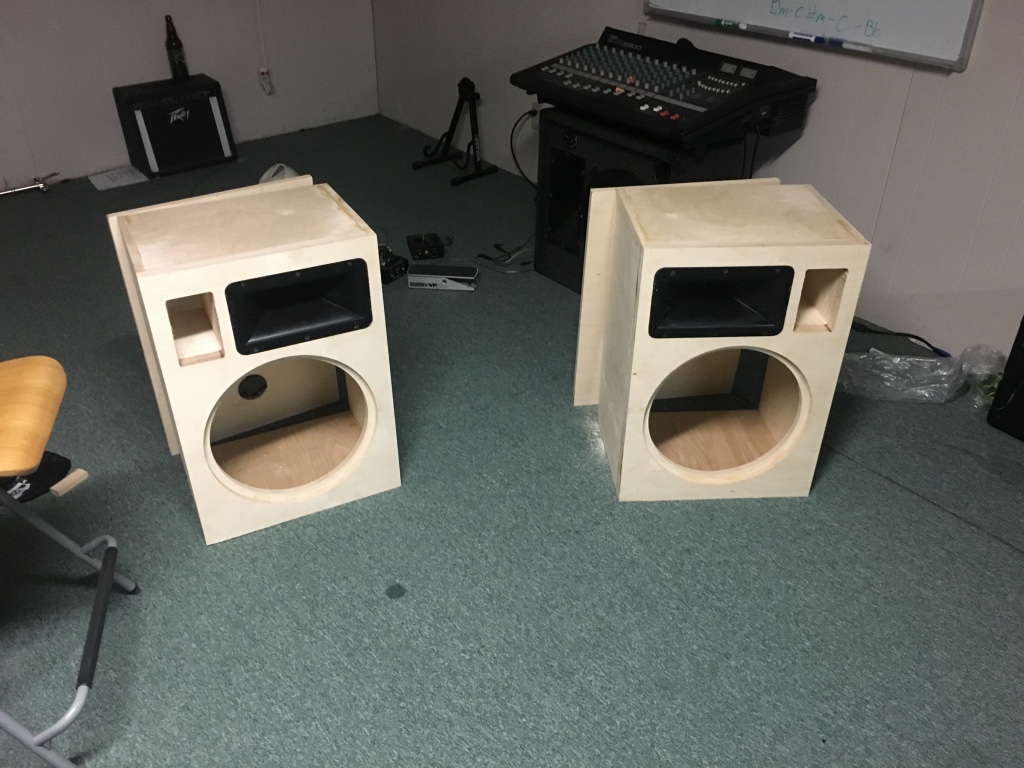

End of day 1, they are starting to look like speakers!
index.php?t=getfile&id=1935&private=0
index.php?t=getfile&id=1936&private=0
index.php?t=getfile&id=1937&private=0
index.php?t=getfile&id=1938&private=0

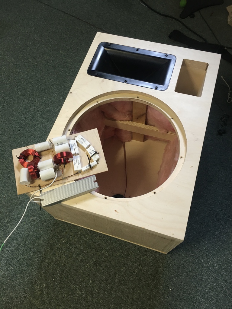

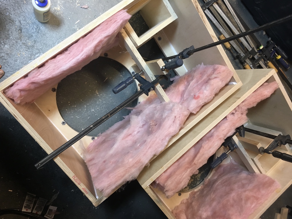

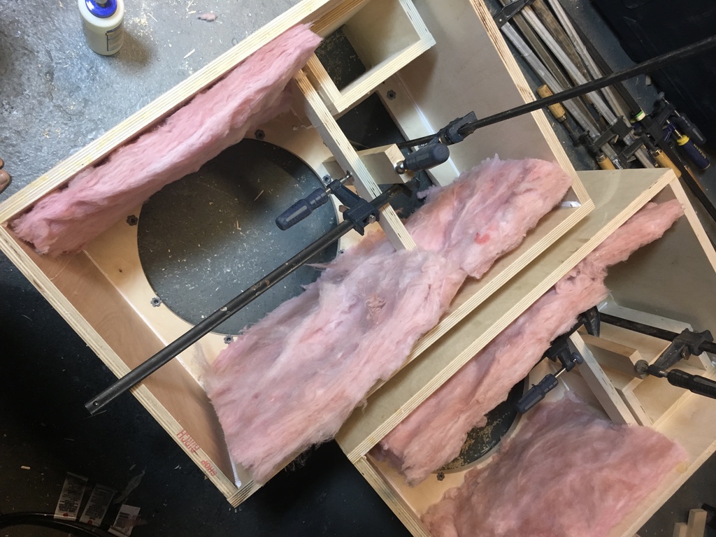

Finishing touches. I added insulation to the bottom and back, also.
index.php?t=getfile&id=1939&private=0
First listen.. Uh oh. Something isn't right. Mids were screwed up. A quick review of the schematic showed I had accidentally wired the B&C250 out of phase.
After fixing that I was really, really happy with the performance. I brought a measurement microphone home with the intention of taking some measurements, but I got lost in listening to music and decided I didn't care. Smile
I do think they will benefit from 1-2 nice subwoofers to improve the bass extension. I was already planning for that.
index.php?t=getfile&id=1940&private=0

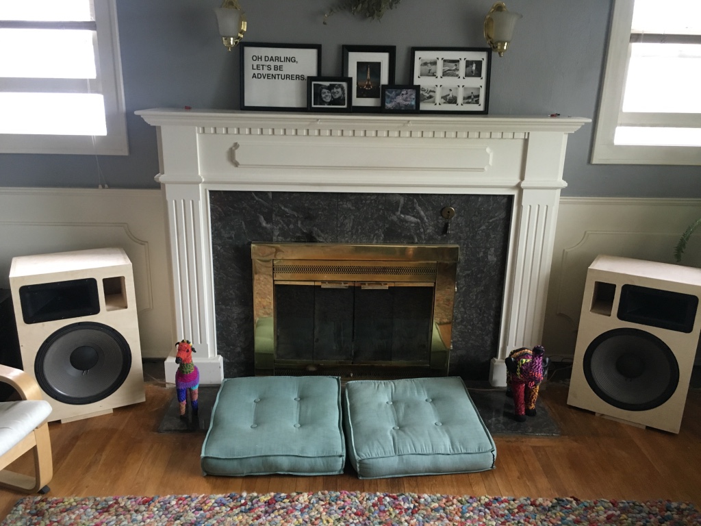

4 Pi next to an overnight sensation for comparison. These speakers are BIG! Smile

You did the same thing with your waveguides that I do in my personal builds. I like to smooth them with fine sandpaper and paint them with black enamel too.
As an aside, isn't it amazing how different the sound is when the compression driver is connected reversed? You should see the measurement - the hole is quite obvious.

Very nice build! You also may want to review Wayne's instruction for lining the cabinet with insulation for guidance. I believe the recommendation is the back panel, the side closest the port, and the top, but don't trust my memory. It can be a bit unreliable Wink
