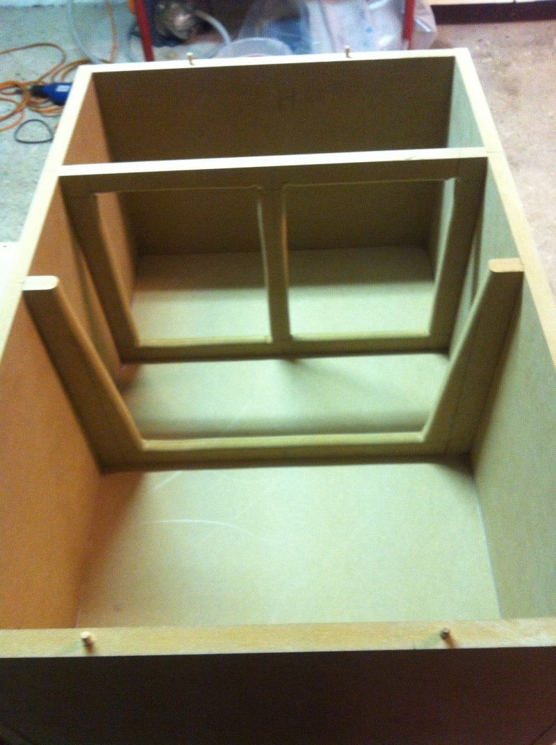

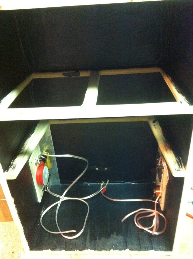

I used 1" mdf for front and rear and added a brace...
index.php?t=getfile&id=1866&private=0

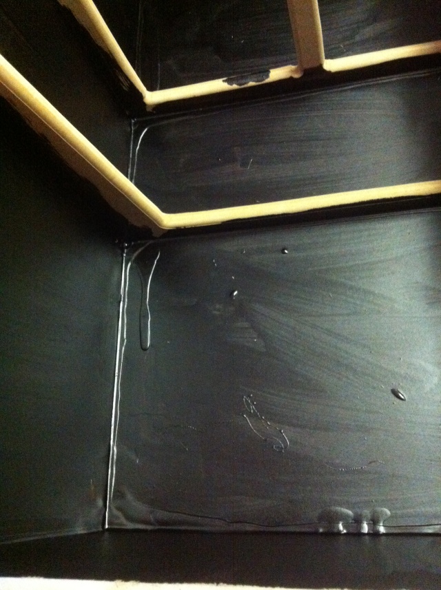

Painted the inside with many coats of waterproofing compound...
index.php?t=getfile&id=1867&private=0

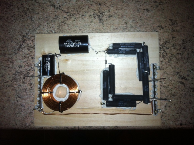

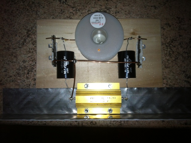

Built separate filters...
index.php?t=getfile&id=1868&private=0
index.php?t=getfile&id=1869&private=0
index.php?t=getfile&id=1872&private=0

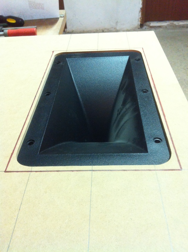

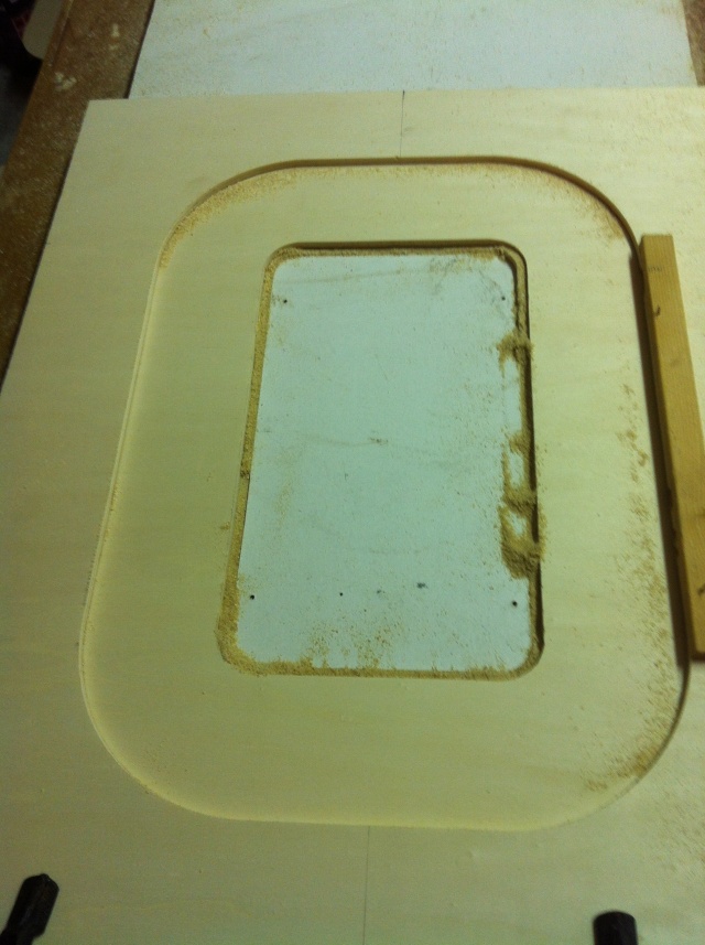

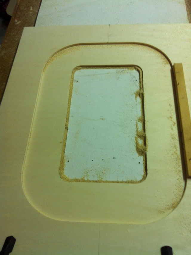

Made the horn recesses following this very good tutorial:
http://www.exquisiteaudio.com/baffle.html
index.php?t=getfile&id=1870&private=0
index.php?t=getfile&id=1871&private=0

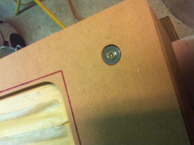

Iron washers and putty for attaching the grills by magnets...
index.php?t=getfile&id=1874&private=0
index.php?t=getfile&id=1875&private=0

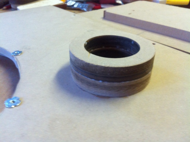

Reflex ducts made by some mdf rings glued together...
index.php?t=getfile&id=1873&private=0

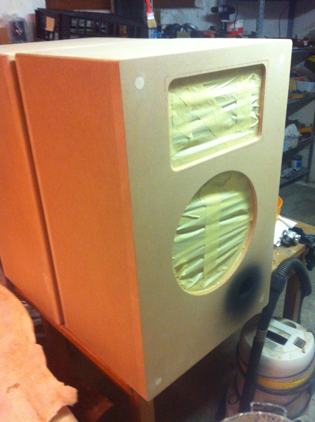

Primer...

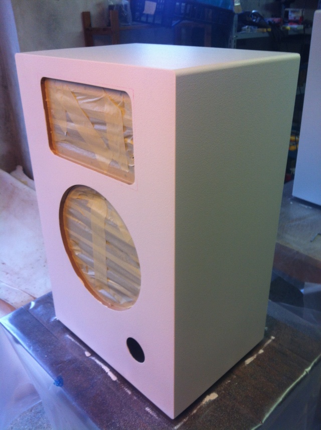

index.php?t=getfile&id=1876&private=0

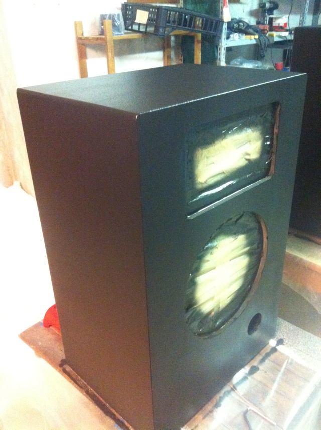

Varnex paint by roller...
index.php?t=getfile&id=1877&private=0

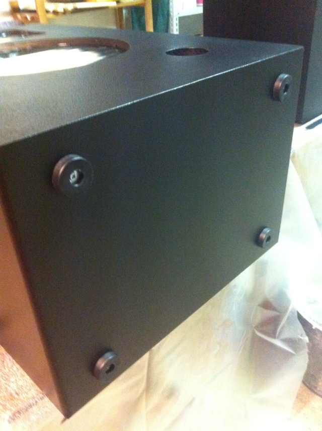

Rubber feet...
index.php?t=getfile&id=1878&private=0

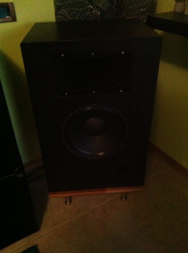

Drivers mounted...
index.php?t=getfile&id=1879&private=0

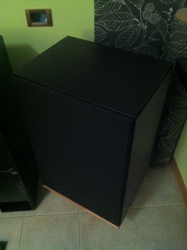

Grills attached...
index.php?t=getfile&id=1880&private=0
Ok and "How do they sound?"...
So good I keep smiling and smiling listening to them... Very Happy

porfido1974 wrote on Wed, 10 February 2016 05:53
Thanks for that link. I was going to surface mount my horns/woofer, but with this info I think I can now recess them.
