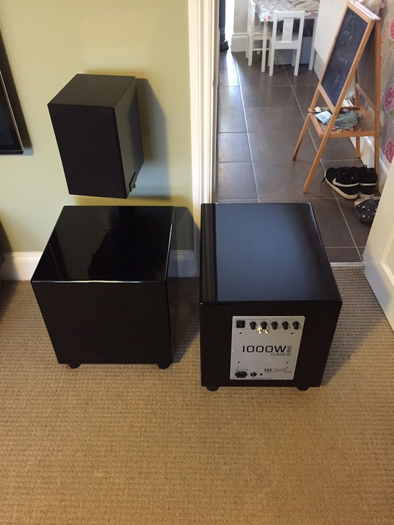

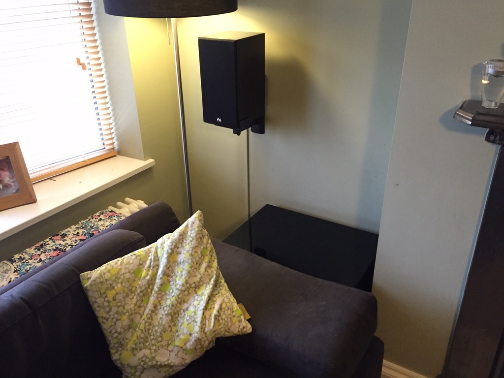

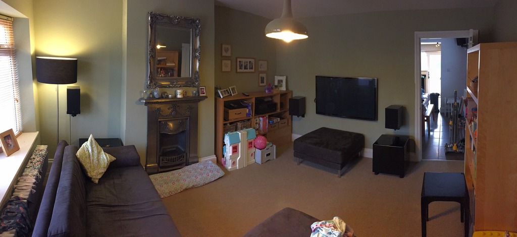

Re: Mono "flanking sub" [message #81716 is a reply to message #81707] Sat, 05 December 2015 08:27 Go to previous messageGo to next message
jonone is currently offline  jonone
Messages: 67
Registered: October 2015
Finally put the amp in the cab for my sub, just got to wait for the driver now! Sad
Here's a few shots of the room, bare in mind it's a small "English" room, not like in the states! Very Happy
index.php?t=getfile&id=1855&private=0
index.php?t=getfile&id=1856&private=0
index.php?t=getfile&id=1857&private=0

That ought to do it man. Smile
It should certainly help even things out in your room. Your room looks to be a decent size.
If I understand correctly, smaller rooms benefit from multiple subs more so than larger ones.
Regards!
Re: Mono "flanking sub" [message #81719 is a reply to message #81717] Sun, 06 December 2015 04:26 Go to previous messageGo to next message
Messages: 67
Yes smaller room are worse for modes I beleive.
