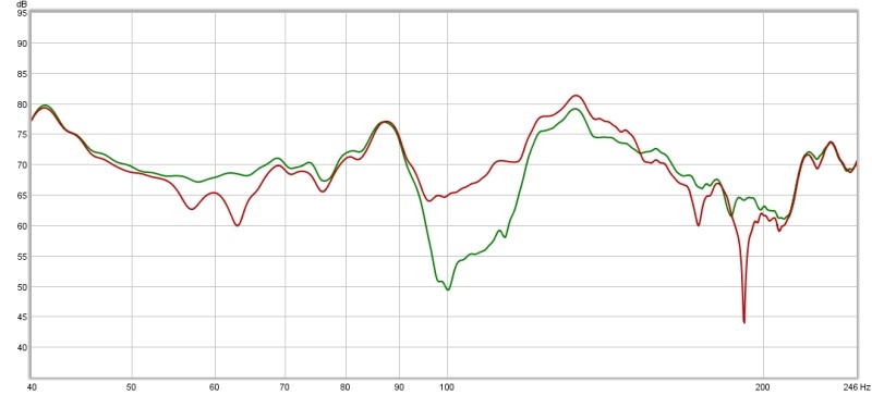

This is my centre seat, in red are my mains on there own, in green is my mains +mono flanking sub, im using a mini dsp with a 150hz Bessel crossover and time aligned to the right speaker which it sits below.
this is with adding 6 db boost to 100hz and 180hz just to the flanking sub.
index.php?t=getfile&id=1844&private=0

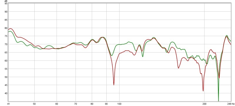

This is the left seat mains in green this time and mains + flanking sub in red(confusing, sorry) I know it's caused a few slight problems elsewhere but that's a big hole filled in!
It needs more tweaking as it's a balance over the three seats, do people generally boost eq points on flanking subs or just use the phase/ delay to flattern the response?
The mains and flaking sub are time aligned, is that wrong? Or should I adjust the delay to get the flattest response? ....... I get confused! Embarassed

We can see that the flanking sub approach is smoothing the mains through reduction of the notch around 95Hz - 100Hz. This is largely because of the sub's physical relationship to the mains - Even though there's just one helper woofer, it's still a couple feet away in each plane. So we can see your mono flanking subwoofer approach works pretty well for smoothing.
From your measurement data, I'd say this is a workable solution provided the single summed subwoofer doesn't throw off the image. That was my biggest concern really - The flanking sub approach requires moderately high-frequencies blended in the subwoofer and the main it is flanking.
Lower midrange can be localized, giving perceptional cues of the position of the source. Having a shared flanking subwoofer between the mains can smooth the self-interference notches - as your measurements have shown - but I was concerned it might mess up the stereo image. I suppose that's a subjective thing, and might be content sensitive. Some (nearly mono) material might sound very good in a single flanking sub setup, while others (with highly panned content) might not work as well.
As for the comments/questions about "time alignment", remember that is impossible to align in three dimensions. You can synchronize in one position, but not all. That's what the multi-sub and flanking-sub approaches are all about. They mitigate anomalies that are created specifically because sound sources and their reflections cannot possibly be time aligned.
