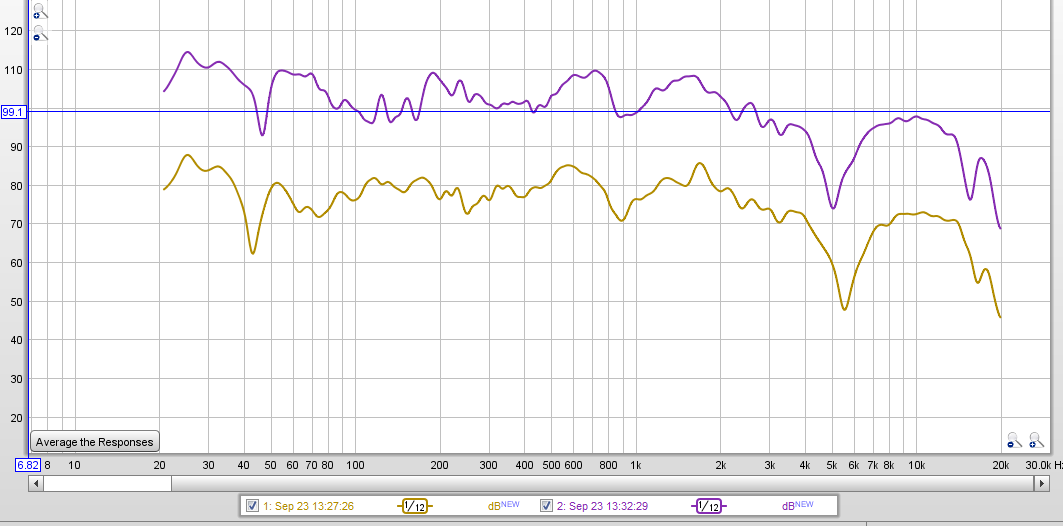

Ok I'm pretty sure I'm doing something wrong here either taking the measurements or I wired all the DE250's out of phase maybe?
This is the Left, then Right Speaker. The mic was several feet further from one speaker then another due to USB wire length.
Here are my measurements. This is in room of course.
index.php?t=getfile&id=1822&private=0

I've tested them both ways and the graph doesn't look much better.

I'm suspicious of the measurement system. If you had a driver mis-wired, you'd see a hole around 1.2kHz. So it's not that.
I see a big hole around 5kHz, and it's pretty much the same in both traces. However, if that were a compression driver problem, I'd expect it to be in one but not the other. So I doubt it's the driver.
It looks like one measurement trace one is shifted in frequency with respect to the other by about 10%. Where one shows a feature at say 5kHz, the other shows the same feature at 5.5kHz. Where one shows something at 42Hz, the other shows the same thing at 47Hz. So the anomalies appear to be the same in both traces, but for some reason, they're shifted in frequency by 10%. That's an odd set of symptoms.
I think the anomalies are probably caused by the measurement system. It's the only thing I can see that would cause this.

Irrespective of the anomalous frequency shift Wayne mentioned, the only time I have gotten issues like this was when I was running both speakers simultaneously and taking measurements. The only way that works is if the microphone is just about exactly between the monitors. As you've stated, your microphone was significantly off. Do you think it was possible you had both running, or one only partially reduced in volume? In my attempts to center the mic I found that the further off center, the lower the frequency of cancellation. This may not be your problem but check it if you haven't.

Yeah I believe I did have them both on. I'll try to redo the tests soon and see if I can get the sound card on the computer I'm using calibrated too.
