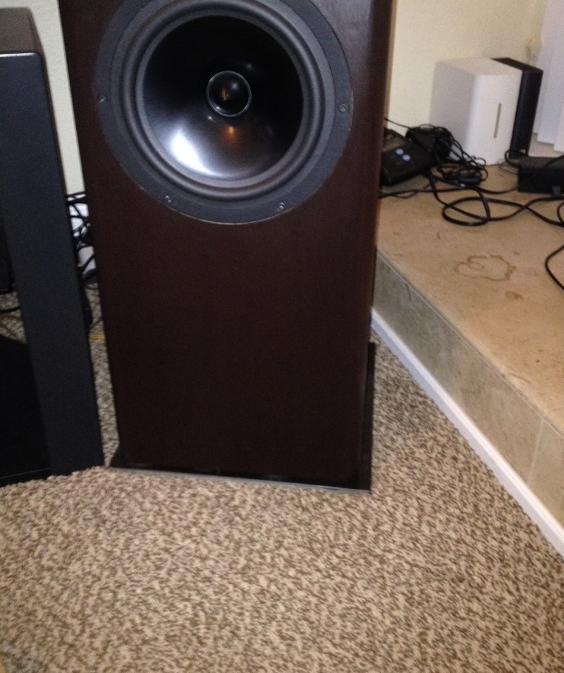

Okay I have searched, and have found plenty on recommended stand height/tilt (I think I will be going with 15" and 3 degrees).
But I did not find what might be the minimum sufficient stand base size, that still provides adequate stability. The smaller I can make the base, the more I can move my right speaker over a 4" high riser that interferes with my room setup.

Stands should be 12" to 15" with 3° to 7° setback angle.
As for the construction of the stand, that is really up to you. It depends mostly on materials and taste. A metal stand can be made with very thin tubular and still be structurally adequate. Wood stands need to be a little larger.
I like having two flat surfaces, each nearly as large as the bottom of the speaker cabinet, one for the stand base and one for the perch. Those are separated by a wood post that is actually a hollow "tube" made of 1/2" to 5/8" stock that's about 4" x 4" x 12".
Re: 4pi Stand Base [message #81546 is a reply to message #81544] Sun, 23 August 2015 11:15 Go to previous messageGo to next message
Messages: 58
Registered: February 2011
Thanks Wayne again for the input. I was thinking the base would have to be nearly as large as the speaker bottom for stability.
I've attached a pic of the problem area. The current speaker is 11" wide, the 4pi is 18.5" wide (and will have greater toe-in). I cannot move my entire setup over to the left to accommodate (stairway opening on the other side), so some portion of the 4pi has to sit on the raised floor.
I think I have come up with a solution. Basically a platform the same size as the speaker bottom, with four legs on each corner extending downward. One rear leg will be 4" shorter and sit on the raised floor, problem solved.
Any other possible solution anyone sees most welcomed.

could you make the base of the stand a triangle and make it work so the edge of it is flush against the tile while part of the speaker above the stand over hangs the tile?
You'd have to make it the exact angle you want them toed in at but it might work.
Option 2 hang them from the ceiling? I've half jokingly considered something like this.

Yes that could work (I thought of something similar, but using two legs in front and one in back). But I think the four leg solution would provide greater right/left position and toe-in flexibility.
Option 2 where do you put the flanking subs LOL Very Happy ? Anxiously awaiting an update to your build thread!
