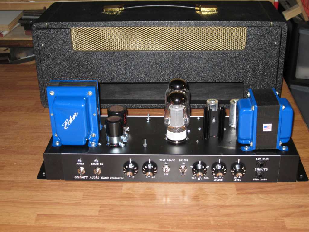

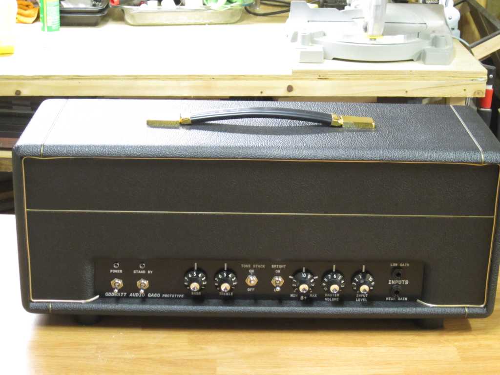

Another update.....I have the first pre-production amp here and running it through the paces. Coming soon for sales ....price not yet set though.
index.php?t=getfile&id=1791&private=0
index.php?t=getfile&id=1792&private=0

Wow, Bruce, that looks really nice!
What's the tube compliment?
Best of luck with that! The prosound world is very different than hifi, and the people intested in FOH gear are different than those most interested in backline gear too. So these are are new roads to travel; Or maybe you're already familiar with these markets. But in any case, I suspect you'll be greeted with the highest enthusiasm!
Re: Guitar Amplifier Progress [message #81529 is a reply to message #81528] Mon, 10 August 2015 17:14 Go to previous message
Hi Wayne, Yes the long in process head amp is getting there. It has been "beta" tested a lot in the Detroit area and now time to get the real things going. The tube line up is 12AX7 first stage, 12AU7 tone stack, 12AX7 driver inverter, and pretty much your choice of output tubes as long as they are rated for 450 V. 6L6GC, EL34, KT77, KT88, 6550, 7027. You actually can run 6V6s in it if you set the B+ below 350. Above that you will smoke them. The adjustable B+ goes from 450 down to about 70. Allows interesting distortion from the output stage. The preamp stage can be over driven as well. Power output varies with the tube choice from about 20 WRMS to 60 WRMS. It plays clean, dirty and everything in between. A fun device to design and now get out on the street.
