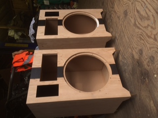

I'm moving ahead on my 4pi build.
All I need are the crossovers and waveguides and I'll be able to complete them. Razz
index.php?t=getfile&id=1743&private=0
index.php?t=getfile&id=1745&private=0
index.php?t=getfile&id=1746&private=0

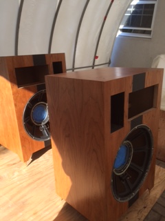

I just have to decide what color to stain the cherry veneer. After that I'll shoot it with some satin clear and install the woofers, your crossovers and waveguides (once they arrive).
I hope you like the racing stripes😀.
Regards!
Re: Johnny5's four Pi build [message #81455 is a reply to message #81453] Thu, 16 July 2015 10:58 Go to previous messageGo to next message
Messages: 19102
My wife and I were wondering what those black stripes were.
Are they paint? Formica? A darker wood?
Re: Johnny5's four Pi build [message #81457 is a reply to message #81424] Thu, 16 July 2015 14:16 Go to previous messageGo to next message
Messages: 358
Registered: June 2015
Location: NJ
Google "acrytech".
It's an acrylic coating that musicians commonly use for the exterior of say, a bass amp cabinet/pa speaker and the like.
I had some left over from the last set of speakers I built and just sold- "b741scanspeak".
I only used it for the stripe because I had laid out/cut the veneer in the wrong orientation, and
I only had enough veneer left to do the front panels with the grain running horizontal instead of vertical.
Therefore, I decided to keep the grain vertical, and throw in the stripe, so you're looking at a mistake Embarassed.
I happen to like it this way, and the speaker covers will hide it if I choose.
Regards!

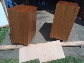

They have darkened quite nicely with no stain.
Here they are after several coats of clear (gloss) lacquer.
You can see the raw cherry veneer laying on the ground in front of them.
Quite a difference!
