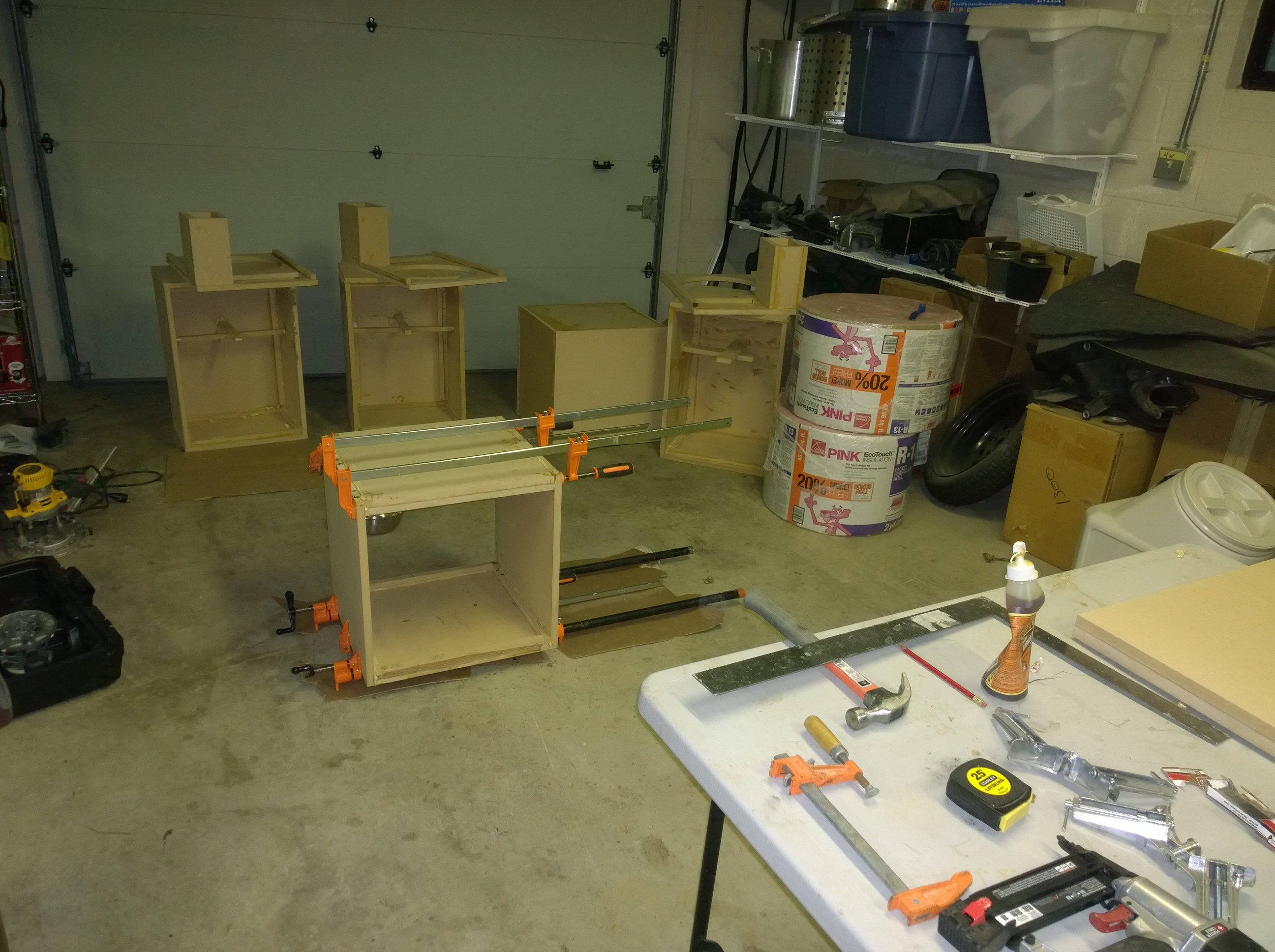

Progress continues, all of the ports a glued to the baffles, all of the cabinets have the bracing in. just need to glue baffles in, with only six camps I can only glue so much at a time.
One 3 Pi subwoofer is together just need to cut baffle, the other subwoofer should be together tonight.

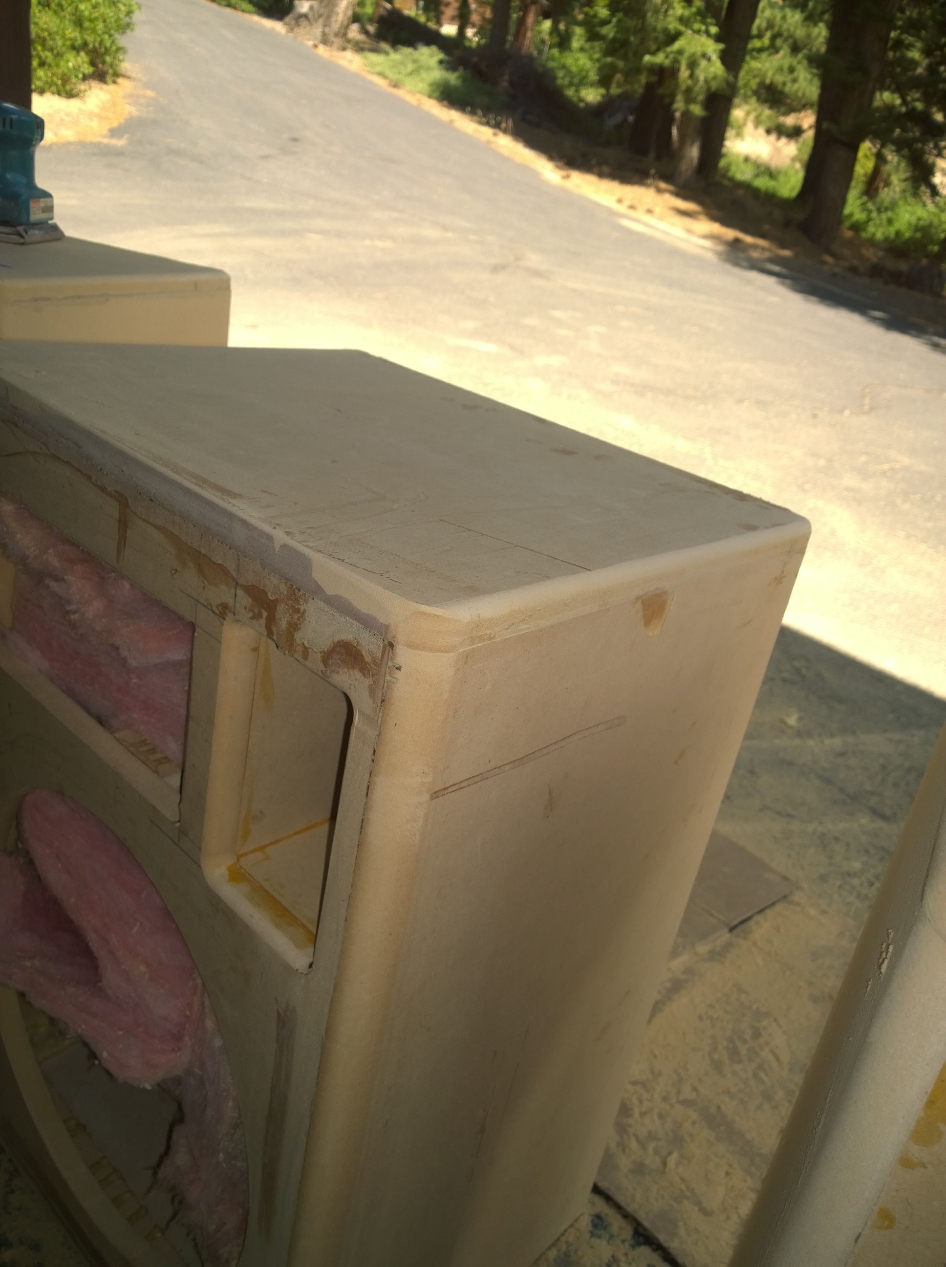

More progress, The 3 Pi Subwoofers got their final hole cut with a 4" hole saw, since my router couldn't make a 4" hole and my dermal didn't like cutting MDF. I also bondoed around the edges and sanded, The subs are almost ready for paint. As of this morning before work the last baffle has been glued on to the 4 Pis.
index.php?t=getfile&id=1780&private=0
To finish the 4 Pis I'm thinking about doing a 1" round over up the front sides with my router then bondo and primer. While I figure how what color I really want to paint them.

Round overs done, hope to finish Bondoing the edges of all the boxes tomorrow, then a bunch of sanding and I'll hit them all with some primer.
You can see the 3/8" round over on the top sides, and the 1" round over on the front sides, I think I'm leaving everything else square.
