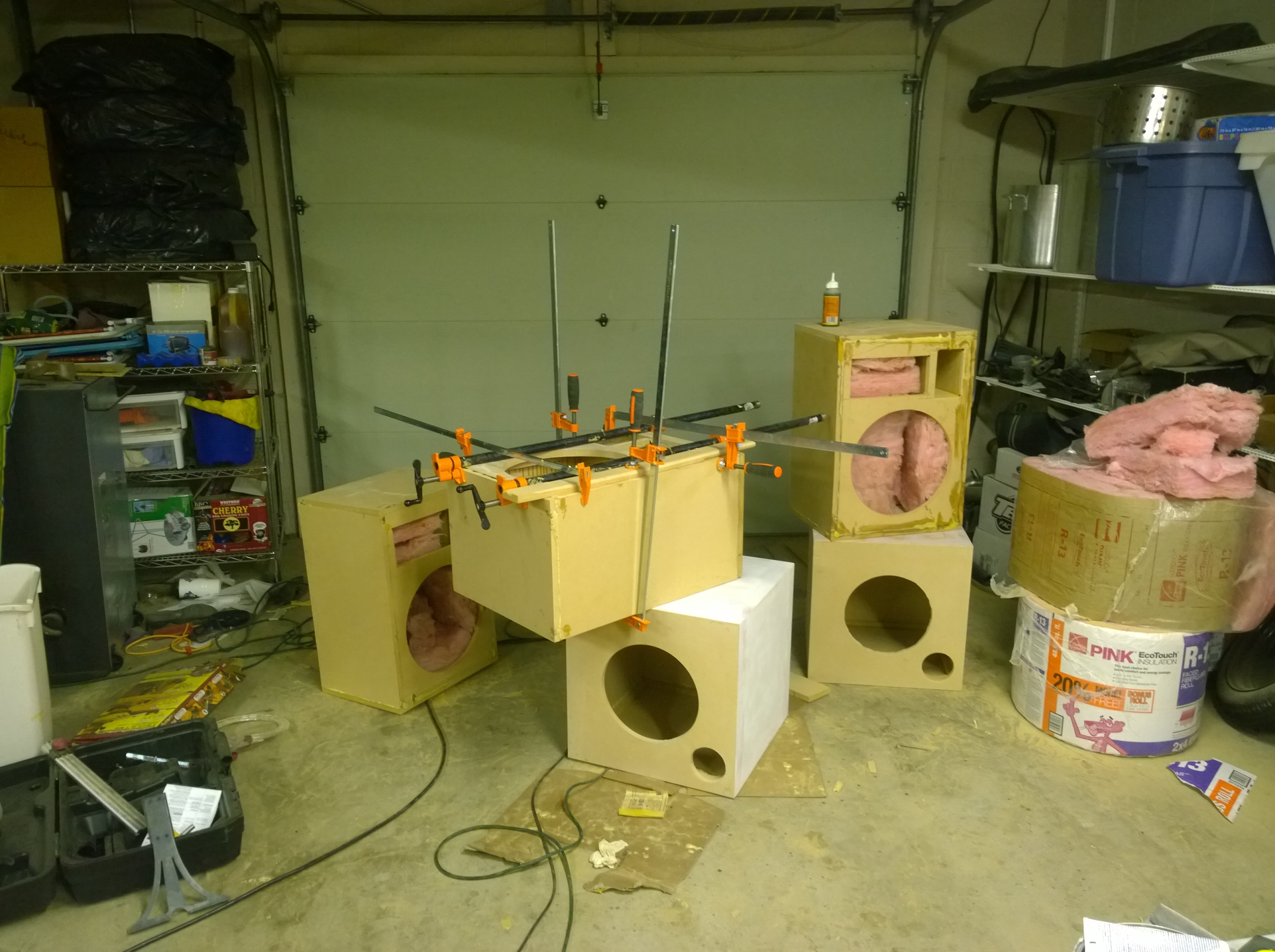

Progress continues, all of the ports a glued to the baffles, all of the cabinets have the bracing in. just need to glue baffles in, with only six camps I can only glue so much at a time.
One 3 Pi subwoofer is together just need to cut baffle, the other subwoofer should be together tonight.

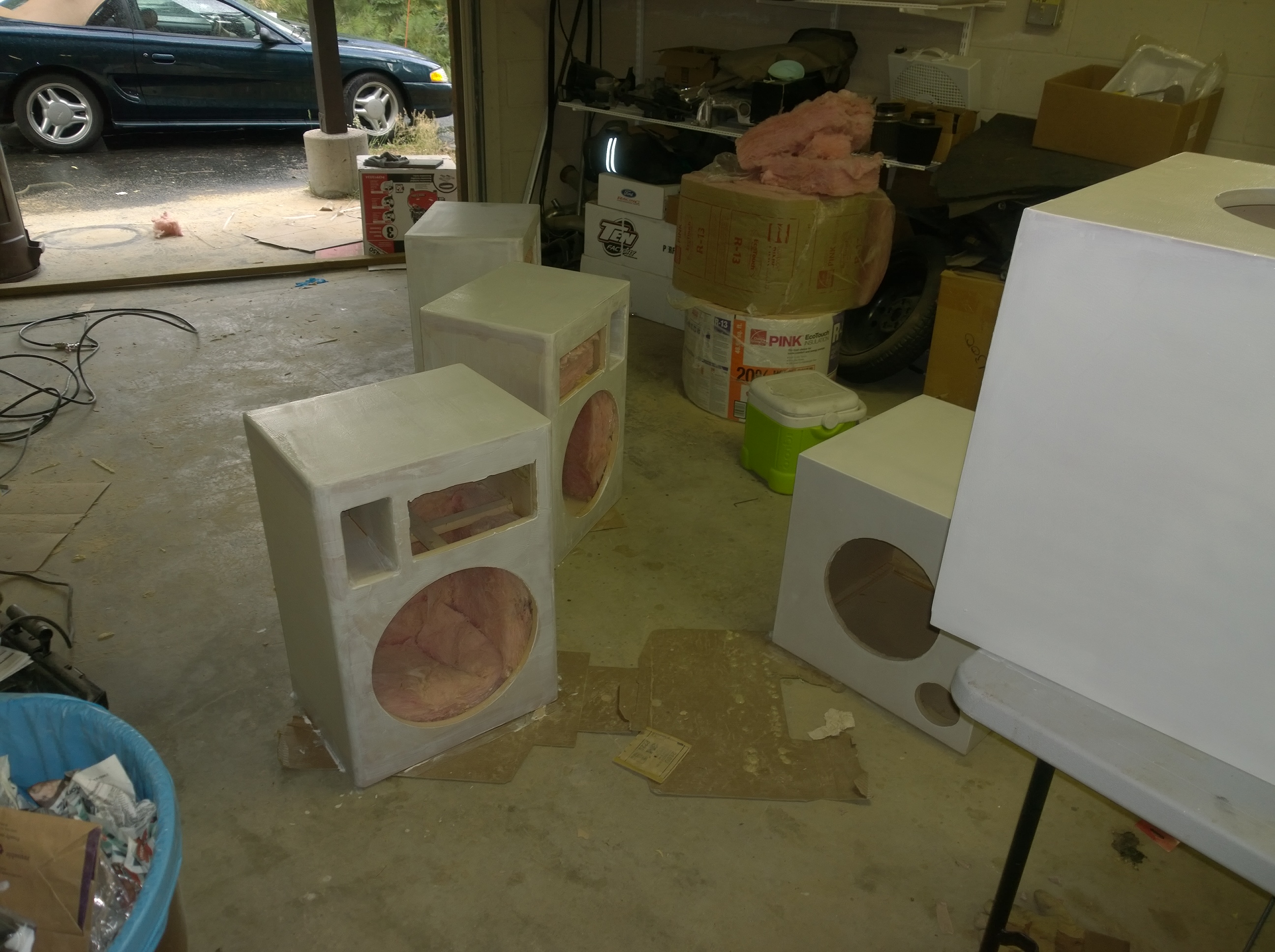

Bondo done, Primer almost done.
Nothing a little Bondo couldn't clean up
index.php?t=getfile&id=1786&private=0
First coat of high fill primer done, more primer and sanding to come.
index.php?t=getfile&id=1787&private=0

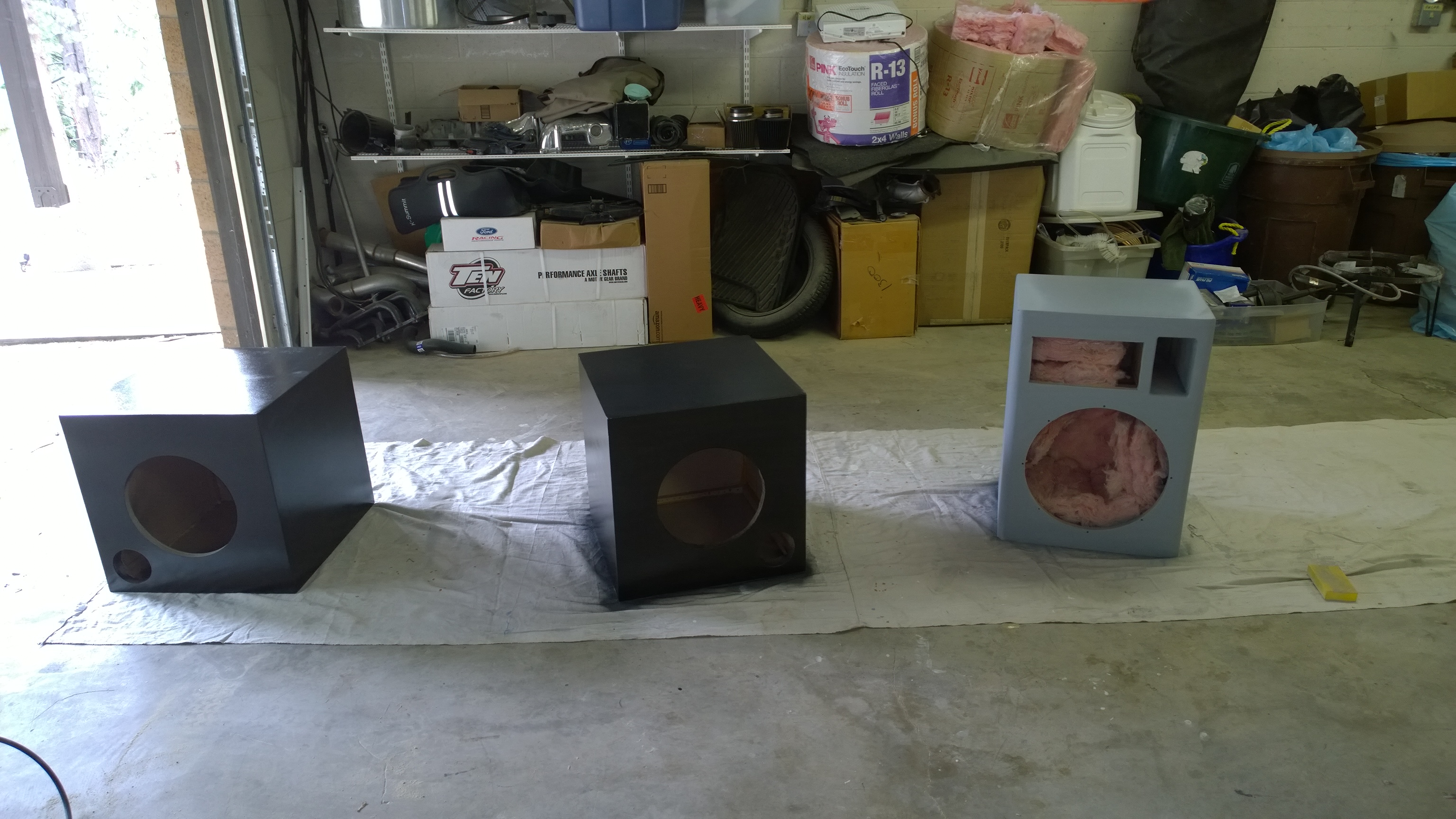

Messages: 32
Registered: July 2015
Location: Lake Tahoe , NV
Sanding sanding sanding....so the first primer I put on needed a lot of sanding, I have the 3 pi subwoofers done! They are finished with Rustolem Hammered Black spray paint. It's a pretty nice look for the subs.
One 4pi is fully primed ready for more sanding before I start the stone gray enamel. the other 2 have the first primer put on and need a lot more sanding. The primer is basically the same color as the stone gray I'll be painting them.
index.php?t=getfile&id=1788&private=0
I'll be out of town for work all of this weekend and and most of next week. My goal is to have all the paint on minus a the clear coat before I go. another 4 hours of sanding with some painting in between and I might be there.
