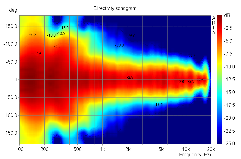

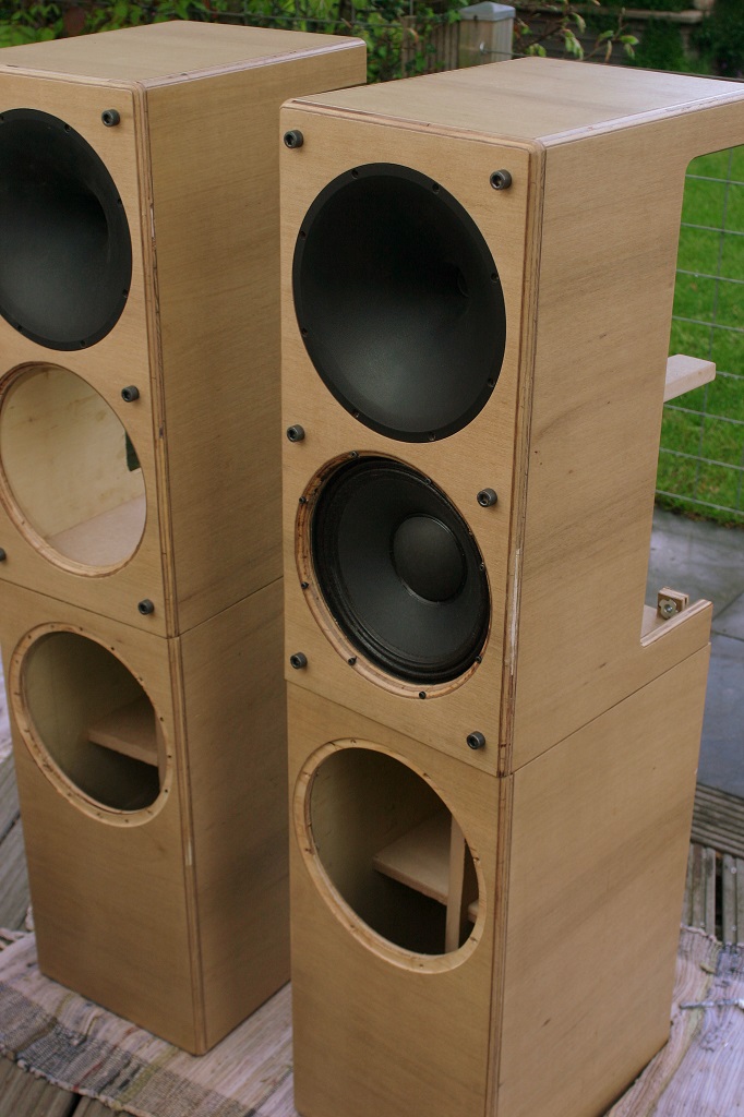

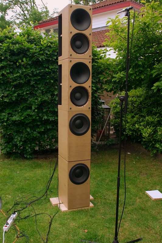

I'm finishing up on a project:
- Above modal region a waveguide (dayton 10inch) / 10inch woofer combination for controlled directivity
- 1st order cardiod radation in the transition zone by using a damped u frame
- multi sub (4) for the modal region (omly two shown in image below)
index.php?t=getfile&id=1756&private=0
index.php?t=getfile&id=1757&private=0
index.php?t=getfile&id=1758&private=0
index.php?t=getfile&id=1759&private=0
index.php?t=getfile&id=1760&private=0
However, I'm having a hard time setting up the four subs. There are endless possibilities. I would really like to try to do a computer based optimisation. I found a tool made by Andy c, however, it doesnt appear to be available.
Does anyone know of software that can optimize multiple subs based on the individually meassured responses?
