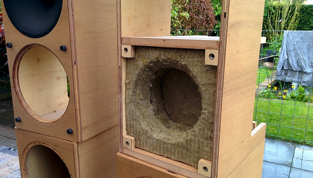

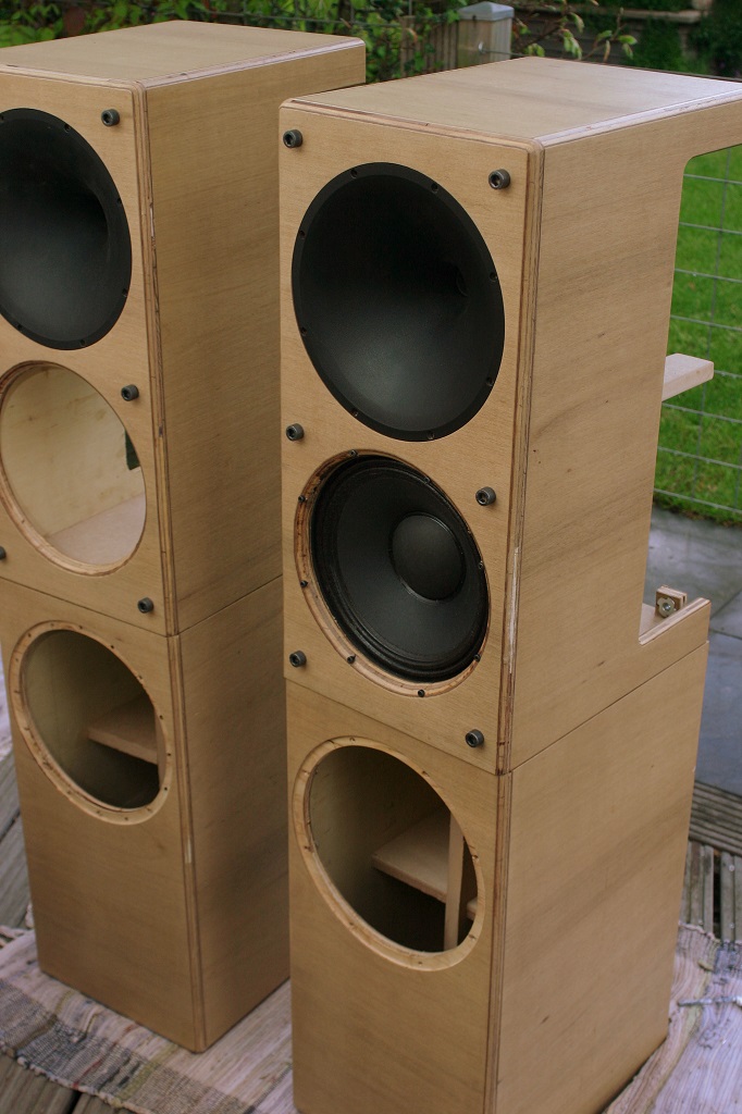

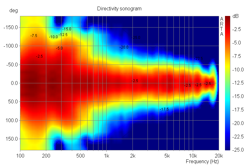

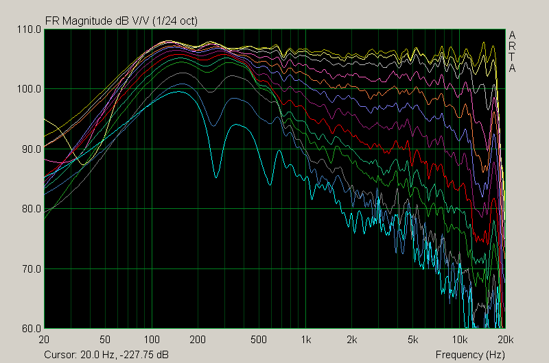

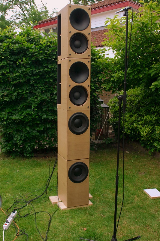

I'm finishing up on a project:
- Above modal region a waveguide (dayton 10inch) / 10inch woofer combination for controlled directivity
- 1st order cardiod radation in the transition zone by using a damped u frame
- multi sub (4) for the modal region (omly two shown in image below)
index.php?t=getfile&id=1756&private=0
index.php?t=getfile&id=1757&private=0
index.php?t=getfile&id=1758&private=0
index.php?t=getfile&id=1759&private=0
index.php?t=getfile&id=1760&private=0
However, I'm having a hard time setting up the four subs. There are endless possibilities. I would really like to try to do a computer based optimisation. I found a tool made by Andy c, however, it doesnt appear to be available.

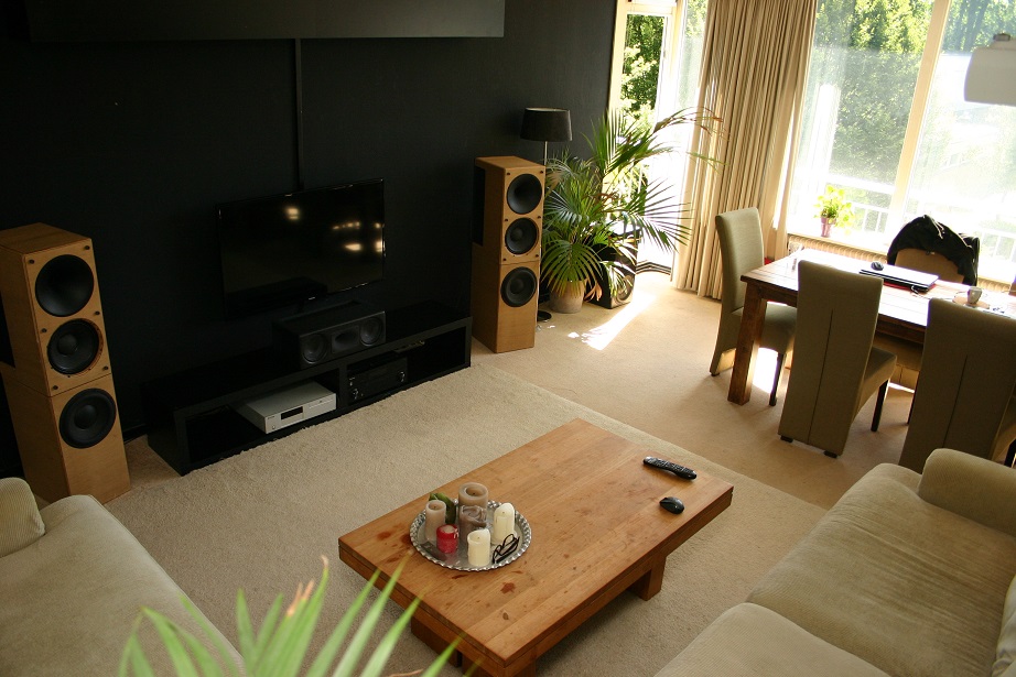

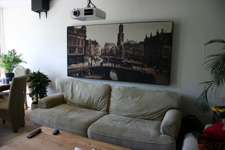

Thank you for your quick reply! Here's an overview of my room.
Note the corner sub in the right of the image
index.php?t=getfile&id=1767&private=0
Note the sub right of the two main speakers Smile
index.php?t=getfile&id=1768&private=0

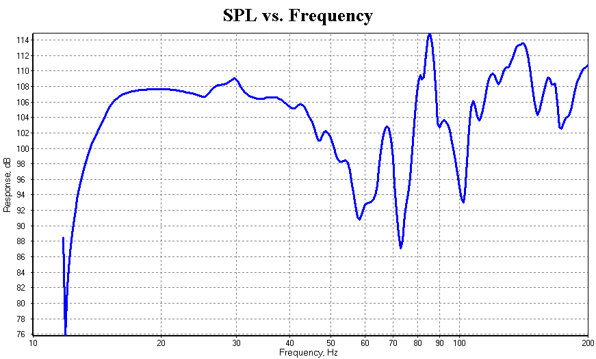

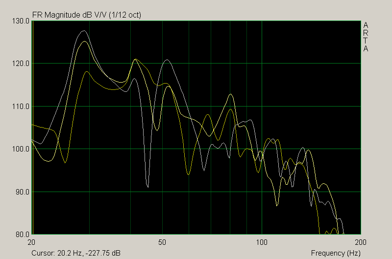

I'm not getting very good results so far. Here are some measurement results. This is all 4 subs active, measured at the three main listening positions.
index.php?t=getfile&id=1769&private=0
After removing the Linkwitz transform EQs that were applied to all (sealed) subs, it got better. However, especially the corner sub doesn't appear to integrate very well. Currently its level is set at -12dB, and phase is inverted. When I get it right for the main listening position, the corner sub sounds out of phase at position 2 & 3 and vice versa.
There are so much possibilities to try, and they work out differently at the various positions. I'm afraid I could spend days without getting it right. I would very much like to try to run a computer based optimization. Do you know whether the software tool made by andy c (link) has ever been made available? It's description looks perfect (the help section)!

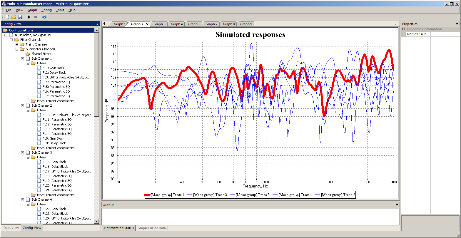

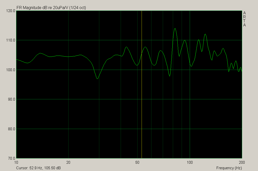

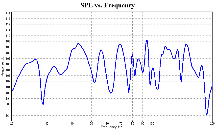

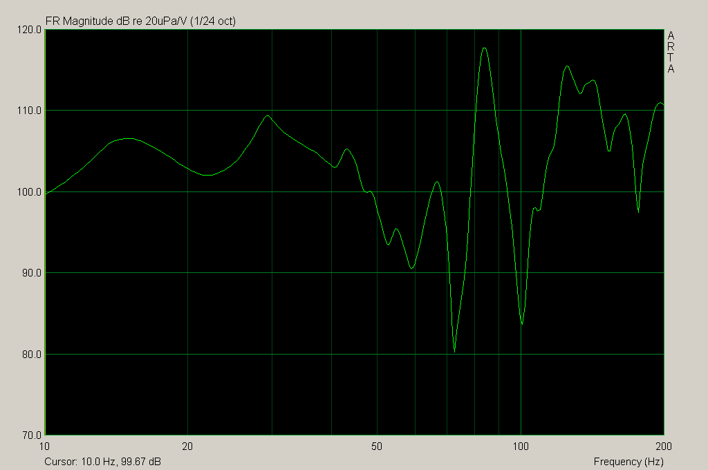

Andy C was so kind as to provide me with his program. He has put quite some effort in it, and that worked out really well. It works by importing dual channel measurements of 5 listening positions of the 4 subs and mains seperately. It took me a couple runs to get it right. After entering all values into my Hypex DSPs, i did a measurement to check the accuracy of the simulation and it turned out quite accurate.
Main listening position simulated and measured (had to move mic in between):
index.php?t=getfile&id=1795&private=0
index.php?t=getfile&id=1794&private=0
Position 5 (left mic standing at same spot):
index.php?t=getfile&id=1797&private=0
index.php?t=getfile&id=1796&private=0
I'm very pleased with the results, it worked better for me than doing it by trial and error myself. The LF sounds well controlled now and when needed powerful. And there's much less variation when you walk through the room.
The red trace is the main listening positions. The four other traces are the other positions
