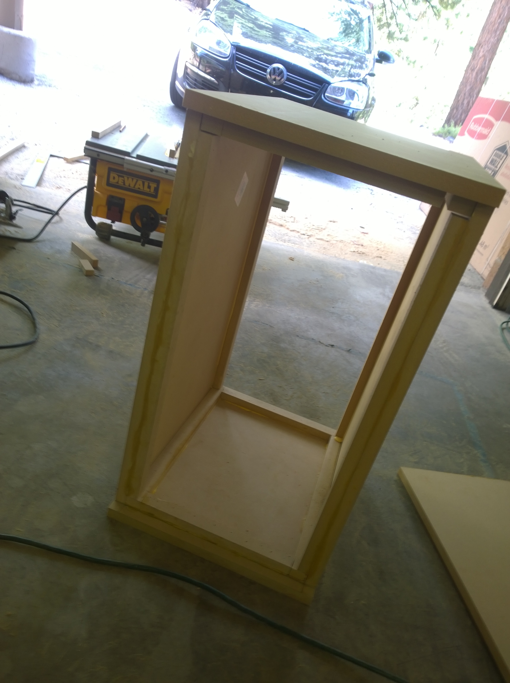

Finally got started on my build over a year later, more pics to come soon.
index.php?t=getfile&id=1755&private=0
This picture is just a quick dry fit of the first of 3 boxes. I should have it mostly glued together soon. I started putting the first port together and realised it's all wrong so i need to recut the mdf for the ports.
More pics to come as progress continues.
Wayne if you see this any chance I can get a the plans for a 3 Pi subwoofer?

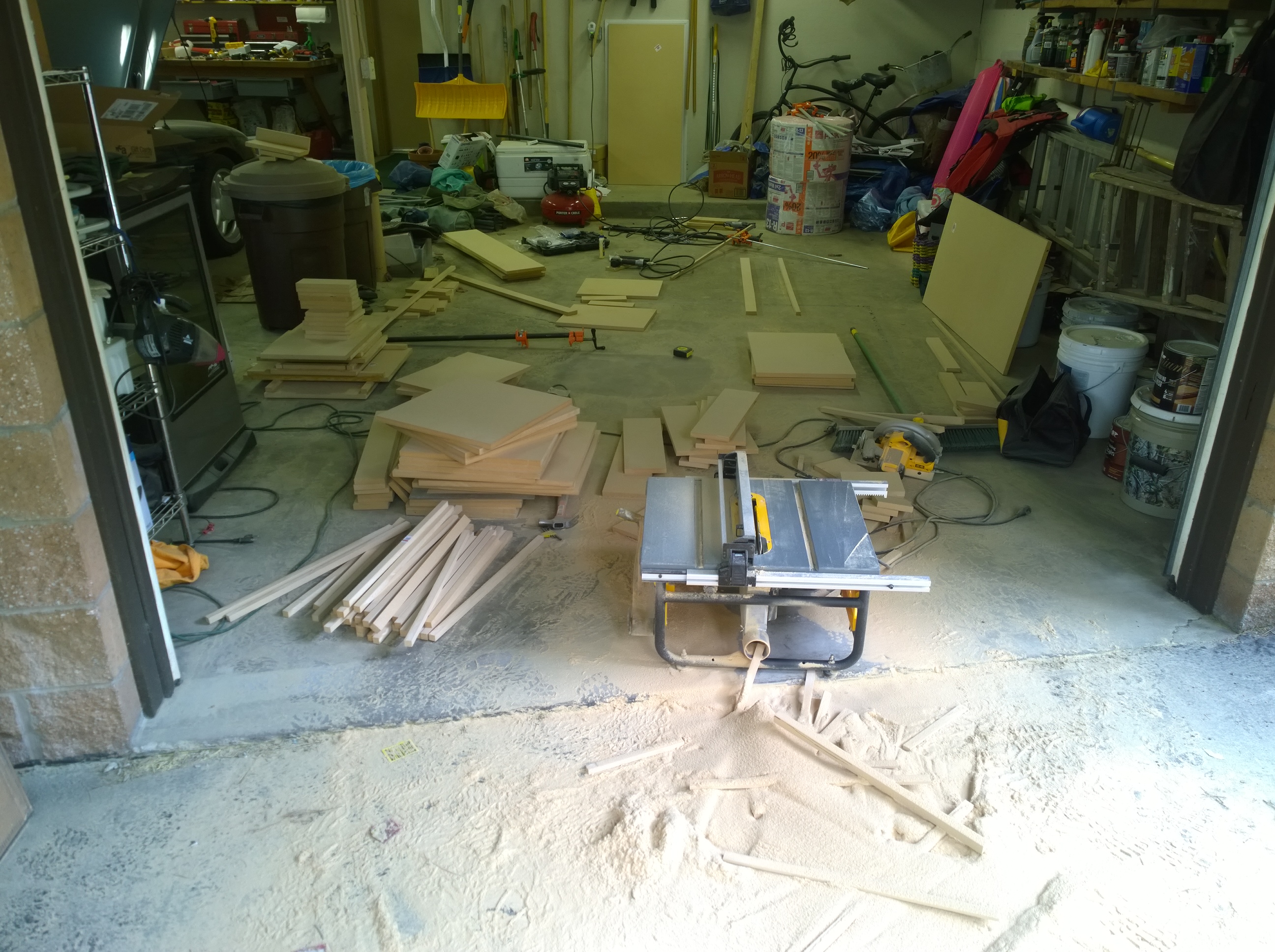

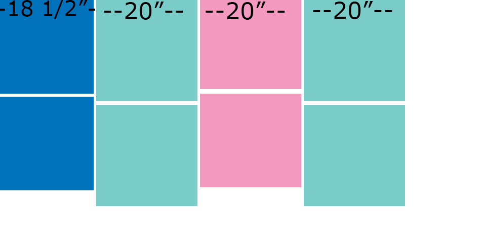

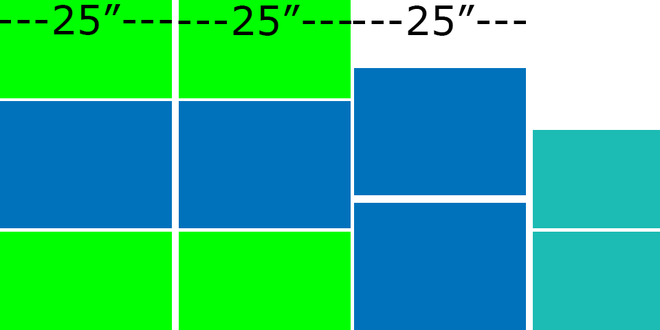

Made some more progress yesterday after going to homedepot to pick up the rest of the MDF. Sadly their panel cutter wasn't working so i ending up having to get 14 2ft x 4ft MDF boards, which was good and bad, Good because it fit in my car and on my small table saw, Bad because i didn't get to use my cut sheet which would have made all the cutting much easier if i could have started with 25" wide sheets not 24"
4pi cut sheet"
index.php?t=getfile&id=1764&private=0
3 pi Subwoofer cut sheet:
index.php?t=getfile&id=1765&private=0
Finished all the major cuts for L C R and 2 flanking subs.

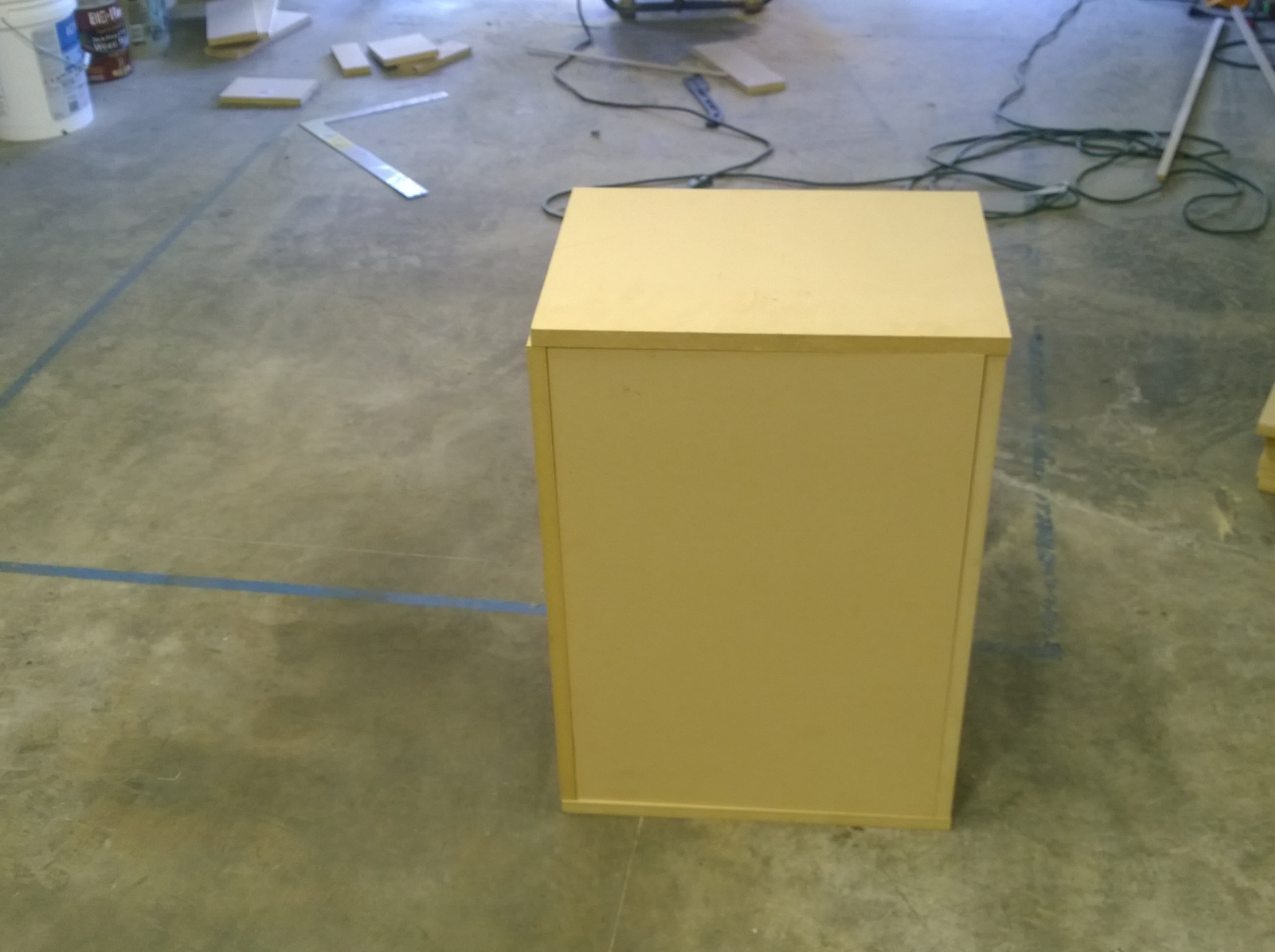

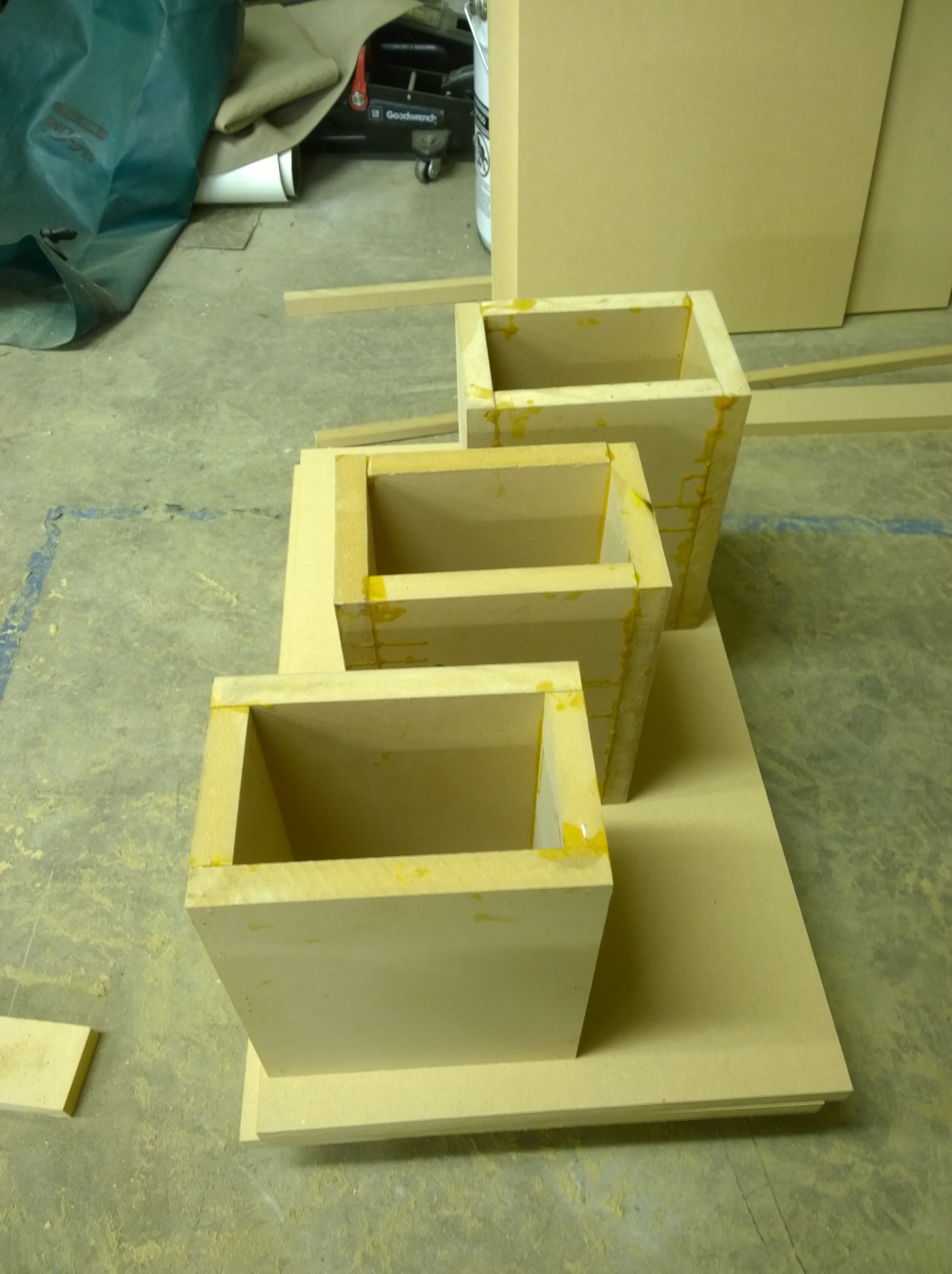

Panels with bracing, The bracing is glued and pined down using an 18gaugae pin gun with 1 1/4" pins. I used this same method to put together the ports, I'll be gluing and clamping everything together from this point.
index.php?t=getfile&id=1761&private=0

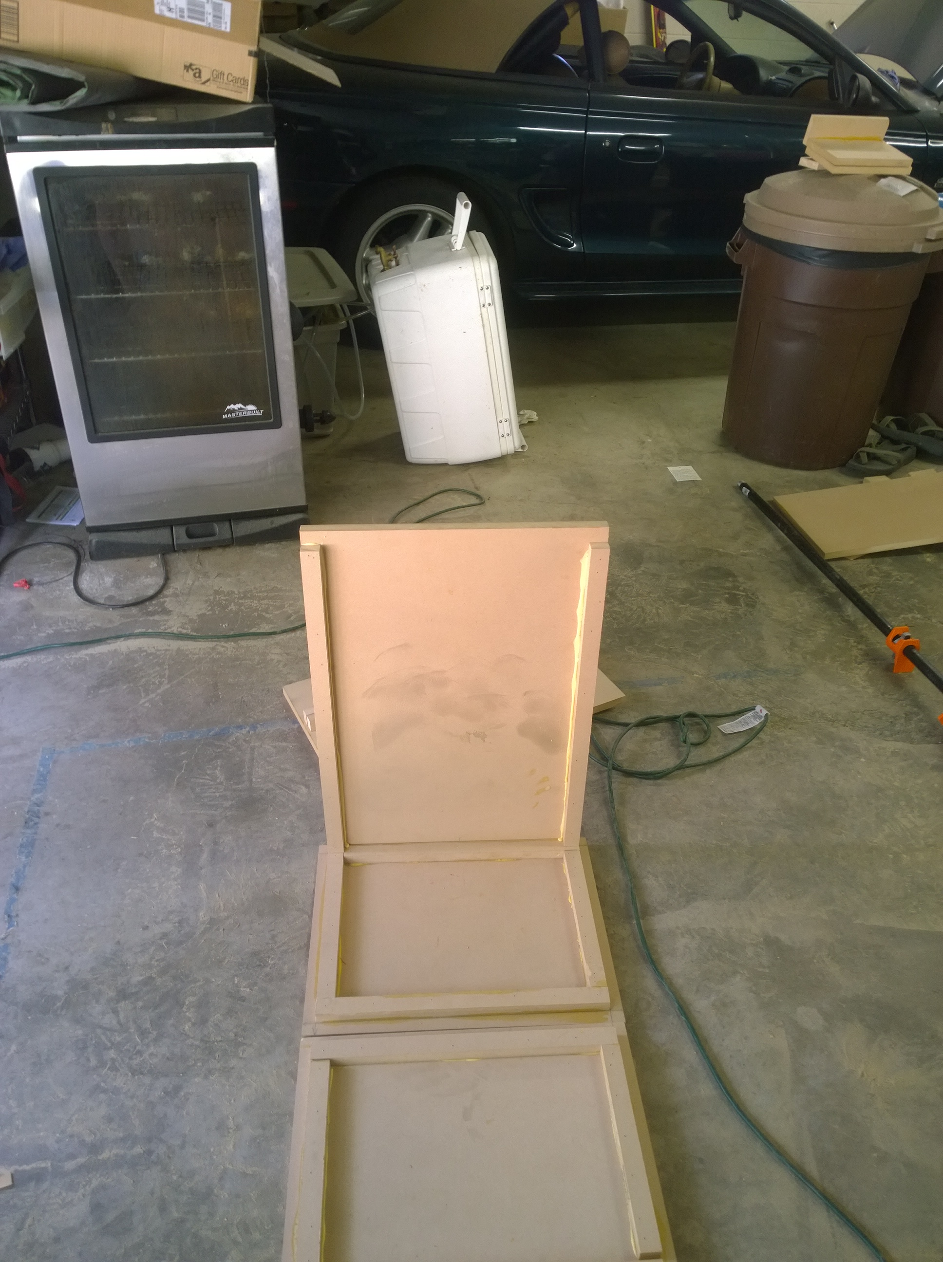

needed to finish 3 4pi's and 2 3pi subwoofers.

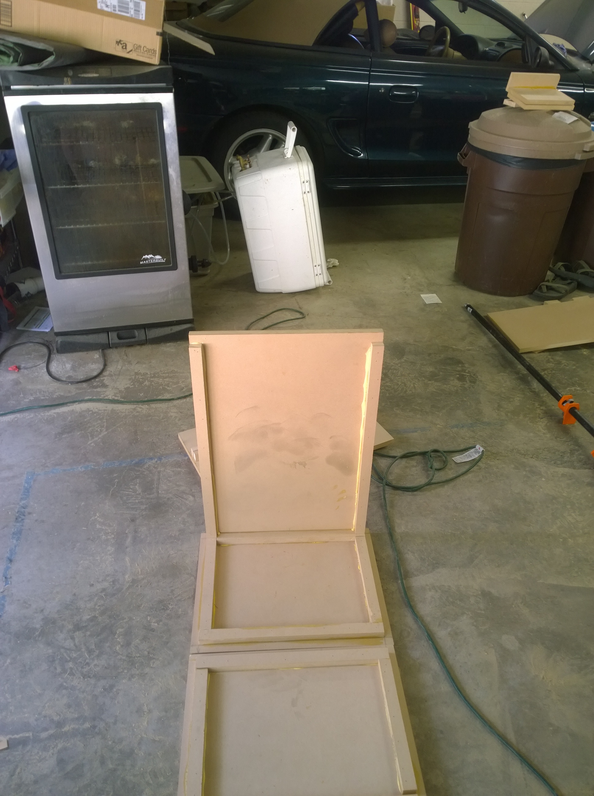

Here's a dry fit with all the side bracing in place, will had cross support above the woofer when its all together.
index.php?t=getfile&id=1762&private=0

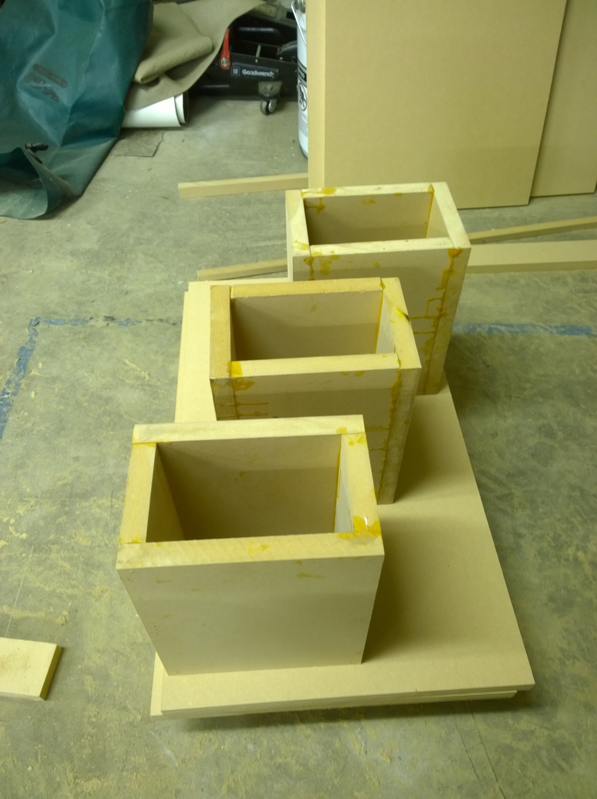

Third time's the charm when it came to cutting the boards for the ports. Luckily the smaller cuts where my last cuts, because somewhere between my last large cut and cutting the boards for the ports the rail on the contractor table saw I'm using jumped a tooth and was completely off. Lesson here cheap contractor saws suck. Need a real table saw soon.
Here are the ports, pinned and glued together.
index.php?t=getfile&id=1770&private=0
Now that I have all the bottoms and side ready I'm going to start gluing the boxes together with out fronts and backs as I'm waiting on a router to cut the baffles.
