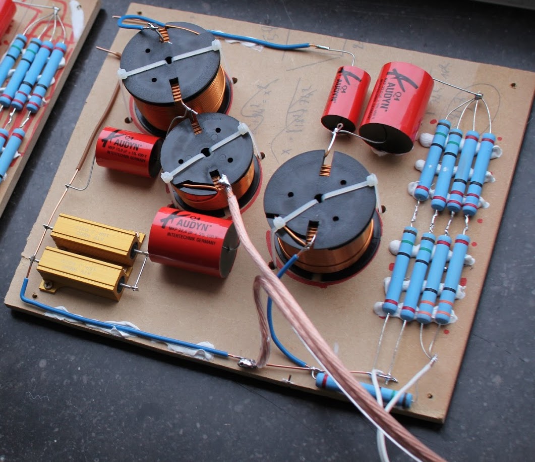

Hello Wayne,
Both compression drivers are B&C DE250 drivers with H290C horns bought on the 4PI-webshop. Both drivers show the same unusual roll-off.
According to your previous post, I understand that the DE250/H290C combination doesn't need extra CD compensation (with an extra C1) because the crossover-design on its own already compensates enough for this CD/horn combination?
This is a picture of the crossover:
index.php?t=getfile&id=1729&private=0
1. No C1 is installed
2. An extra resistor (over the tweeter) is installed (to reduce the possible peak at 1.6khz with the H290C horn).
3. R3 (the Zobel) isn't a large silver block (as seen often in the 4pi crossover pictures), but two 15ohm/50W resistors connected parallel.
Nothing of this should cause problems, should it? Or do I overlook something?
Maybe it is an incredible coincidence that both mics show the same roll-off?
Thanks in advance.
