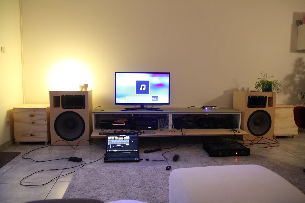

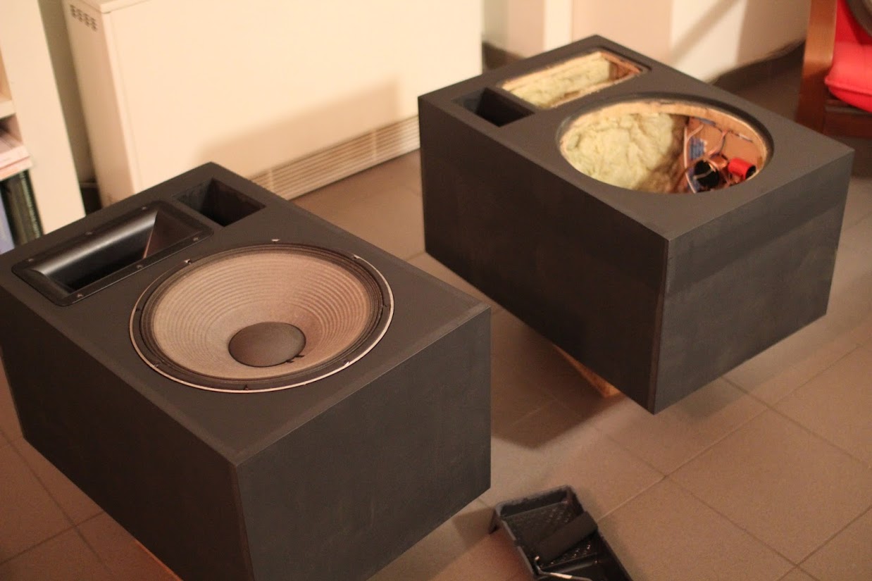

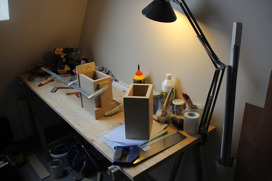

Hello,
Two years ago I started with the 4pi project thanks to Wayne who helped me a lot with his plans and answering my questions.
Pictures!
1. Building the 4pi speakers
2. Finishing
3. New house, made new tv furniture --> new finishing (birch)
Measurements with ecm8000 mic (listening position): very poor low-end due to room modes and resonances:
I've bought two lab12 subwoofers and made 2 testing enclosures. crossover with mini-DSP (30hz;48db/oct, 120hz;12db/oct):
A very geeky testing setup. My wife loves me when I do this kind of setups.
Much better low-end frequency response at listening position!
When I measure full range from the listening position, there is an obvious roloff at the high frequencies. Is this something to worry about? I used the behringer ecm8000 mic, used CAL-file (which makes the roloff even steeper) and the m-audio fast track which is also calibrated by REW.
