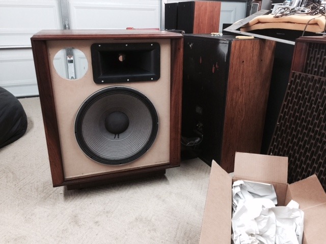

I just received my 4pi parts and have a few questions.
Since I'm not using the standard cabinet I'm trying to figure out the displacement of the H290C.
I also picked up the 4pi crossovers. I haven't soldered boards like these, having only worked on through hole boards. Do I lay the components leads on top of the traces and solder away? Thanks!
Here's a pic of my Barzilay 4pi's. They will be a mirrored stereo pair.
