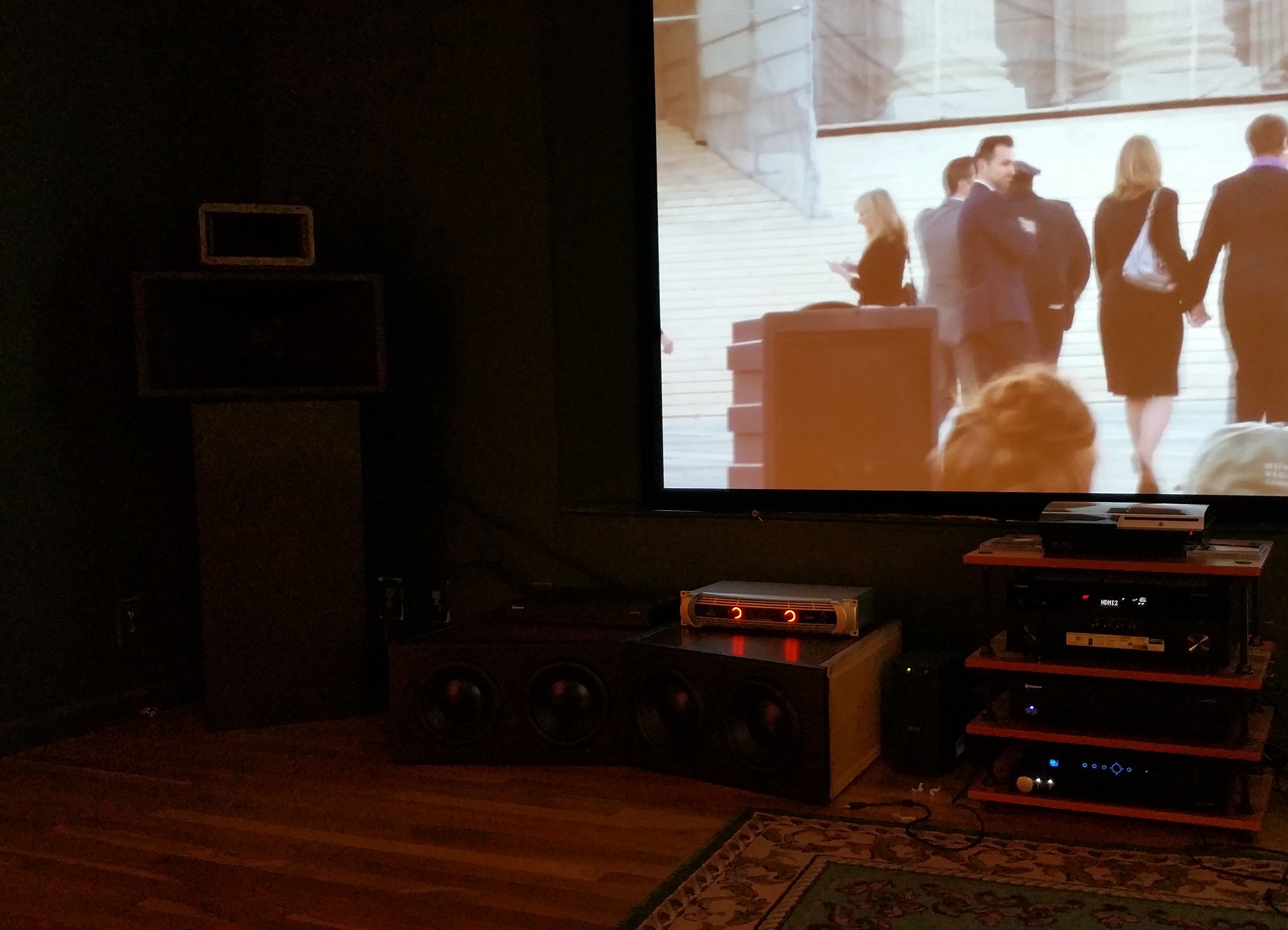

After playing with MiniDSP I can't imagine going back to passive. I just installed a pair of Nolte Audio 4X10" (per pair)175Lbs subs and I now have BASS!

Success!
John Nolte of Nolte Audio came over and set up the MiniDSP crossover driver by driver. He used the same XO points as WP and measured and set thing up from there.
Spent all day tweeking, went out to dinner then sat down and listened for a while.
These are indeed very nice speakers.
Because of the design of the subs, we had to lay them down on the front wall. They don't seem to do anything bad in that position. The sealed subs are flat to 24Hz and make crazy amounts of bass.
We have not done any EQ at all and could walk away right now and be 100% satisfied.

I measured the distance between voice coils between the subs and the the drivers in the 7Pi cornerhorns and added delay accordingly. The main speakers were 4.xx ms away. Amazing difference! The subs disappeared and I can no longer pinpoint the mid and high drivers with my ears. I now have stereo bass and very nice resolution on the mid/top!
Very nice speakers indeed.
