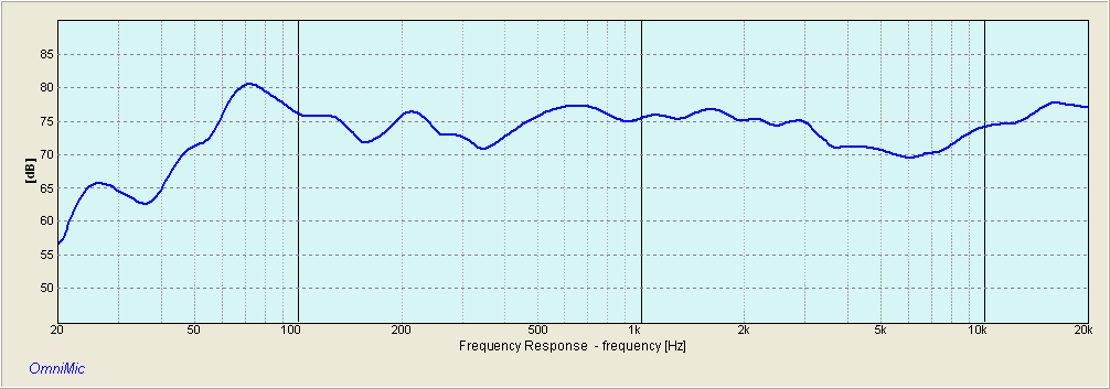

For $120 I couldn't resist, and mine arrived yesterday. My first impression with some baroque classical music was they were a B652 with bass response, they sounded pleasant, and there were not annoying characteristics like sizzzzly tweeter sound. Then I measured them and found an unexpected surprise.
So my question for the speaker experts is what's going on here? Did they intentionally design that 70hz hump into the midbass response? I actually prefer their sound with the ports stuffed with a rag, in which case everything below 150hz is reduced by about 3dB, but I'm thinking somebody who listens to hip hop and pop music might prefer the sound with the ports open.
index.php?t=getfile&id=1591&private=0
